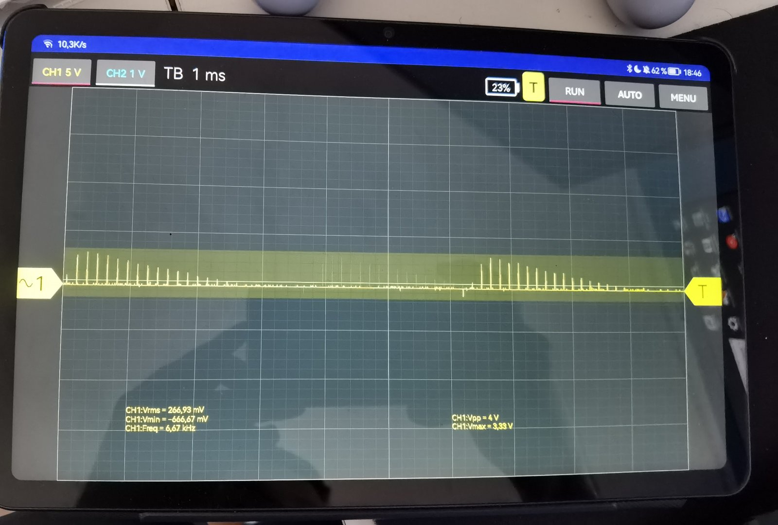

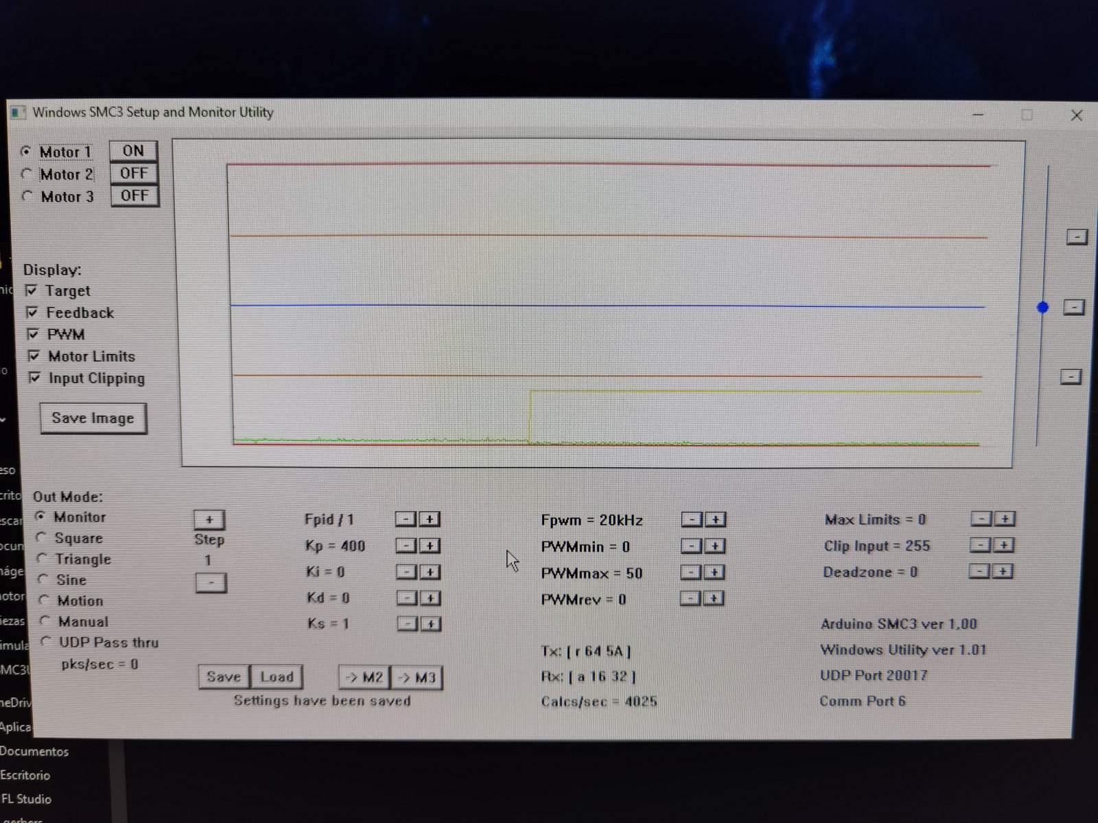

    Hello, after some time i´m testing the initial setup I planned, the motors just move in one direction, and did an audible high pitch noise. I´m trying to find why because as it is 2 arduinos and im testing first 2 and then the other 2 (which for now have not been tested) and maybe will have the same problem or will work nice. I disconnected the motors from the IBT-2 to see with my scope the output the motor receive and i found that the noise do not come (or entirely) from the motors, as it still sounds. When i set up PWMmax over 40 the noise changes and my scope just shows random spikes of voltage but never with the frequency I set in smc3 Util, the IBT-2 which I´m testing (both of them) heat up even with the output just conected to the scope and without any current drawing. I´m using 24v as i´ve saw in other post that IBT-2 could not work well at this voltage, but I´m confused because that noise and the motors moving but just in one direction just switching on the button on smc, without PWM or Kp set (which makes the sim go down by the way) and heating up not just the IBT-2 but also the cable (and maybe internals of the motor, but its sill cold at touch)
    I post the photos of the last smc3 config I used and the scope output I got... I can do the same for all configs of SMC and still will have same results, maybe changing the sound a little if i put pwm frecuency up or turning PMWmax up.
    Also, the arduino I´m testing is an official one, first connected to the hub it should use and then directly to 3 different ports of my pc with the SMC3 modified to MODE2 as it should be.
    If more information is needed, I´ll try to get it. I´m using an IDSO1070A scope which also worked nice up for others projects so it works nice

    Shielding is important.
    Try Fpwm at 25 and also set MaxLimits:
    Max Limits Used to create a band at either limit of the feedback range beyond which if the motors move (typically through inertia) the SMC3 will automatically shutdown the drivers and keep them disabled until reset. This is essentially a safety mechanism if something goes wrong. The value can be between 0-255 (however can’t be greater than the current clip setting).

    I've done that too, still nothing... I can still hear something, just different pitch. For the limits I usually set it to 255 too but since my computer and the sim aren't very close and the sensors are not mounted definitely (first I need to see where the center is) and I have It set up at 0 just have smc3 running, when I set it to 255 or other values and move the sensor it can change the sound if the feedback is above instead of below.
    Everything is pretty much shielded and the motors are specifically built dc motors, not wiper motors or things like that with each arduino sharing its ground with the 2 ibt-2 each one drives. The arduino I'm testing used to work in my first 2dof sim which used MM shield and still works if I modify the code to mode1 and use the wiper motors I had but this doesn't do anything. Also I have tested the motors with a pwm controller and they move fine and strong... I think it could be the IBT-2 that are faulty but I think if the cable of the motors and the IBT gets hot, it should have an output... Even if it's just in one direction
    I'll try to do more test to find what it is and post results of what you've recommended

    After some tests, I´m starting to think that the noise I´m saying comes from the power supply, it just changes the pitch from 15kHz to 35kHz (at 5 kHz, 10 kHz and 15kHz it sounds at same pitch) and increasing the frequency makes the pitch go down... As i´ve said, the IBT-2 without anything connected to the output just get hot itselfs, is that normal?

    For the cooling part, I made in my 3d printer an adapter for a 12cm fan which I'm pretty sure it should be more than enough to maintain it cooled, also I added thermal paste to the cooler the IBT-2 has and added a little cooler on top of the bts7960... If with that modifications it still gets hot under normal operation I'll be worried haha but I think it might be that the IBT-2 are faulty and that makes the power supply make noise, makes themselves get hot and makes the motors only go in one direction at same speed no matter what PWMmax is selected.
    I'll test them as I said with 12v to see if they are 100% faulty and see what I'll do... Cytron looks good but replacing bts7960 with btn8982TA it's cheaper.

    I´ve just have tested the other 2 IBT-2 which I didn´t test before... they just work king of good, I did not put a load to them but they don´t output a random scope signal, don´t make the power supply to make any kind of noise and don´t heat up whiout load. Tomorrow I´ll test them with the same 2 motors to see what happens... Maybe I just broke the other IBT-2 because a bad connection to the arduino or because I put accidentally 30kHz at SMC3 and that drestoyed them.
    I´ll post what happens and when everything works I´ll upload photos
