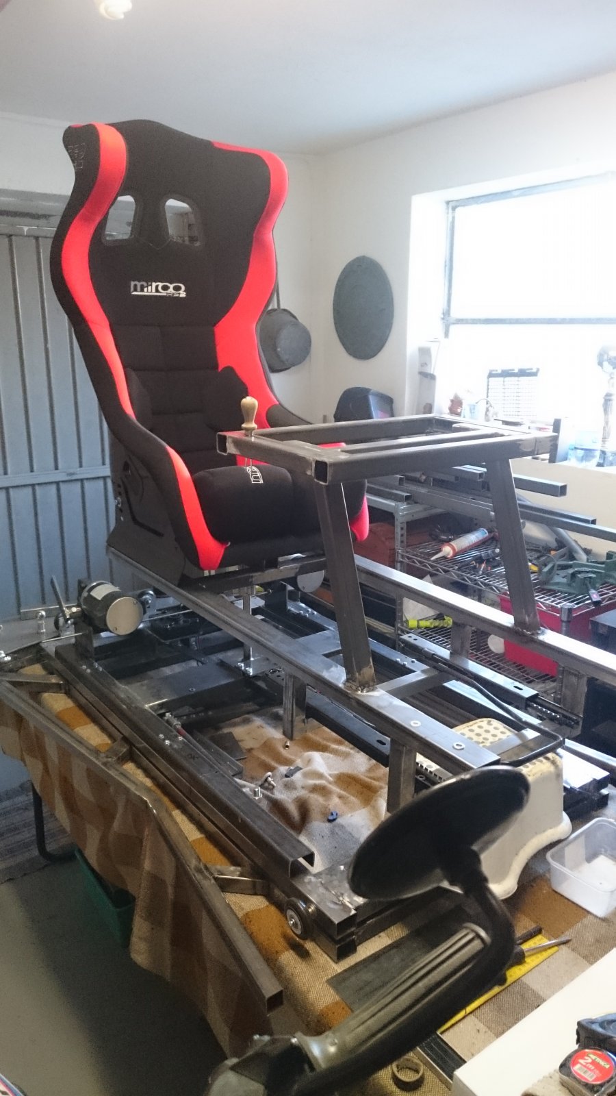

    After my first experience of a 2dof simulator, ...... only made possible thanks to the support received from you on this forum I am going now to build a 4 dof, then adding the surge and traction loss. I used to design my favorite tools ... pencil, ruler and also a compass but especially the mind, the incurable desire to build ....; my skills, unfortunately, do not allow me more
    Although fascinated by this solution with suspended engines, I decided to make a traditional 4dof, to separated from each other the surge and tl forces and the latter in turn by the pitch and roll forces. Right away I realize the complexity of this project, at least compared to a 2 dof traditional, but still want to try. In my project, probably nothing new or special but a workaround. I hope that in this case your views and suggestions can help me in this endeavor.
    The shopping list in no particular order:
    - A wife and 2 childs patient, so patient
    - Iron ... So iron ... ..30x30, 40x30, 50x30, 40x40 and 50x40 U open
    - The seat sliding slide for sliding pedals
    - 2-ZYT90-155-12 MCP4 engines 60: 1 65 rpm for pitch / roll / heave
    - 2-ZYT80-120-12 MCP4 engines 50: 1 90 rpm
    - 4 Cards jrk Pololu 12V12
    - 4 Potentiometers with 180 ° hall sensor
    - Linear guide for surge effect
    - Wheels taken from rollerblade shapely
    -Wheels trolley
    -Wheels taken from shower!
    -4 Power supplies 12v 50th
    - many others small things like cables, screws and bolts,
    -simtools and your continued support and encouragement here

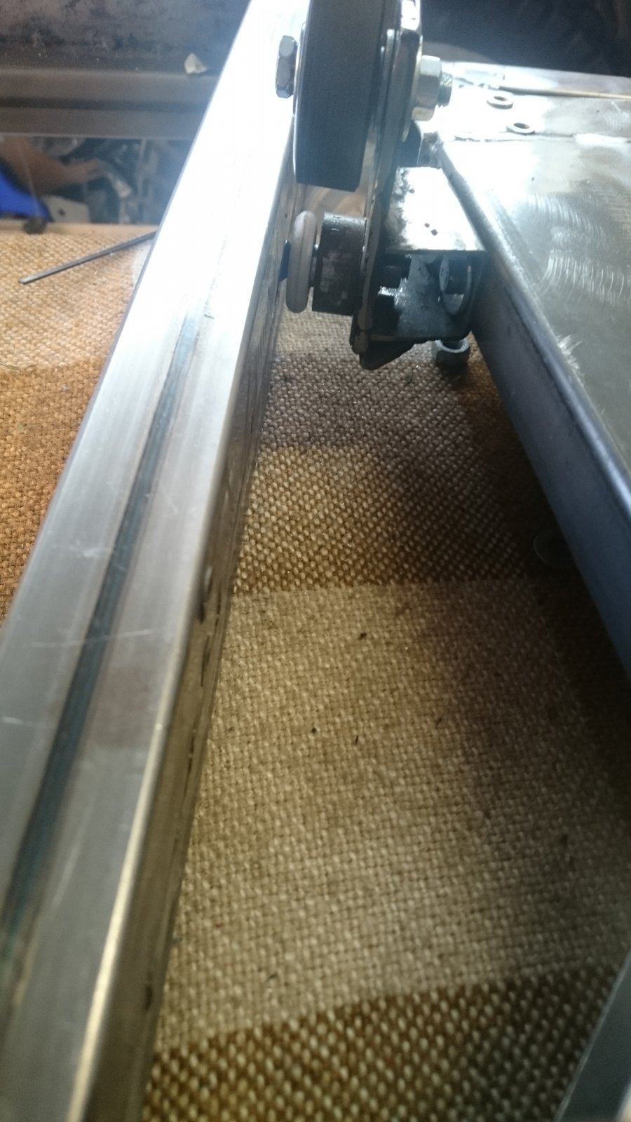

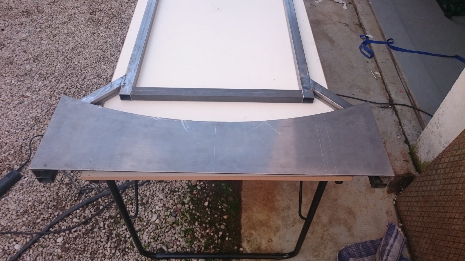

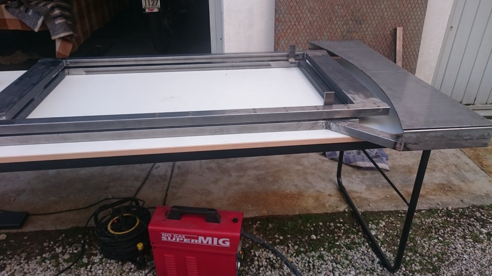

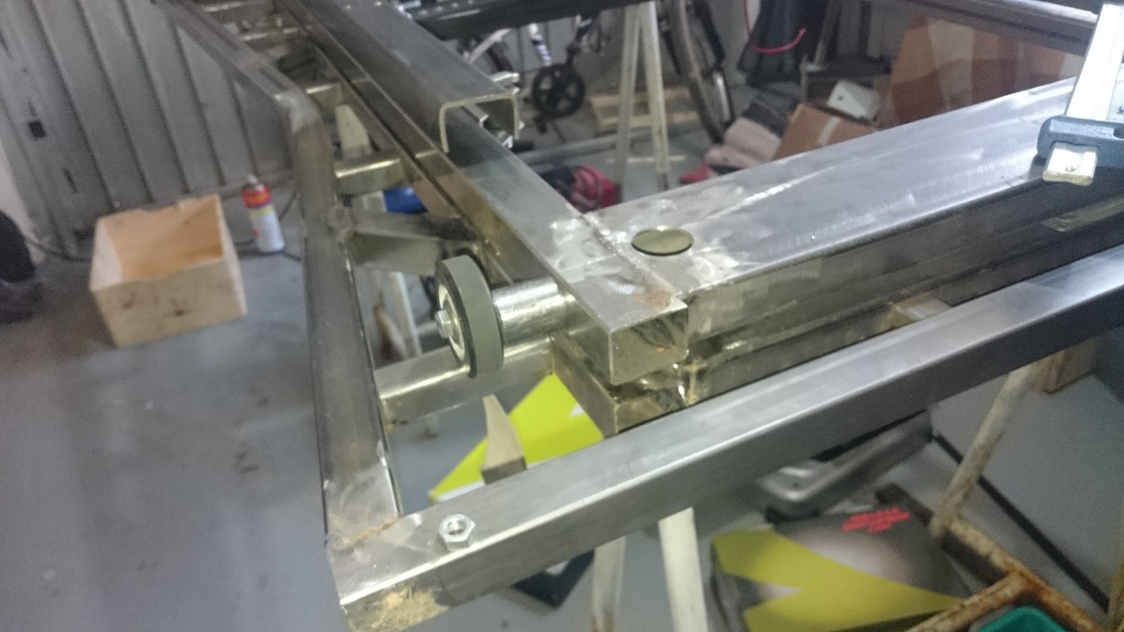

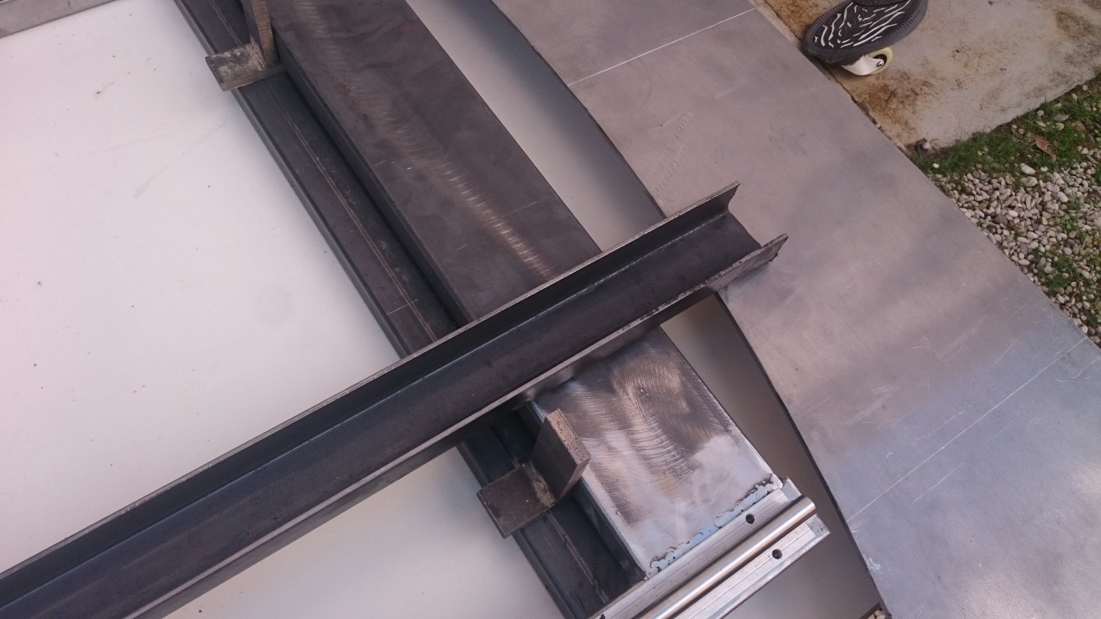

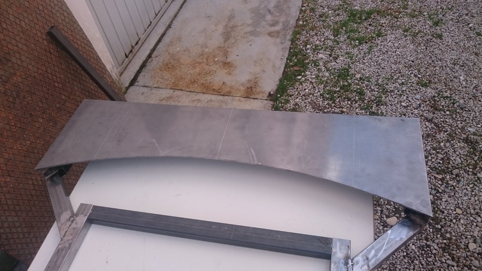

    For Tl I wanted to use the curves linear guides, but after discovering their exorbitant cost I decided to look for another solution. Then through a friend I made a 5 mm thick plate. curve above and below which the wheels run. This so because the structure remains more stable when the engine of tl kicks. Above there will rollerblade wheels of which I reduced diameter using a drill press and a file .... unfortunately I do not have a lathe, while below there will be some very small wheels of the type of those used for the sliding doors of the box shower. At the center 2 wheels of the type used for the trolley . In the front two wheels taken from rollerblading. Also a bearing ultra-flat from lazy susan. In order to better adjust the height of the wheels I made of the eccentrics. This way I can adjust the height of each wheel and thus have an optimal contact of the same with the base. As for the surge, well there is not much to say, the solution of the linear guides is in my opinion the best for smoothness and quiet operation, and also the cost gold is acceptable. Initially I had planned and bought 150mm 12mm slides with 8 sliding bearings but I want to try to use only 75mm slides with 4 slide bearings. We'll see.
    The surge will be 30 cm 15 forward and 15 back tl 30 cm 15 right and 15 left.
    The Tl curve radius is 130 cm

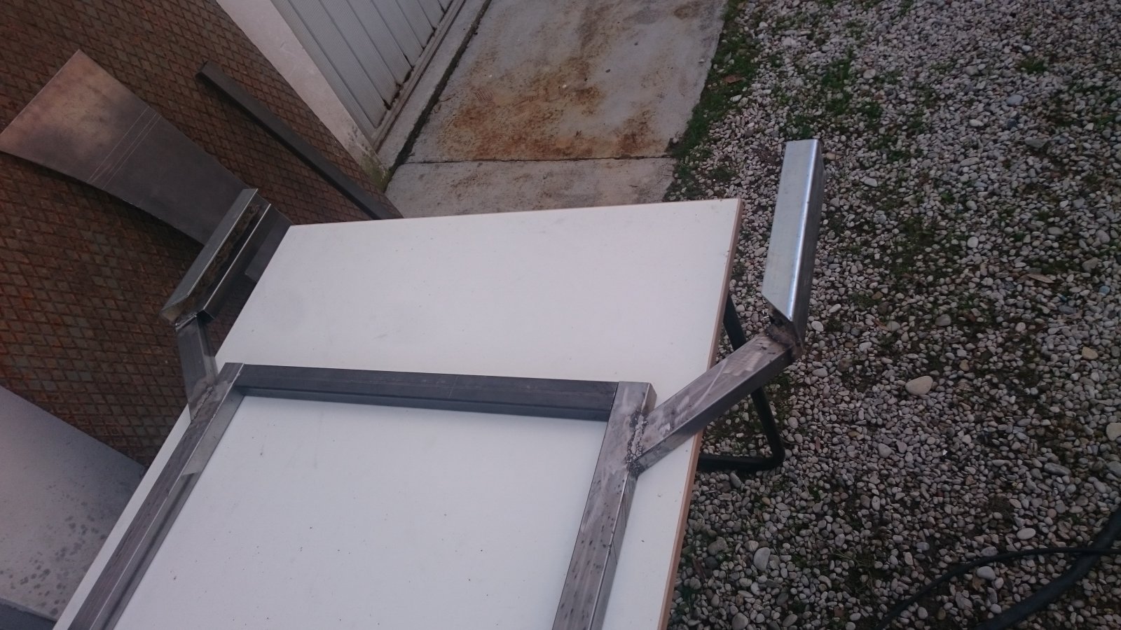

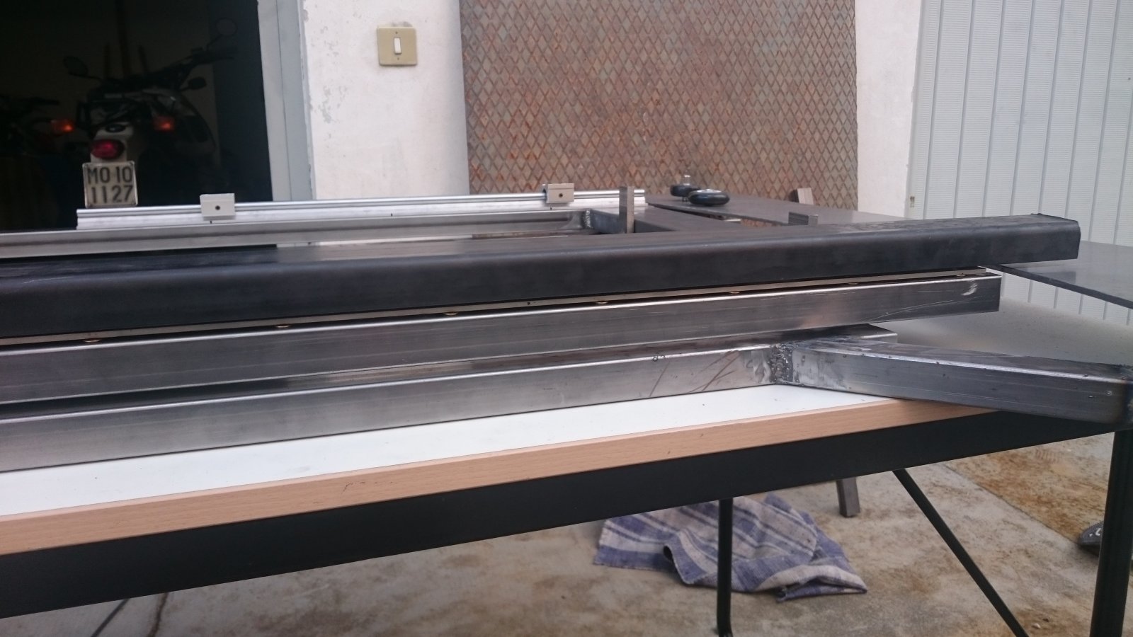

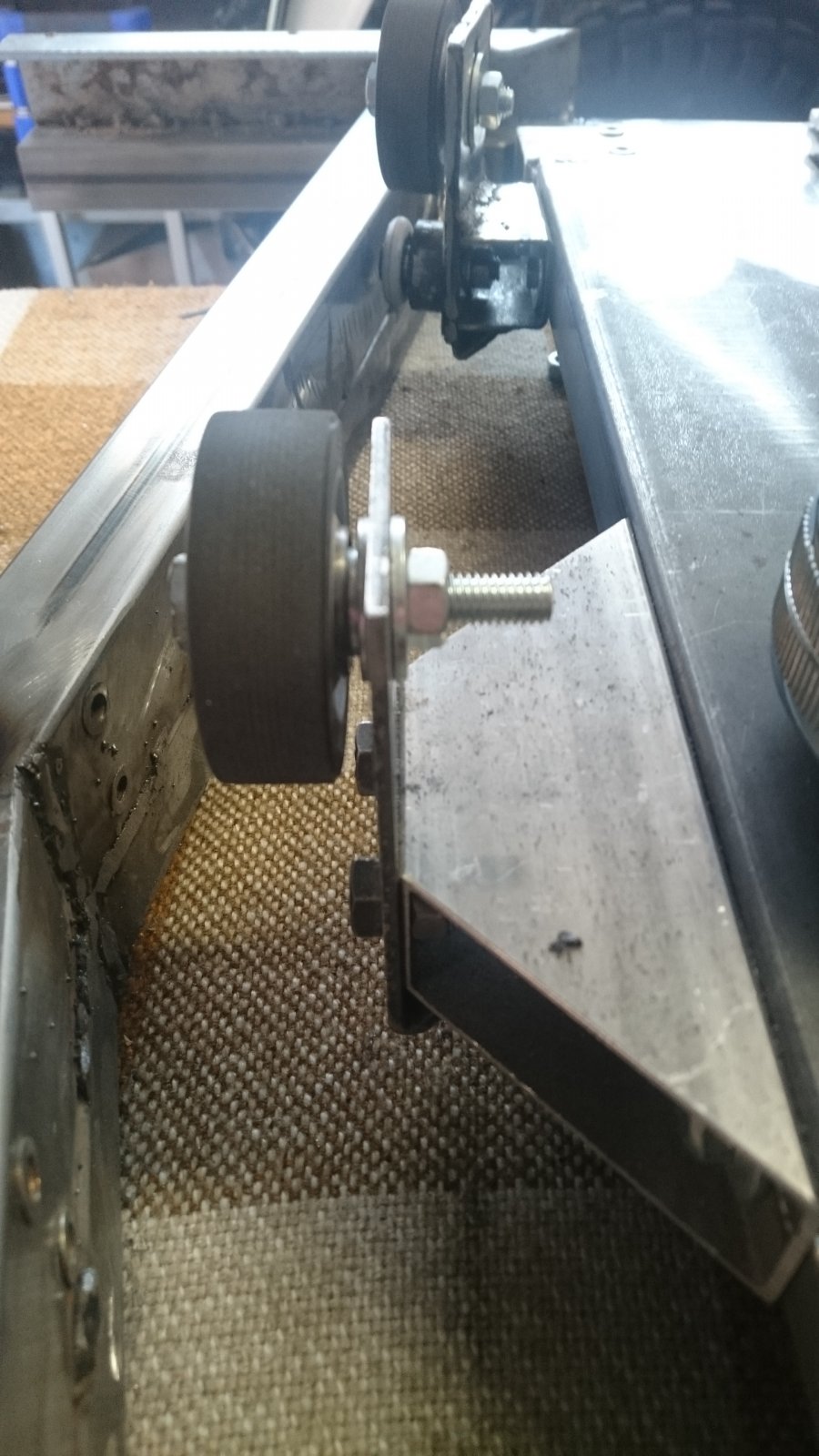

    photos in which you can see in detail the sliding system of Tl, 3 rollerblade wheel up and 2 box door small wheel under the iron plate, mounted on eccentric pin to be able to adjust

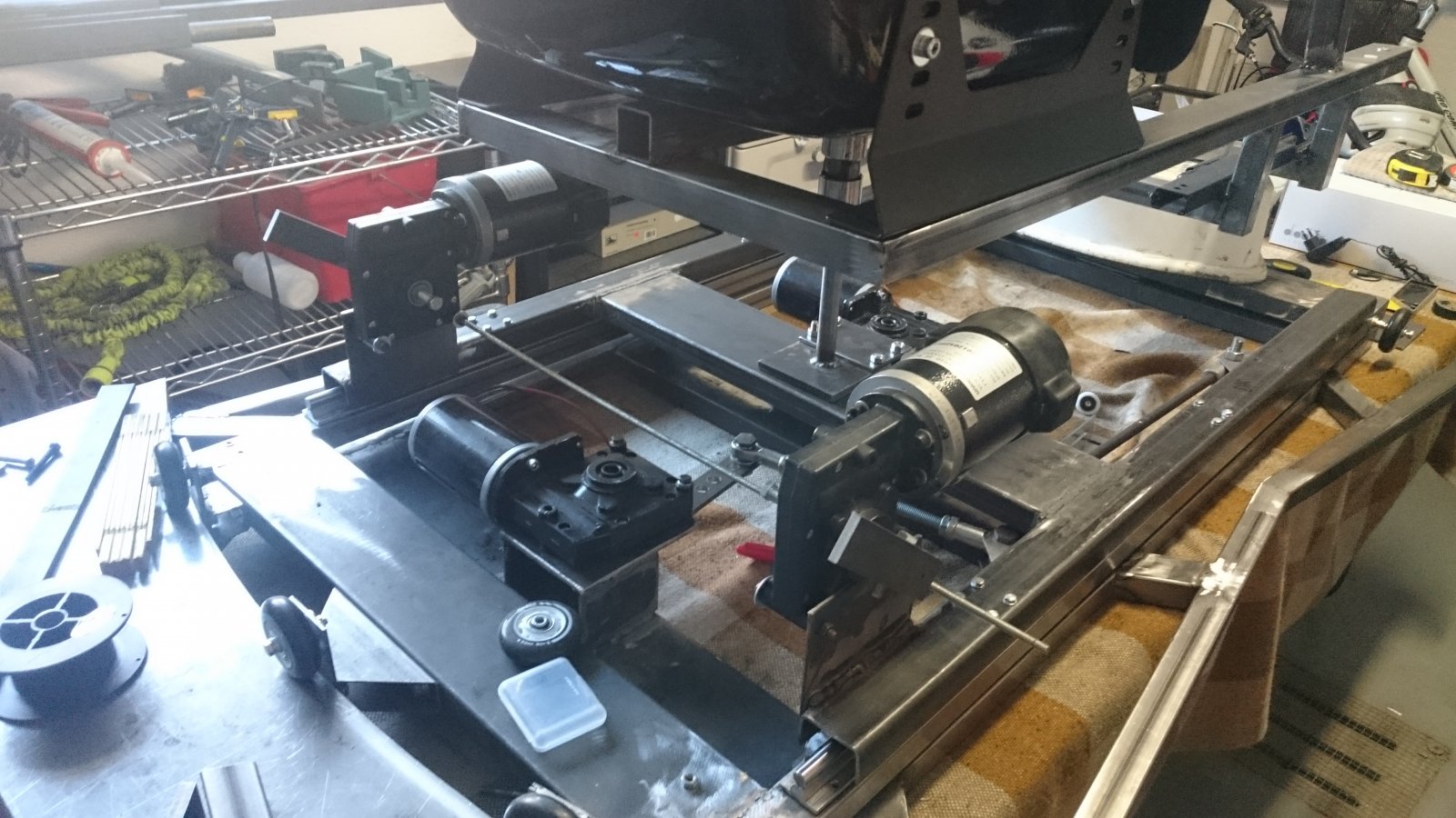

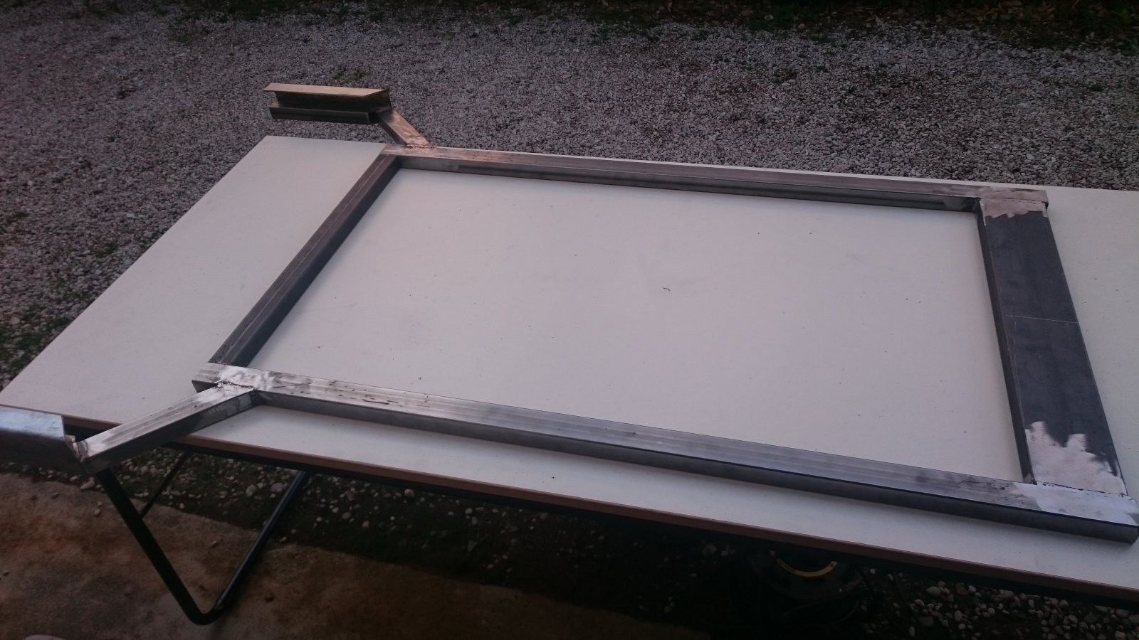

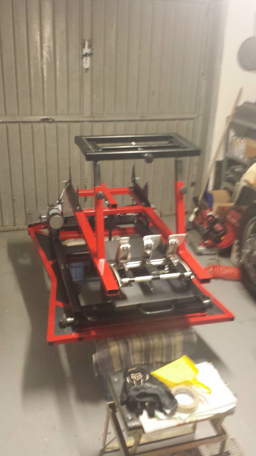

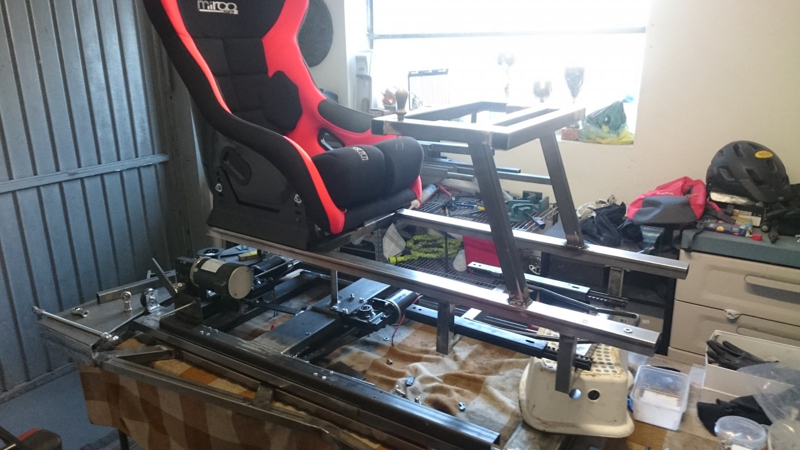

    other photos working in progress

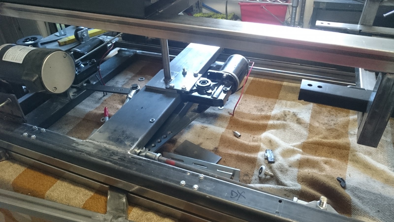

    wheel with eccentric pin for Tl in the centre of structure

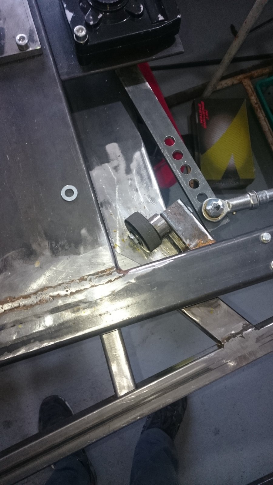

    wheel with eccentric pinfor tl in the front of structure

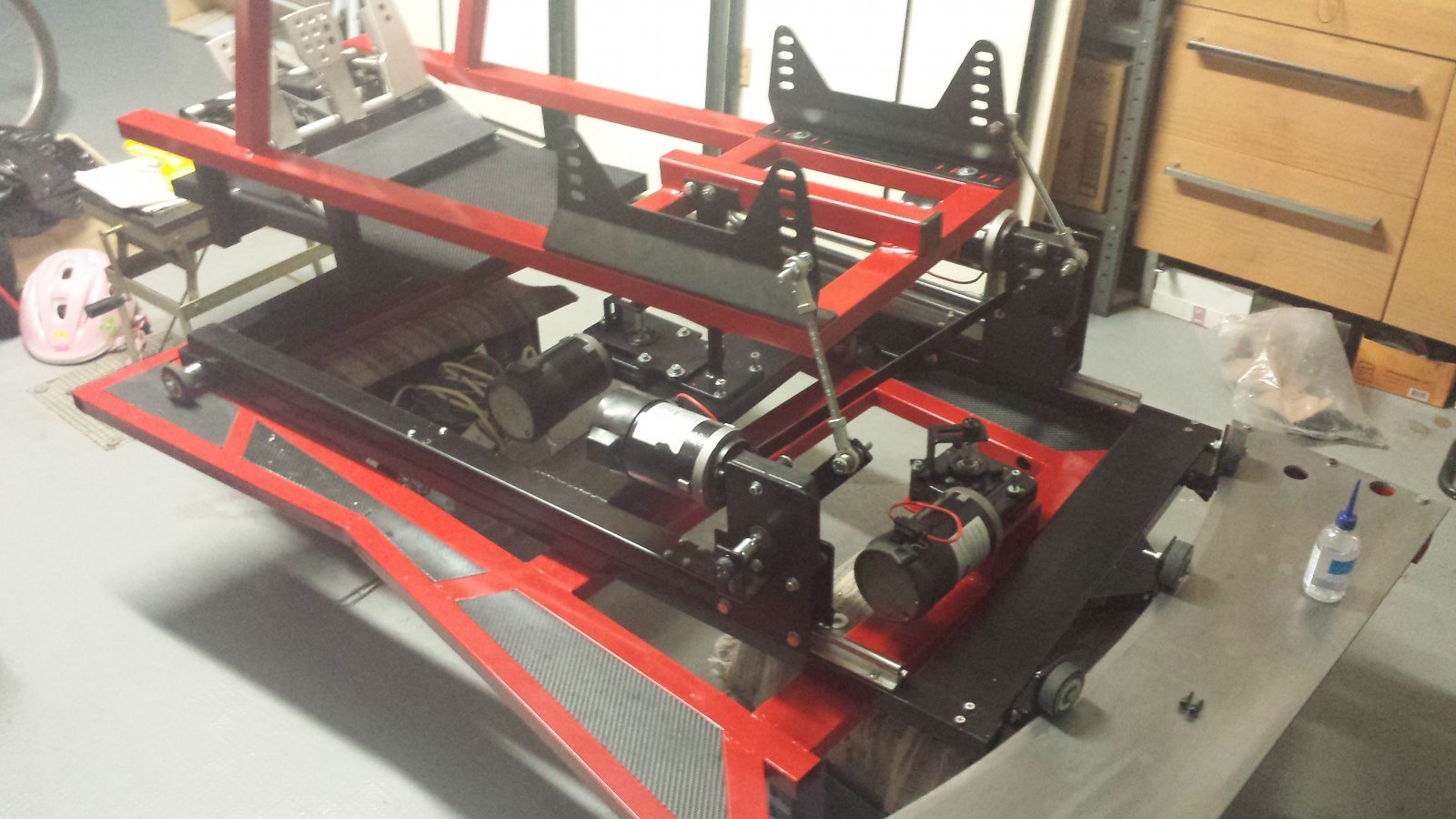

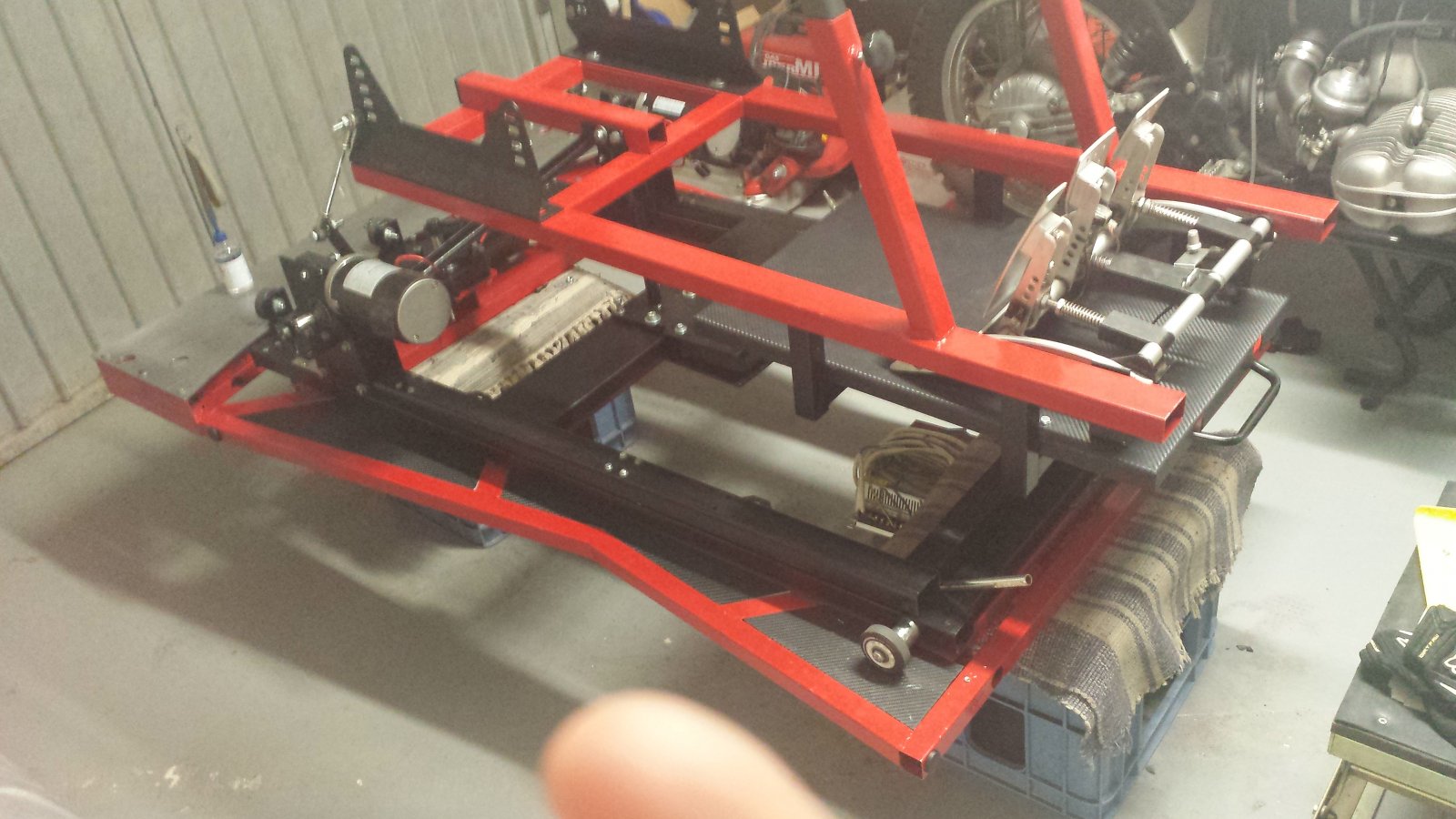

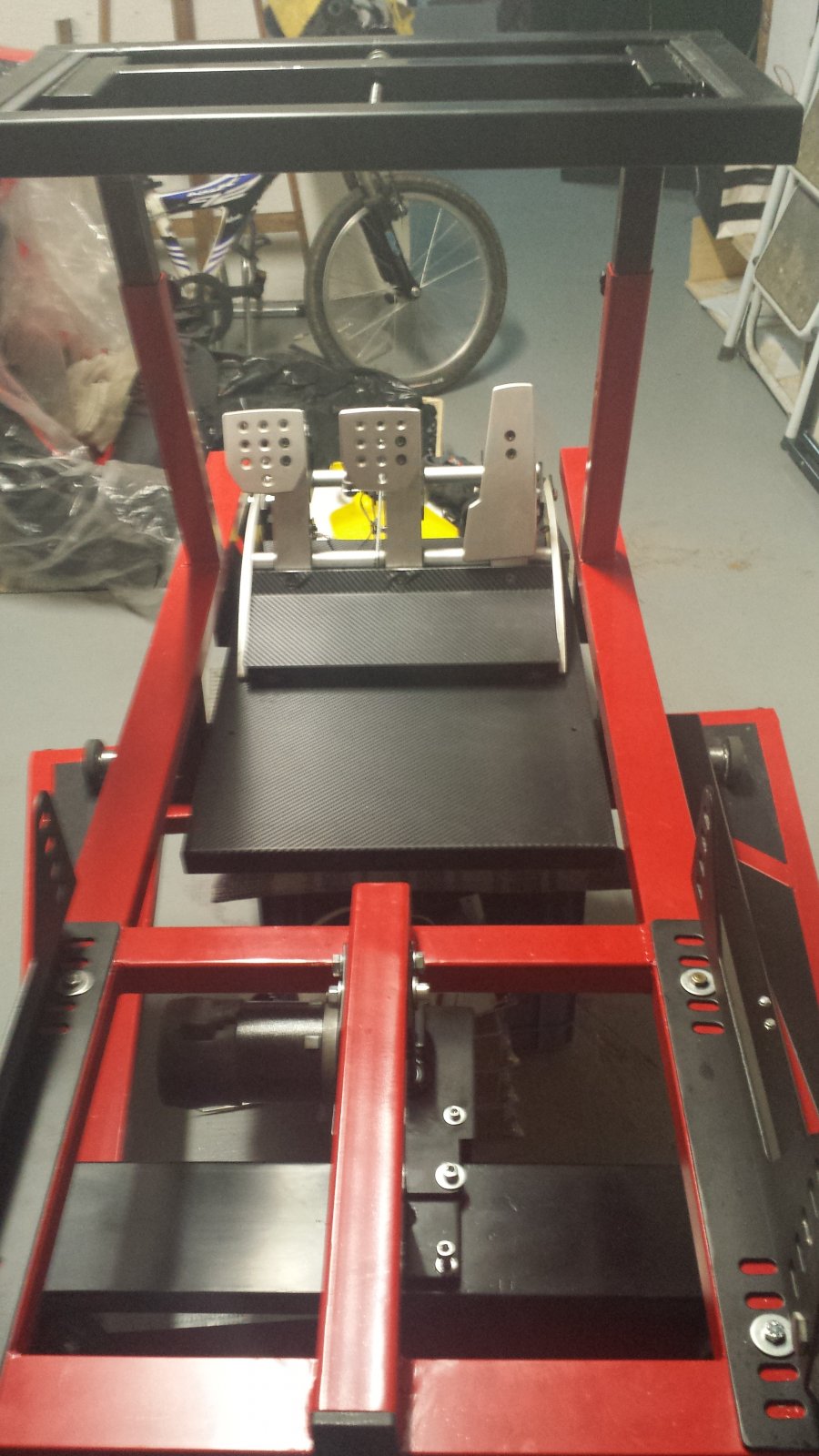

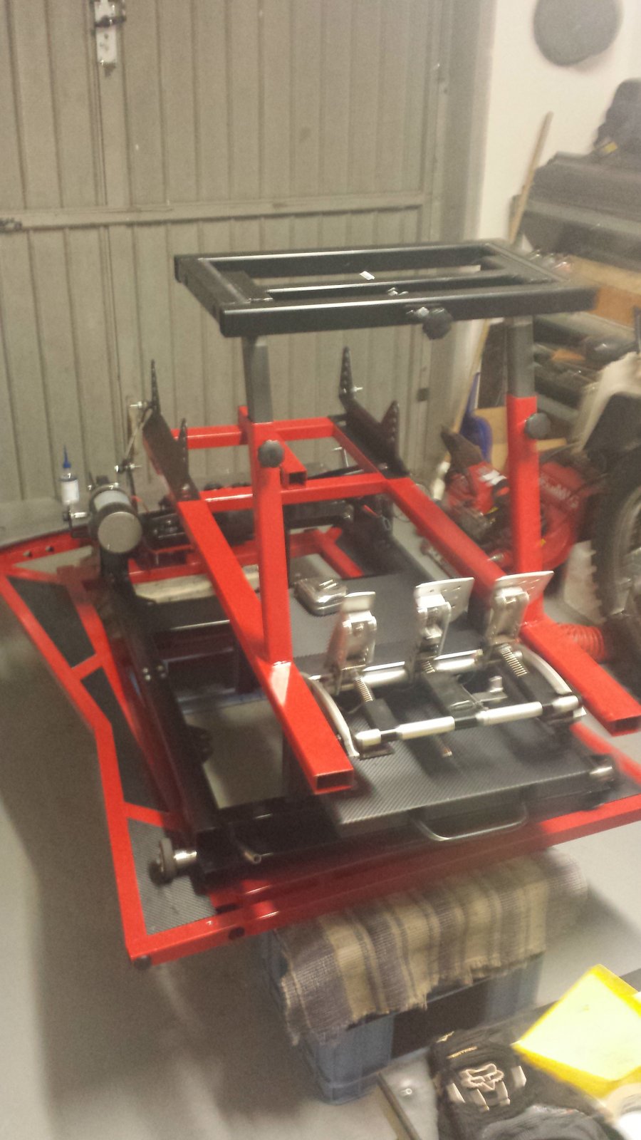

    Hi guys! .....my work is in progress, here some photos, next week I hope to post more photos and details
