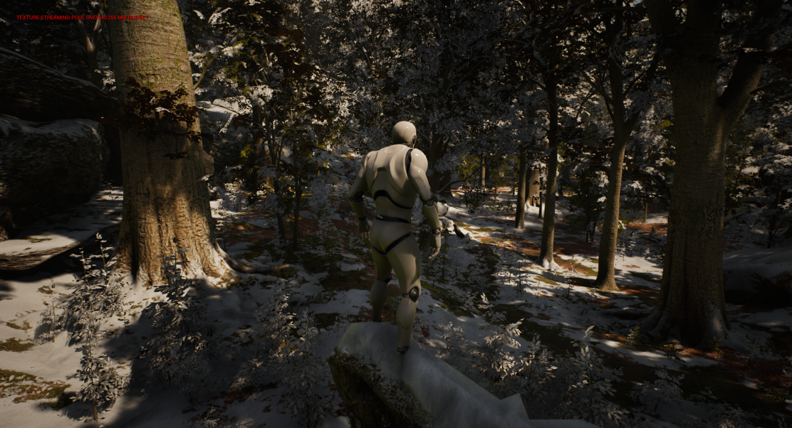

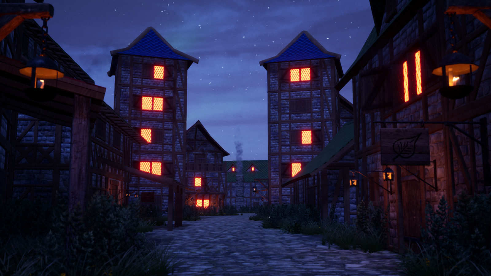

    I am developing the game in Unreal Engine and World Machine. Also credits to some amazing asset creators such as Mawi United and PolyPixel. Just keep in mind I composed a lot of scenes with assets from Mawi and PolyPixel but some of the screens are straight up what they built. However I have a commercial license on these so I can move them over to my project the way they are. Just wanted to make it clear I did not model or texture anything here.. just composed a few scenes together and did some programming. Here are a few screenshots from the game.

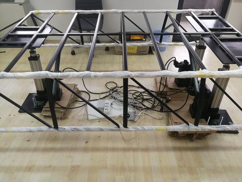

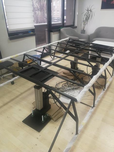

    I have already made an attempt at building the structure of it but I am not sure if the way I went is very feasible. I feel like I need a better solution. I built this little foundation just to test and play around with the motors. I am not sure if I even placed the motors correctly. Just thought a triangle position would be sufficient for a 3DOF. I might have to do slight modifications to it. Dimensions of what you see in the bottom image is a length of 190cm and width of 120cm. Distance between the 2 rear motors is 50cm and the front motor is centered in the front.

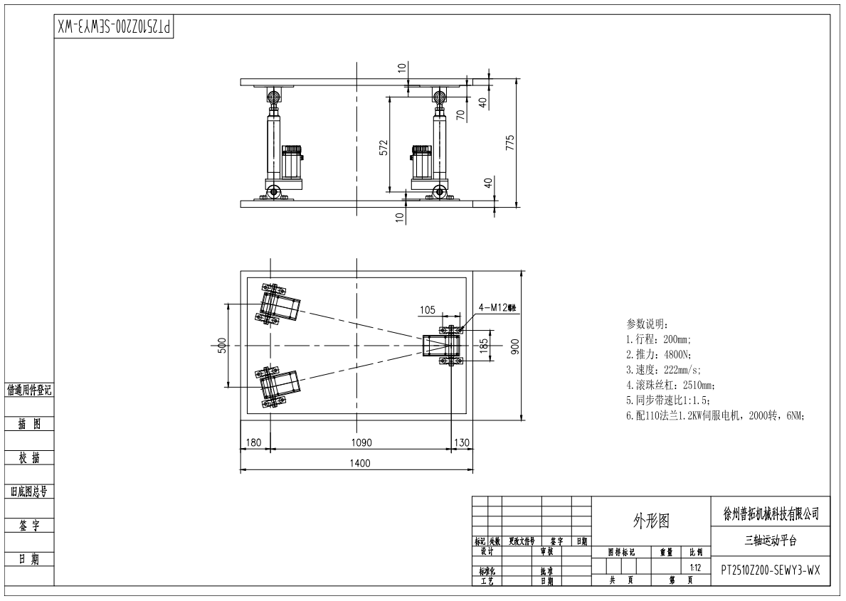

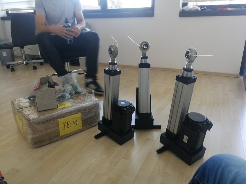

    I have these 3 linear actuators and servo motors that I purchased from a company in China. I have to say I deeply regret my decision because they cost me quite a lot and I will not be using them after this prototype. I have to decide on a new set of motors from a different supplier simply because the price of this was way too much even for a prototype. I am attaching the specifications of these right here. I will try to provide the translation as best as I can. I will edit the translations if you can help me figure out what they could really mean.
    1. Maximum Stroke
    2. Actuator Force
    3. Actuator Speed
    4. Ball Screw
    5. Timing Belt Speed Ratio
    6. Flange, Power, Amount of Turns.. (not sure what is 6NM)
    I think I went overkill with these. For a 4-seat simulator I would assume the maximum weight of everything (people + structure) would be around 500 kilograms.. unless 4 bodybuilders sit on it at the same time. Not to mention the default position of the ball-joint is 60cm above the ground which puts the frame quite high above the ground. Add the maximum stroke to that and it goes really high. I am not sure if that's viable or aesthetically pleasing.

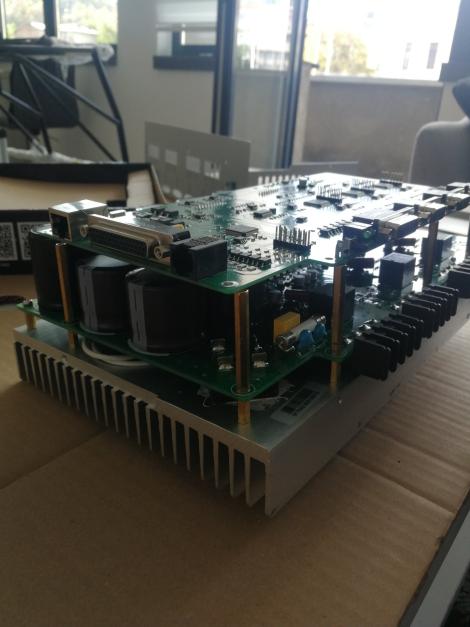

    So I would need to acquire a different set of motors. I was also given a driver called MDBOX (attached image below) to control these. Sadly none of the people they directed me to knew how to run this thing. A bunch of code snippets and executables they sent me to control them were buggy and did not move the simulator how it is meant to move. So I am not sure what happened on that part.

    Thanks for the comprehensive overview.
    Just confirming a triangle is the common arrangement for a 3DOF.
    One thing to consider though with a multi seat arrangement is the possibility of being unevenly loaded, so the rig likely needs to be powerful enough to compensate for that.
    I suspect you would probably not be aiming for as high sim speeds as are often used in projects here: https://www.xsimulator.net/community/faq/speed-needed-for-good-motion.218/

    I assume that wider the triangle is, more angles I can provide. A smaller triangle would require higher strokes to tilt the platform. For weight distribution, I have a quite strong structure and the images attached, I had 4 really big guys jump up and down on it and try to break it somehow but it didn't budge at all. I am more worried about the actuators below breaking under pressure. I need to figure out the right force required for my actuators. For a weight of 500KG, how would I calculate required force PER actuator?
    And yeah, I don't really need very high speeds, just smooth movement. It should be reactive though. I don't know what type of actuators to buy really. I saw some SCN ones on this site and they look good.
