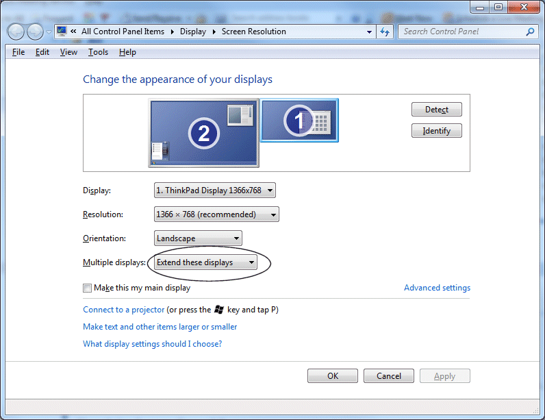

    Hi all, I am just curious about how can I use 3 monitors (frontal, left and right views as force-dynamics 401) with my motion system?...
    My actual situation:
    * 1 PC for both sender and profile.
    * My Graphic card is a Geforce 450gts 1gb with 2 video output.
    * I am using 2 monitor, one is mounted on the 3dof motion system and one is an external monitor to check the x-sim and simulator when I am not on/inside the motion system.
    * Both monitors show the same image.
    Now, how can I transform my single monitor 3dof motion stystem in a 3 monitors 3dof motion system?
    I would to mantain the external monitor too.
    Some suggestion?? Thank you all!

    AFAIK triple head works only with two connected (SLI) graphics cards of your type. You can have a try with this software solution SoftTH where you can use your old card solely for the output of the side monitors or there is also a hardware solution from Matrox. However I think for the money of the TripleHead2Go you can also buy a second card ;)
    Make sure you have selected Extend these displays in the display properties to have two different images on your two monitors. Multiple displays.gif
