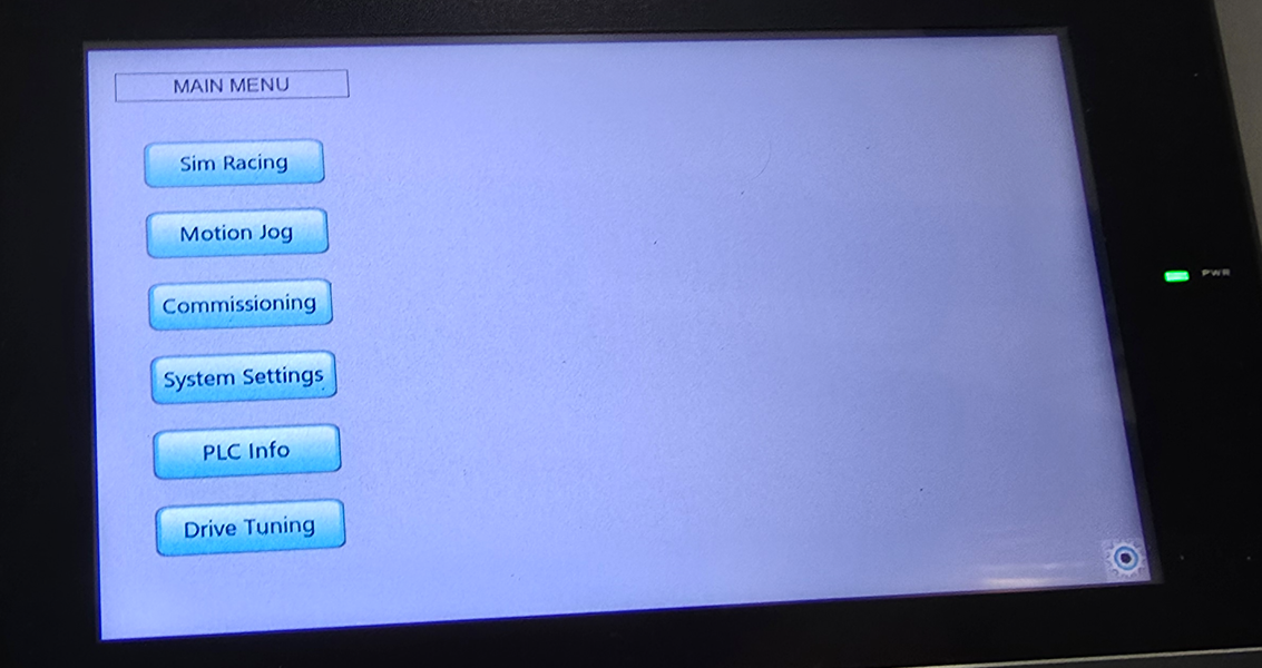

    Hello @noorbeast & @cfischer, I try to explain in simple way and do let me know if yous need more info.
    Flypt mover process motion telemetry from Assetto Corsa then send the actuator position to PLC via UDP, PLC communicates with slave drives to control servo motor movement in sychronised way.
    Here is the PLC frame i built and running. I am new and trying to figure out how upload a video here. I will post the video soon.

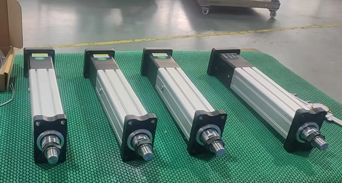

    I also see you are using industrial actuators, i also waiting for my order:grin coming next weeks
    what brand is your actuators and are you satisfied with the quality?
    will also try to setup a 3dof cornering Rig

    I use Codesys, TwinCat from Beckhoff is just too expensive for first trial rig. Some reputable brands in China have the similar function and seems works well for my rig so far, at quarter of the cost. Using these PLC requires support from PLC manufacturers if not familiar due to some technical topics requires expert's help.
    Programming is 100% manual, use ST or ladder diagram whichever easier for you. The UI also has to be from a separate HMI panel.
  10. TLRE
    TLRE New Member
    Apr 10, 2026
    8
    Engineer
    Malaysia
    63Coins
    3DOF, Motion platform
    YKD from China, so far so good, never has problem, still survive from serious jerk during code development.
    Yours from Europe or China? Interest in the pricing

  12. TLRE
    TLRE New Member
    Apr 10, 2026
    8
    Engineer
    Malaysia
    63Coins
    YKD brand actuator from China. Interested to know where @Motion4Sim got the actuator from.

  15. Motion4Sim
    Motion4Sim Member
    Jun 13, 2020
    93
    Europe
    747Coins
    +113 / 1 / -0
    thanks for sharing i ordered KNK motion china brand , localy there is nothing available at this range of price
    everyone else interested into such actuators i used alibaba to order , little tricky to order the rigth one fitting to the drives.
