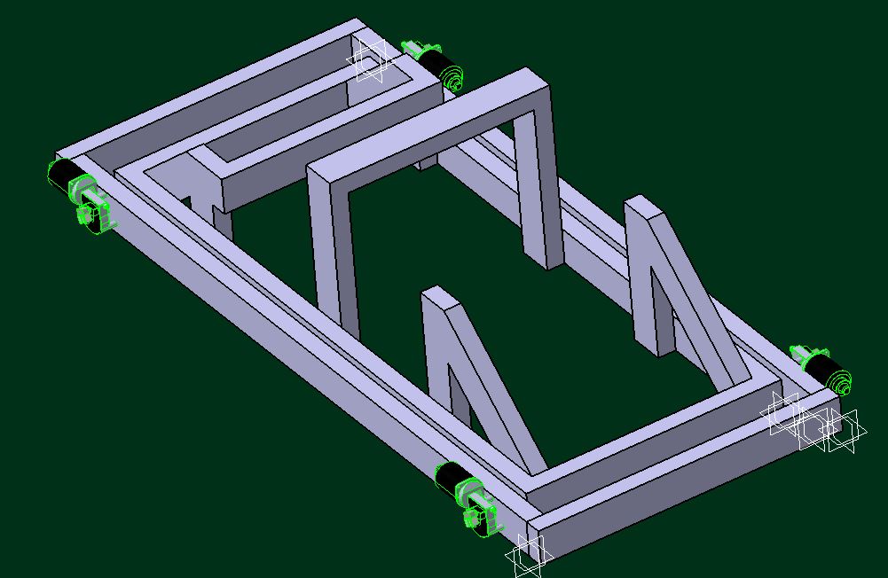

    So I keep throwing around ideas in my head of how I might like to make a sim rig and I keep coming back to a D-Box style setup that moves the 4 corners of my full frame. Seat movers seem less complex on one hand (only two actuators), but more complex on another (u joint at base, balance important, etc). My rig is super cheap, but fairly rigid. It only cost me about $5 for the few bolts I didn't have as I had the spare 2x4s and karting seat already, so there was no cost there. It seems like it would be very well suited for actuators on the 4 corners, but the D-Box setup is prohibitively expensive for what I'm willing to spend.
    My current idea is putting a wiper/window motor or something of the like at each corner like a D-Box actuator. I realize this would normally be an issue as 4 window motors would typically not like supporting the ful weight of me and the rig off the ground, but then I got the idea of "why does it have to?" My thought is that the rig would normally rest on the ground and the motors would only lift it during telemetry events. They might have to fully support the weight for brief periods (like hopping a bump or something), but these would be fairly short transient events. I would likely lose resolution for high frequency events and things like road noise, but I have a bass shaker on the seat to help fill that gap.
    Is this idea crazy? Has anyone tried anything like this before? Seems like the worst that could happen would be reduced feeling on bumps so I only really get roll and yaw, but I think that might be enough for me at this point.

    You would be wise to consider some type of spring assist to help counteract the load to be moved, wipers are not very powerful.

    For what it's worth, I'm guessing the full rig with me included is probably only ~250 lbs. Though I agree wiper motors aren't the most powerful thing ever. I was hoping to find some specs to see what I could come up with regarding their strength. Maybe a wiper motor wouldn't be the best solution either, but some kind of motor/gearbox combo at each corner was the idea at least. I was thinking of SCNs originally, but they would be right on the edge of their ability if I got high power ones. I find it odd that there is no real alternative actuator to a D-Box. Not sure what sort of magic dust they sprinkle on them to get the power and speed they have over just about anything else out there.

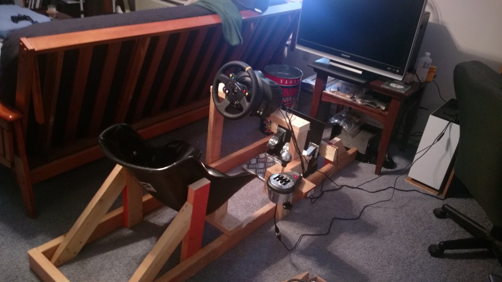

    Hmm, those are a slick setup in a nice little package. Does yours actually "float" off the ground so to speak? Seems like with high ratio gearboxes and powerful motors you could actually support the load of my rig fairly easily without burning up motors that bad.
    As a reference, not that it's a terribly good picture, but this is what I'm working with. Thrustmaster TX wheel with the T3PA pedals and TH8A shifter. I think it was maybe 4 12 foot 2x4s to make the whole thing, so super cheap but pretty dang sturdy.
    Have you got a picture of your setup? Does it "float" at the neutral position? I would think with the kind of power you have that you'd have no problem support the weight. I could probably use motors half that size and still move mine around fine.

    I see what you mean. There would be a little more "programming" involved to get more of the forces involved, though I think that would be fairly straightforward (again, I definitely need to look over the software some more to really understand its capabilities before committing to buying anything). I had the same problem with bass shakers where I wanted independent channels for two different shakers, but it seems that's not nearly as readily available in the form I wanted in any software out there (ie. program X telemetry to this bass shaker channel and Y telemetry to that bass shaker channel).
    As far as elevating the platform I had a few ideas. Originally I was thinking about it mostly being a tilt rig where the platform would sit on the floor with the motors beside it and it would only have upward motion (so sitting level would be my zero point and negative motion would be excluded), though I realize this would remove quite a bit of the motion. My plan is still to mount them on the side of my frame though, so I would still be quite low to the ground. I picture almost a direct couple between the motor lever arms and the frame, so no extension rods like a seat mover for instance.
    I mostly don't like the u joint setup just because I have such a long frame and I'm just not that keen on the whole thing sitting on one point. It's hard enough to get in and out of the thing now (I know, it's my own fault since I built it), but having the whole thing leaning when "off" just seems like it would be a hassle. I suppose gas shocks or springs could help with that some though.
    Motor power is certainly my main concern. If I was just tilting the rig (zero at the floor) I'm not sure I'm that worried, but if I try to support the full weight so I have bi-directional travel I can see why this idea isn't very often used. Sitting 4 motors at stall essentially to hold the weight up is a good way to burn them up, but I'm also wondering if I can't take a lot of that load off with clever gearbox selection. If I can get a gearbox that locks against back-driving with enough ratio then the motors would see next to no load for static weight suspension, though they would still have a moderate amount to move when commanded.
    To make a platform mover I'd pretty much have to redesign my whole setup, so that's one reason I'm avoiding it as a first plan of attack. I've been trying to do baby steps to figure out what is "enough" for my taste (which will probably ultimately never happen shy of driving a real car, lol). Started with just a frame to hold the controls in a "car-like" setup, then added some bass shakers to get a little feedback. Added the Oculus hoping that would be the magic bullet, and while it has made things much better, I still wonder what it would be like with actual motion. Would be great to try one out before committing to anything, but not sure there is anything around me to demo (Kansas).

  20. Map63Vette
    Map63Vette Member
    May 19, 2016
    128
    Mechanical Engineer
    Lawrence, KS
    436Coins
    +31 / 0 / -0
    So what exactly do you mean by there's no way to do a D-Box style setup with wipers? This is what I had in mind. I would build a perimeter frame to hold the motors and have the lever arms between the two frames. I would likely still have to do some kind of tie rod instead of the direct connect I was picturing originally due to needing some misalignment to allow the frame to articulate without binding, but that seems easy enough.
