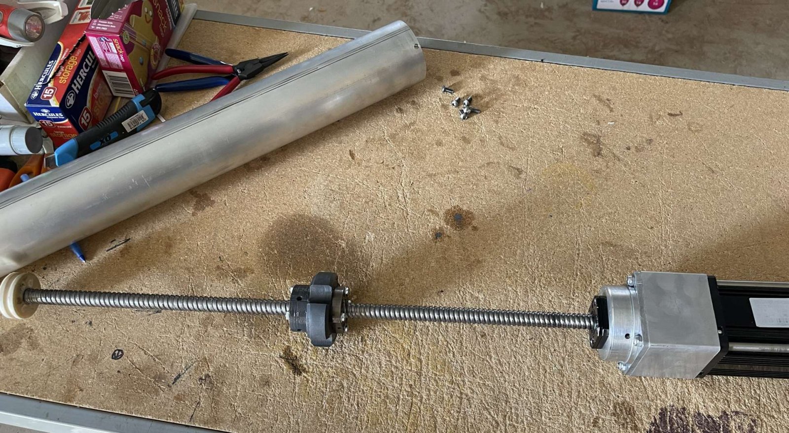

    1610 650 ballscrews
    1019 coupler
    FK12 bearing
    80ST-M02430 220V 750W AC Servo motor and controllers
    Thanos controller
    80mm Aluminium outer tube
    50mm Stainless inner tube
    80mm Aluminium square tube
    Top bush and piston guide made from MOS2 nylon

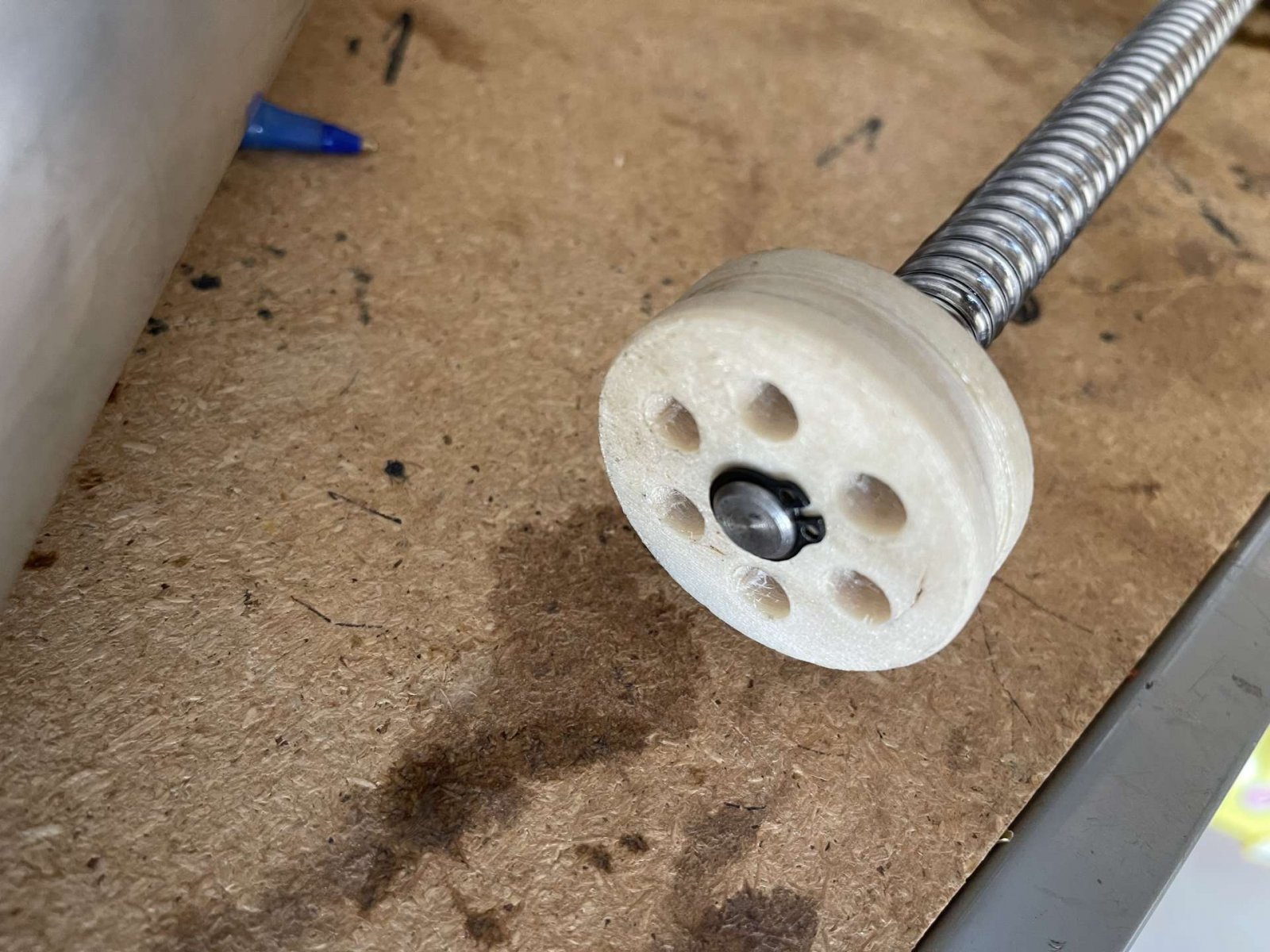

    Ballscrew end support, 3D printed in nylon.
    Lots of nuts and bolts!

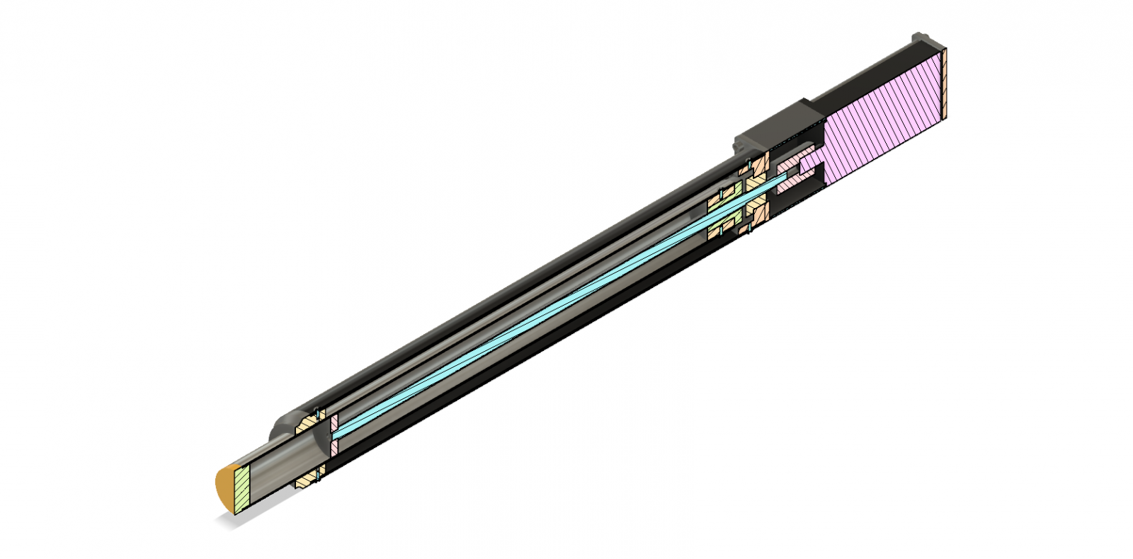

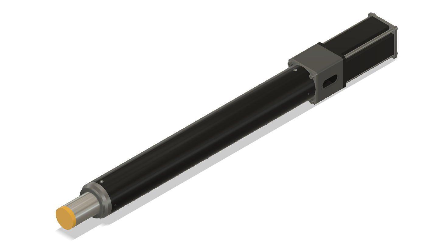

    Here is the basic design in CAD. A few dimensions have changed along the way, but its basically the same.

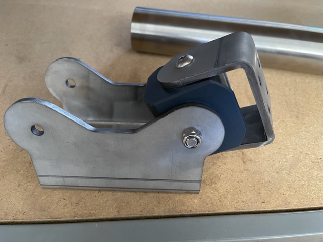

    The design can rotate, so I will use a clevis style joint at each end.

    I wanted to make one actuator first, to make sure everything went together and worked. (Excuse some of the bolts, these are temporary.)
    Here is the first video. Seems to work ok. Sounds a bit loud on the floor, although it isn't quiet when moving fast.

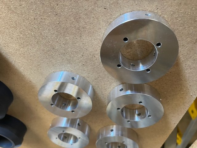

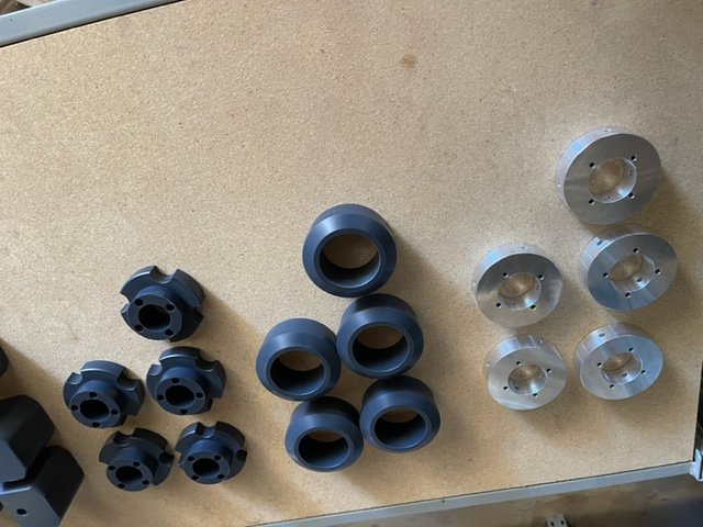

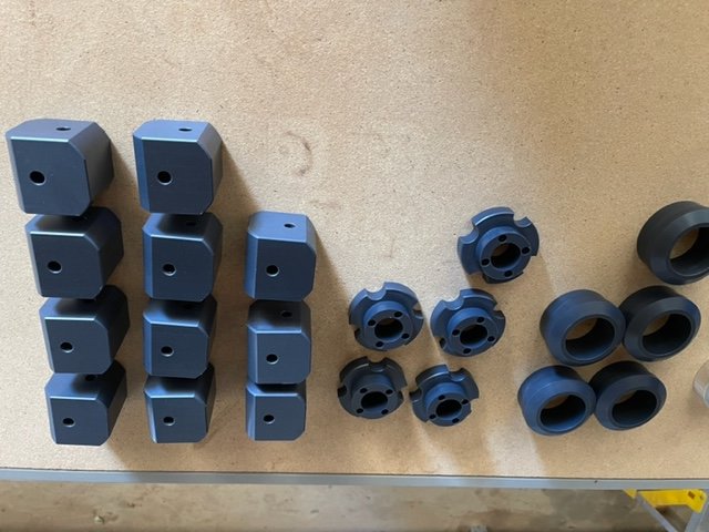

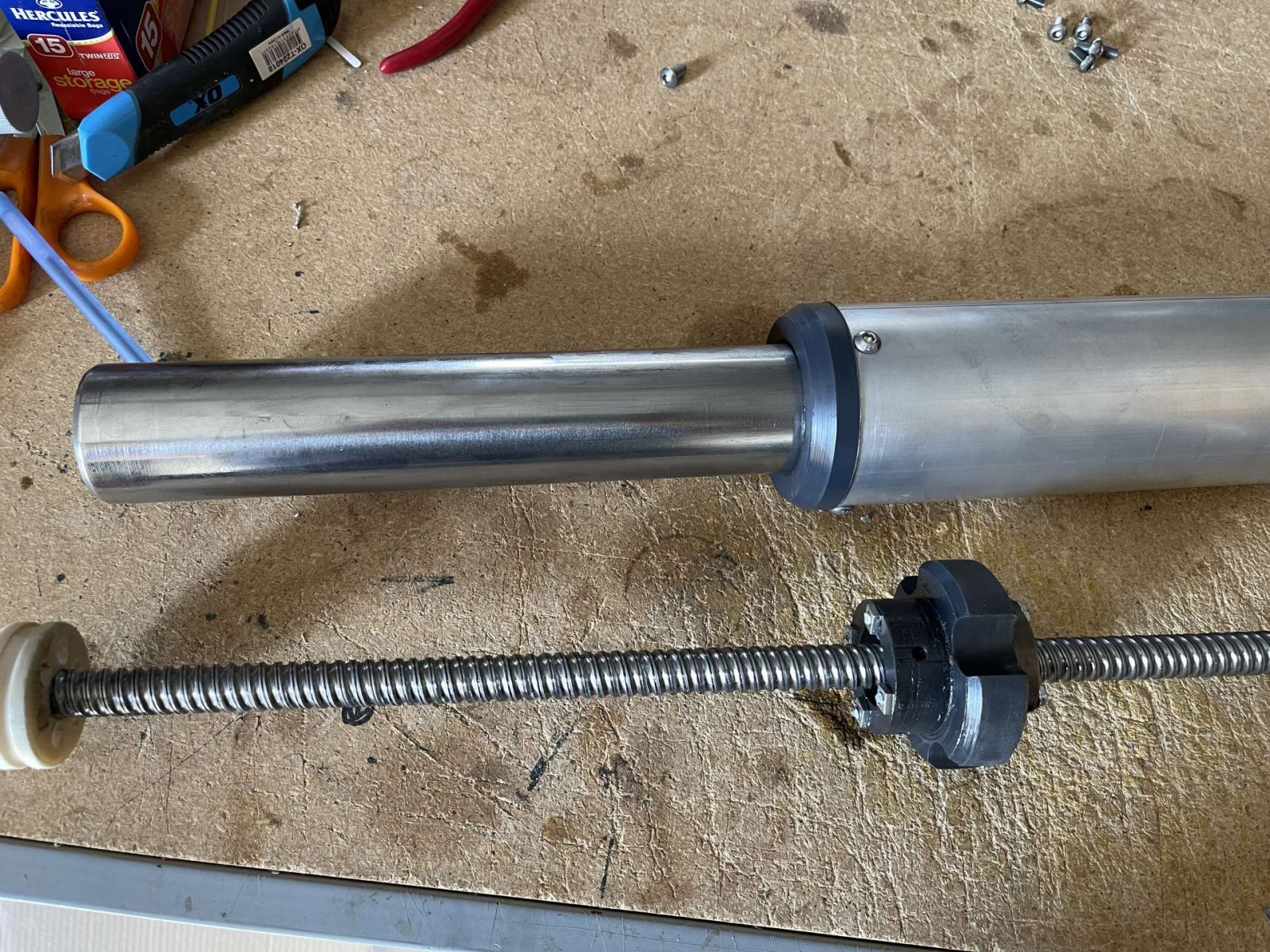

    Here are a few more photos.

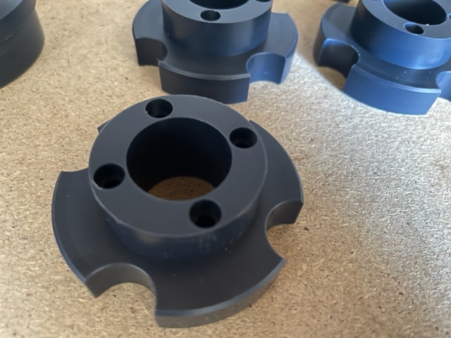

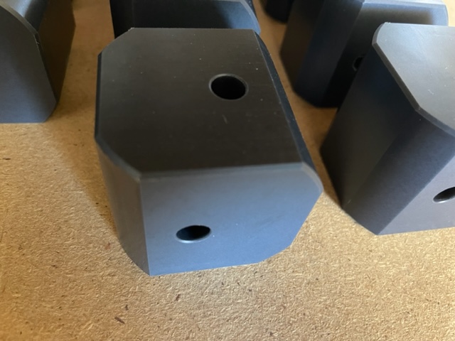

    I had quite a few parts made in China. Quality was very good, better than I expected.

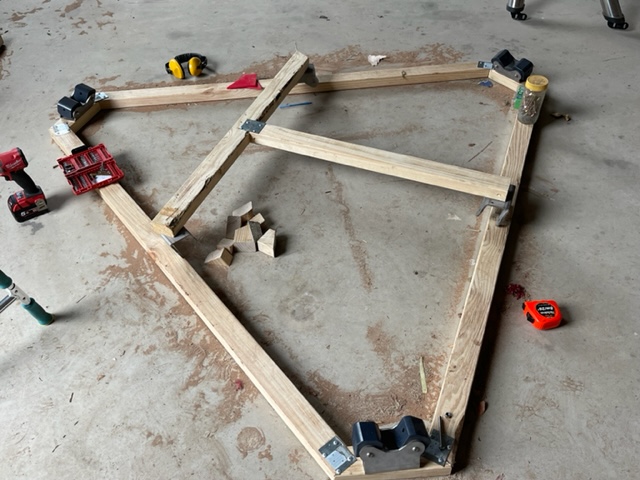

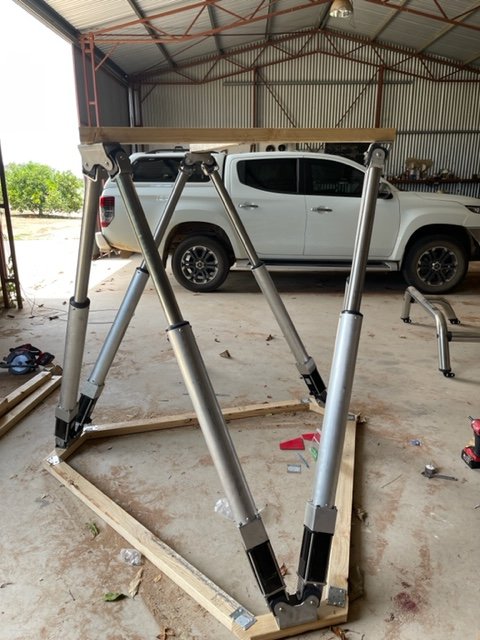

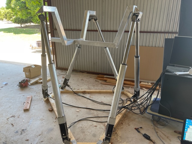

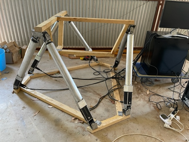

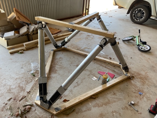

    I built the frame from wood to check clearances and to see if things acted as I hoped.
    • Like Like x 5

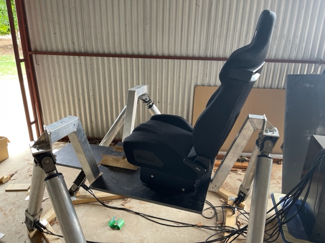

    Found that there really wasn't as much room between actuator pivot points on the base as I wanted. Moving them further apart allowed for more clearance of the pedal area during yaw, and the added bonus of making it easier to enter and exit the rig.

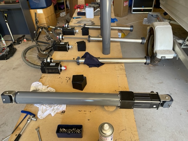

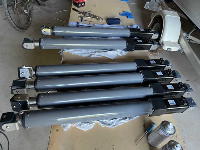

    Here area some assembly pictures of the actuators. Painted them in Audi Nardo grey.
    • Winner Winner x 3

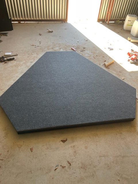

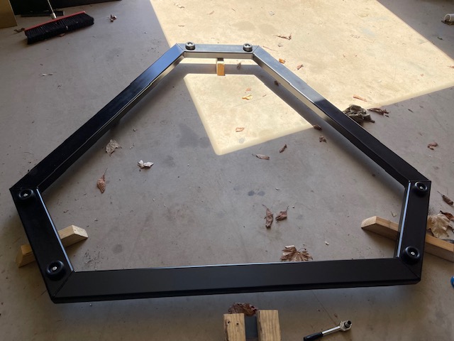

    The base is made from 100x50 steel, I think 6mm thick. It's HEAVY, and I needed to make a little dolly up to move it around. :)
    I used 17mm plywood to cover the top and carpeted in marine grey.

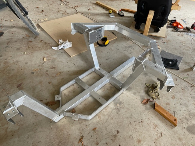

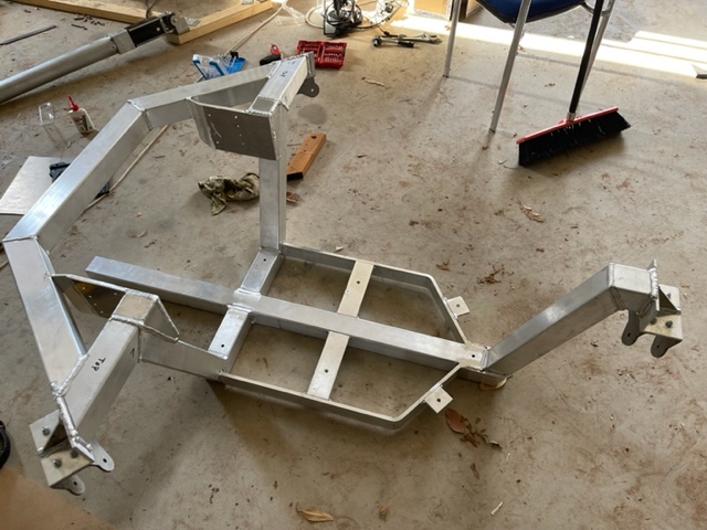

    Decided on building the top of the rig from 65mm square aluminium. Seems strong and rigid and weighs about 9kg on it's own.
    I was worried about designing with a single centre beam, and now wish I had gone with two spaced apart.
    Thinking of using a below floor joystick mechanism, but there is no room without modifications.

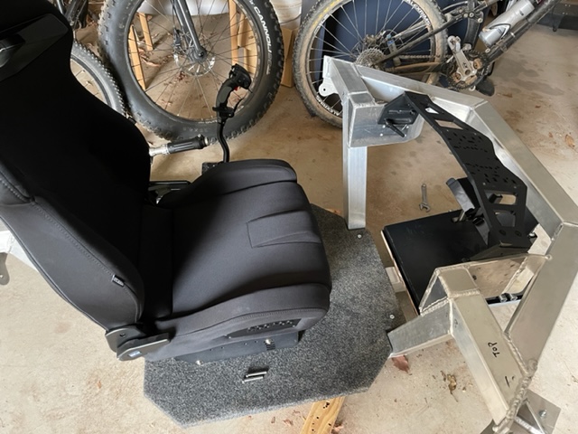

    Some pictures of the chair. Changed from Sparco Circuit 2 to a Sparco R333. Mainly because the circuit was very restrictive when looking to the sides with VR headset on. And also difficult to work a collective on the side. Happy with the choice so far. Plus I ended up putting an adjustable slide on the bottom.

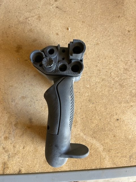

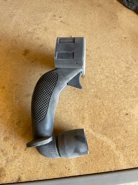

    Side project is building a heli cyclic. Lucky to have my own SLS 3D printer so made the handle from nylon 12.
  10. Jamie Wilson
    Jamie Wilson Member
    Apr 30, 2021
    41
    285Coins
    +37 / 0 / -0
    Another

    You have your own SLS printer and an aluminum welding machine?!? Nice! I wish I had half your toolshop. Usually, whenever family ask me what I wish for christmas, I say: "Aluminum welding machine and a CNC" :-D I wonder why I havent gotten one yet?!? ...got plenty of socks though.
    Why didn't you print those parts you got made in China (POM?) from PA12? Should be way strong enough.

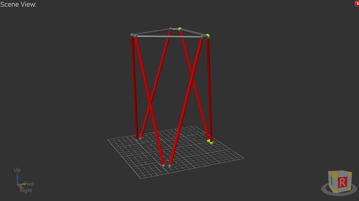

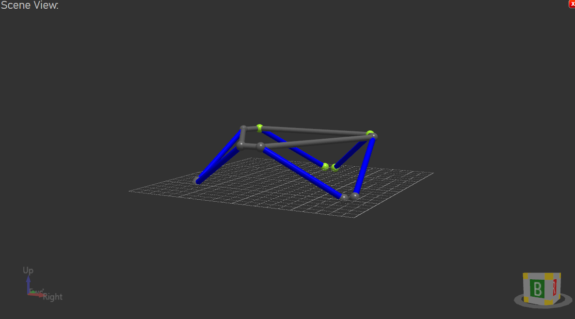

    One thing I noticed: Try not to let the angle between the actuators get too pointy. Ideally you would want them to be around 90° in the standby position but that will naturally vary during motion. The pointier you have them, the less rigidity you get in surge and sway. If the angle gets too large (like >120° or so) on the other end, you might end up with less rigidity in heave.
    Here's two drastic examples:
    Very little rigidity in surge/sway
    Very little rigidity in heave
    Will follow here :)

    Thanks Dirty for your valuable input.
    I'm working on a revision and thanks to your Rig-O-meter, I'll move the lower points closer together. It actually shows slightly better symmetry with roll and pitch front and back.
    Cheers

    Hi @Jamie Wilson, thank you for sharing your work. I'm also starting to build mine. I'm in the state of collecting informations from contributors. So I made my choice for AC servo motor like yours and other contributors.
    For the actuator, I like your design but I'll mount the motor in parallel like @pooh did to gain space. I see that you use the same universal joint as @PeterW and in my thought it's the best solution. So I'd to ask you how did you get them from china? What is the material of the black joint? POM? What is the thickness of the U-shape?
