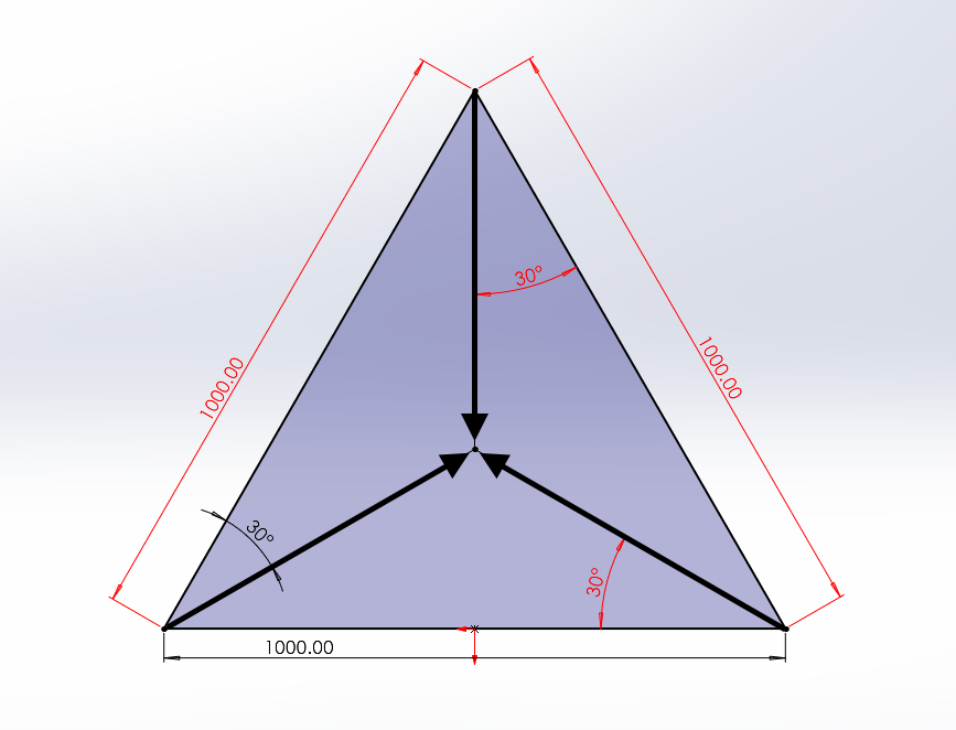

    Hello everyone,
    I have a question about a 3DOF stewart platform.
    As you know a 3DOF Stewart Platform is a simple equilateral triangle, with all equal sides and all equal angles. This provides the platform with equal motion in all directions.
    Right now, due to design limitations, I cannot place an equilateral triangle platform beneath my cockpit.
    Is it safe to have an isosceles triangle, as in, 2 equal sides and 2 equal angles, with the third side being unequal. What would be the disadvantages of such a platform? And most importantly, is such a platform safe? Is there any risk of the platform falling over due to not being able to lock itself in place?

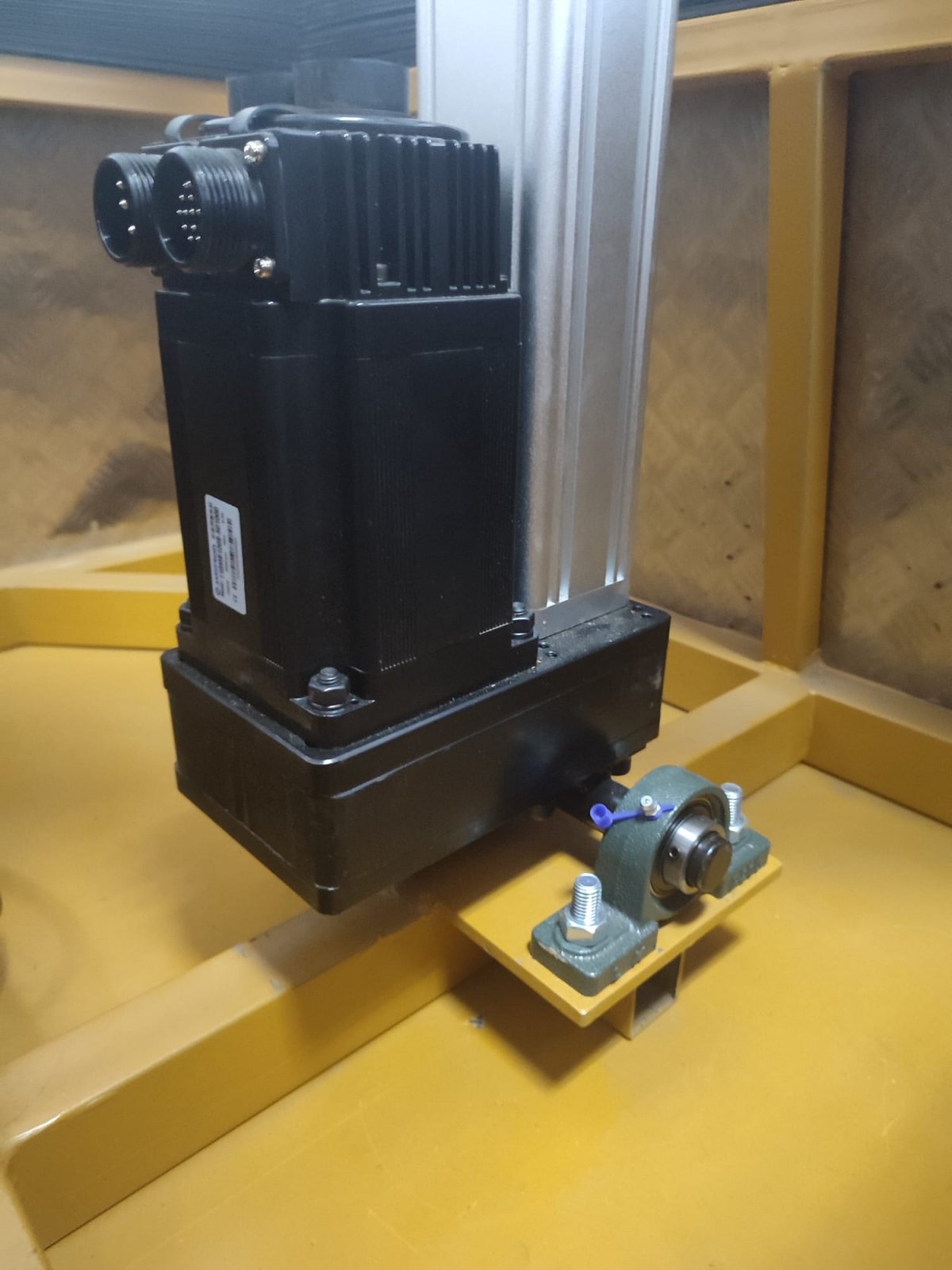

    I have industrial bearings in my actuators that allow it to rotate, providing a little bit extra freedom.
