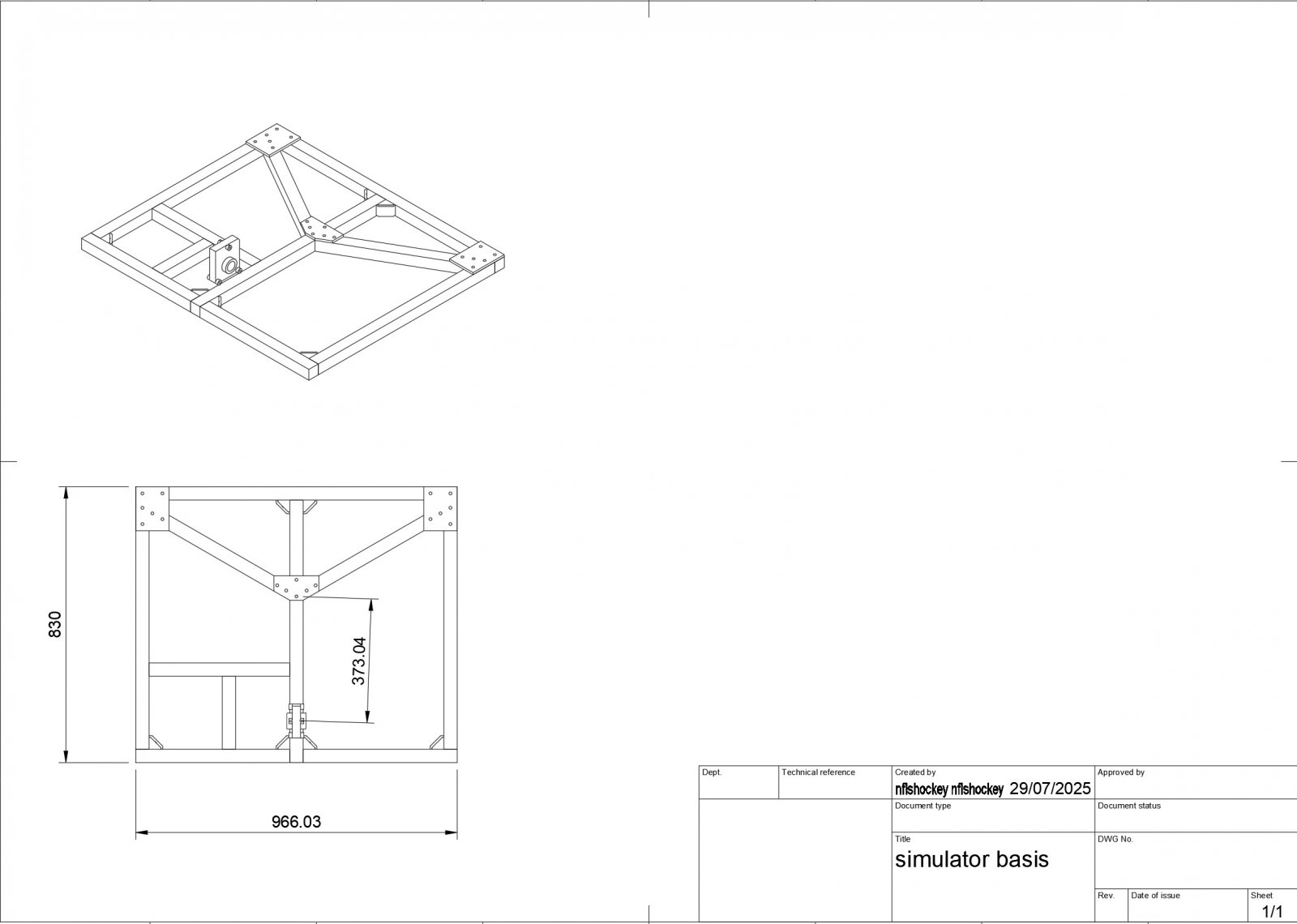

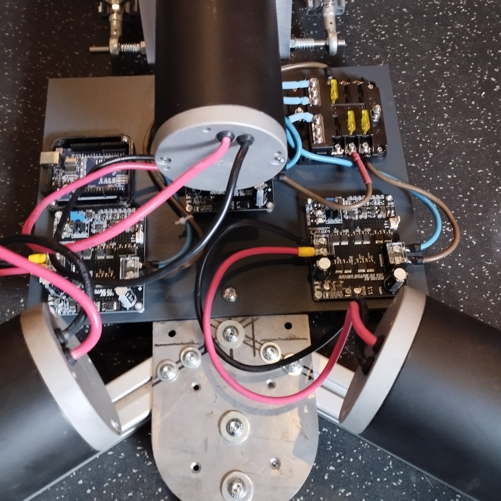

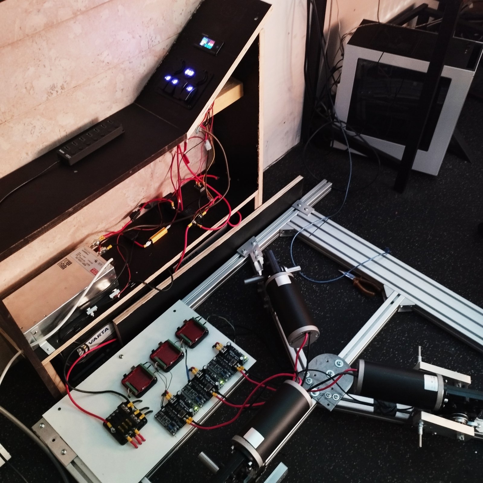

    Started with the design for the simulator base , 120° angles between motors.
    I will use 4040 aluminium profile and standard corner brackets .center and corner plates will be made out of 6mm aluminium.
  3. SaintFrank
    SaintFrank Member
    Aug 14, 2021
    80
    Proces operator
    Nederland
    160Coins
    +29 / 0 / -0

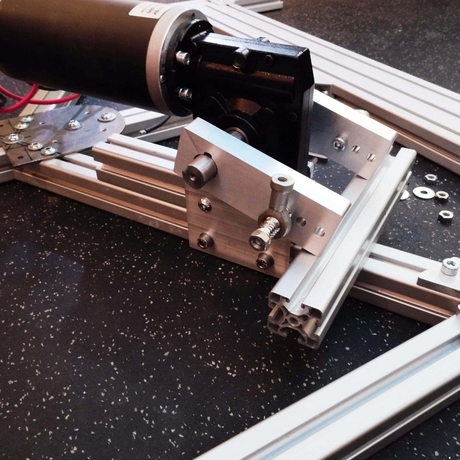

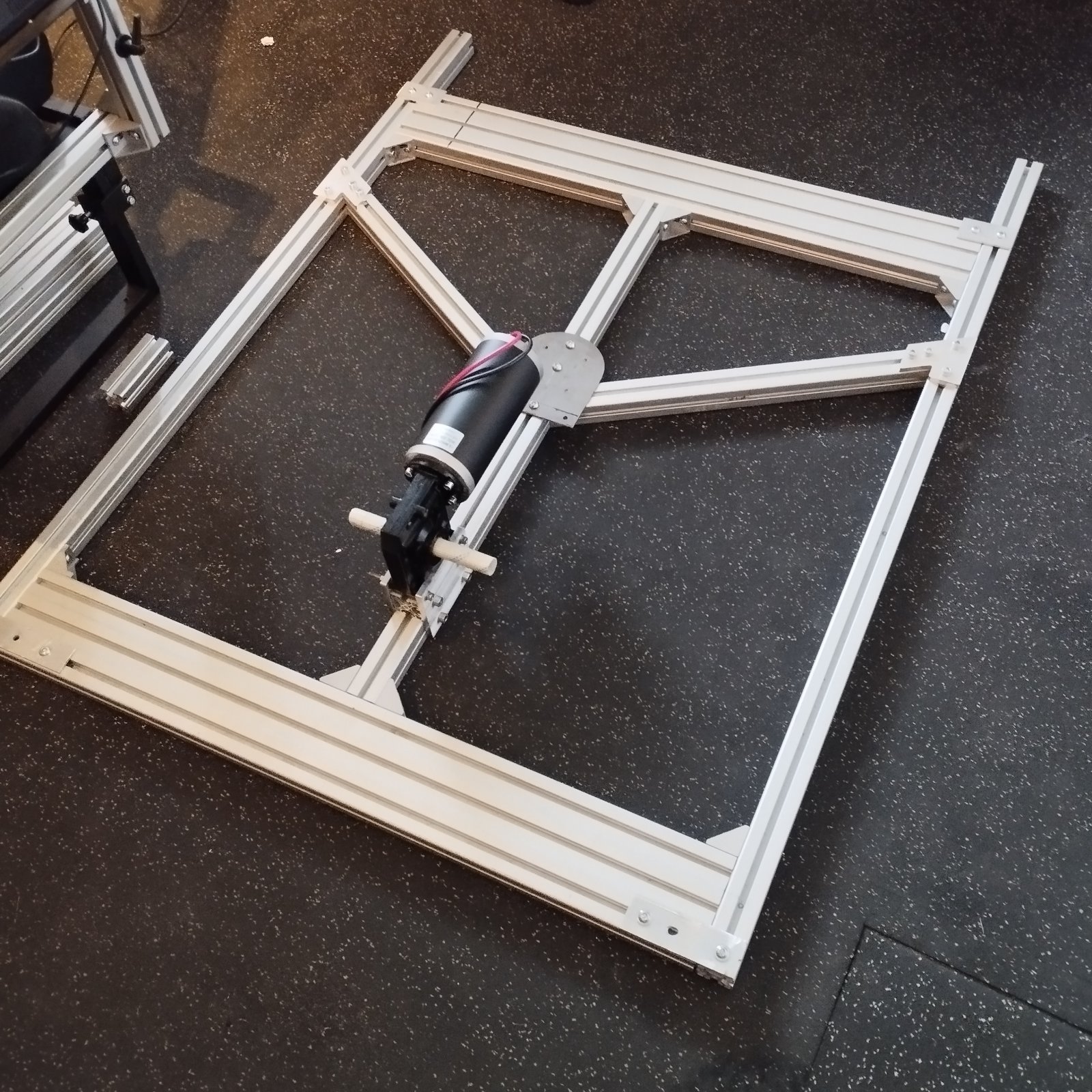

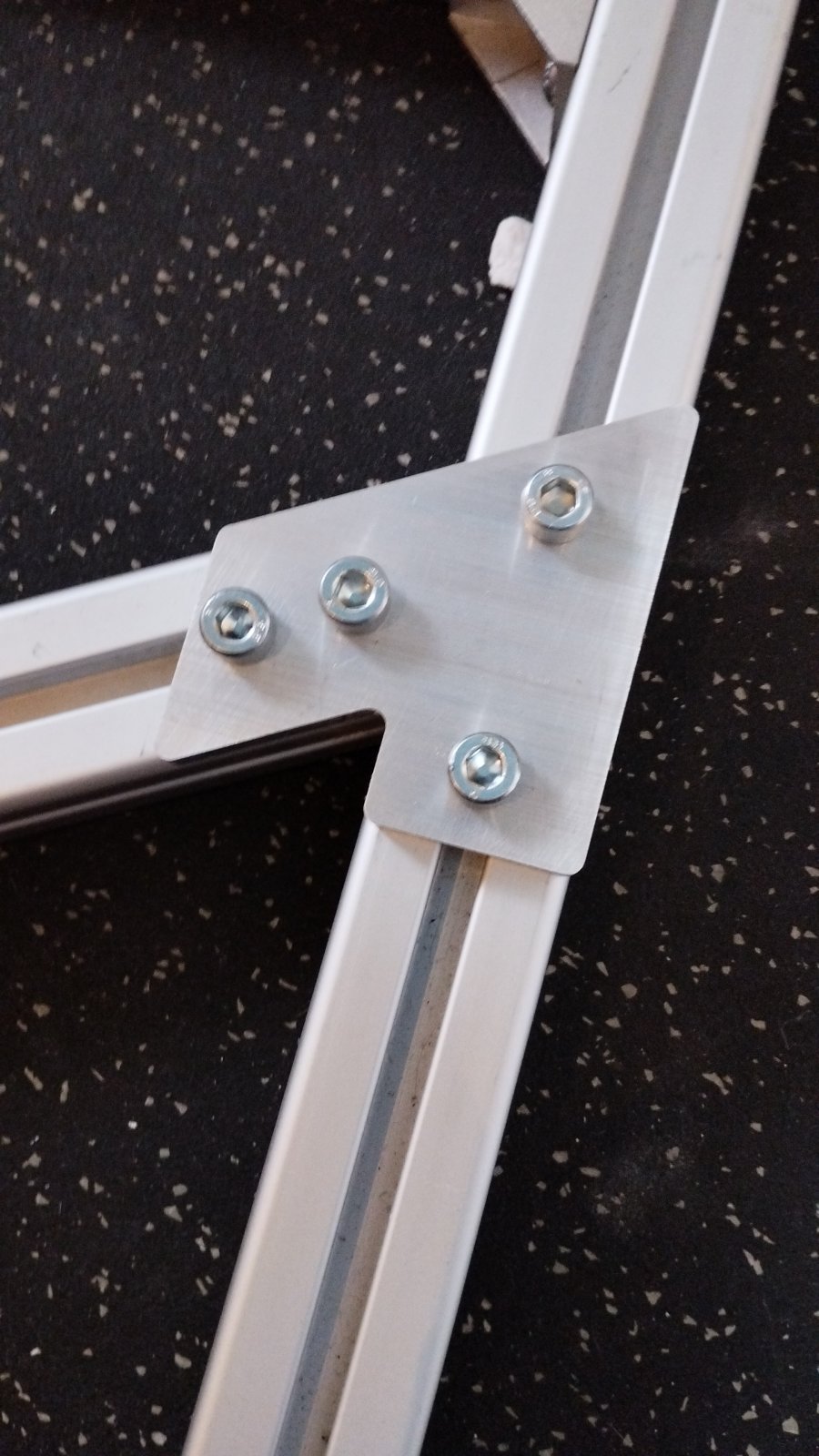

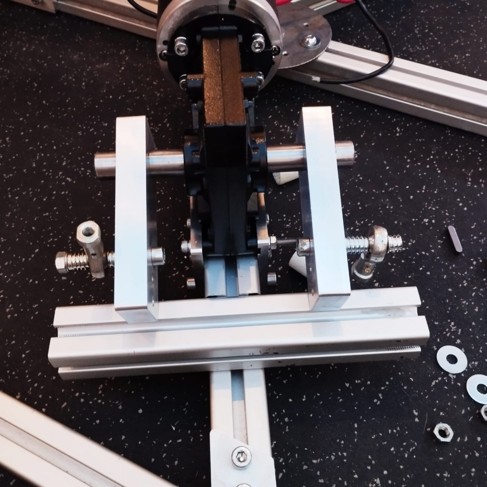

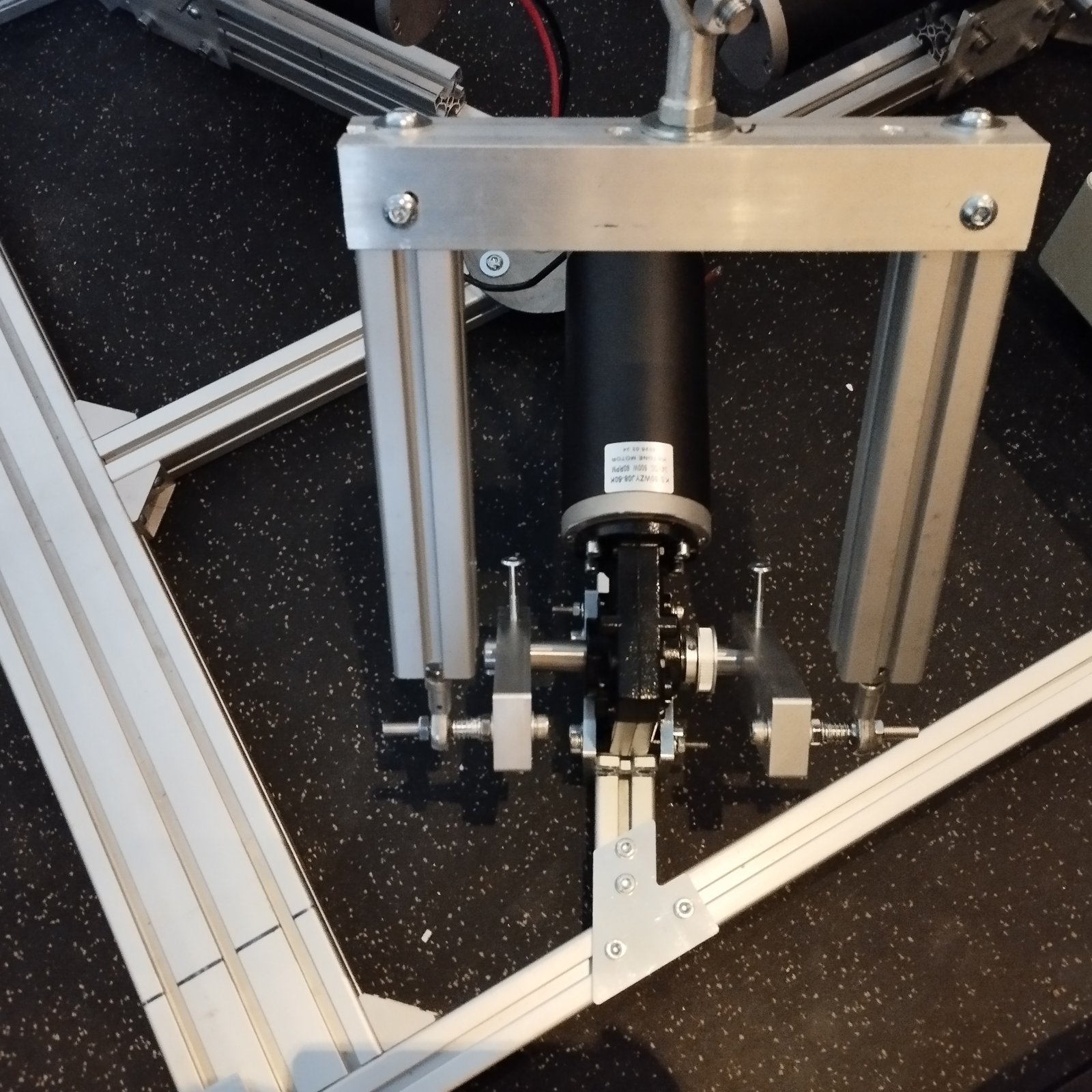

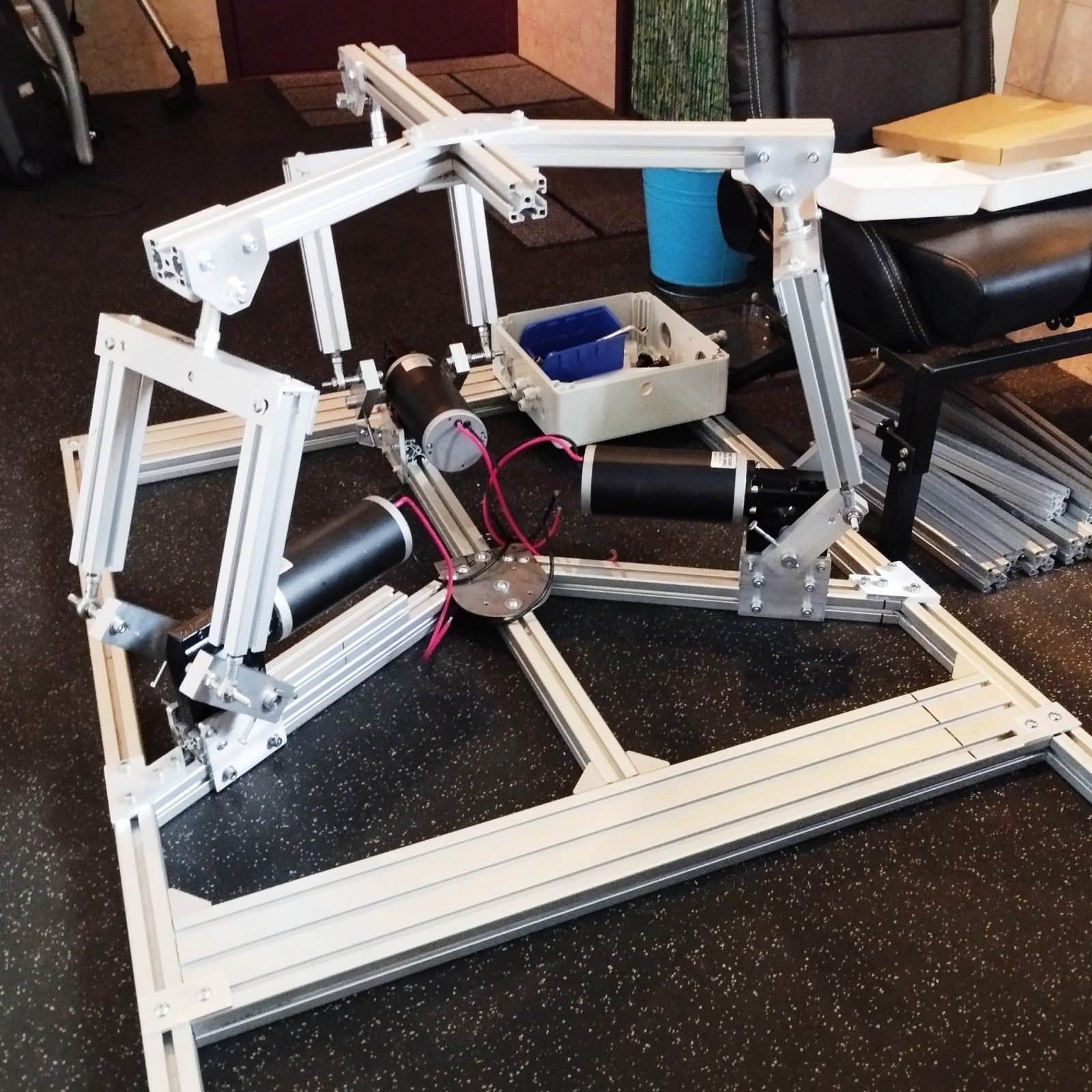

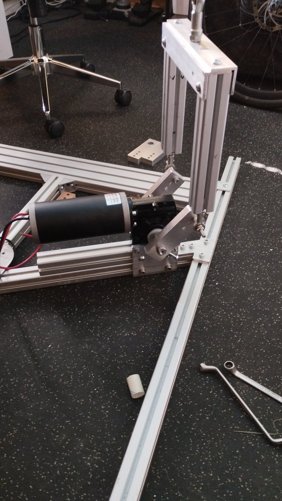

    I Got started on the simulator base. It got a bit bigger then planned:grin. (1mtr x 1mtr)
    I had some 12040 aluminium left from the cnc machine project , and made use of that.
    Wanted 120 degree angles between the motors.
    So Cut the 60° connectors on the side out of 8mm aluminium with help of the cnc.
    Waiting for more alu. to arrive, to make centerplate and make motor mounts for the other motors
    the mounting plates for the motor are also 8mm thick , hope this will be sturdy enough.
