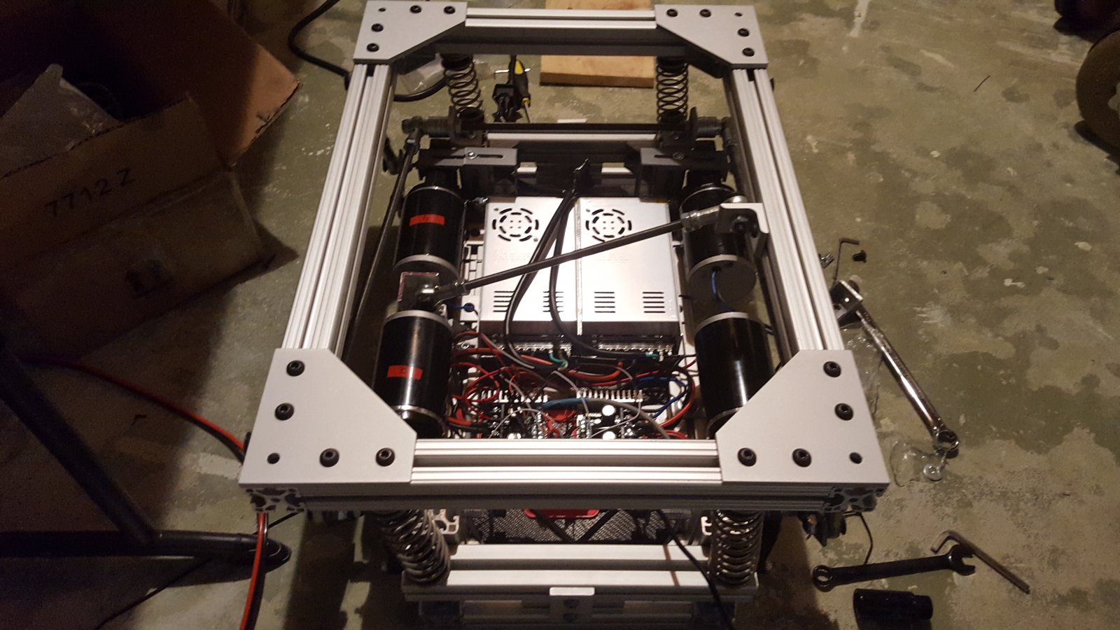

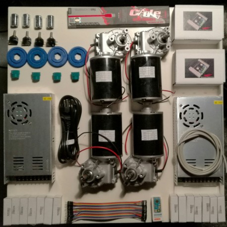

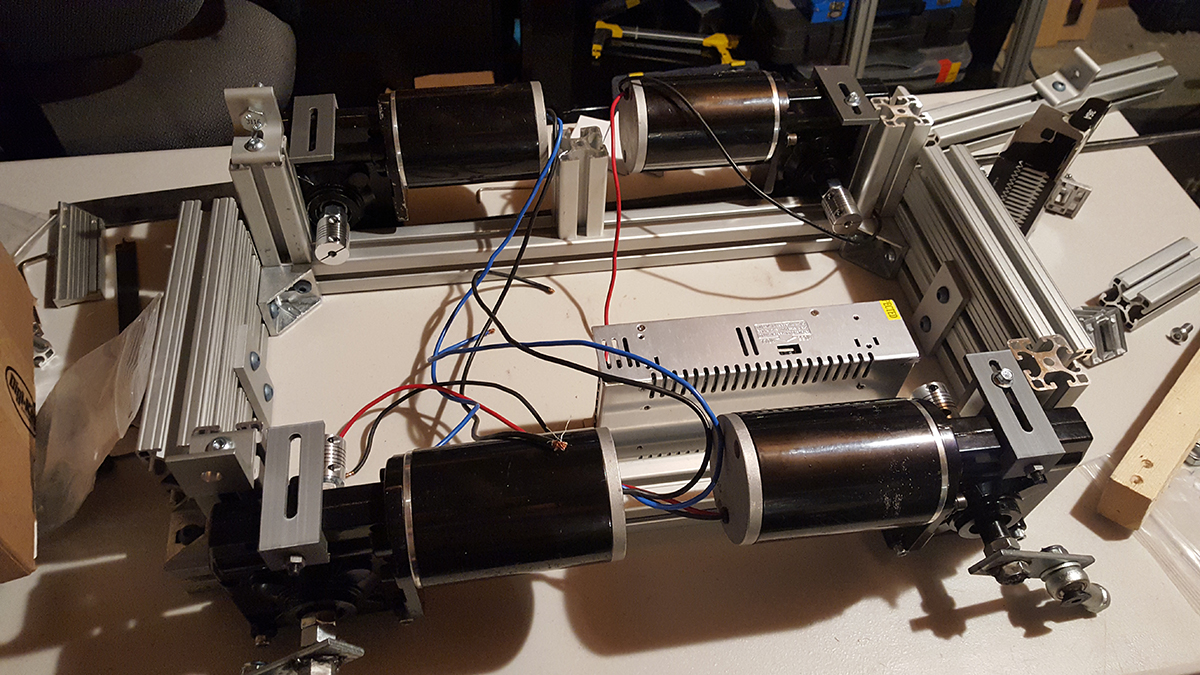

    Well, finally got all the parts I need for my 3DOF seat mover. (roll, pitch, heave)

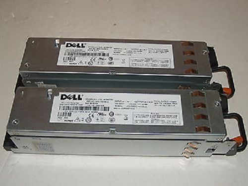

    4 JRK controllers
    pgsaw ebay motors (25:1 and 50:1) can't decide, and need some input
    Server power supplies (I assume i need 4)
    https://www.ebay.com/itm/Lot-of-2-D...0BB/222409818423?_trksid=p2485497.m4902.l9144
    I'm starting of with a Sim-Lab GT1 rig.

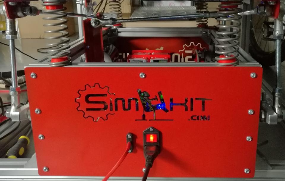

    My approach is to use a similar setup as the Simukit (4 motor) 3dof, but using wormgear motors.
    Actually already bought 2 sets of pgsaw ebay motors
    4 25:1 and 4 50:1.
    First question:
    What do you think would be better the 25:1 or 50:1 motors?
    As mentioned i will be using JRKs.

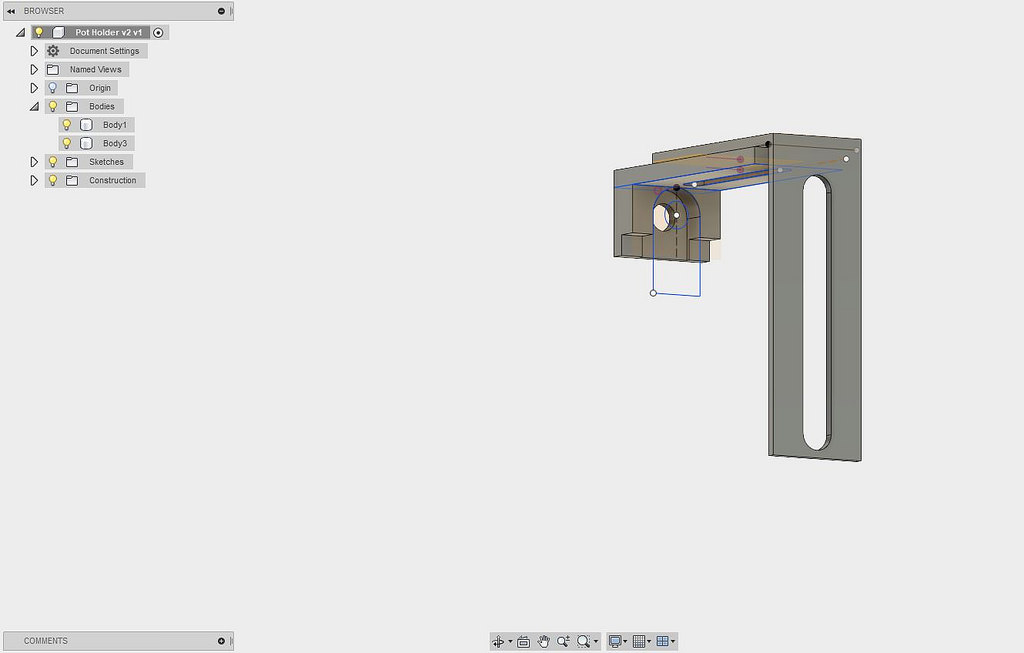

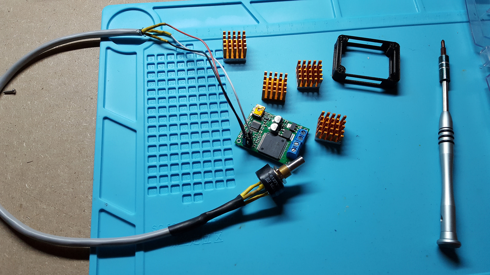

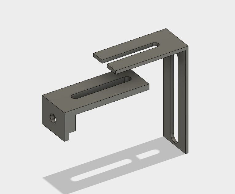

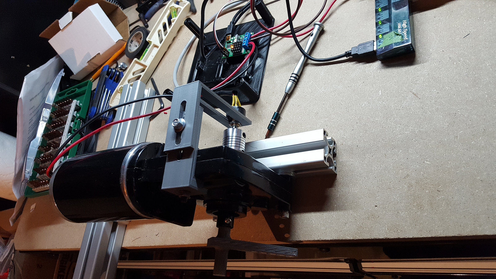

    Already started mocking things up with a 3d printed axle to test. (will be replaced with threaded rod)
    Also did a 3d print for the pot holder. Seems to work well.
    I'll upload the stl file and link it here in case anyone else wants to use it.
    I did a test config on one of the motors with the JRK utility.
    Not sure if this is normal, but when testing the movement with a max acceleration setting (600), and aggressive direction changes via the target slider on the input tab, the power supply would crap out. And I kept getting a Max Current Exceeded fault. The PS is rated at around 69A, so I'm not sure what the issue is.
    Is 600 acceleration not to be used, or do i need a more powerful PS.
    Thanks for any input and suggestions.

    Great idea to 3d print the pot holders. Do you have the .stl files to share? Thanks.
    21,723
    152,051Coins
    +11,063 / 56 / -2
    In a compact design 50:1 are better as torque really matters. Personally I use 60:1s, but they are not available via your provider.
    Use 1 PSU per motor, particularly with servers PSUs, as it helps manage the large spikes when an axis reverses. LED PSUs are more fault tolerant than server PSUs.

    Thanks noorbeast.
    So would you suggest I just get some LED power supplies to make sure I don't run into any issues? And would two 30A units be enough for 4 motors?
    Also one other concern I had with the 50:1 motors is their speed. 75rpm vs 150rpm for the 25:1. Is 75 enough?
    21,723
    152,051Coins
    +11,063 / 56 / -2
    Sim motors may draw up to their stall current, which is far greater than their rated current, multiple motors could be handled by a single PSU but it needs to be powerful enough to supply the spike loads and honestly I consider it pays to go with one PSU per motor to avoid any possible issues.
    With respect to motor and lever linear speed keep in mind that design also affects the actual motion and speed of the seat. In a compact design moving the base requires more torque but the speed and movement range of the seat is amplified by the seat back height.

    Here you go

    Slight progress...
    Managed to bench test two of the motors one 25:1 (on left) and 50:1 (right)
    The 25:1 definitely reacts a lot faster. It might be down to tuning though...
    Quite happy that things are actually working in LFS.
    Still have to read quite a bit on how to set everything up properly and then start building the actual rig to add to my Sim-lab cockpit.
    21,723
    152,051Coins
    +11,063 / 56 / -2
    What you observe has to do with physics not settings, the ratio of the wormdrives means that the 25:1 is going to react twice as fast, but have less torque than the 50:1, notwithstanding mechanical loss, which is a bit higher for the 50:1.

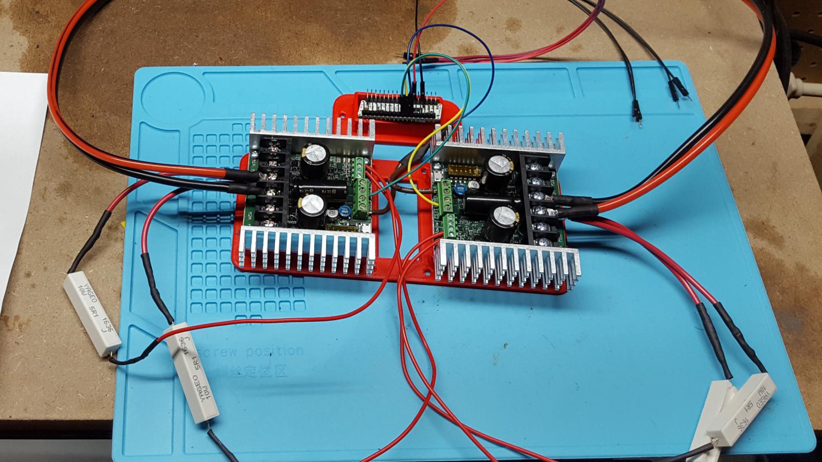

    Question:
    Although initially I was going to use 4 JRK's for the project, I'm now seriously thinking about an Arduino board and 2 Sabertooth 2x32 drivers. (already have these)
    I think I have all the info in terms of setting things up (Flashing Arduino code as well as setting up the Sabertooth and wiring). the only thing I'm confused about is how do you set the Max, Min and center for the levers and pots?
    With the JRK's you set things through the utility, (pot center, Max min lever angles) and you can test the motion. I have no idea how to do this with the Arduino/Sabertooth combo, and I can't find this step in any of the tutorials.
  11. digitalmonk
    digitalmonk Member Gold Contributor
    Dec 9, 2016
    44
    Canada
    239Coins
    +21 / 0 / -0
    Made the move to Arduino and Sabertooth.
    hooked everything up today, and she's alive!!
    Now I just have to clean up the wiring and get the rest set up (seat platform, and all connecting rods and support springs).
    Next will be tuning..
    Speaking of which are there any good guides to setting up a 3dof in Simtools?
    I'm getting confused as to how each of the levers are supposed to be positioned based on the DOF effect (pitch, surge..)

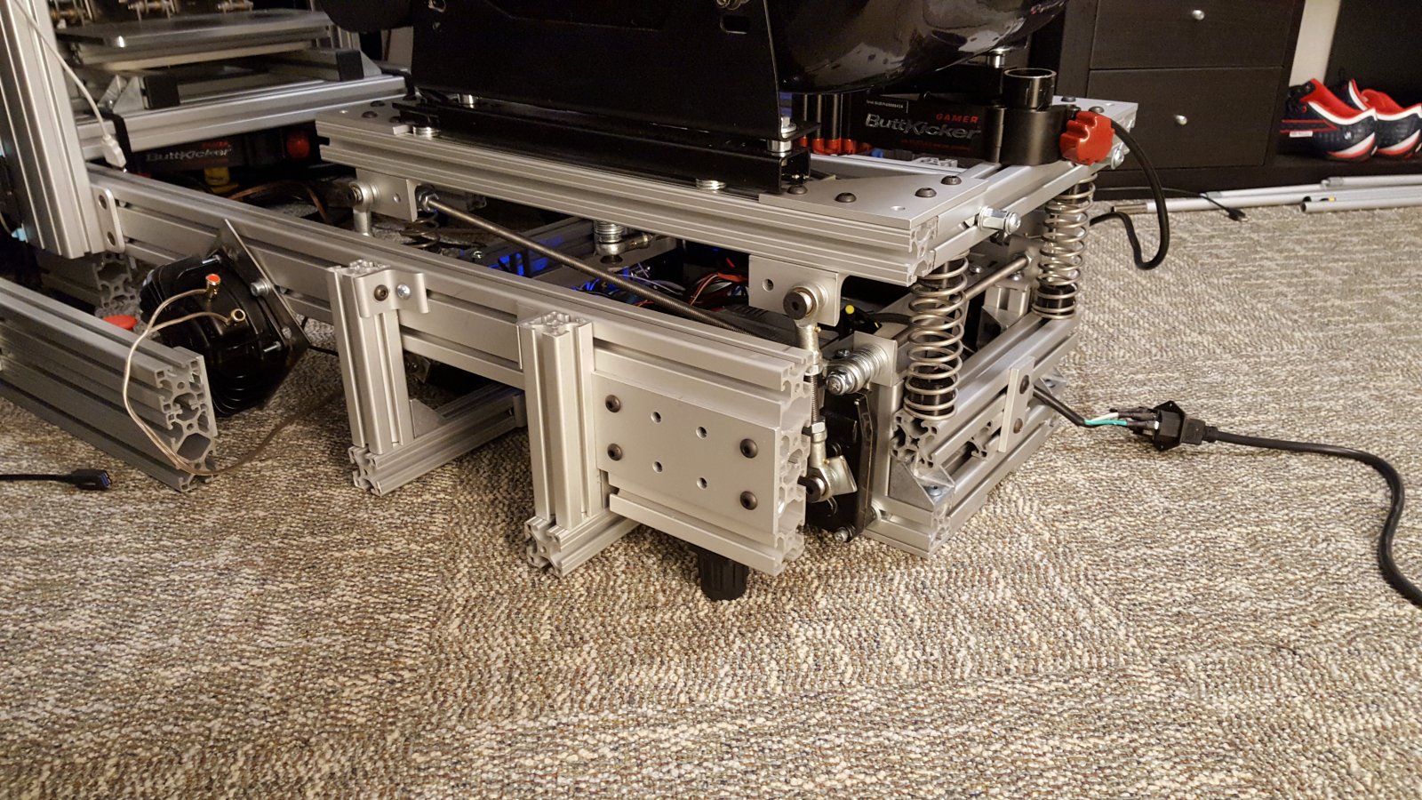

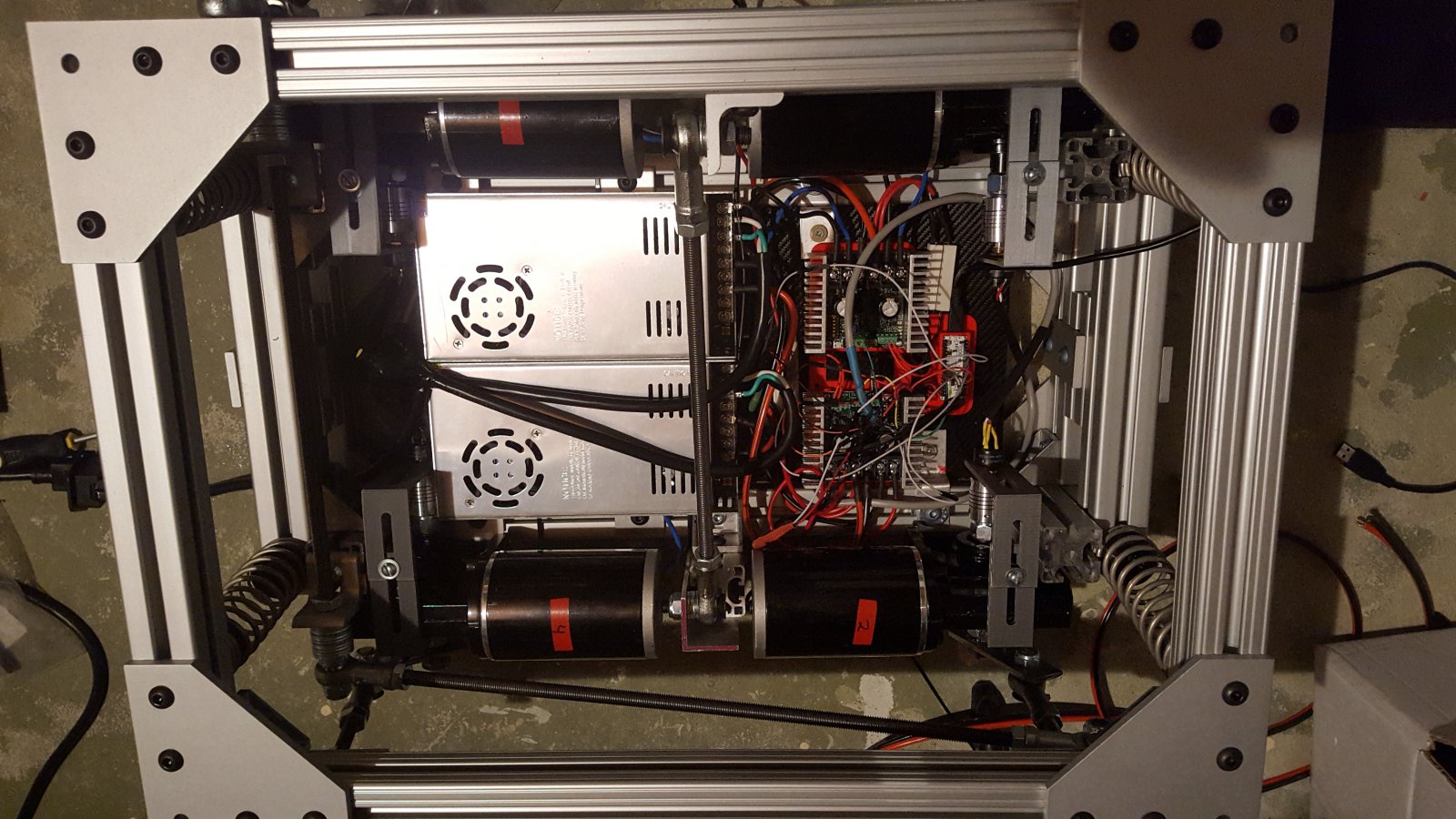

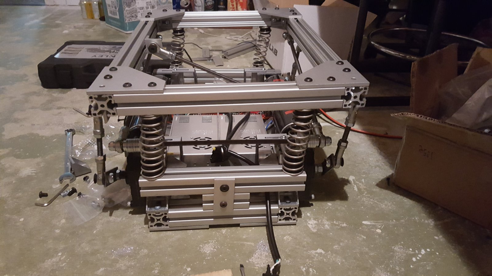

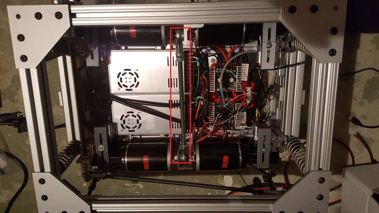

    Ok so I hit a bit of a snag. Everything has been put together. Everything works however when I test Heave in simtools the chair platform does not move straight up. It looks like it's shifting to the right on upward motion and to the left on downward motion. When the levers are centered the support springs are perfectly straight. When it goes up or down the platform shifts to either side. And the springs are no longer at a 90degree angle.
    This is what it looks like unpowered. Once powered it levels out. The springs are straight. I made sure all the threaded rods have same measurements side to side etc..
    Can't figure out what the issue is. If I pitch the front or back tilt straight down without a shift. But heave shifts the platform.
    What is the most common issue for this?
  13. RandomCoder
    Feb 19, 2017
    185
    Control Engineer
    UK
    1,674Coins
    +143 / 0 / -0
    Could it be the torsion link you have going from the base between the motors to the platform? The pictures don't show how it's mounted but I'm guessing it could be your problem. Due to being fixed length and if bolted to the base it will cause the platform to travel in an arc.

    Here is the problem...
    This bar pushes it to one side or the other when it goes up or down.
  16. yobuddy
    5,433
    51,020Coins
    +5,181 / 19 / -0
    I think with this kind of build, you need 4? hinge connections like the one on the front of this sim.

    Thanks for the reply guys. Randomcoder you zeroed in on the problem. Yobuddy the bar is supposed to be there but I had it at a too much of an angle. Base vs seat platform. It's supposed to be more like in this image.
    The design does work well. I just totally messed up the angle. I didn't think it was supposed to be almost straight.

    Related question. Do I even need the springs if I'm using 4x 50:1 motors? I tried to duplicate the simukit design and that uses springs but the motors on that don't have as much torque.

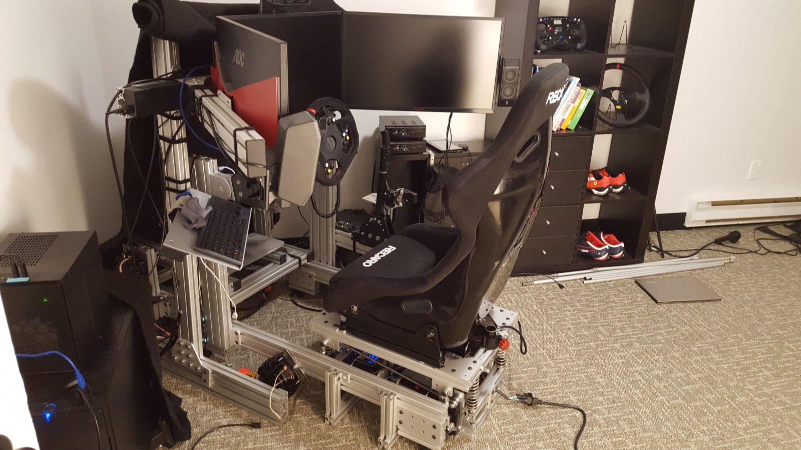

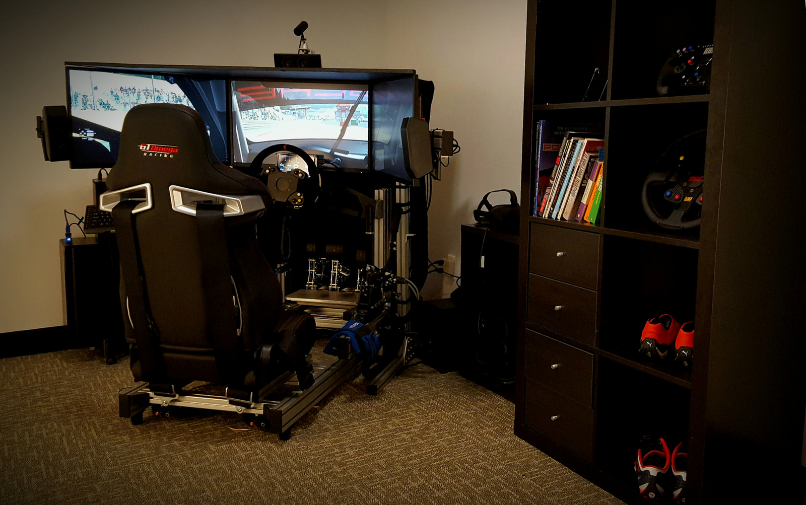

    Finally Done!
    I fixed the angle of the middle rod and it's all good.
    Now the fun part starts with tuning the motion..
    Here are some pics of the final setup.
    One thing I noticed.
    If I turn on Output testing the platform settles to the middle position and is even. However when I start Assetto Corsa and sit in the car the seat is tilted slightly to the left. Not sure why. Is this normal? You can feel it while driving as well. As if the car has a constant roll force applied to it.
  19. prodigy
    prodigy Burning revs
    Oct 27, 2013
    459
    Croatia
    6,698Coins
    +399 / 4 / -0
    Have you found min/max values in the Tuning Center?
    Reset all values in Tuning Center and run 1-2 clean laps to find min/max values.
    Maybe the sway or roll values are not even and the seat is tilted.
