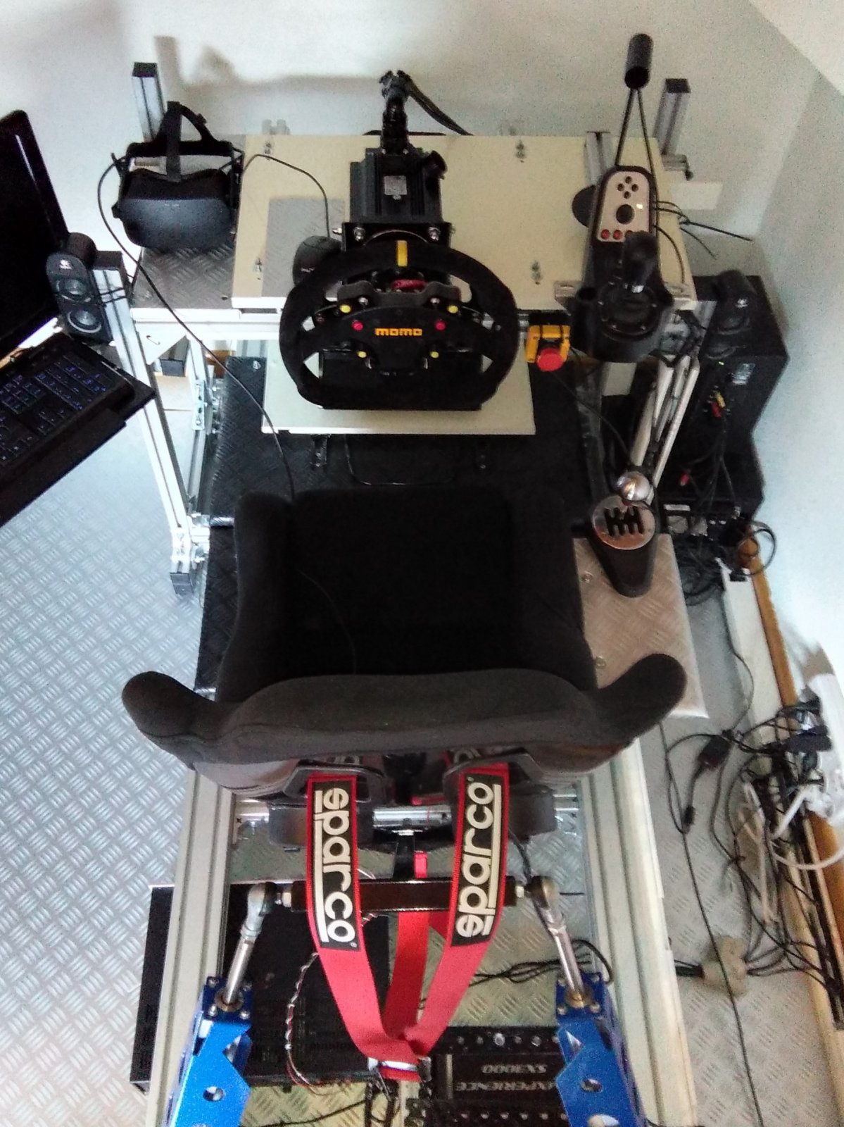

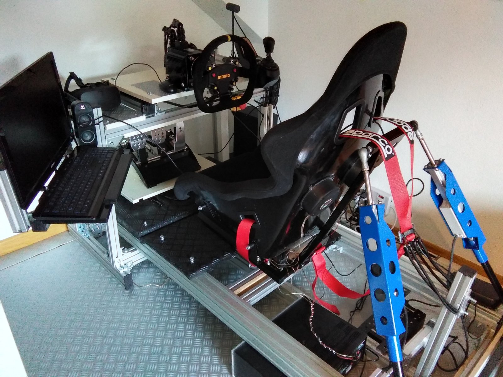

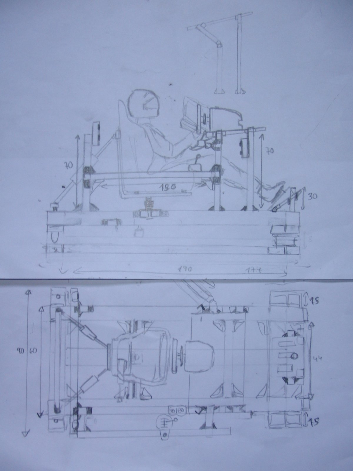

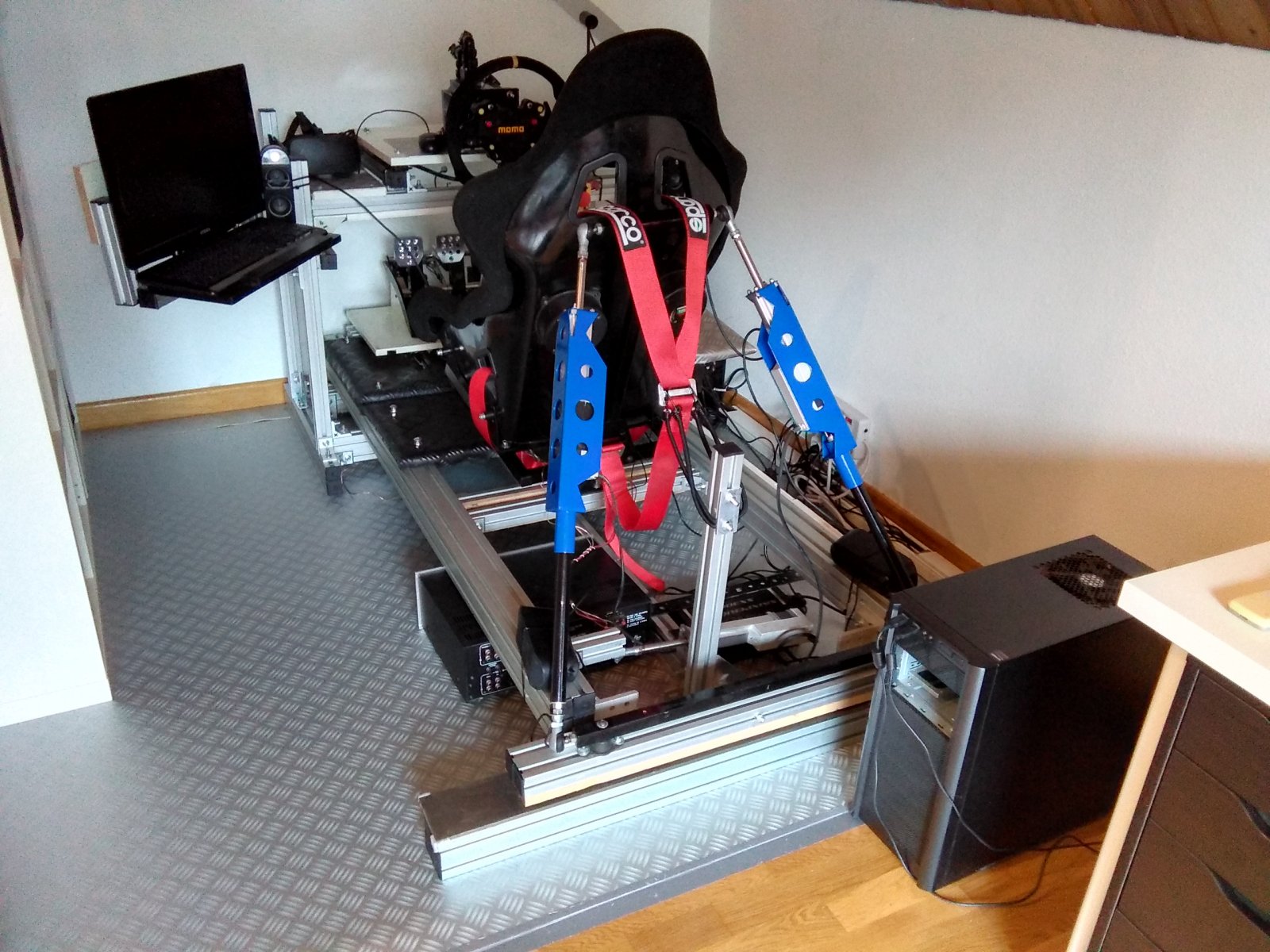

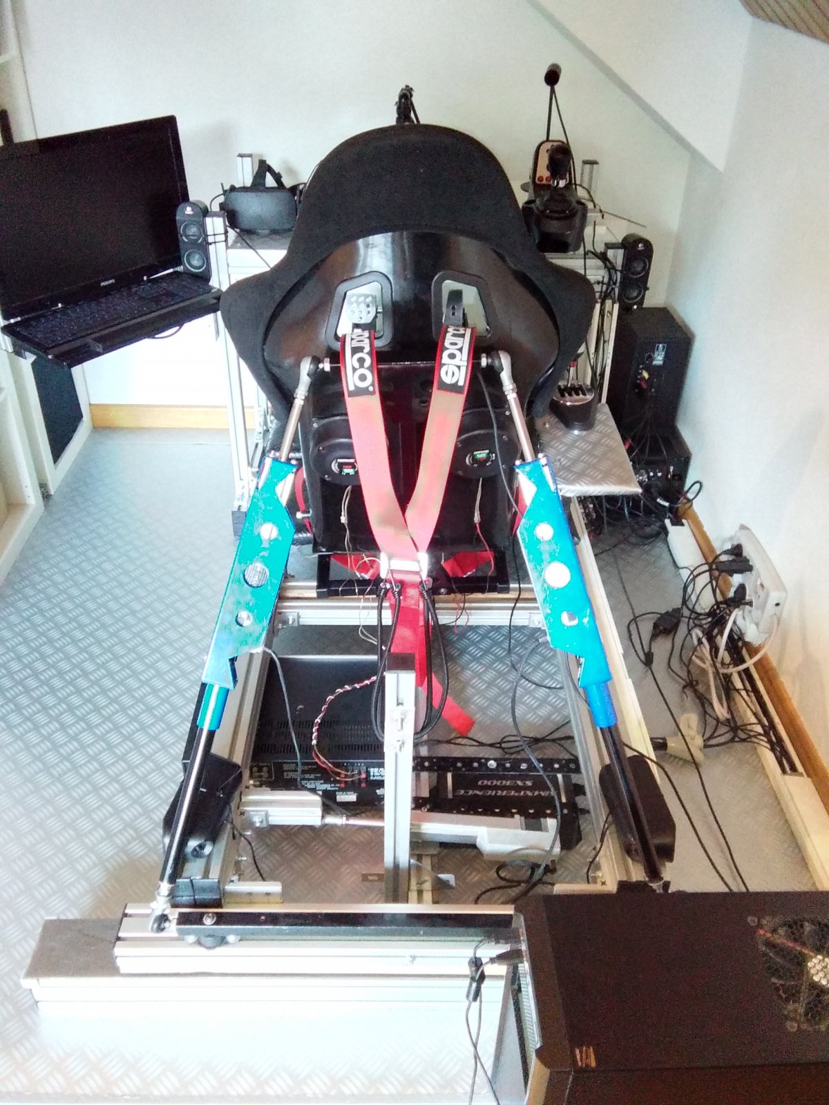

    All is done by me except the basic kit for motion (Simxperience kit 1) which is the cardan+2 actuators+dampers. The rest is DIY.

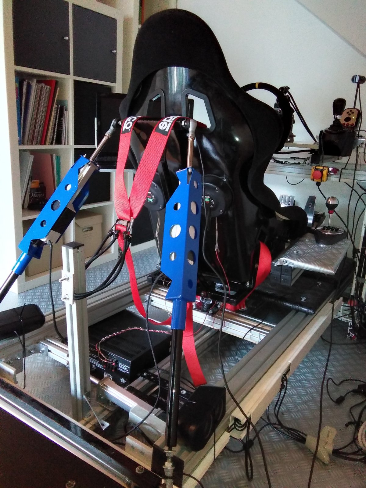

    I started with a 2 dof and then added a 3rd actuator (scn5 150mm) to have yaw/rear traction loss.

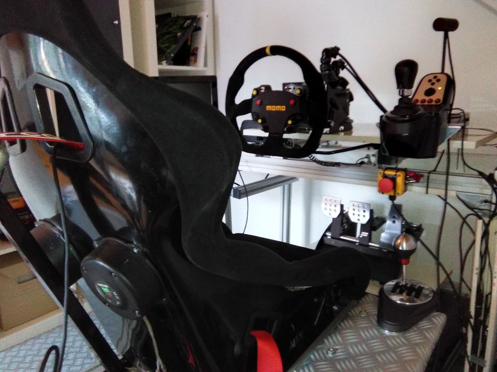

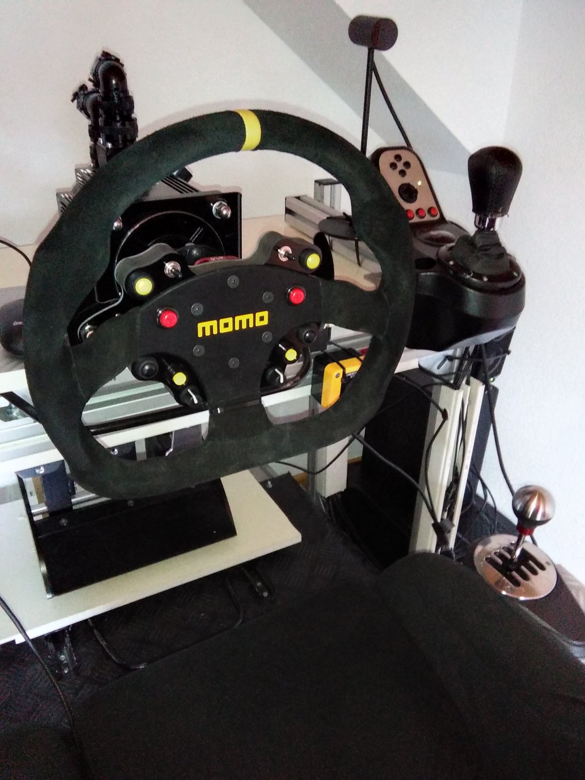

    from a logitech g29 I evolved to a T500 and nowadays i use an OSW small mige with a momo wheel filled with buttons and rottarys all functional.
    The pedals are quite basic: fanatec v2
    gear box also basic: thr8 and the old logitech used as a secuential
    some bass shackers are placed under seat (2) and behind seat (2 more) and also under pedals and gear shift (simply using low pass filter audio in stereo so i have different vibration left/right)
    used to have a flat screen, then a 100" projection beamer, then a 180º 100" warp arround projection beamer and nowadays an oculus rift (i don't have anymoer a flat screen or any other screen, just the rift).
    Hope you like my rig!!

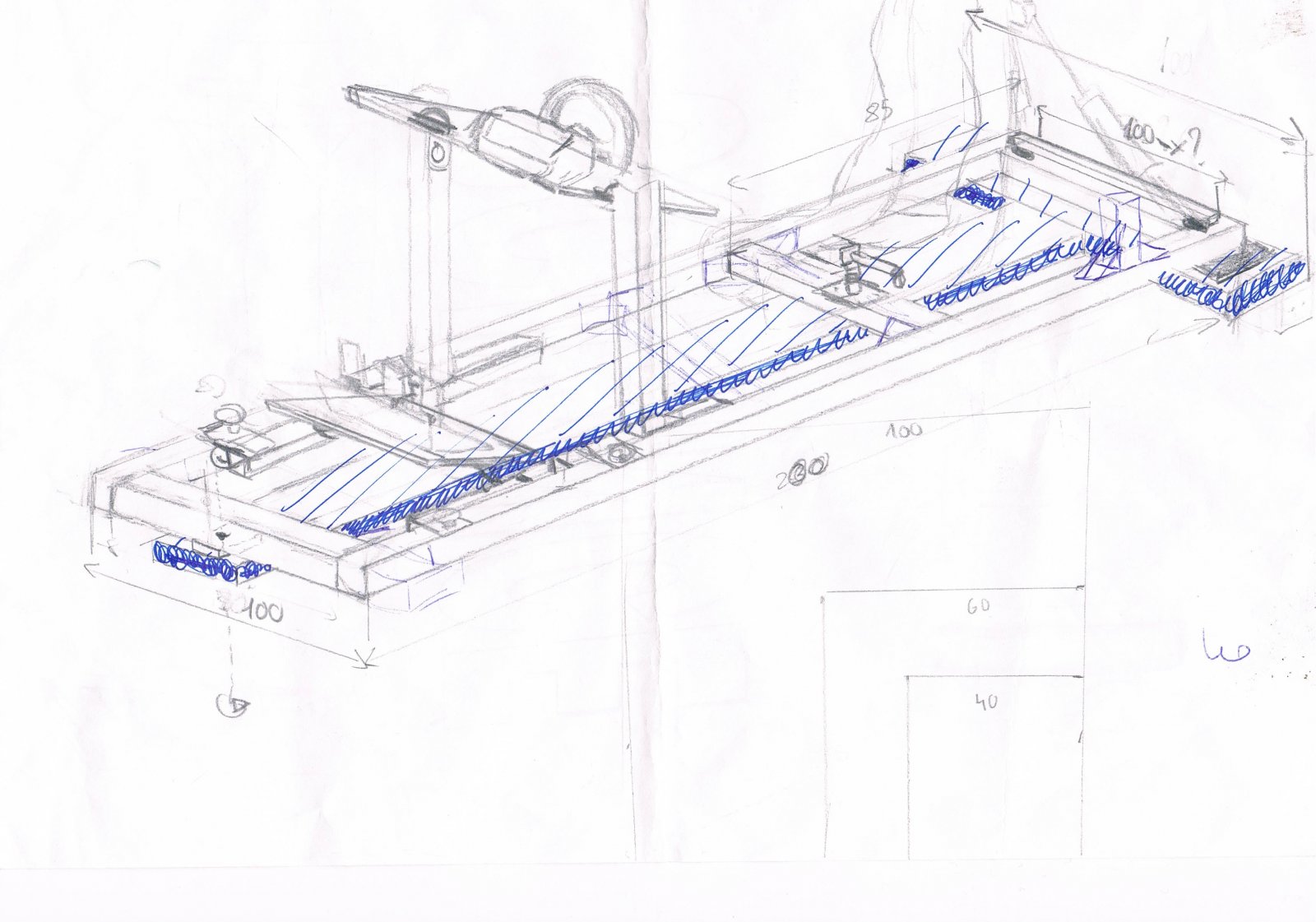

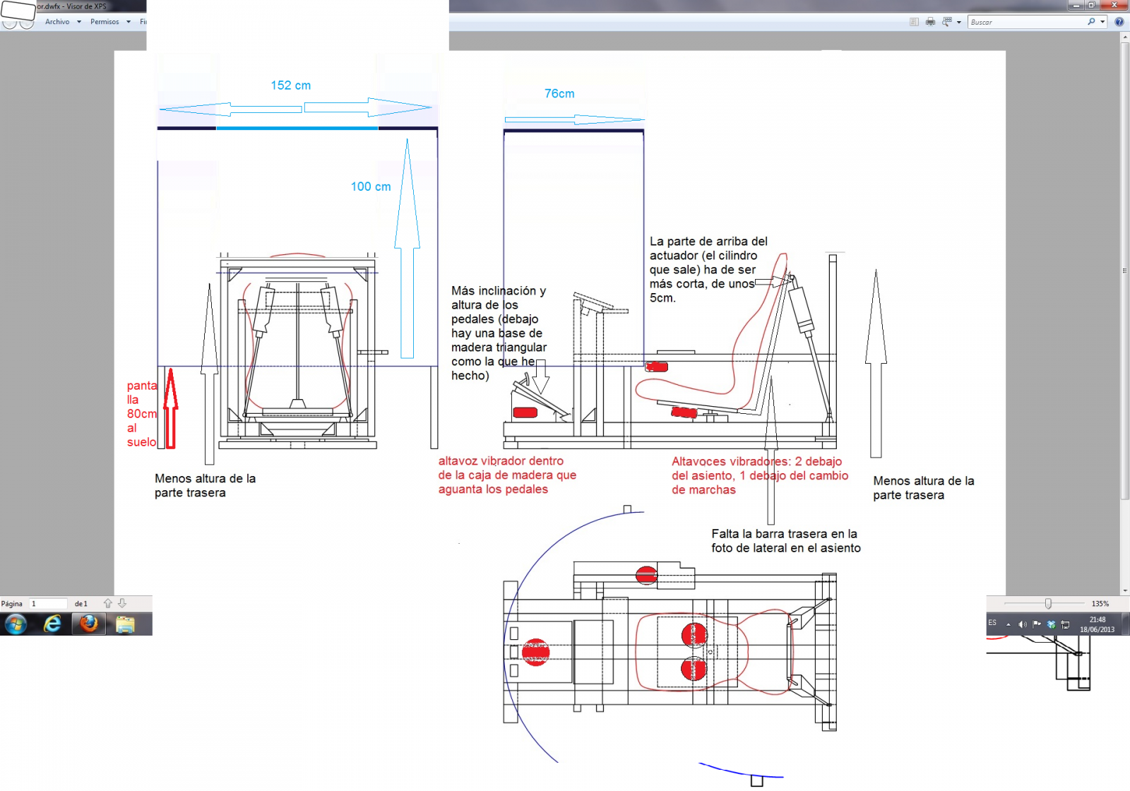

    if people has any questions i can post the ongoing process to build it to how it looked in cad doc (do not have pics of building process on how is it nowadays)
    I add first drawings and final cad (though the actual simrig is fairly different and updated form the cad)
