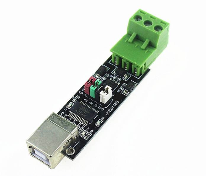

    First and foremost, the examples that I have seen on the forums use RS232/RS485 Serial Converter Adapter like this one:

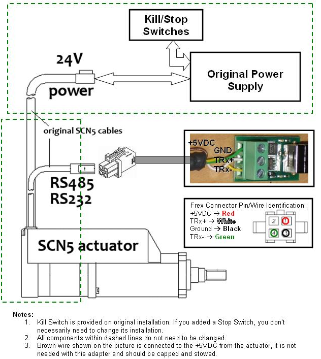

    to connect the SCN5 actuator to the PC like so:
    ** Note: Only 1 RS485 per Actuator **

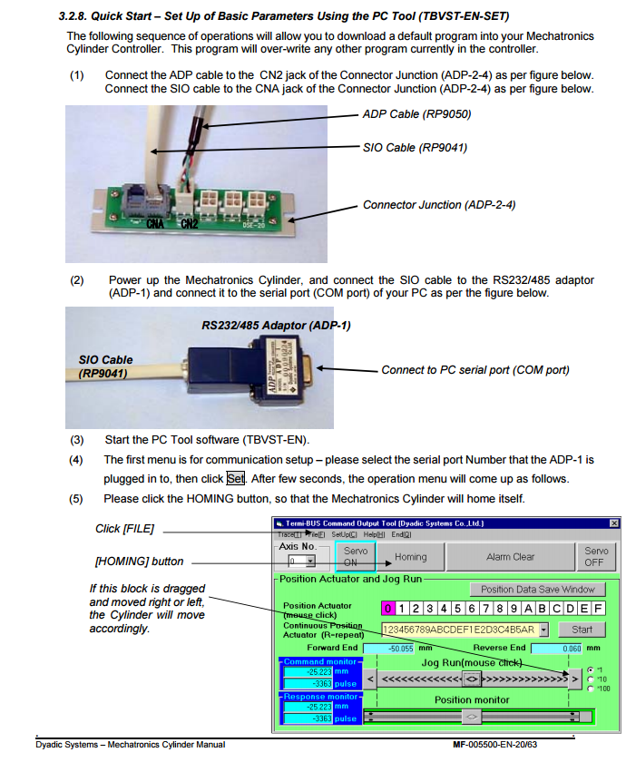

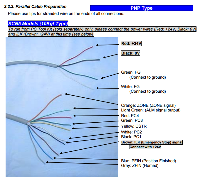

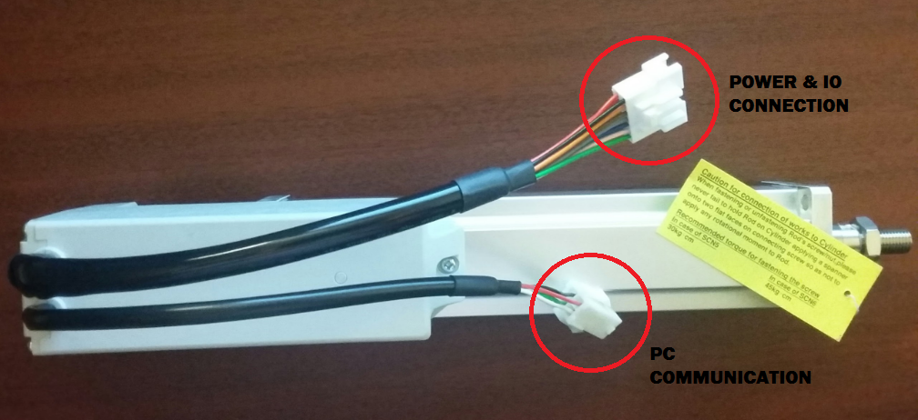

    But SCN5 comes with the following wires:
    Per the Operational Manual for SCN5, the supplier suggest getting the following items: PC-CTC ToolKit = ADP Cable (RP9050), SIO Cable (RP9041), Connector Junction (ADP-2-4), RS232/485 Adapter (ADP-1), and TBVST-EN Software = ~$400+!!!
    From the builds I have seen on here, the wiring completely ignores the Power & IO connections like so:
    Which results to a potential cost of ~$10-$20. This is where I am confused.

    1) Is the PC-CTC ToolKit (valued at a base price of $275) needed? How does the alternative (RS232/RS485 Serial Converter Adapter) act as a substitute?
    2) What about the TBVST software that is used to program the actuators?
    3) How does the SCN5 interface with SimsTool (without a microcontroller like the Arduino)?
    4) Why are the Power & IO and the 5V+ connections ignored?
