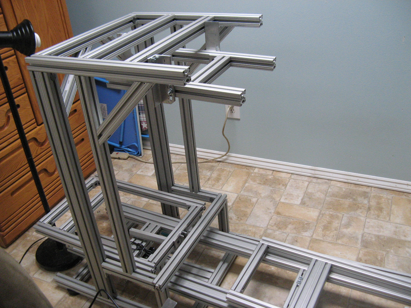

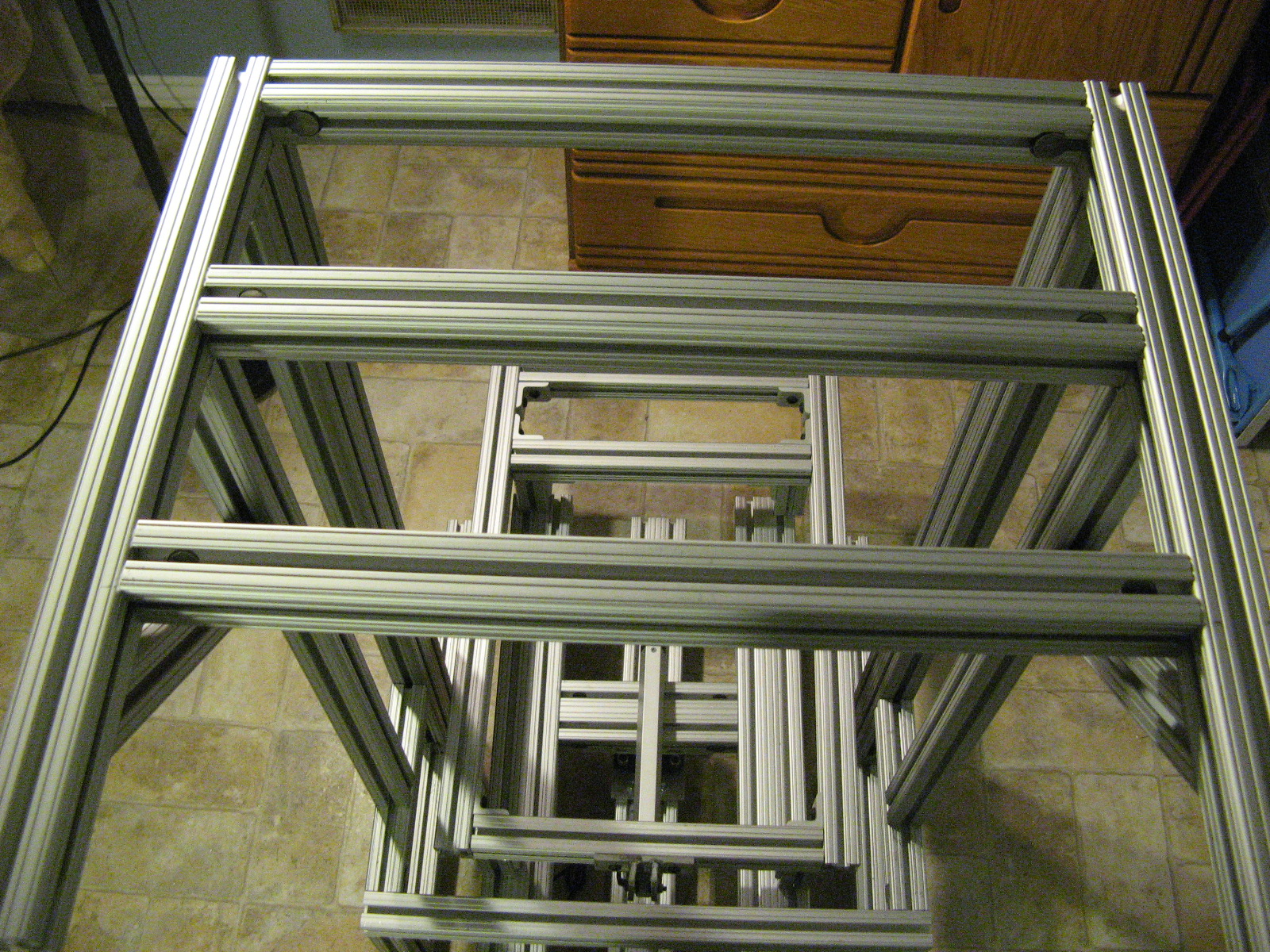

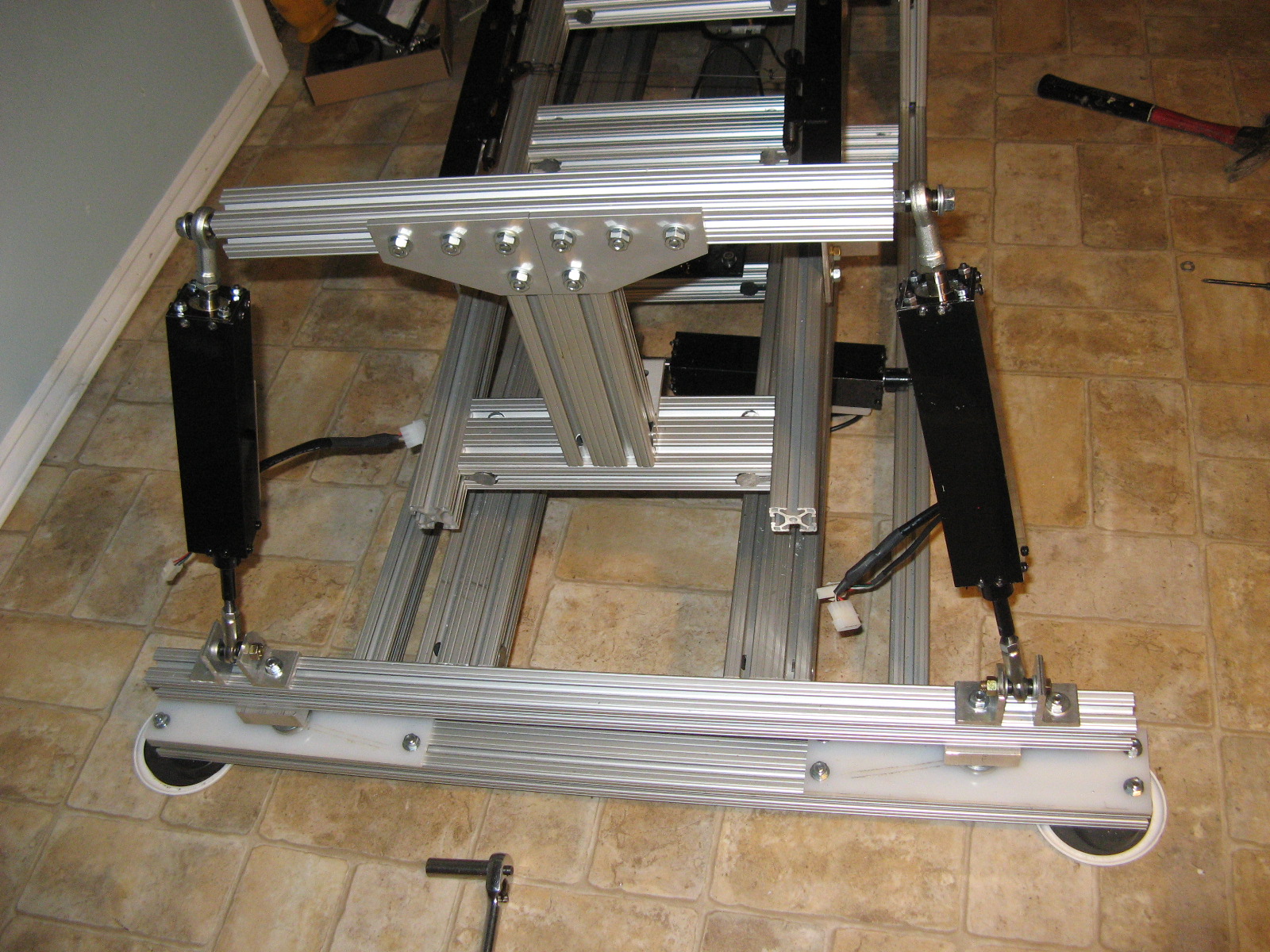

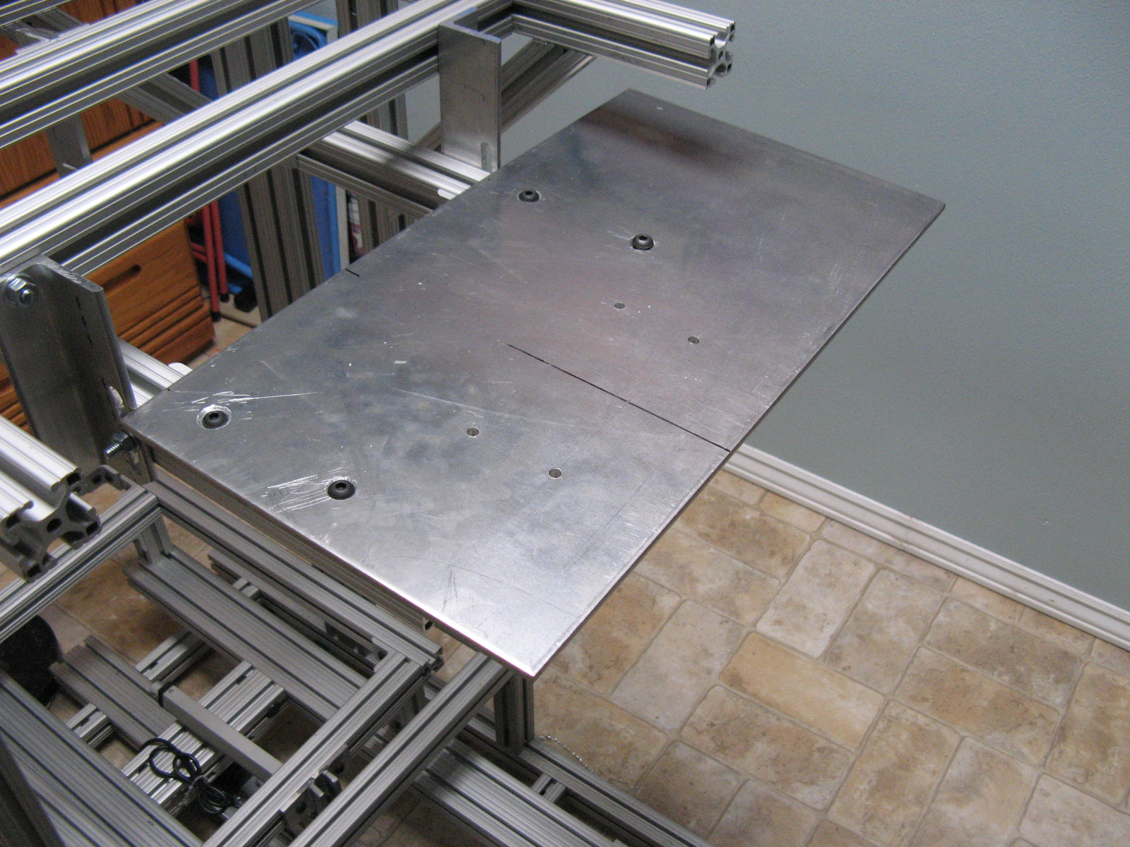

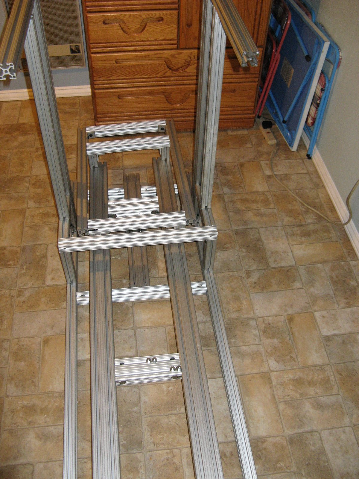

    I was finally able to dedicate time to put it together.

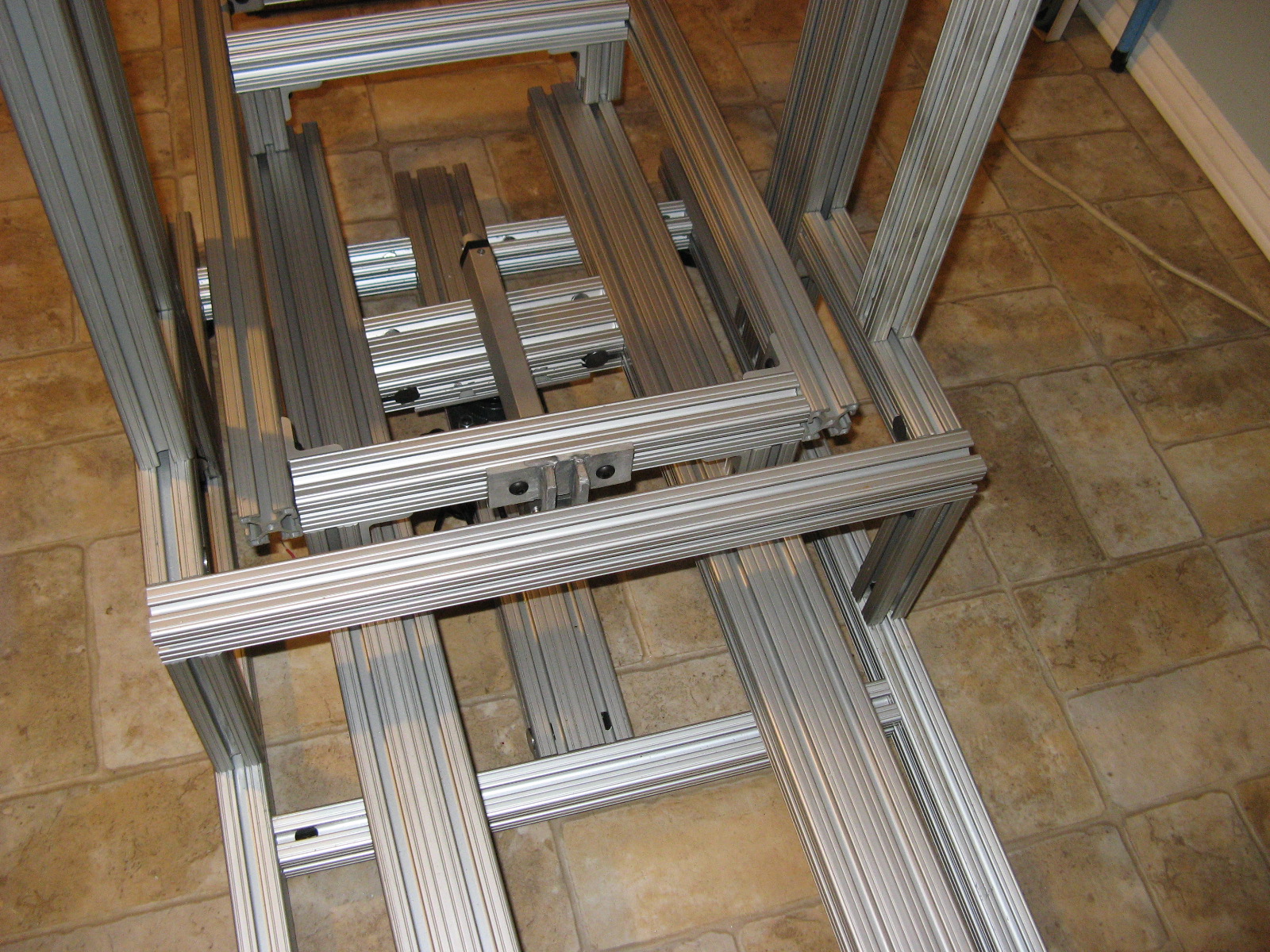

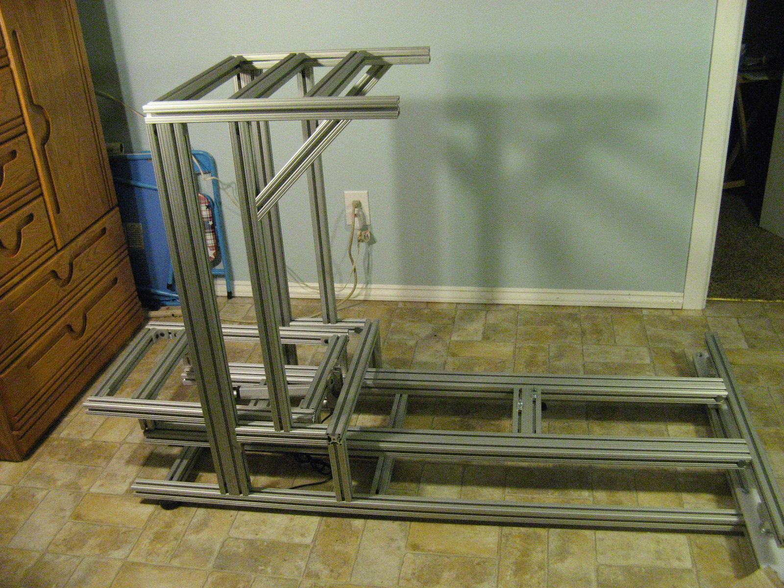

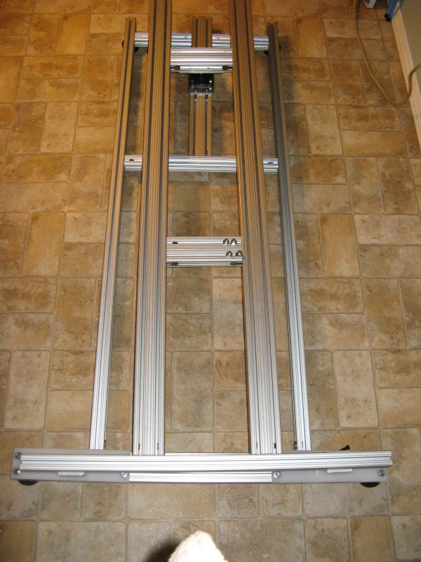

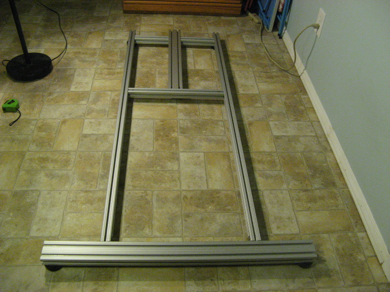

    In the next pictures, I will show the progression of the project. The first picture shows the lower base. IMG_5804.JPG

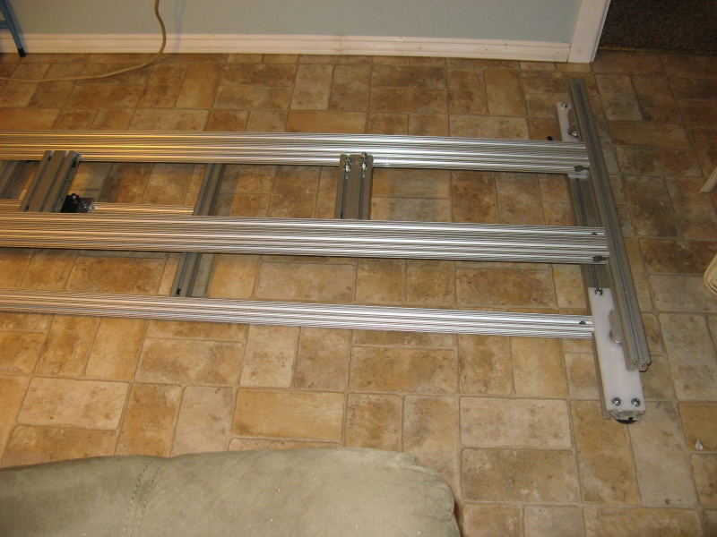

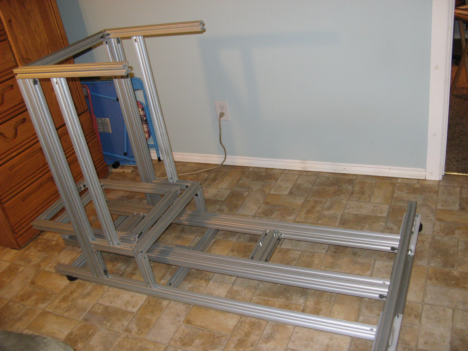

    The next pictures show the loss of traction base, and some details.

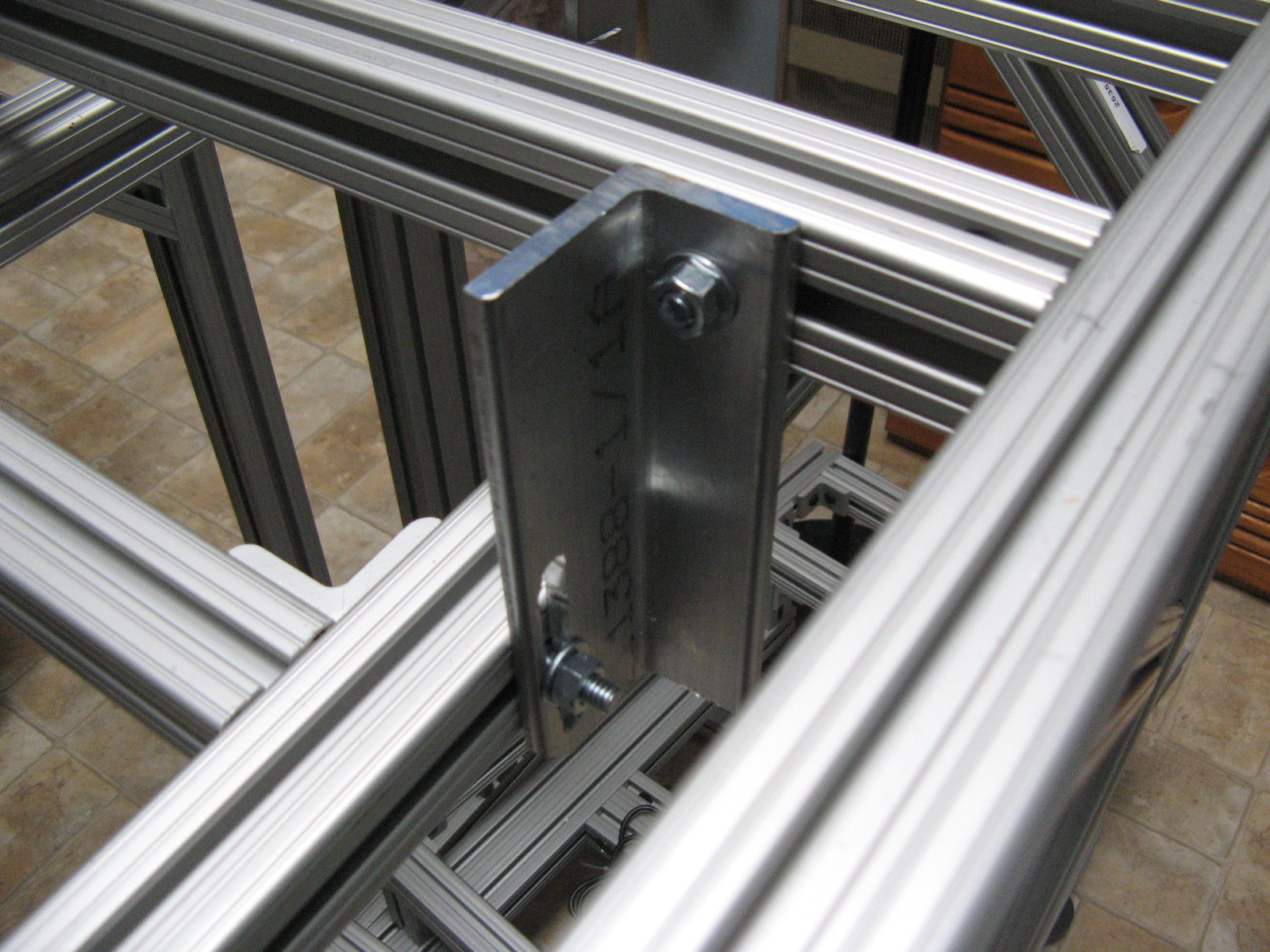

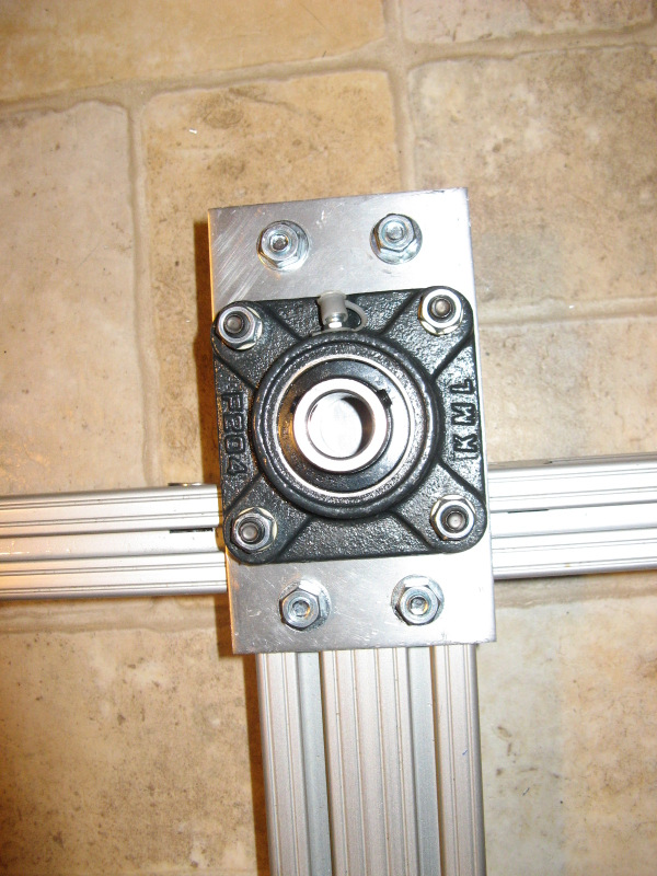

    IMG_5825.JPG This picture shows the front bearing(a pillow block). IMG_5828.JPG

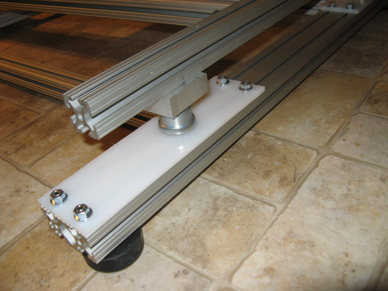

    The picture on the right shows one of the the rear bearings and the rear bearing support plate (UHMW).

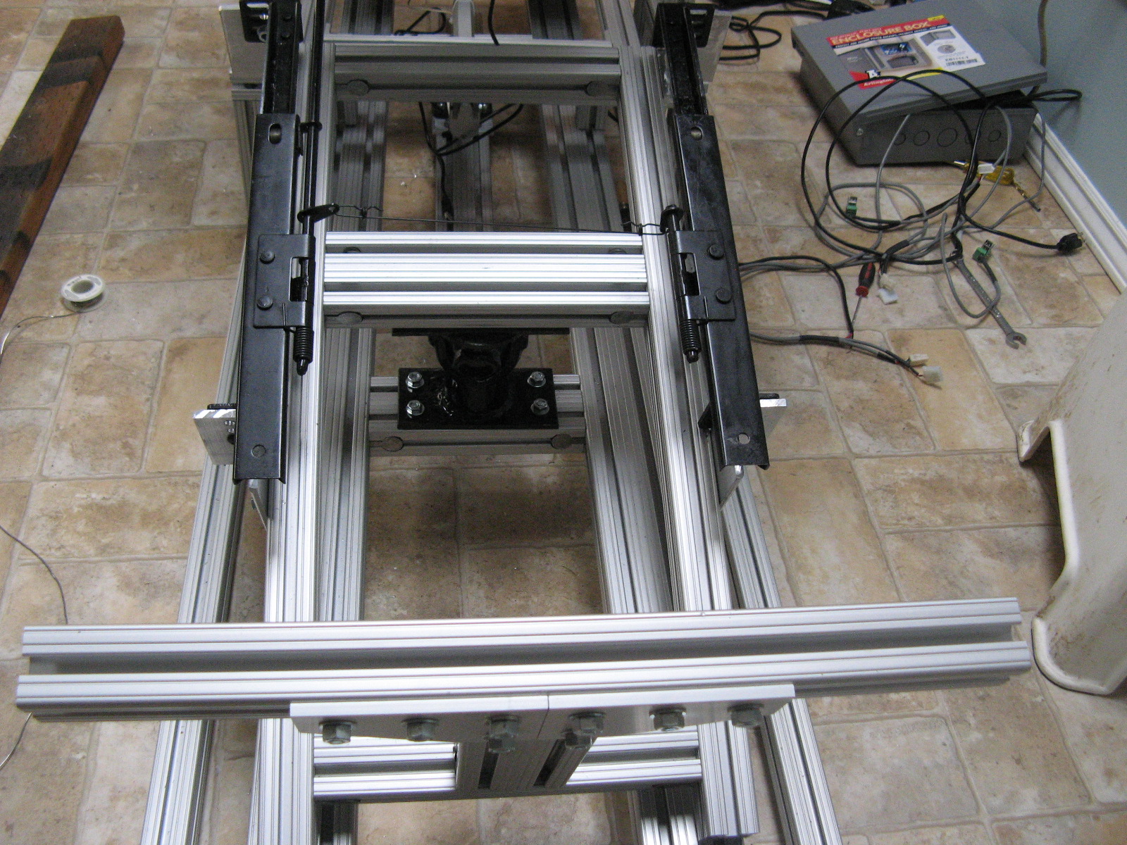

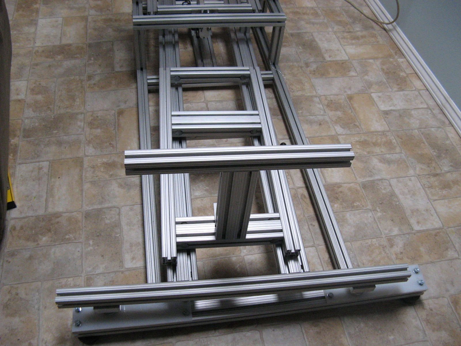

    The next one details the two sub-assemblies lower base and loss of traction base. IMG_5827.JPG

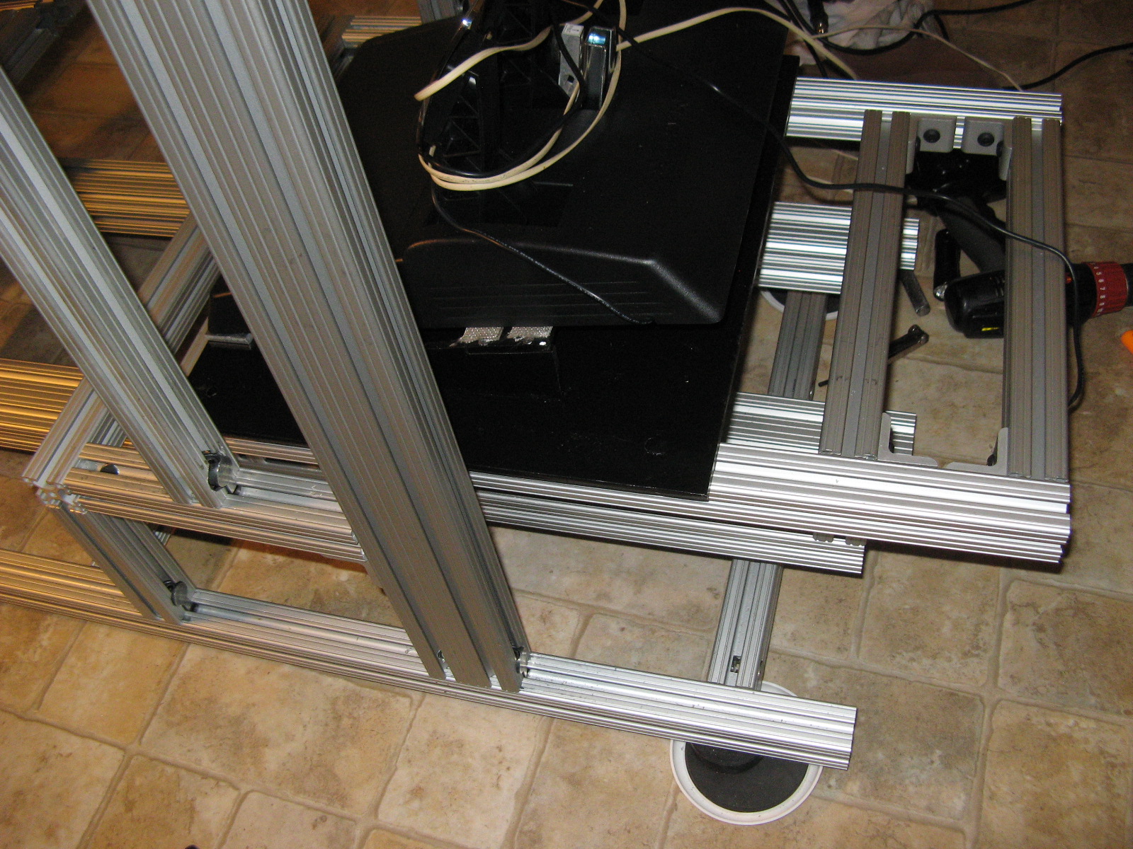

    In the next picture, you see the pedal base and the monitor a steering supports.

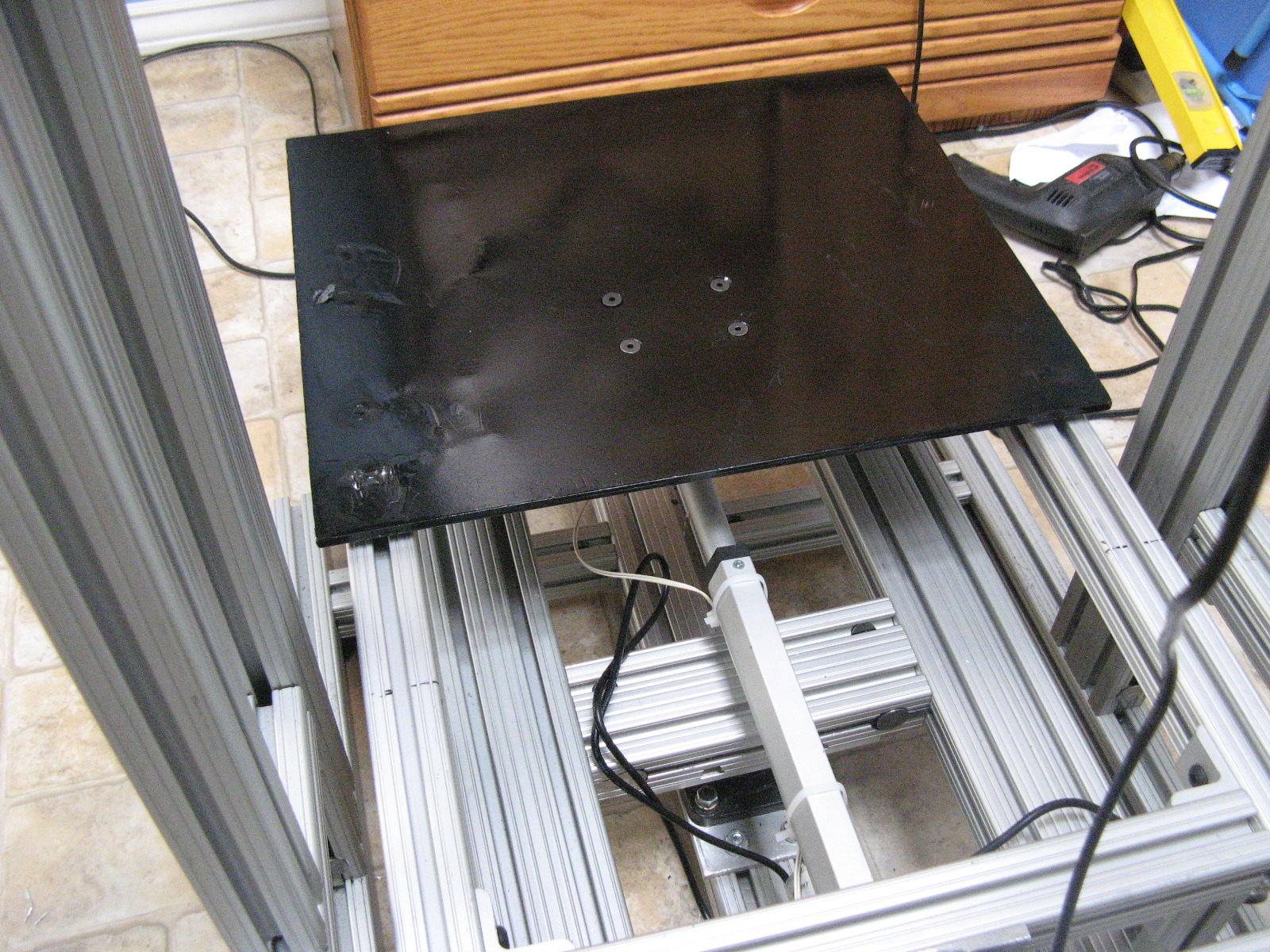

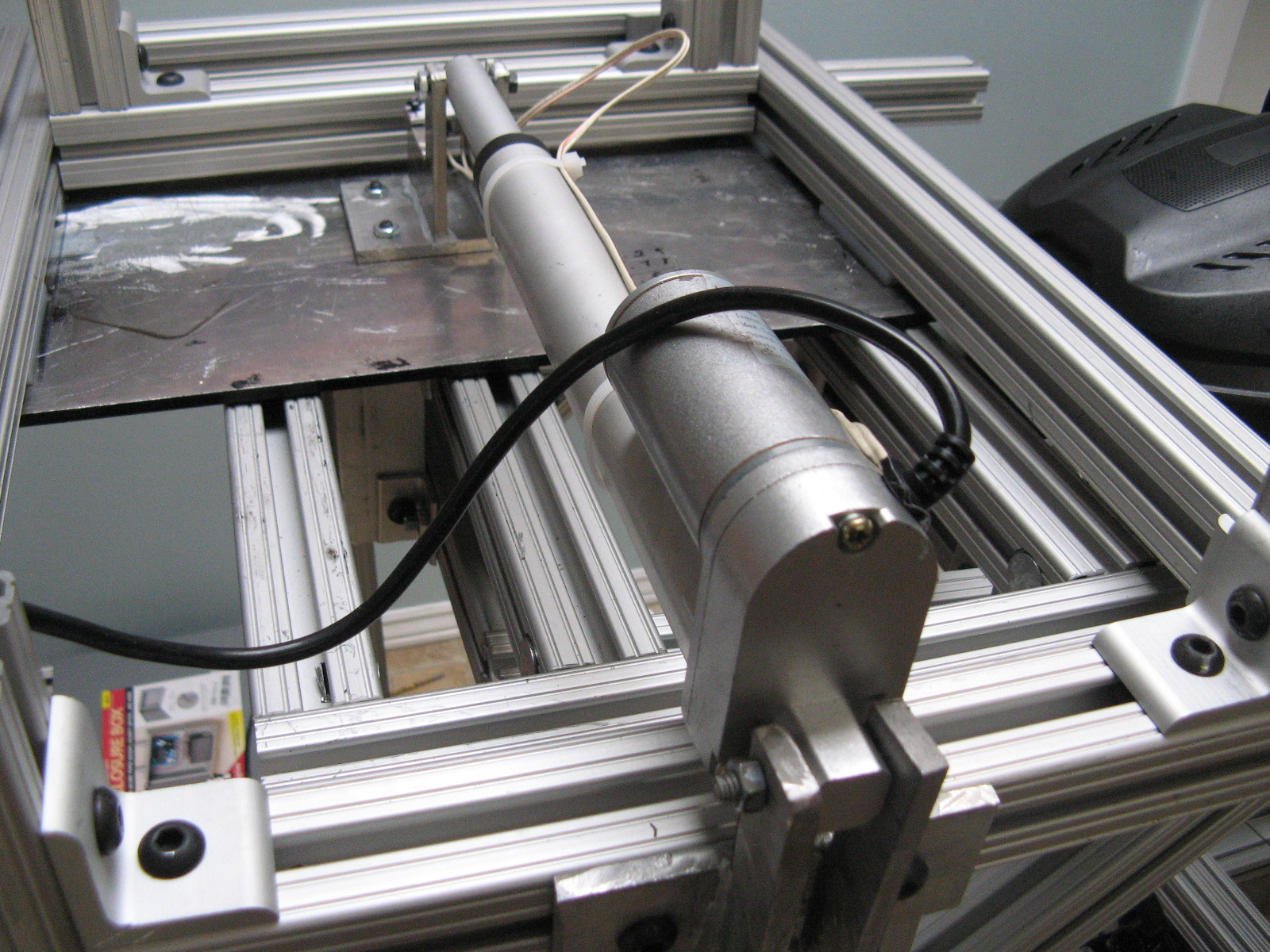

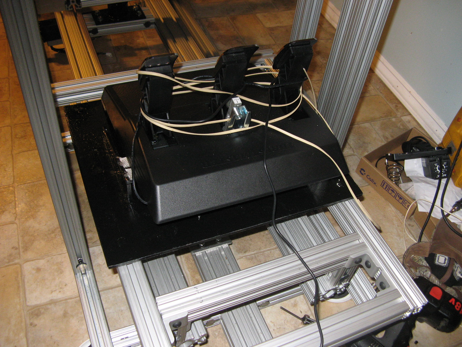

    More detailed view of the pedal base, with a 8" stroke linear actuator for pedal longitudinal adjustment. (It will be controlled from a control box mounted on the steering wheel support plate.) IMG_5833.JPG

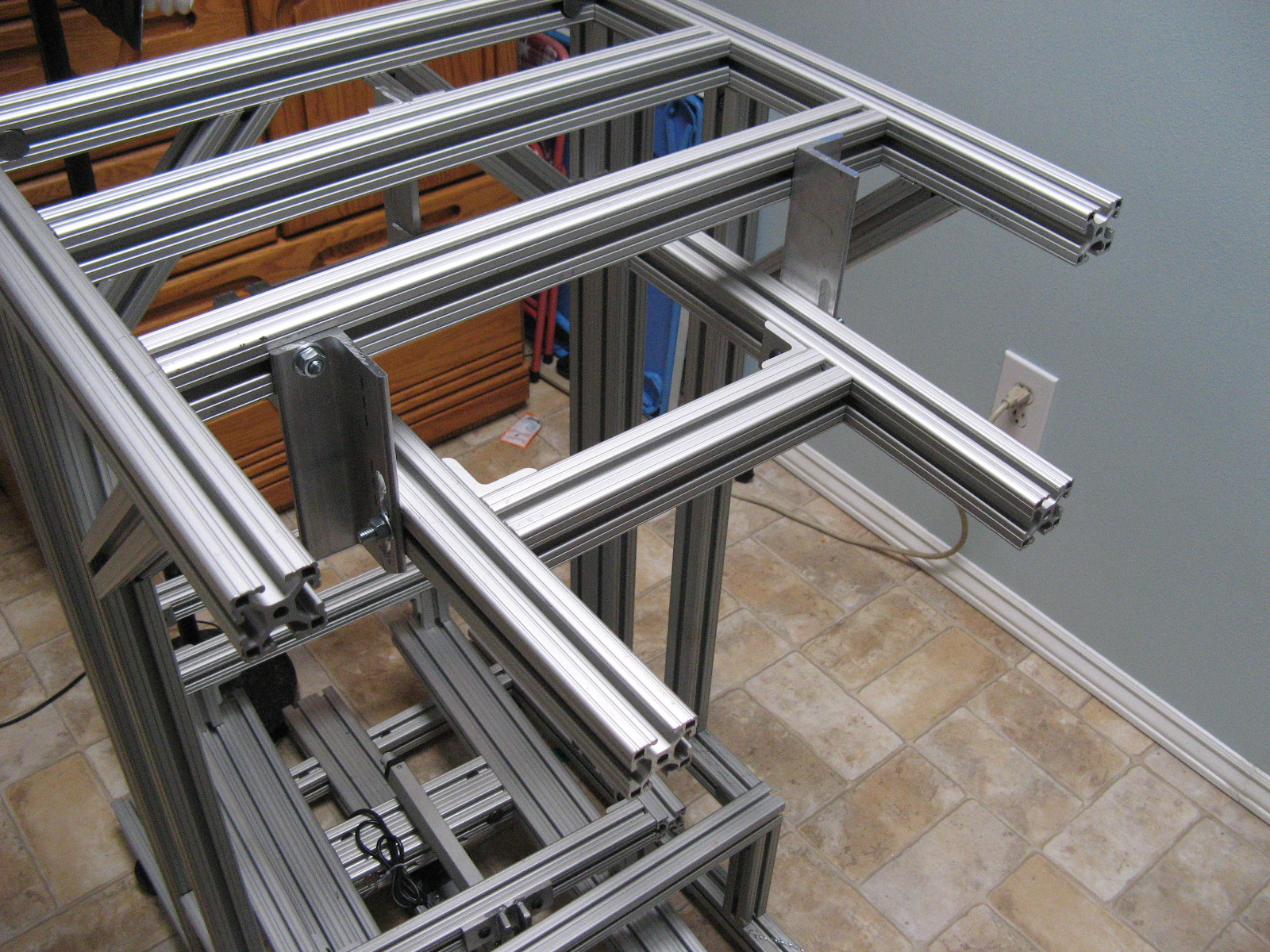

    This is the current stage of the project. I have the steering wheel plate support assembled, except for the adjustable front mount, the seat base assembled, minus the universal joint, which I had to send to a shop for welding to the top plate.

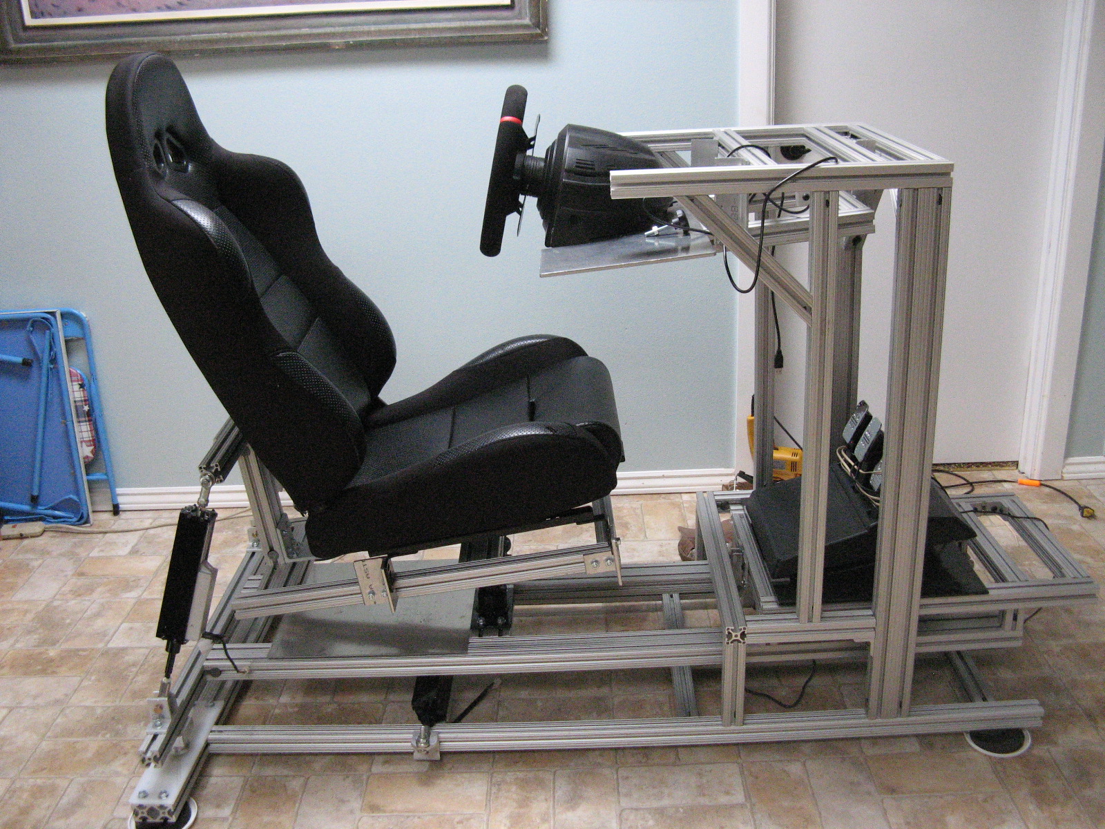

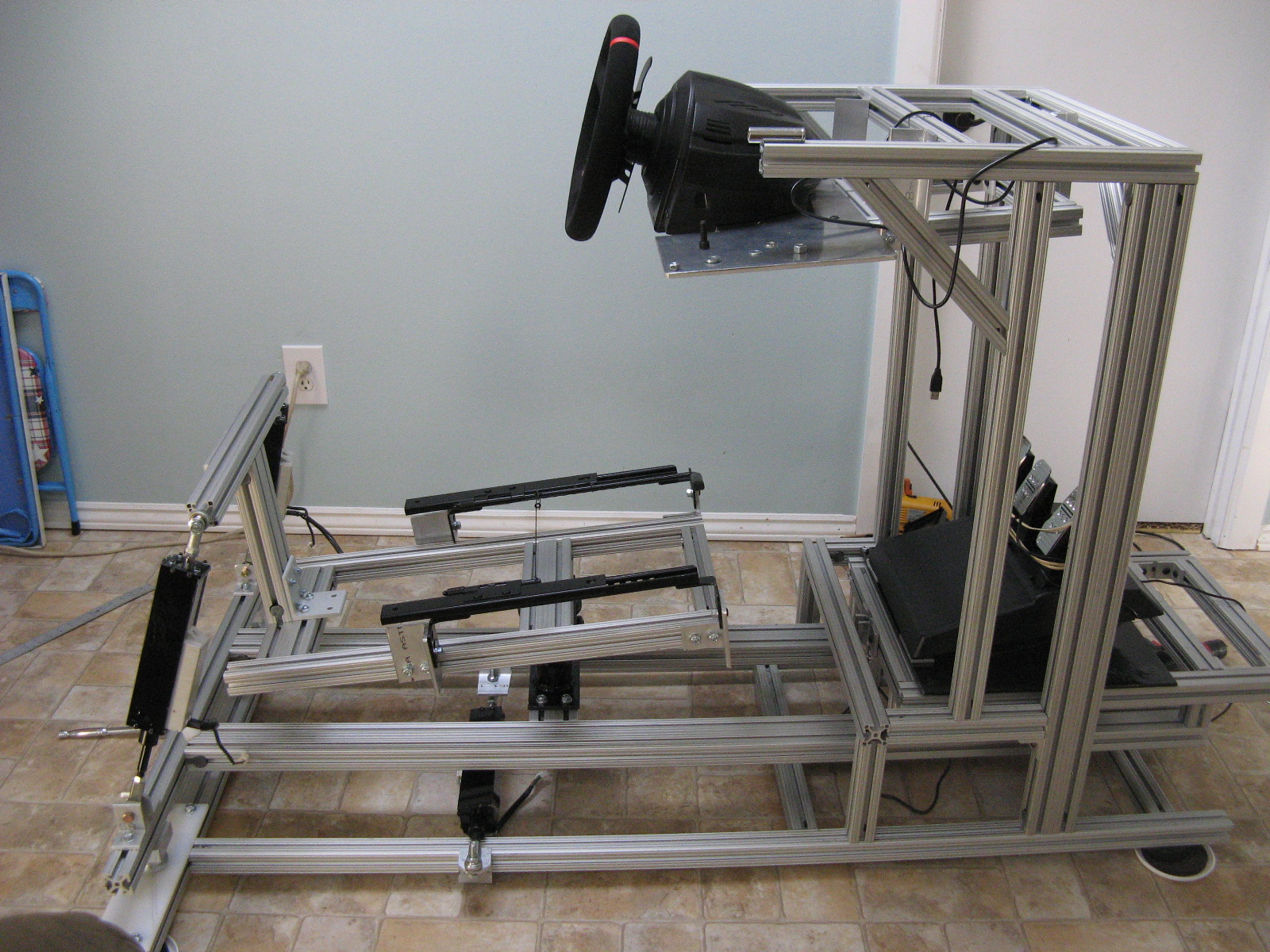

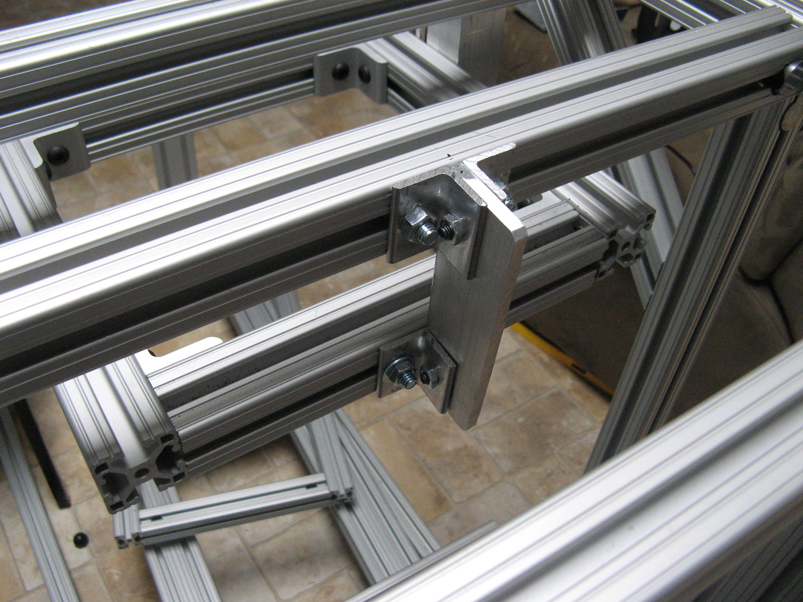

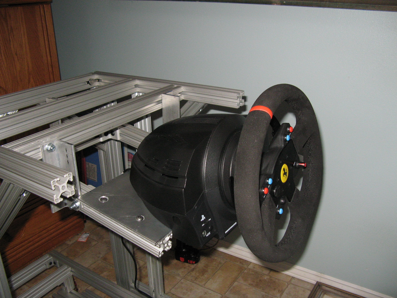

    Finished the assembly of the steering mount. The following pictures show details of the rear and front steering mounts, the steering support frame, steering mount plate and also the seat base. IMG_5838.JPG IMG_5839.JPG
    The steering position is very comfortable. The seat base is ready, I will pickup tomorrow the u-joint ( being welded to the top plate) and the three front SCN5 front plates.
    Picture of the seat base.

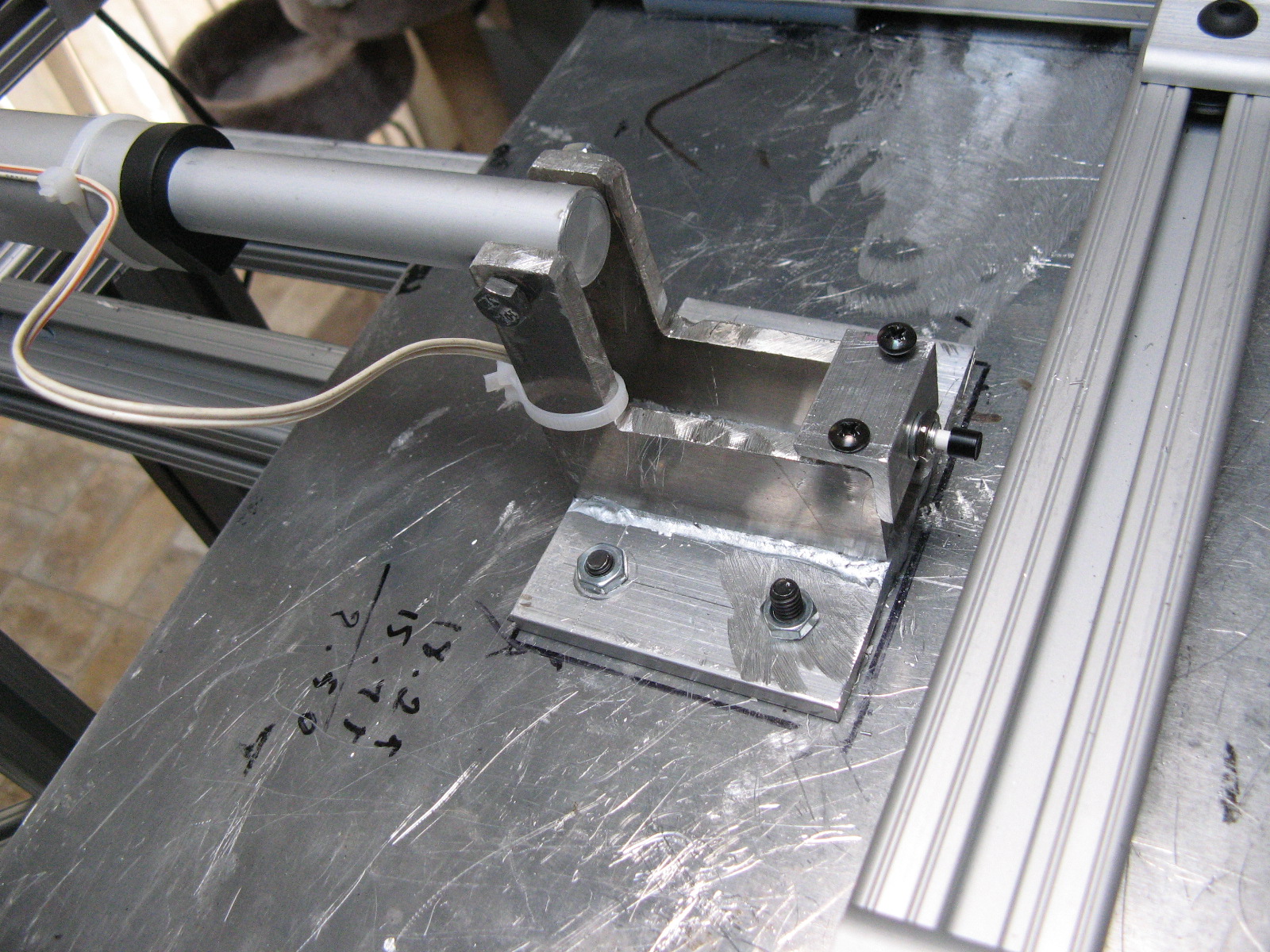

    You can see details of the pedal adjustment front mount, with the limit switch for end of travel movement. Also details of the rear linear actuator attachment.
    Next you see the pedal base at maximum extension. Pedals can be moved forward approximately six inches.

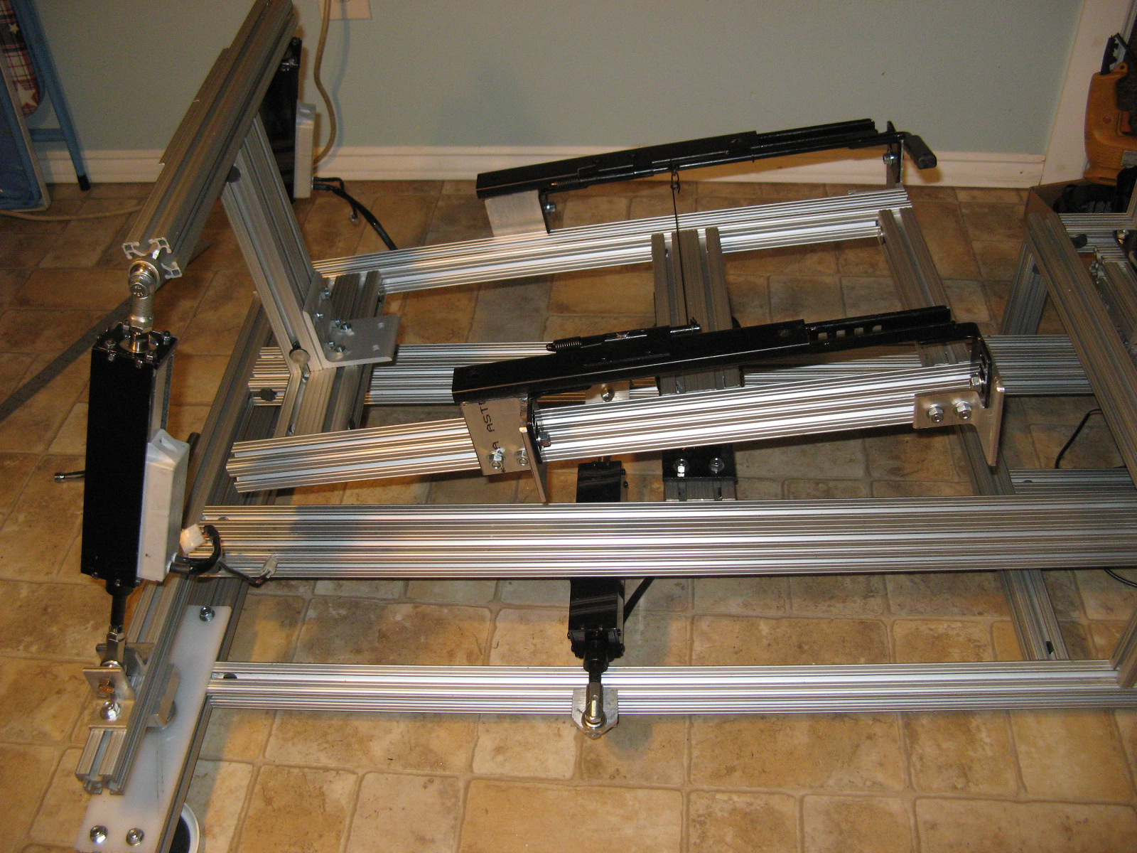

    Here is a picture of the seat base already attached to the u-joint. Tomorrow I will install the three SCN5's, install the pedals, after adding the load cell to the brake pedal, and I will be done with the mechanical part of the rig. I will then wire the SCN5's and build the enclosure for the monitors.
    I had to take a break: my back got messed up. Better now, so I made some progress.
    Inatalled the SCN5's>
    Modified the pedal mount, to raise the front about a couple of inches, for more comfortable position.
    The seat was installed; I might have to re-balance it by moving the u-joint back about two inches.
    After the installation of the monitors, and finishing the electrical connections, including the button box, I will start testing and fine tuning. I have a feeling that the steering wheel will need to be moved about one inch forward, for more comfortable arm position. It is not bad now, but I think it can be improved.
