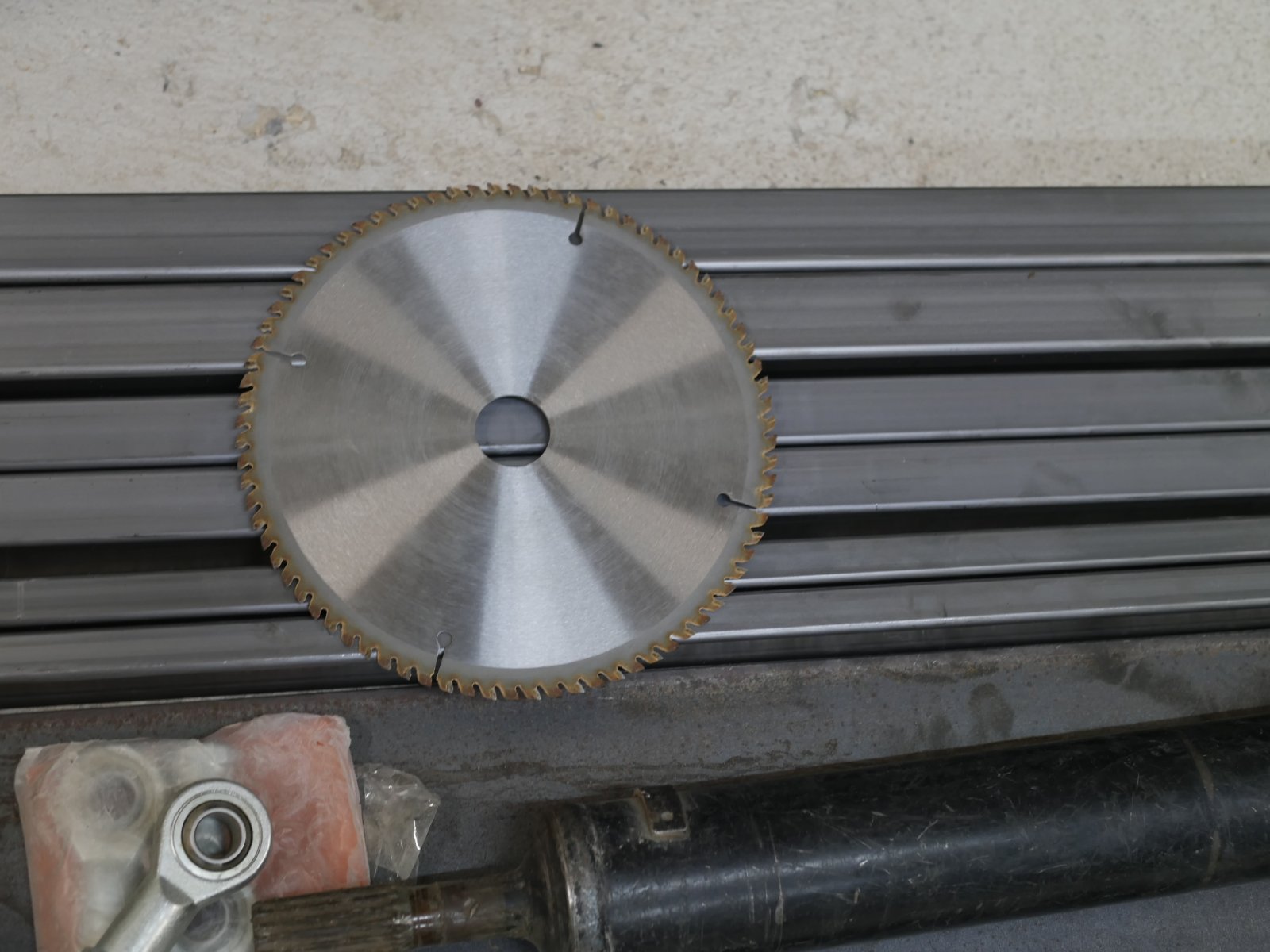

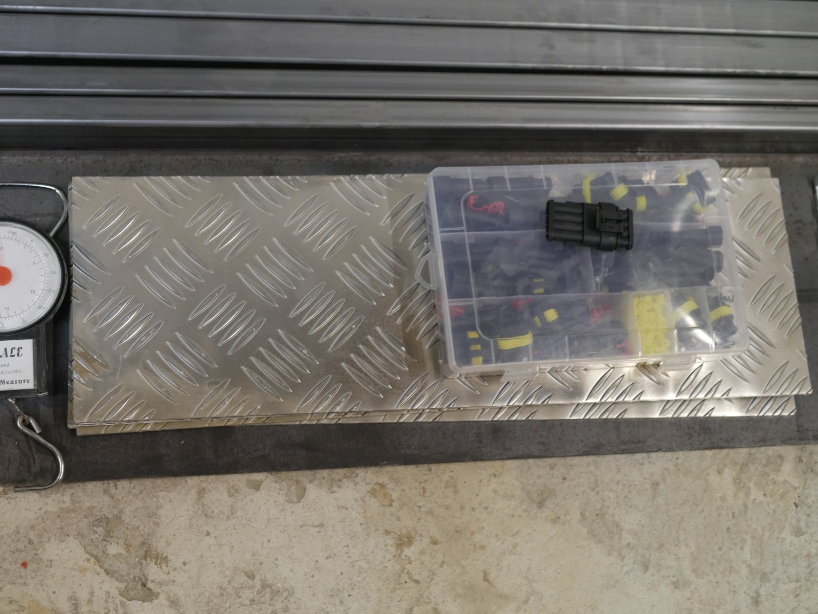

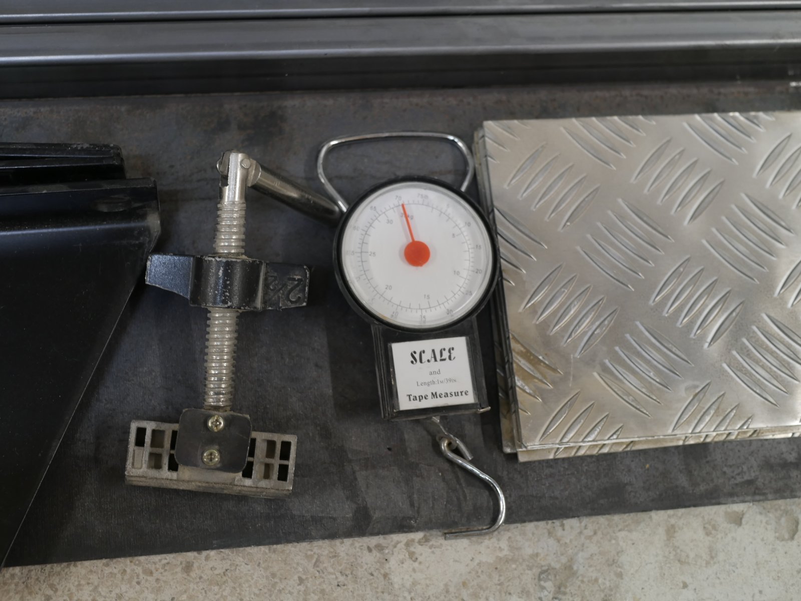

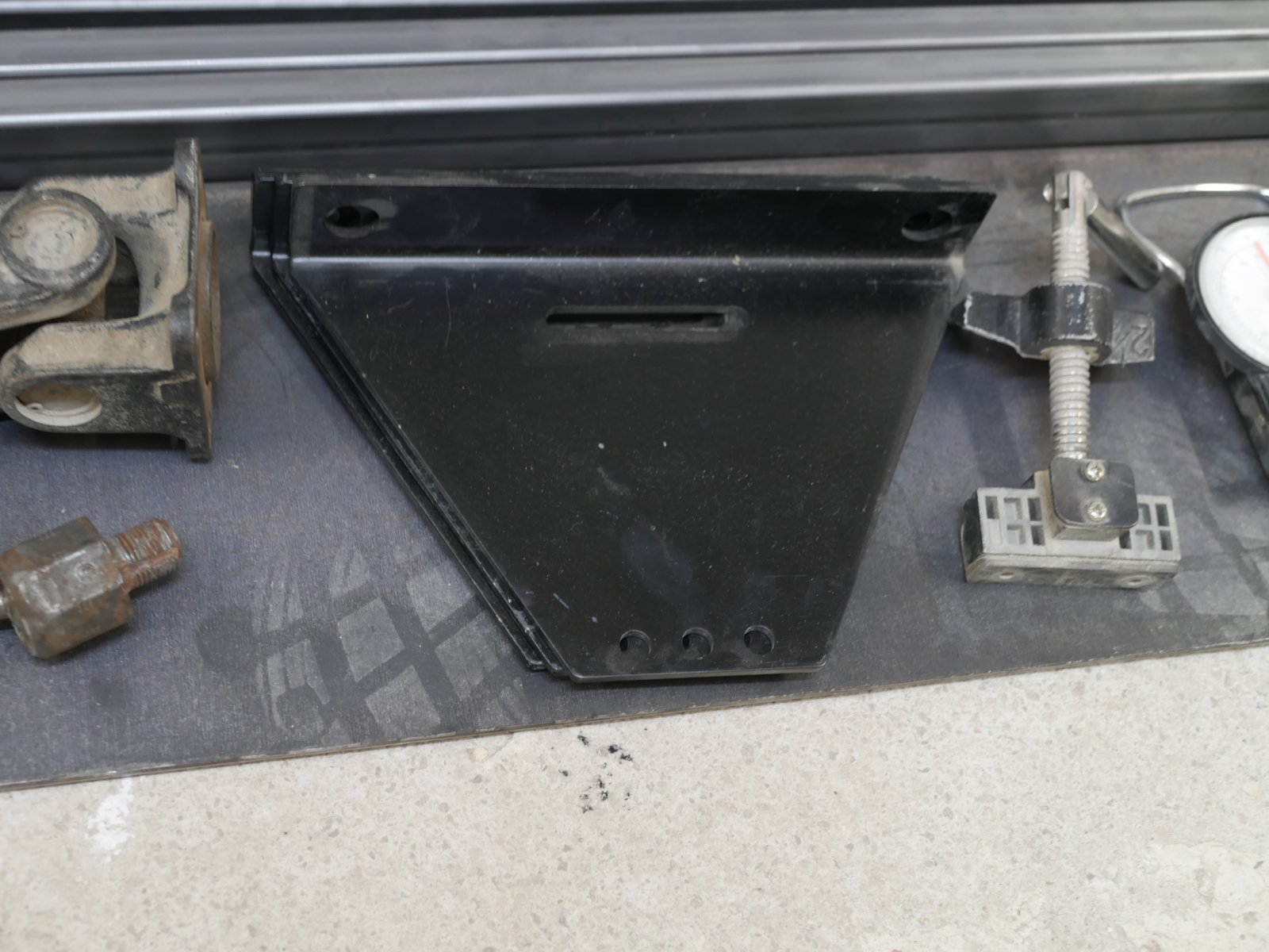

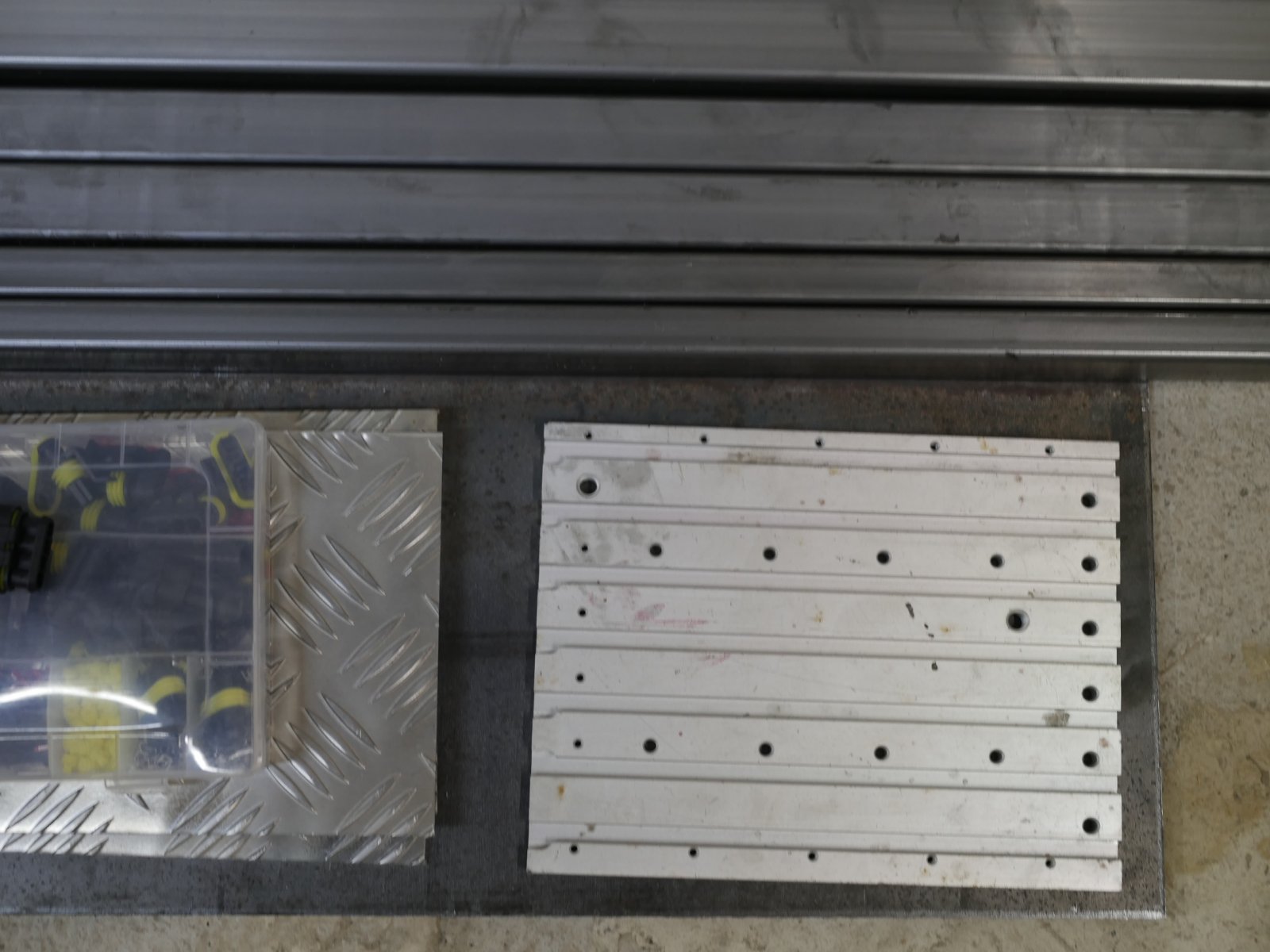

    I will update this message with the entire manufacturing process and cost (12/4/2022)

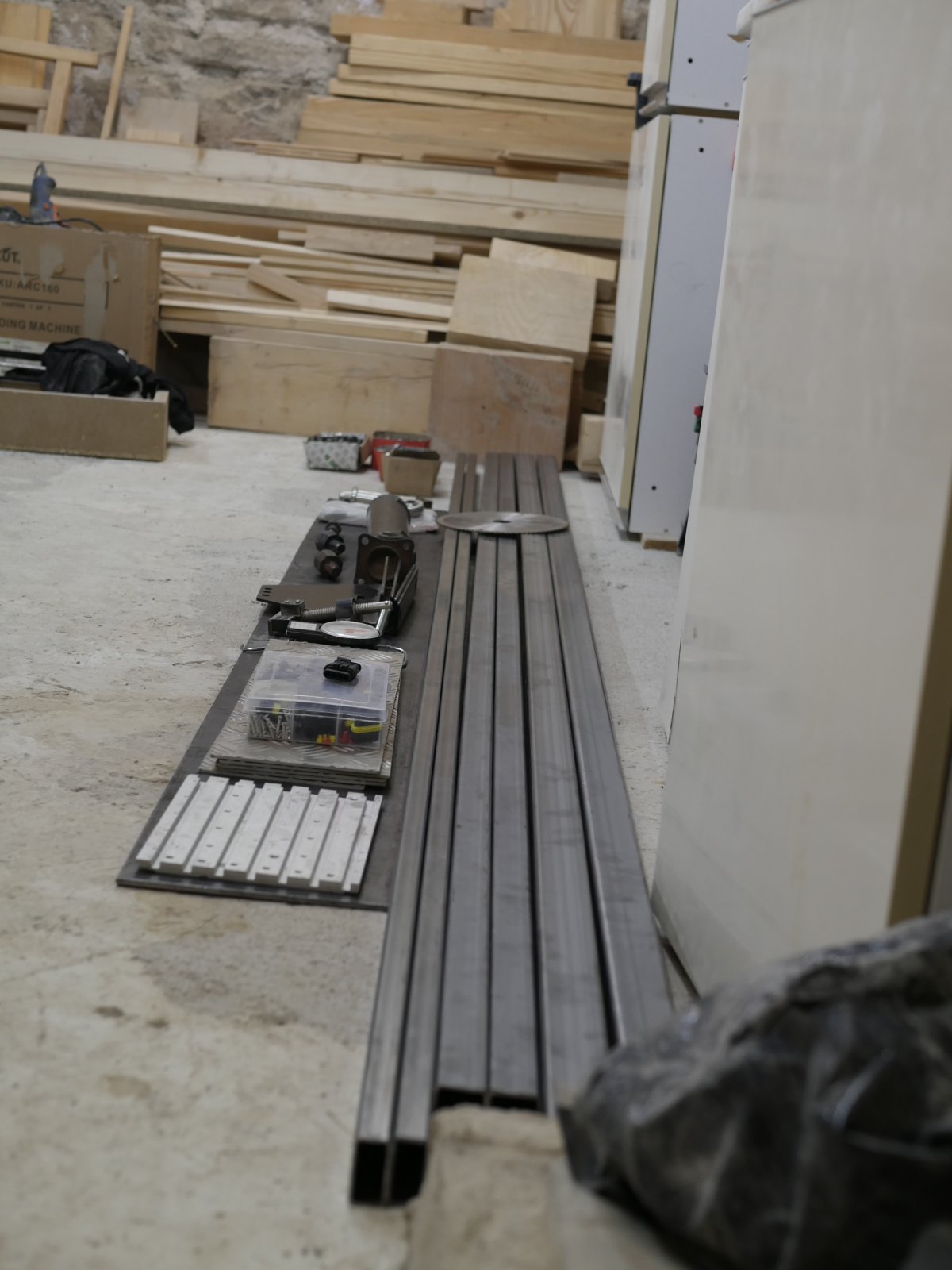

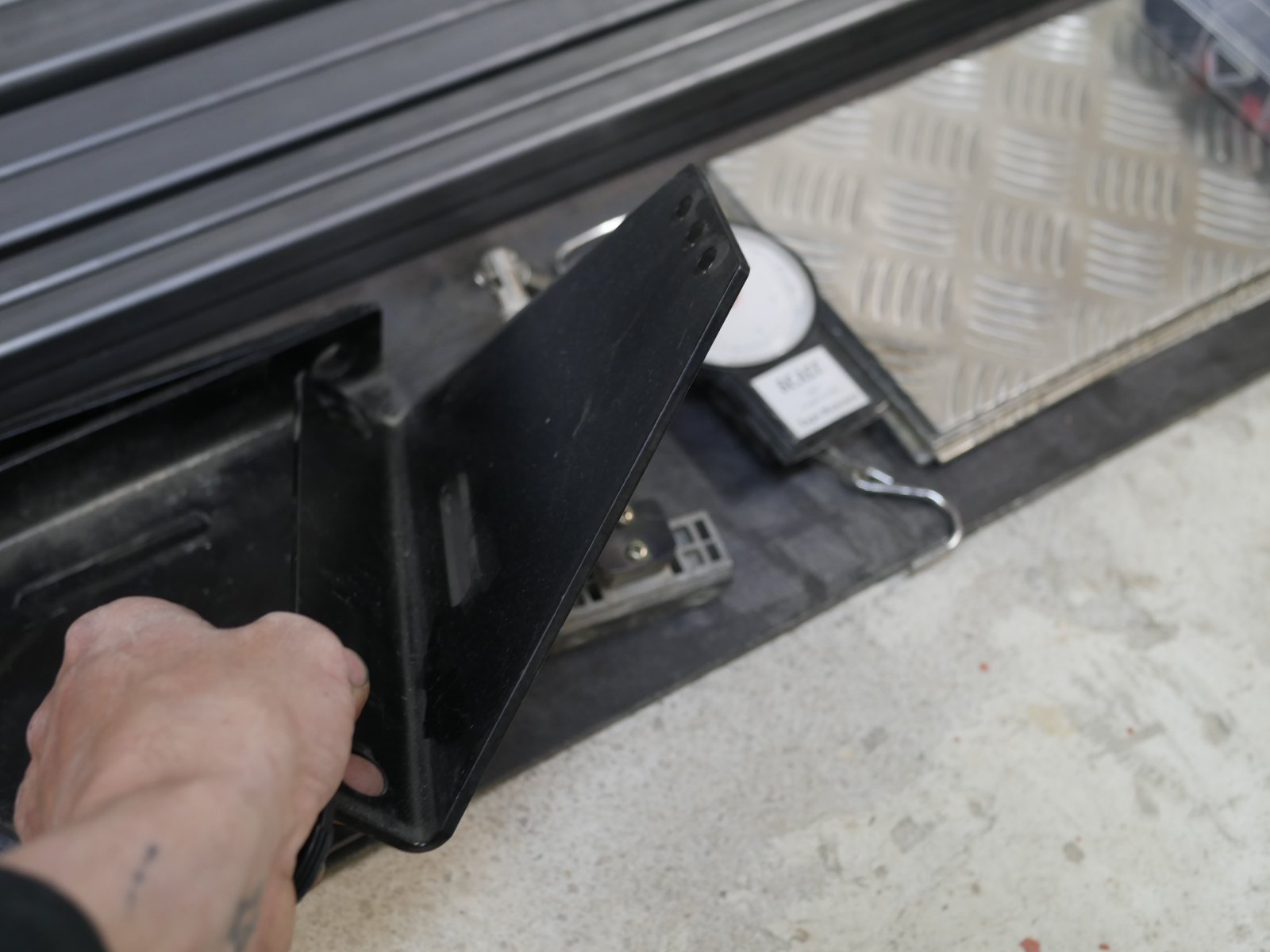

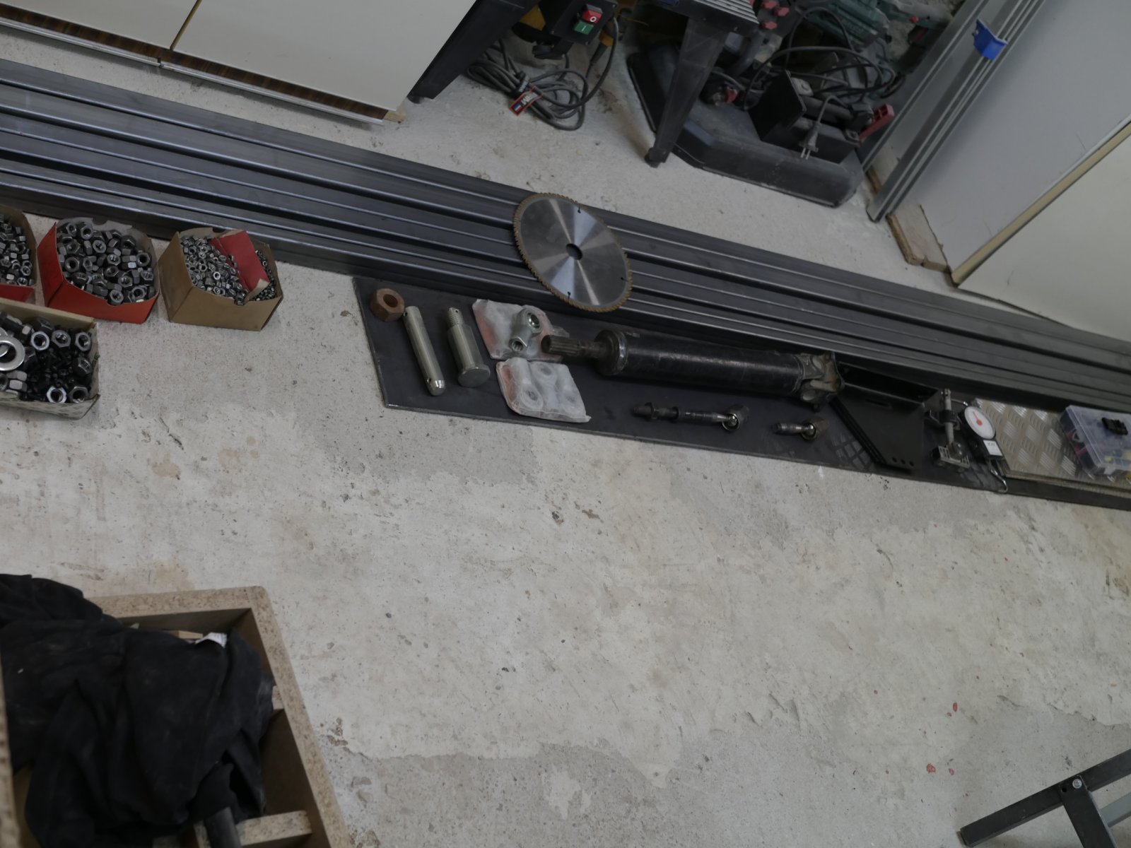

    Well, finally this morning I went shopping to build my DOF Nebuchadnezzar :)
    He hasn't decided on the motors yet...or anything electronic, I hope to carry out the project with everyone's help!
    But for now I have work to start.

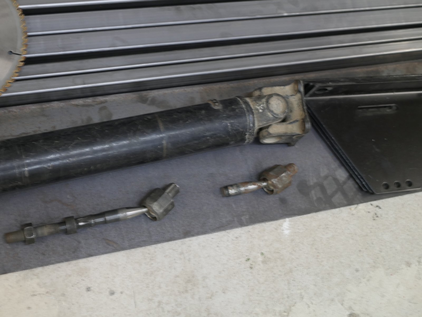

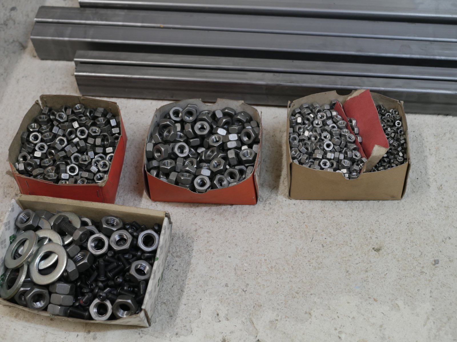

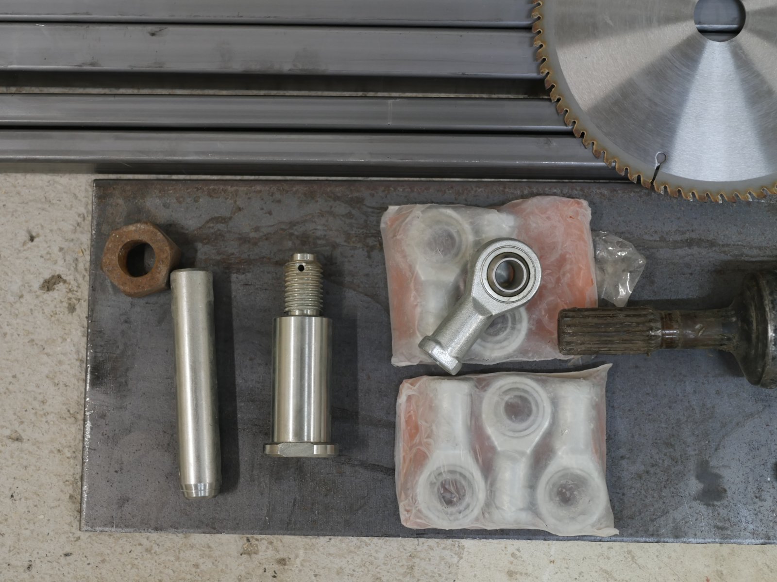

    I went to the junkyard to buy candy:[​IMG][​IMG]
    Cardan 8€
    Ball joints 2€
    Old circular saw blade (to make CTN arms) is good and strong steel
    4mm steel squares x4 7€
    3mm aluminum sheets x5 12€
    Connectors (Amazon) 13€
    arms 16mm x6 4€
    35mm steel shaft for loss of traction 2€
    Steel bars and Steel plate ( Traction loss) 5mm 141€
    50x50x2 mm Base Structure
    40x30x2 mm Platform lost traction and steering wheel and pedals
    40x20x2mm Seat structure
    Little by little I will collect the rest of the necessary pieces
