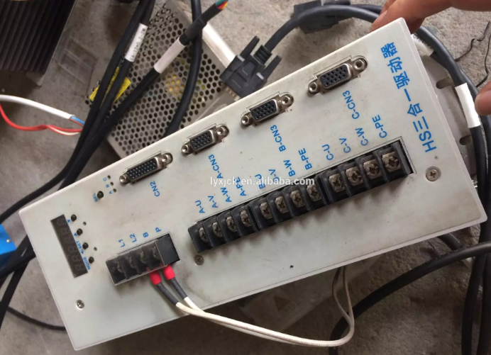

  6. Kenza
    Kenza New Member
    Mar 3, 2019
    13
    126Coins
    I'm working with these motors https://www.alibaba.com/product-det...spm=a2700.details.maylikeexp.1.42cd6aecbJG194
    That's why I was asking about the pots..
    Q1 : Should I use Pots?
    Q2 : Is it possible to use SMC3 code with these motors ?
    Q3 : These motors come with this 3-in-1 servo drive (see picture), What should I use for the control part ? does it still the same (An Arduino UNO card + 2 monster moto shields) ?????
    I'm waiting for your answers !
