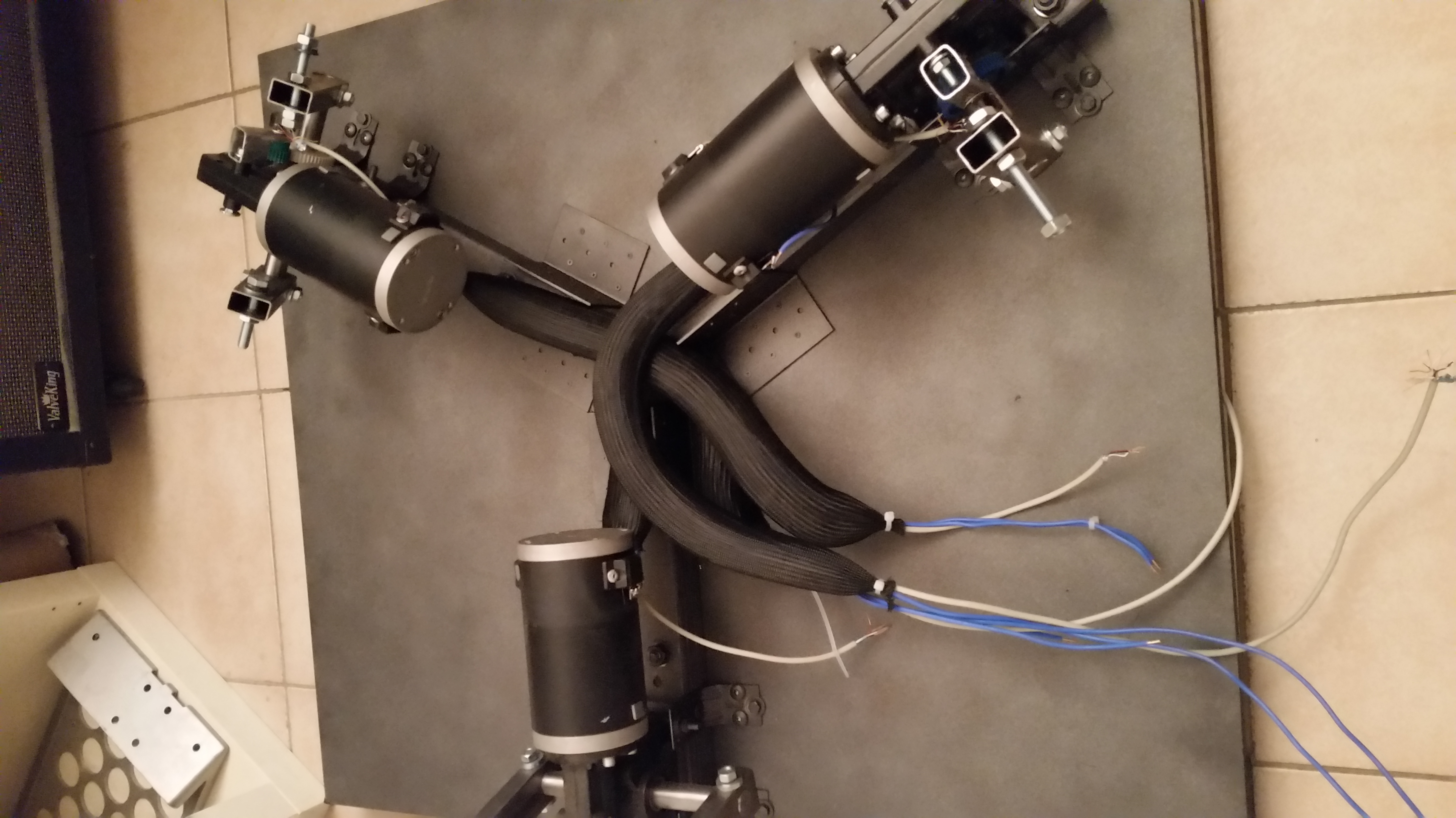

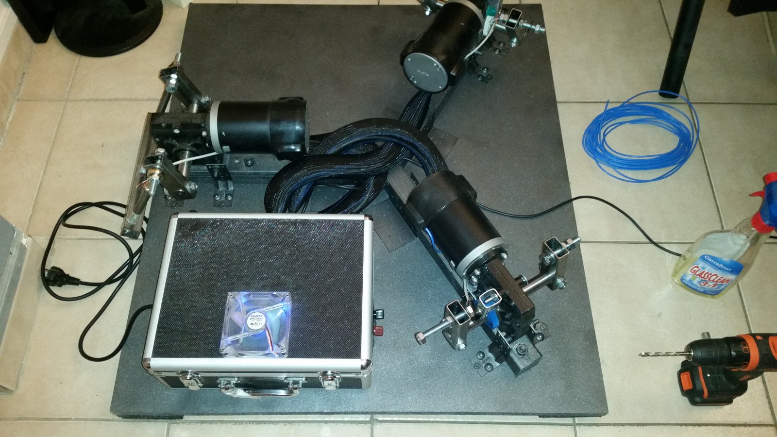

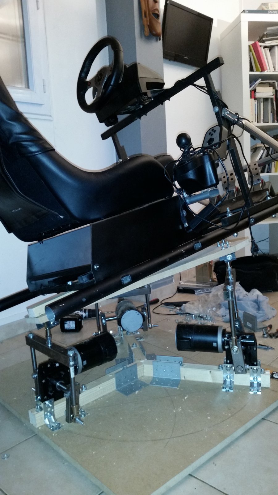

    Here my 3 Dof Sim! 8 months to work on.... I'm not really good i know :) but its work!

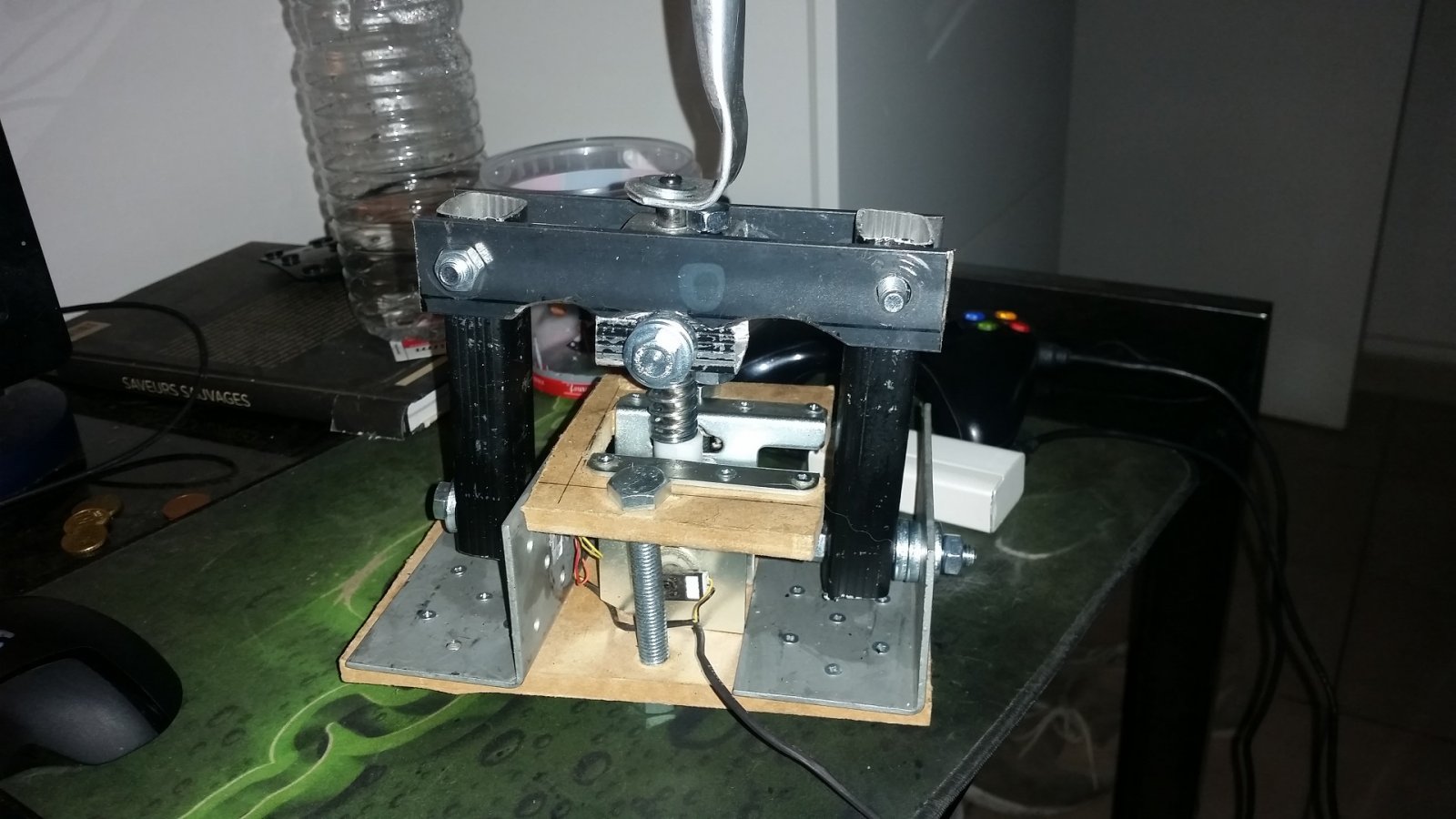

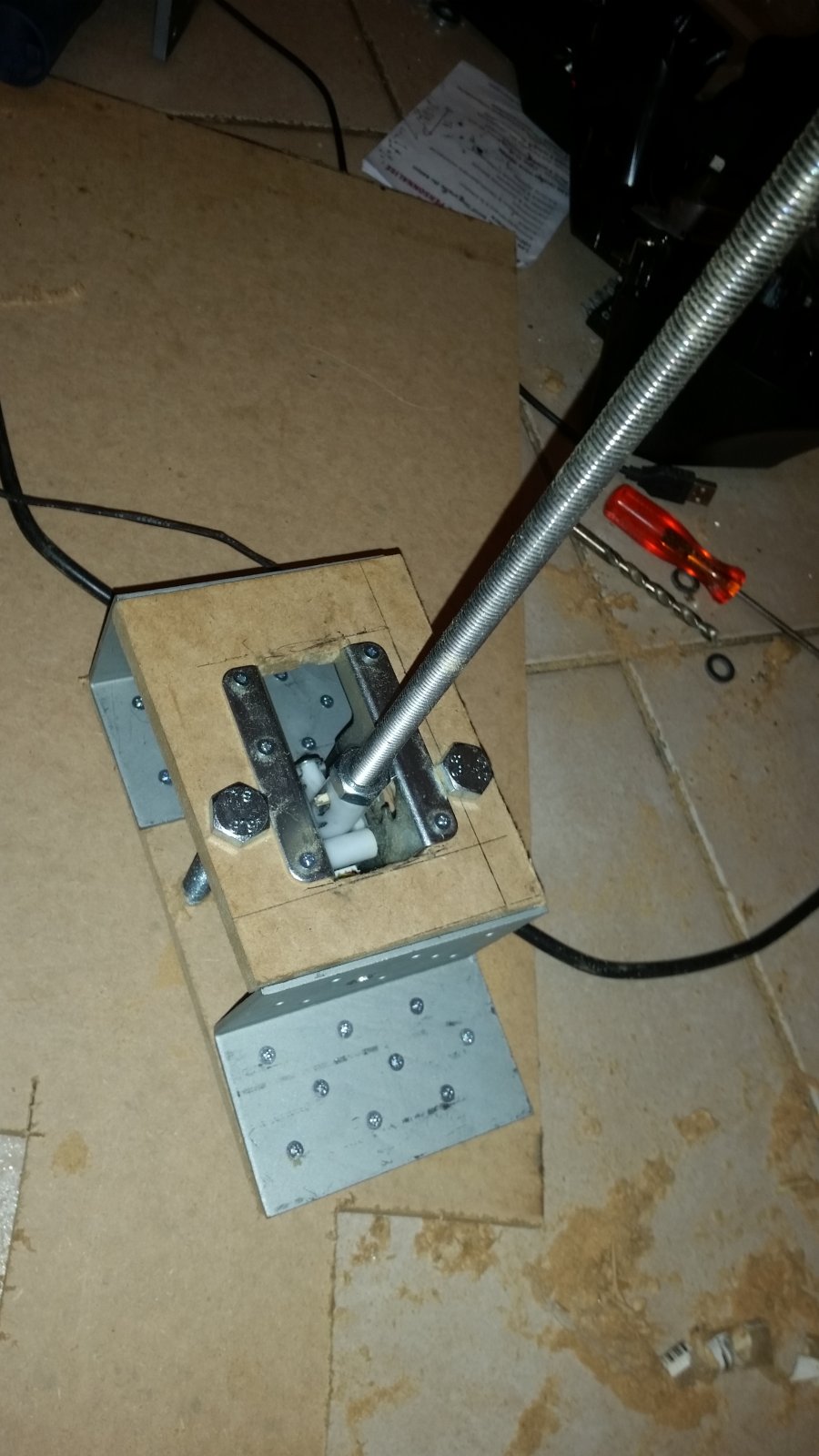

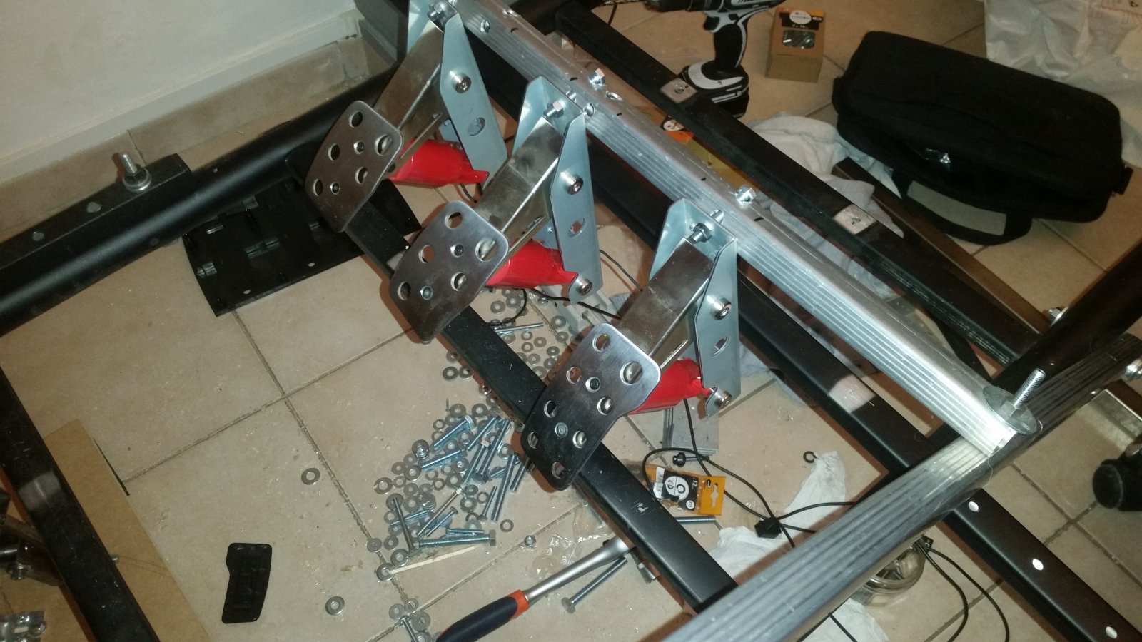

    inverted clutch:
    shift for my big hands:
    anti slide:
    miss just one thing, Simtool2.0!!!!! coming soon!

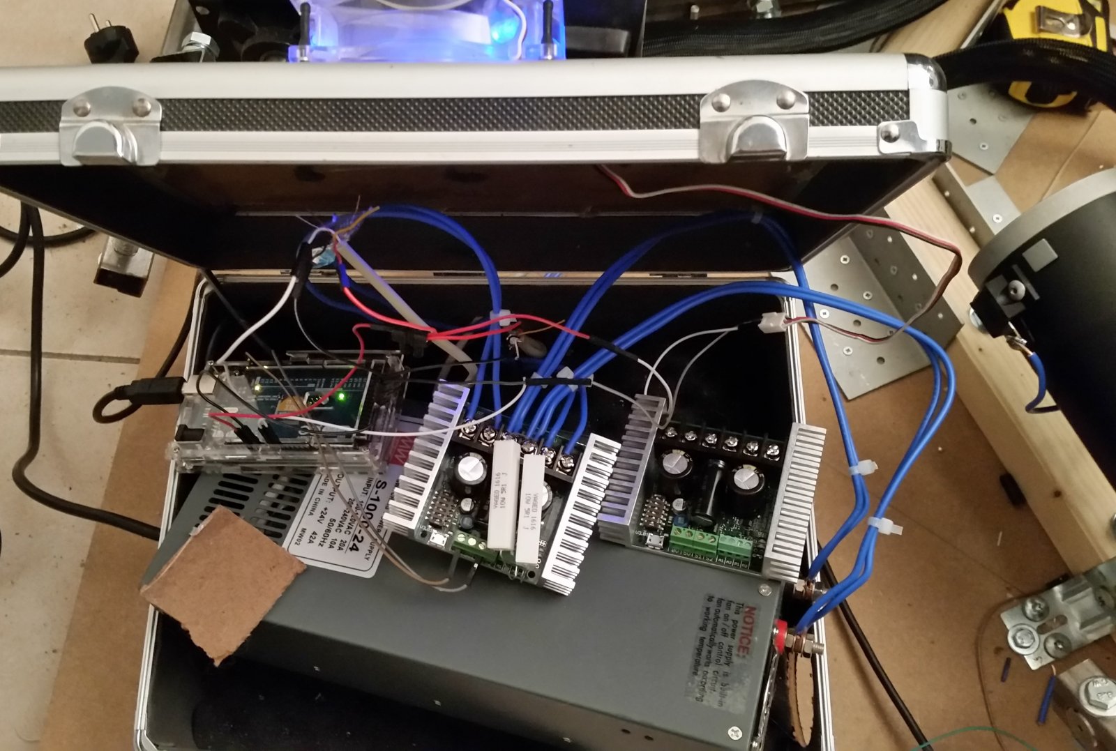

    Hi Demosux and welcome to XSimulator.net.
    Please post some pictures/details of your electronics for the sim. What are you driving the motors with? What motors are they (wattage, ratio,rpm,voltage, etc). How well do the lift the driver?

    some details:
    2 sabertooth 2x32A to drive the 3 motors
    1 power supply 1000W 42A
    1 arduino mega for the code
    350W Dc motor 42Nm

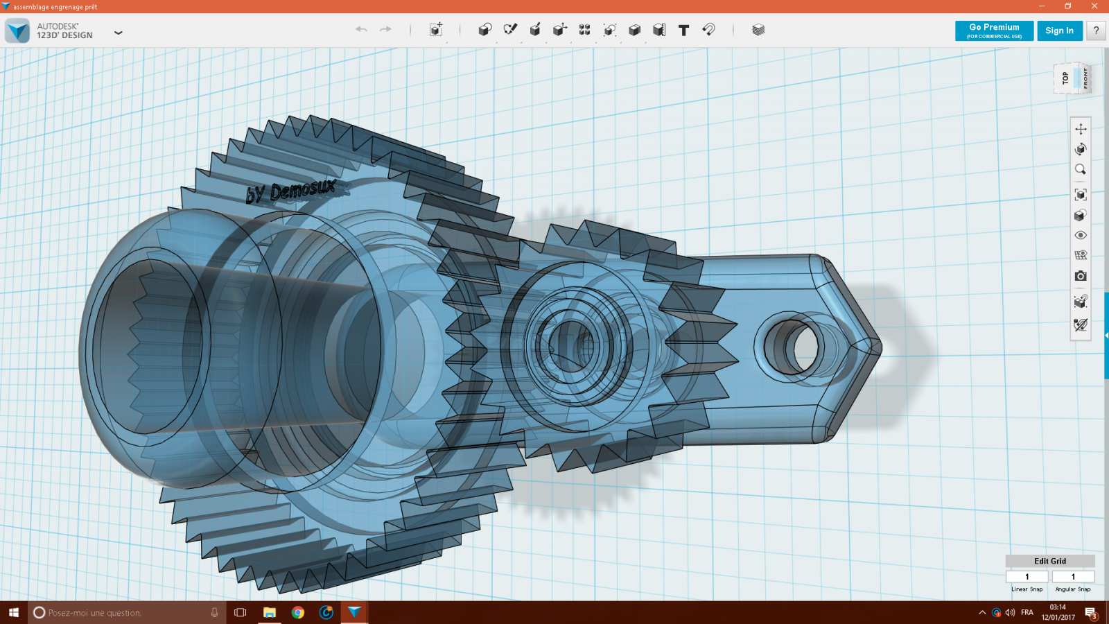

    my gear box

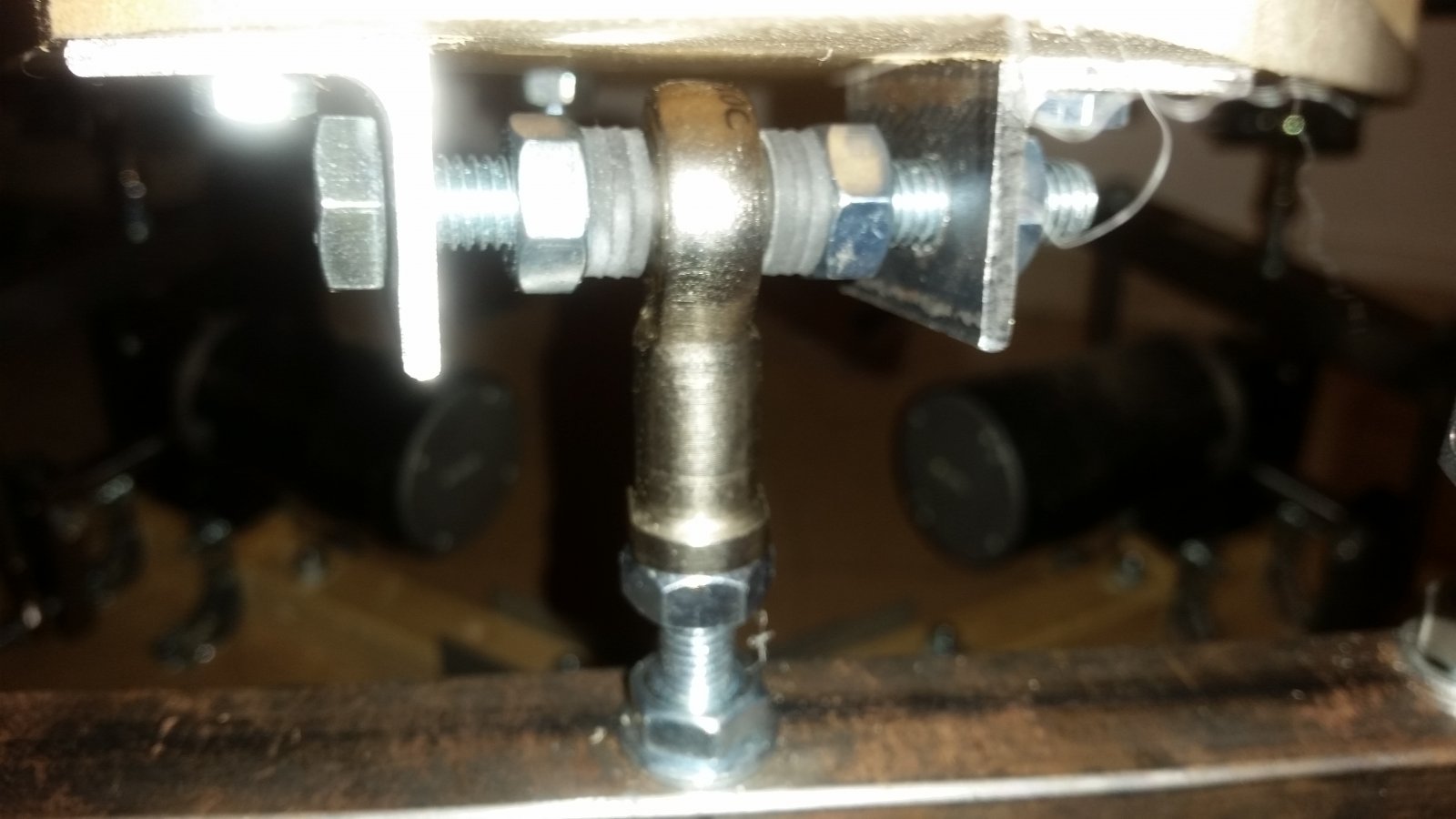

    the way to up the plateform
    The position sensor for a pots, (123design) 1/DC motor.

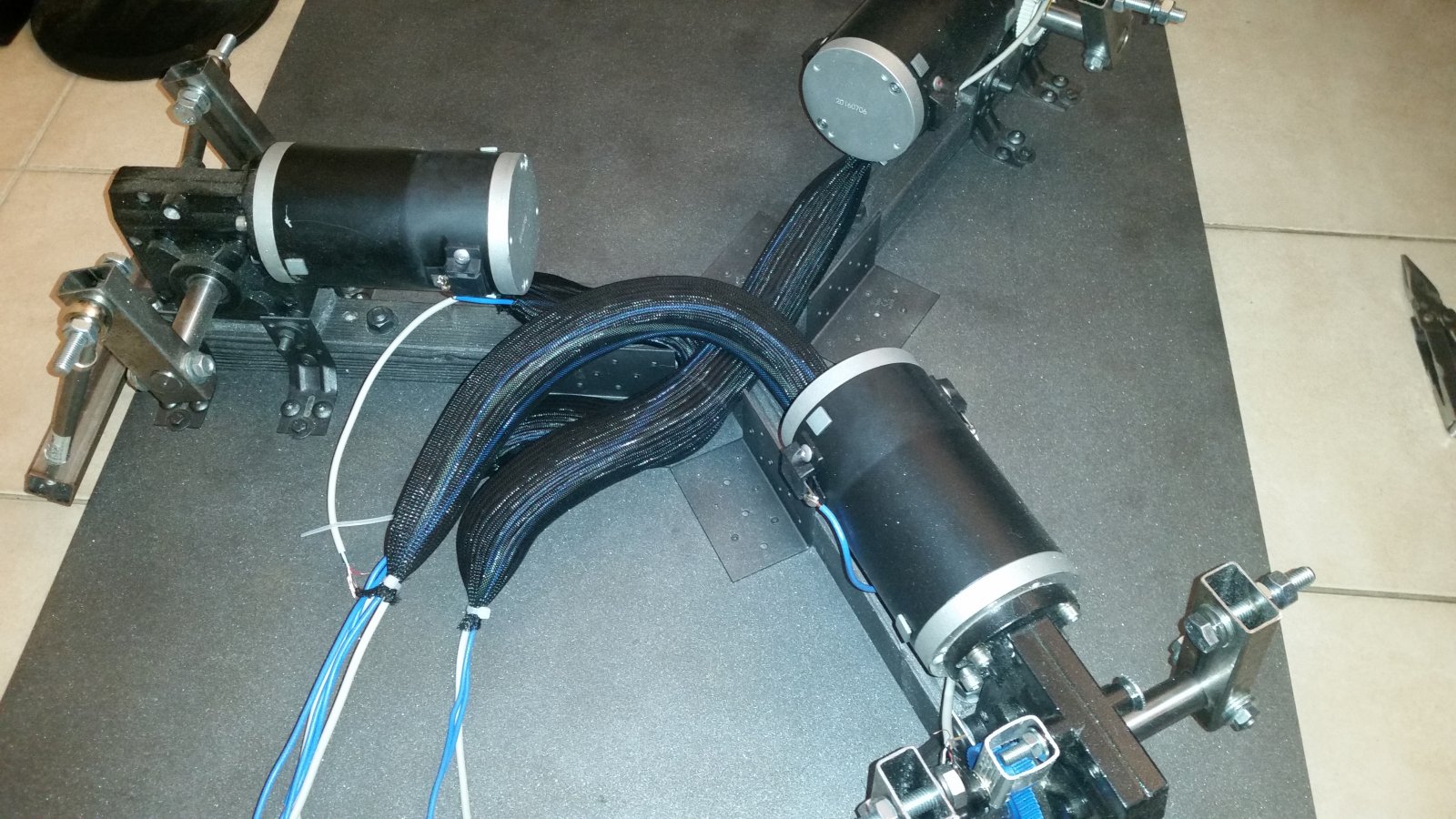

    Today, time to paint and wires cleaning! Tomorow i do the rest (cokpit)

    Very interesting. Can you please give some more information about the motors? Brand, and where to buy?

    interesting how you installed the arm lever on the motors, Nice platform :thumbs
    A short video could be interesting to see !:)

    what is the RPM or ratio of your motors ? and where did you buy it ?
