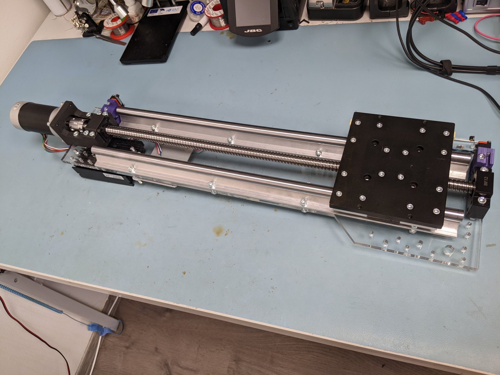

    For this I first built linear actuators. I got inspiration from FlyPT - 6DOF Brushless DIY Actuators project and have chosen many parts from that project.

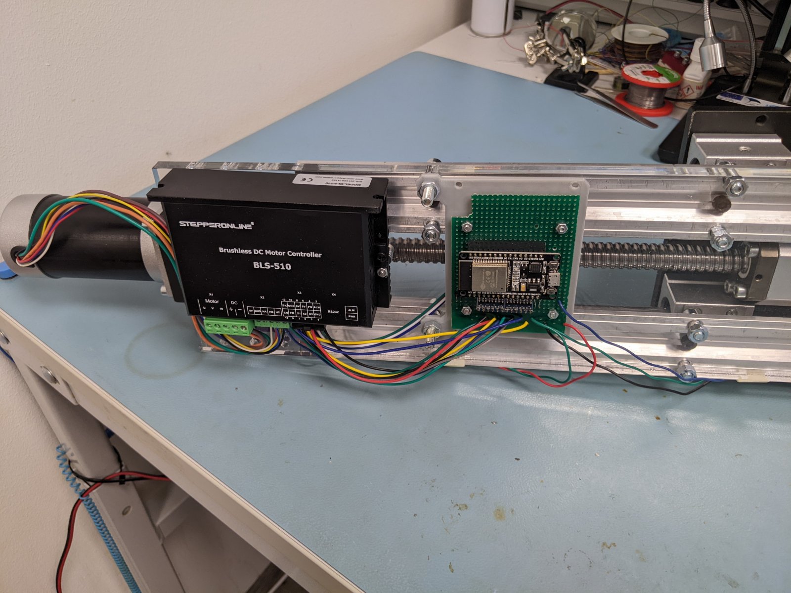

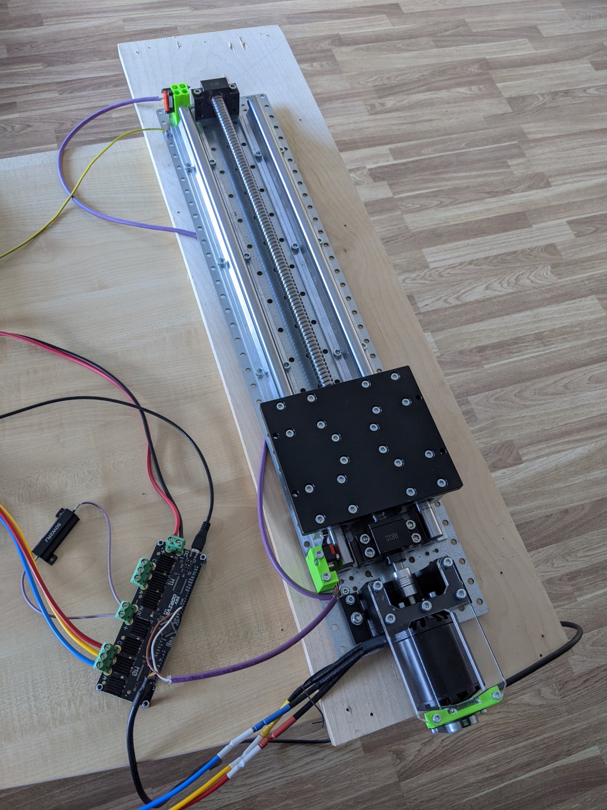

    Actuators are using SFU1605 ball screw rods with 36V 4000RPM 0.44Nm 184W Brushless DC Motors from STEPPERONLINE with simple BLS-510 BLDC motor driver.
    I used ESP32 boards with firmware from FlyPT project to control actuators via USB interface.
    This is the first version of the actuator.

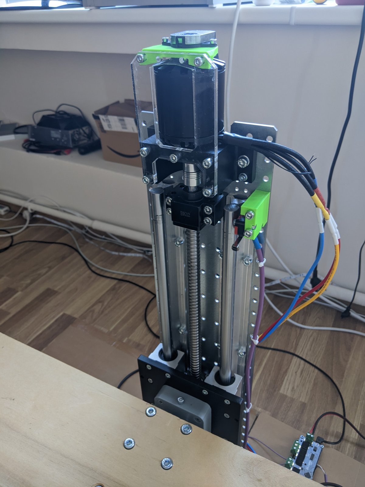

    Turned out that the motor of the actuator was not powerful enough to properly test motion platform. Also motor controller has not enough options for fine tuning actuator movements.

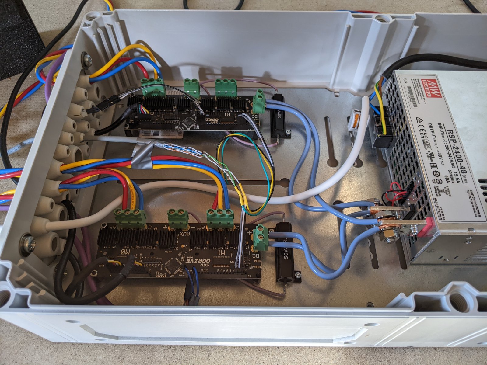

    So I improved actuator build with much more powerful motor and controller. For next ones I used D6374 150KV BLDC motor with max torque of 3.86Nm paired with AMT102-V 8192 CPR encoder. For motor controller I chose ODrive for plenty of control and power output. Also actuator frame is now made from steel.

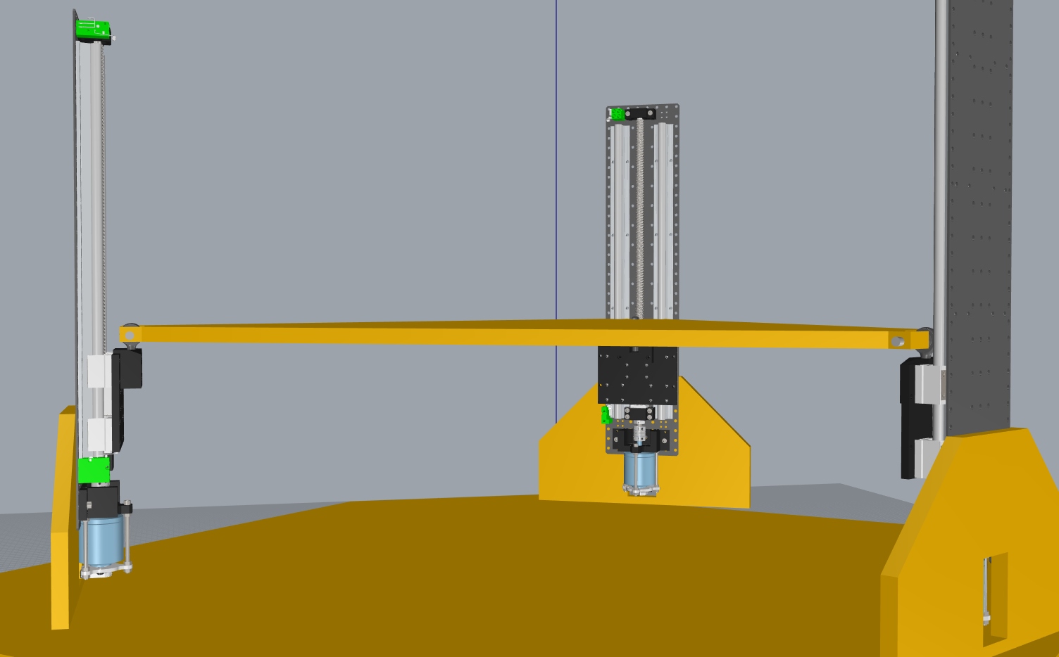

    Here is CAD drawing of platform.
    Actuators have cnc like mounting plate with mounting holes.

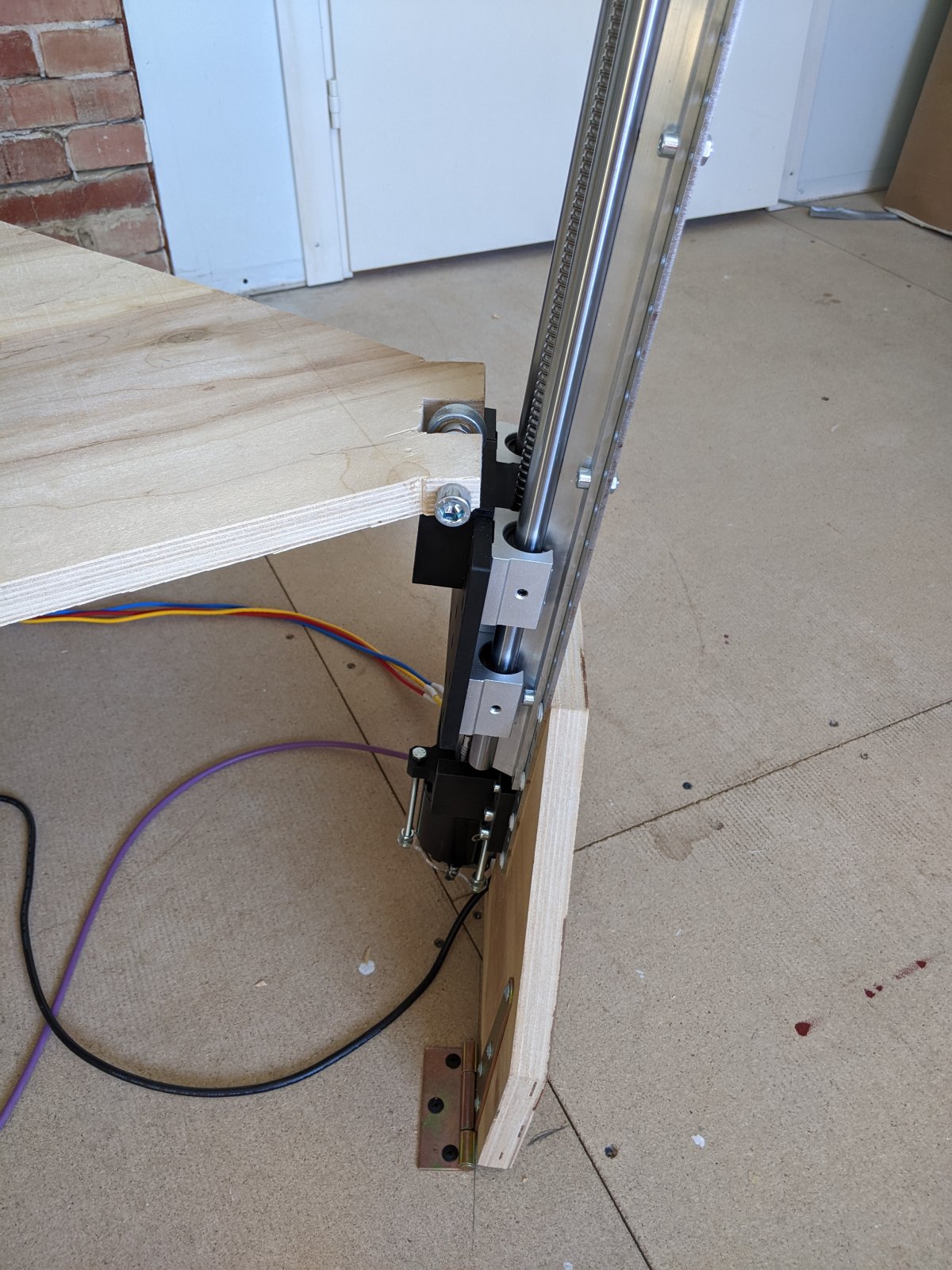

    Platform plate is connected with actuators using male threaded single row joint rod ends. They are fixed with 3D printed adapters to mounting plates. Other half is fixed to platform plate with long M12 bolts. Probably need to enforce those connections with plate.

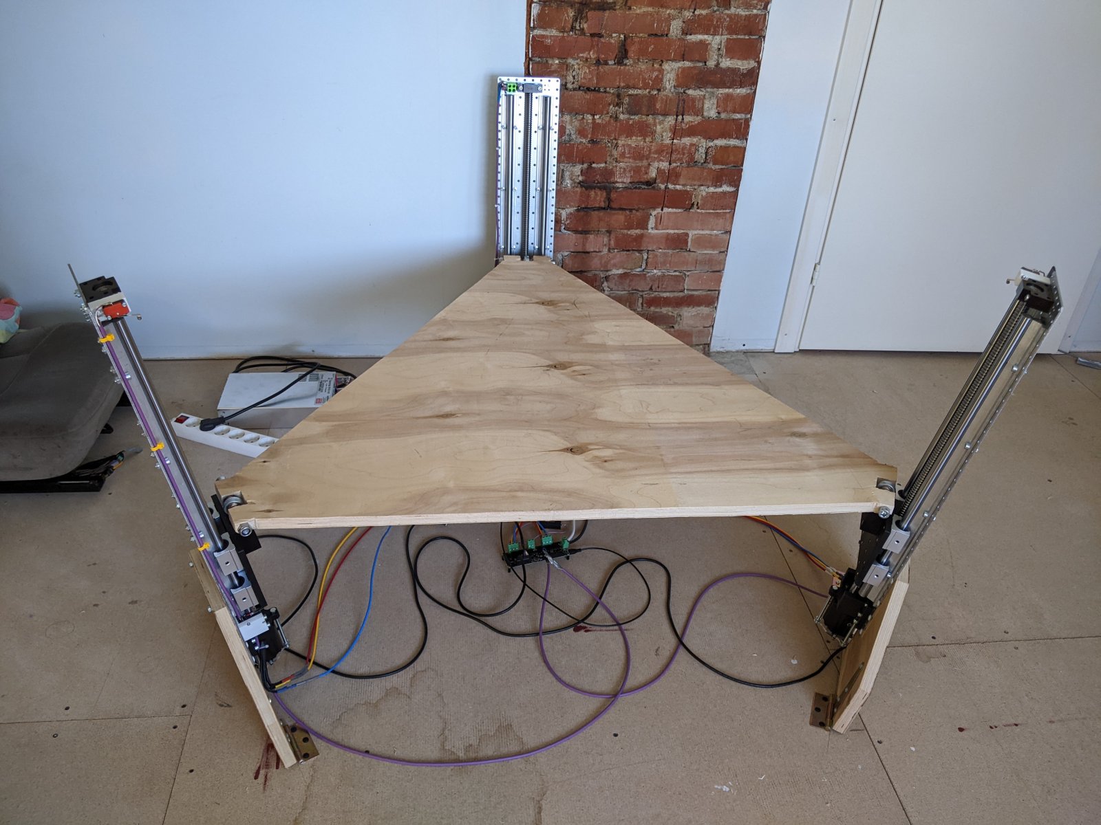

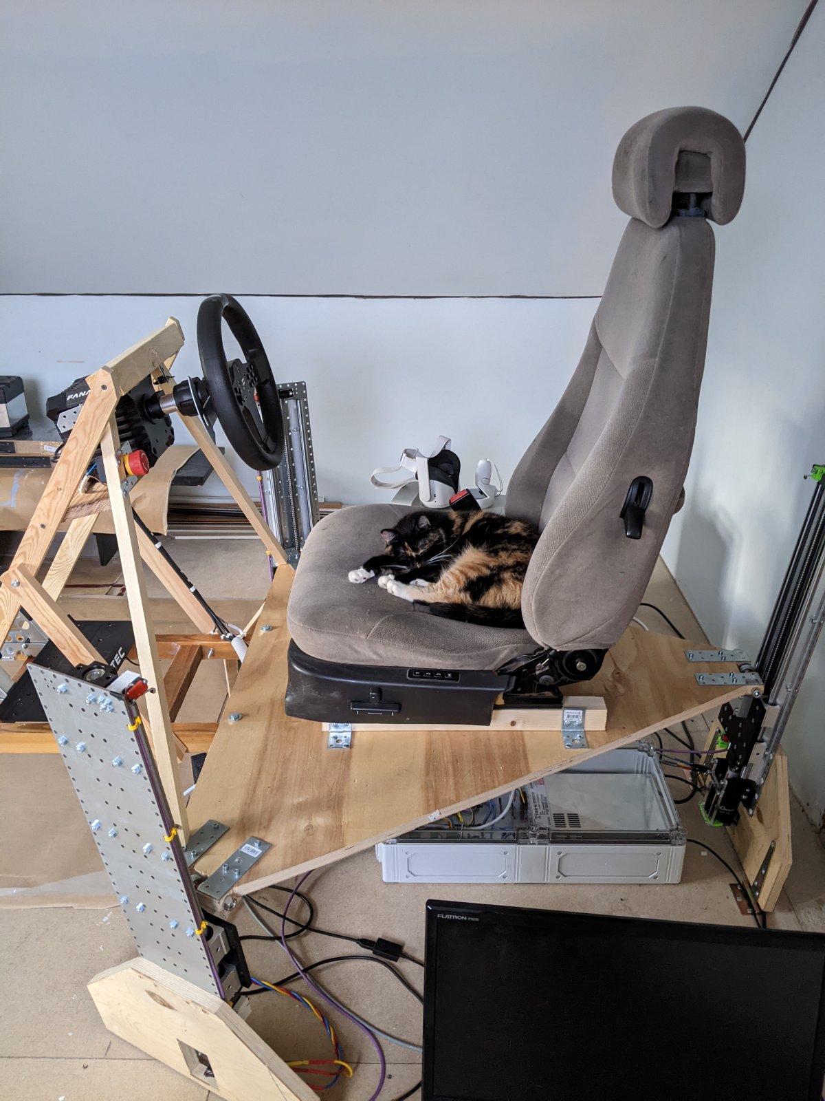

    and actual build this far. Screwed straight to the floor with hinges at the moment. Used 21mm plywood for plate.

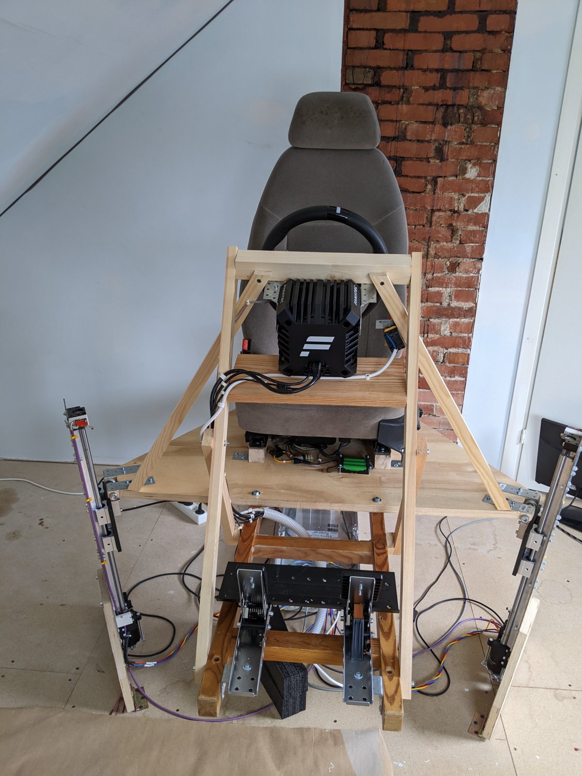

    Despite having difficulties finding time for the project, I finally have a working rig.

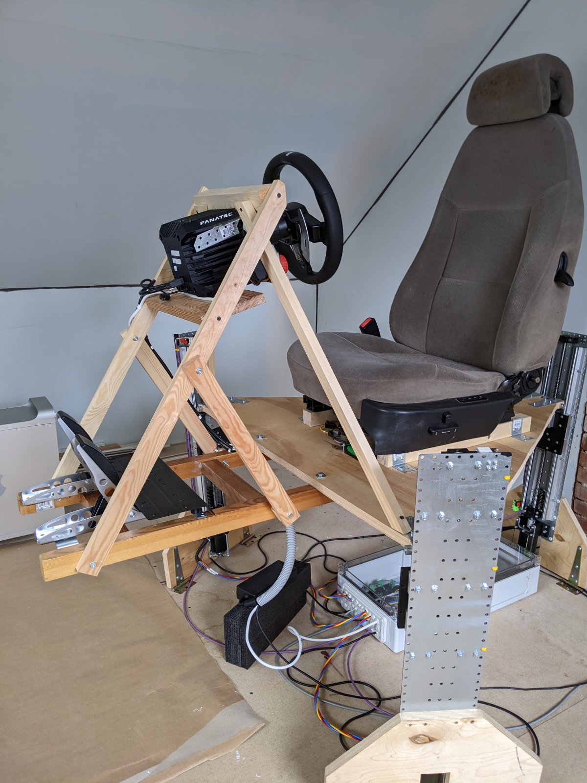

    I reinforced the joints with metal parts, installed some safety dampers for actuators in case motors lose power and platform fall down and put motor controllers and PSU into the enclosure.
    Next I installed my old Saab 900 electric seat with functional seat positioning.
    To save time I chose to buy wheels and pedals instead of building ffboard based wheel as I planned earlier. I chose Fanatec CSL DD Ready2Race Bundle. It came with CSL pedals, CSL steering wheel P1 V2 and CSL Direct Drive wheel base with max 8Nm of torque.
    I did a simple wood profile based fixture for wheel and pedals.

    As I am using Odrive for actuators control, there is no direct support for Odrive from Simtools and no interface plugins.
    I decided to use a can bus for robust communication and to use the usb-can adapter I had laying around. It is AVR controlled USB<>CAN Bus Interface by Michael Wolf.
    As firmware source code was provided, I modified the firmware to get it to work with Simtools. Simtools axis data is sent via serial interface and converted to can frames. Can frames are sent to actuators in format suitable with the Odrive can interface. Incoming axis data includes all three axis positions and will be relayed to all actuators almost simultaneously. Actuators are selected by can node id.
    I spent a lot of time configuring Odrive to control actuators rapidly enough and with good response. Currently I got actuators working 200mm/s although theoretically it is possible to achieve over 400mm/s with chosen motors and encoders.

    Replace Saab seat with proper rally seat as current one doesn't offer enough side support and is simply too soft.
    Actuators are quite loud at the moment. I think it's because of no vibration dampening.
    Also the PSU is noisy and should replace ventilators.
    Fine tuning axis parameters in Simtools. They have pretty modest settings at the moment.
    If I have more time then add a 4th actuator for 4DOF.

    It seems to me that the connection between the actuator and the platform is not reliable, because the plywood can crack or break, although the idea of the platform is very good.

    I agree. Currently it is working but at some point I probably replace plywood with aluminum frames.
    Also actuator connections to ground are currently very basic and give a bit play, I am thinking about proper connections with separate ground frame.
