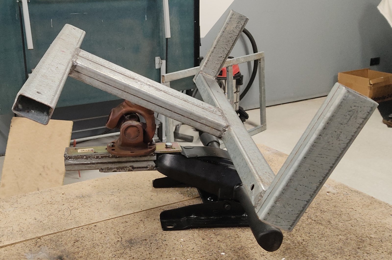

    this is my first motion rig. I was inspired by this forum. I saw, i read and than i think “i want to build a motion rig like yours”.
    My current setup is a playseat challenge with Thurstmaster T248. My first idea was to build a 2DOF motion platform for the Playseat. After a few weeks of research the idea switched to a 2DOF platform with traction loss. And it will be final a 3DOF motion seat.
    My budget requirement? Cheap but solid and compact
    So, I bought the mechanical muscles first. 3 wheelchair second hand motors. 24V and a lot of torque. The big one comes with 60nm! The two little ones, i dont know.

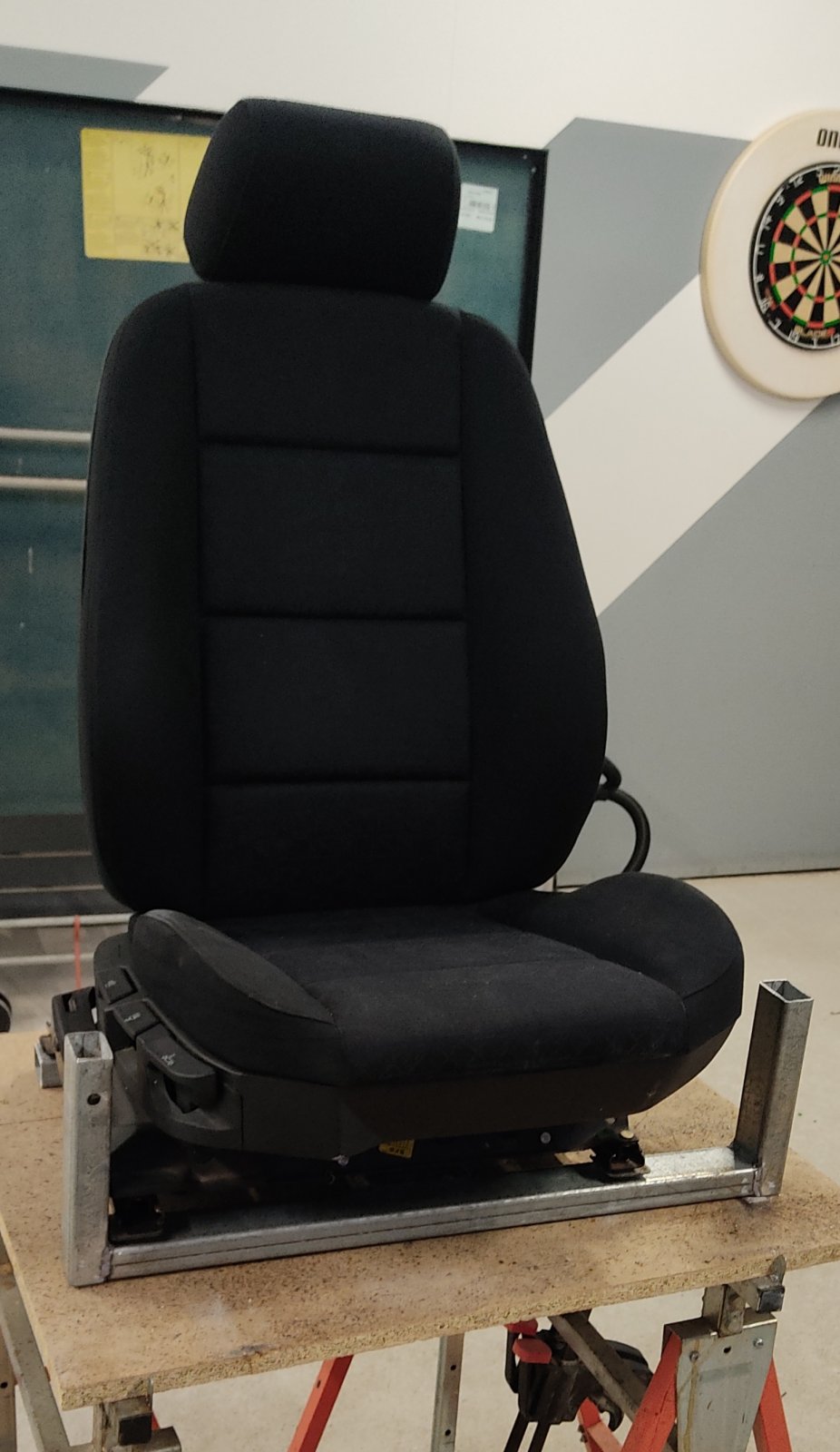

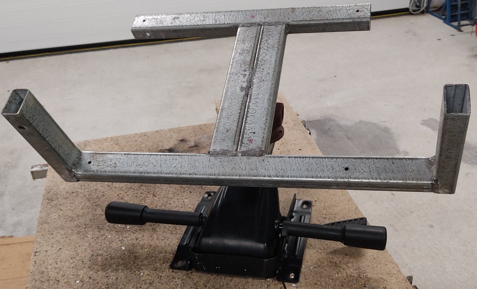

    Then i bought 3 20A power supplies, a joint from a little truck, 3 motor driver BTS7960 and other electric and mechanical stuff. A office chair mechanic (@noorbeast like your smart idea) and a car seat from a BMW E46 ( i’m a german guy ;-) )
    I want to use DIY hall sensors.

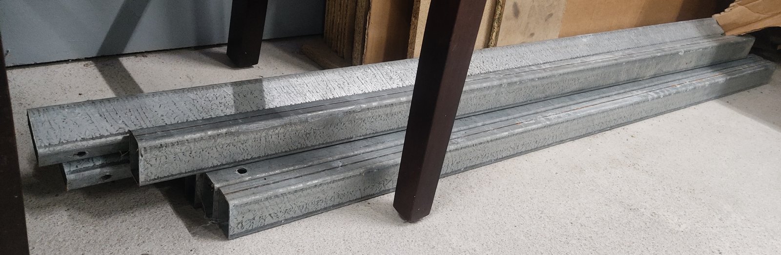

    The 50x30mm steel profiles are sponsored by a bro.

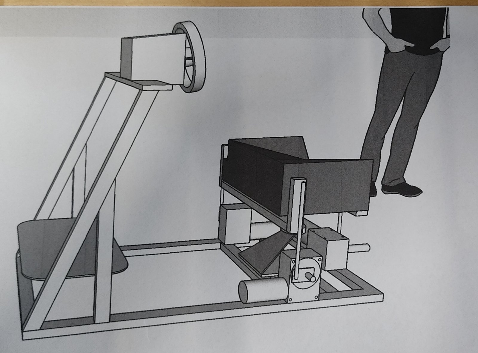

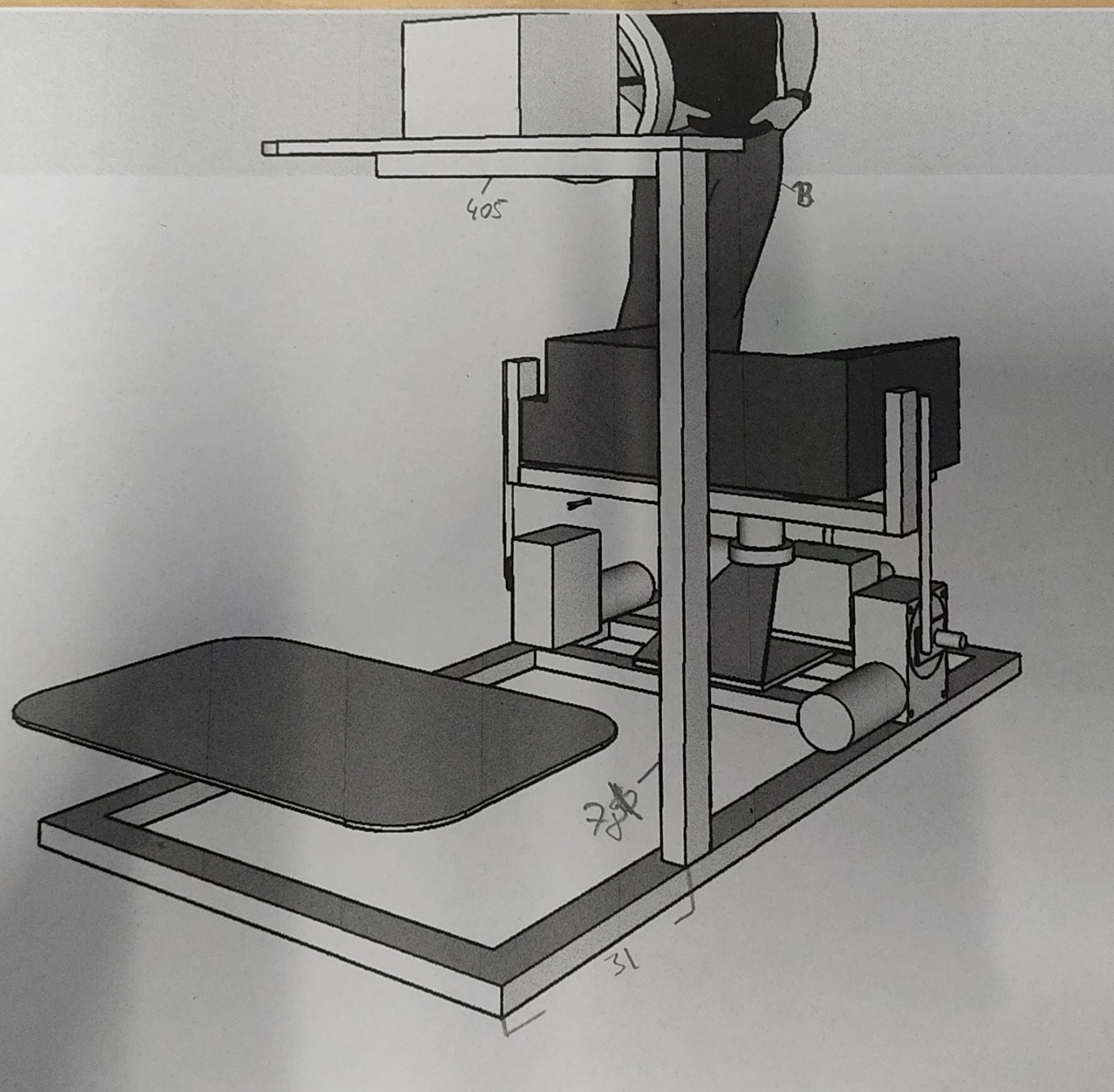

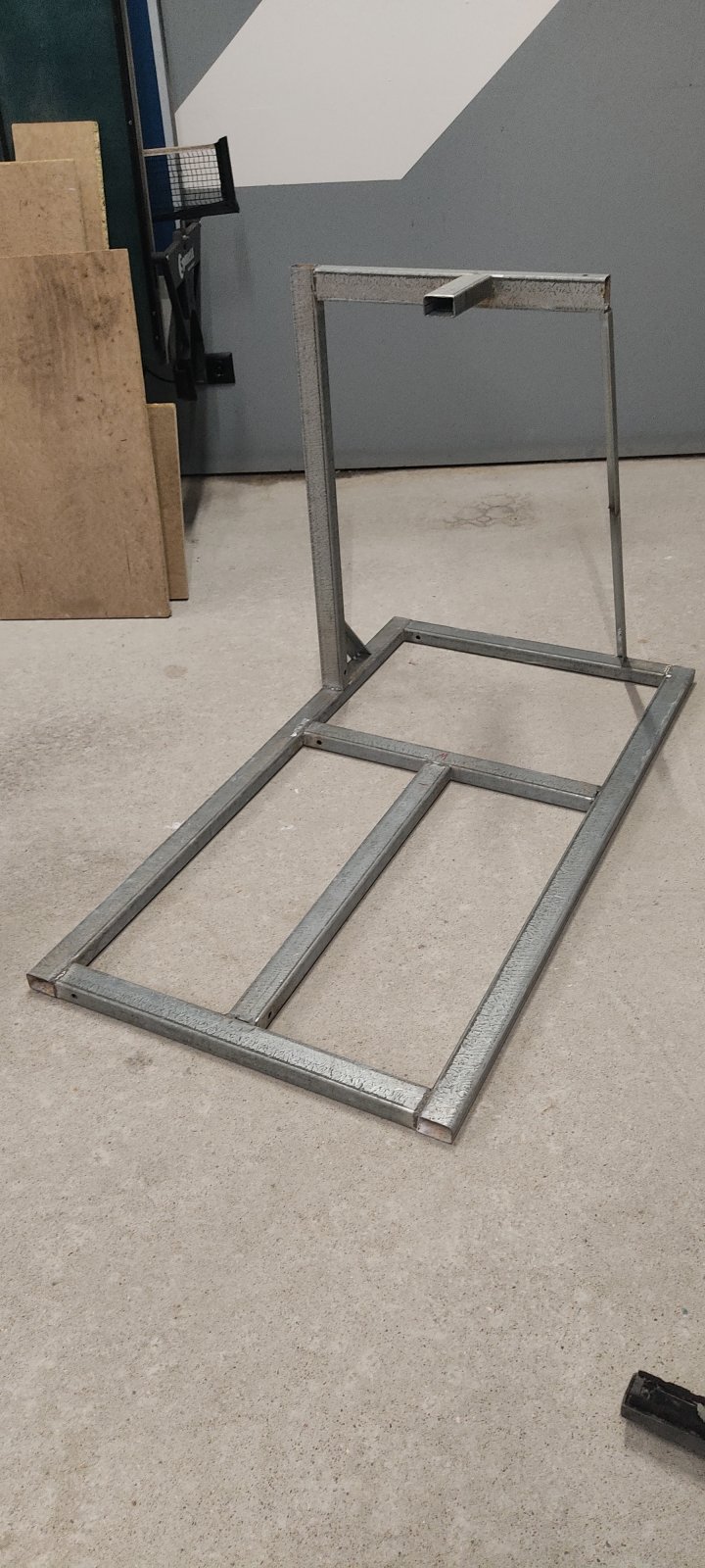

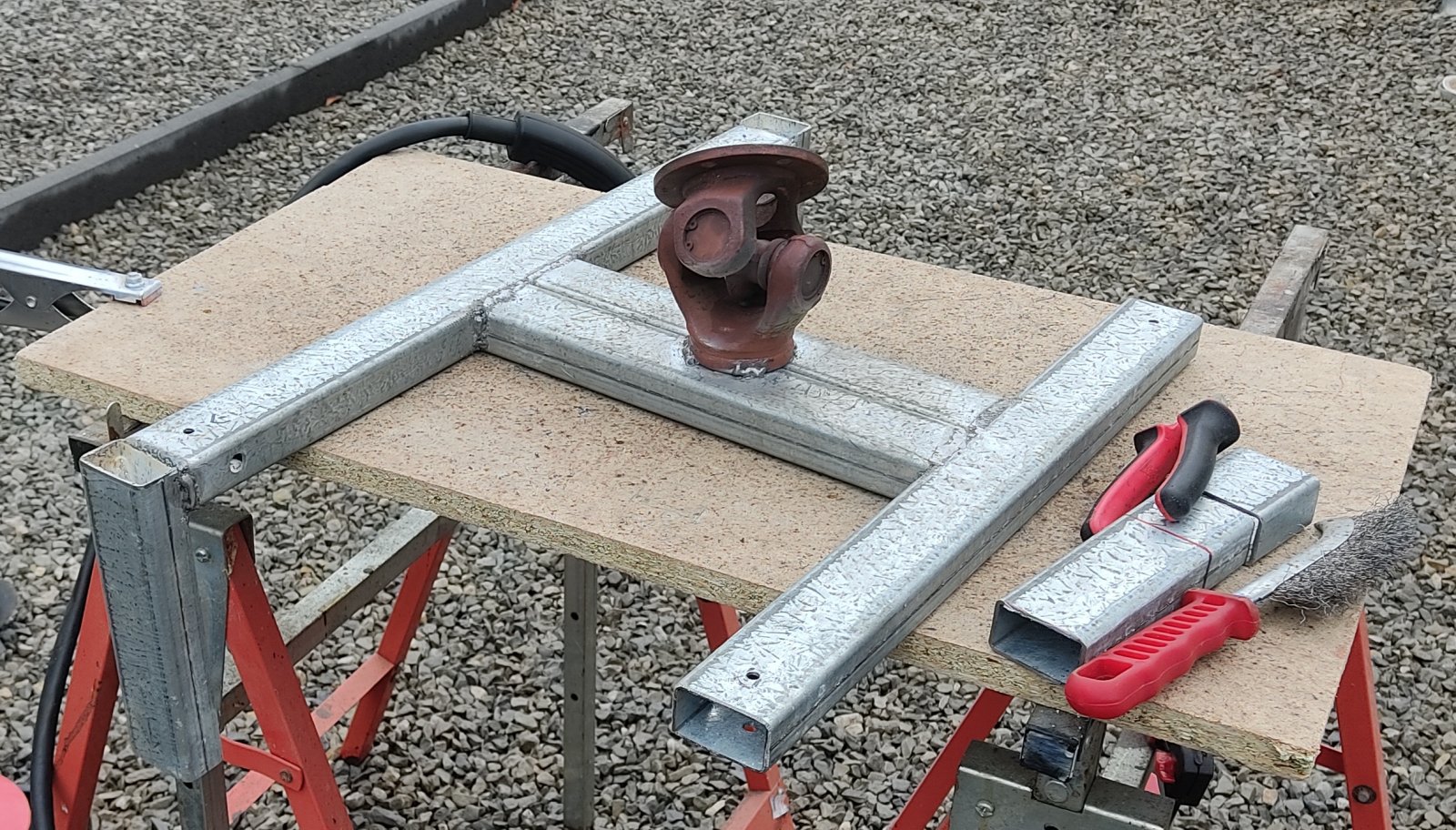

    First i visualized my thoughts:

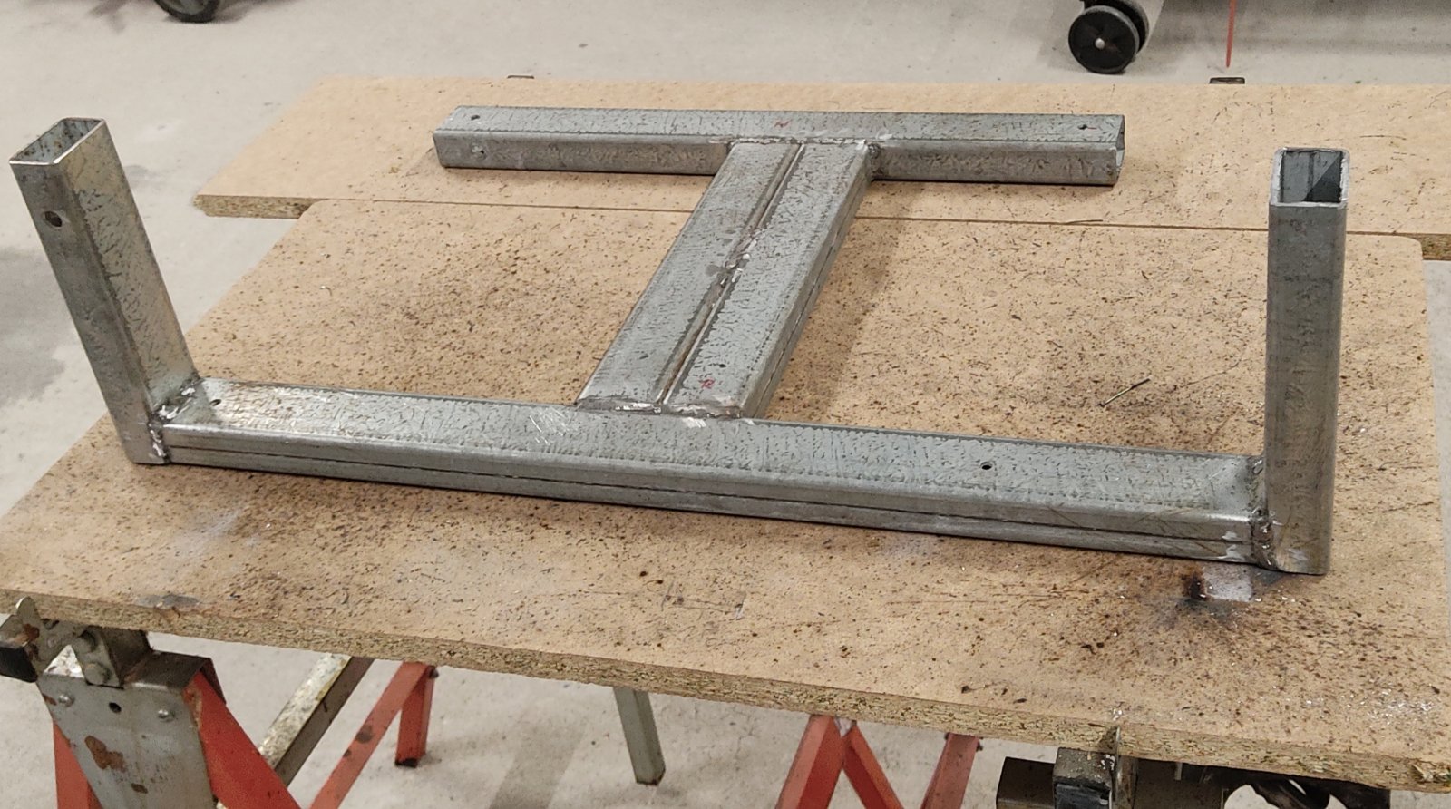

    i start to build the rig from top down
    i’ve never welded before
    I extended the point where the joint is extended for a longer lifting path
    These are the first steps.
    more coming soon…

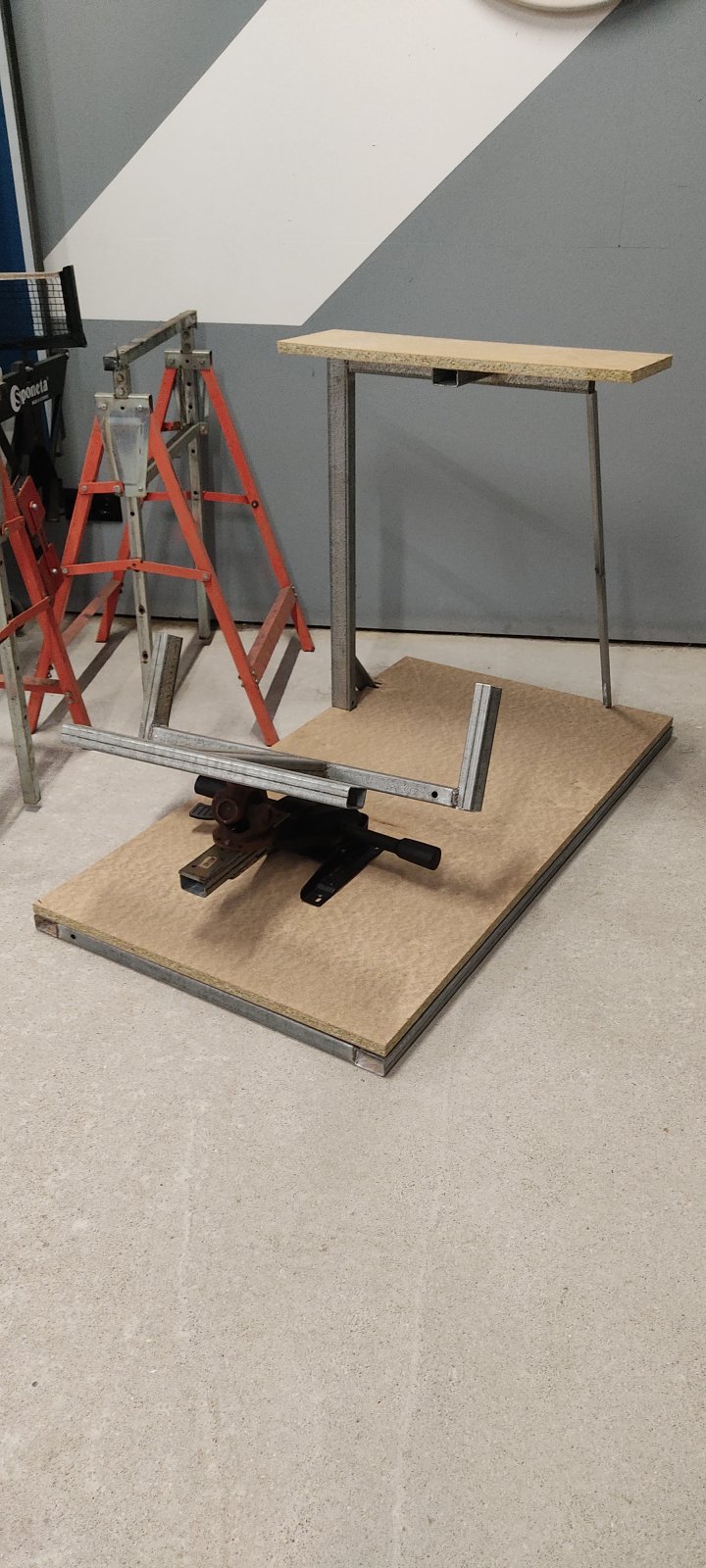

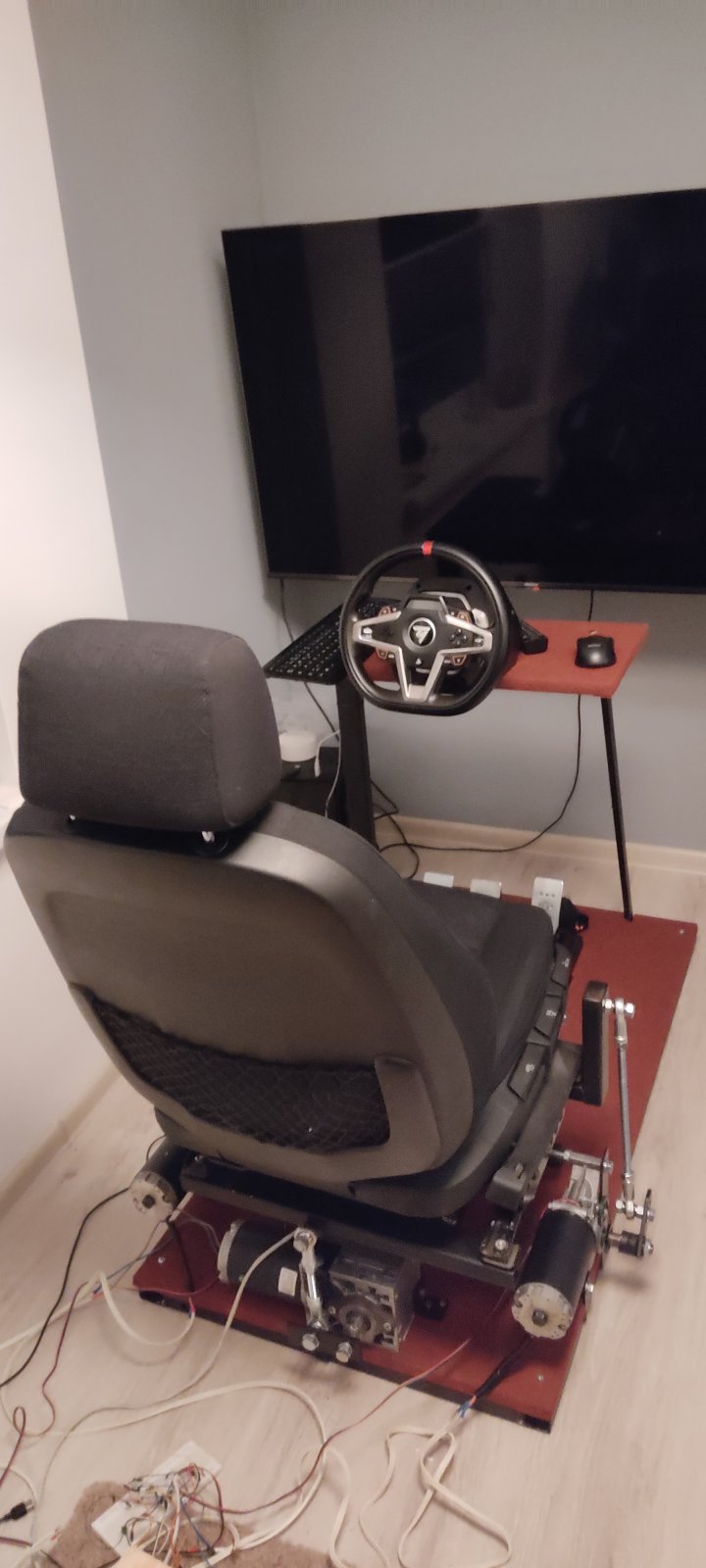

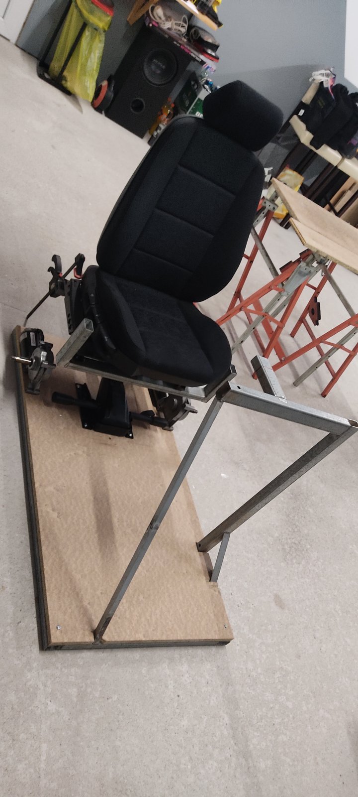

    let's go forward
    at the building time, i change the construction
    now the steering wheel rod and floor is installed
    more coming soon…

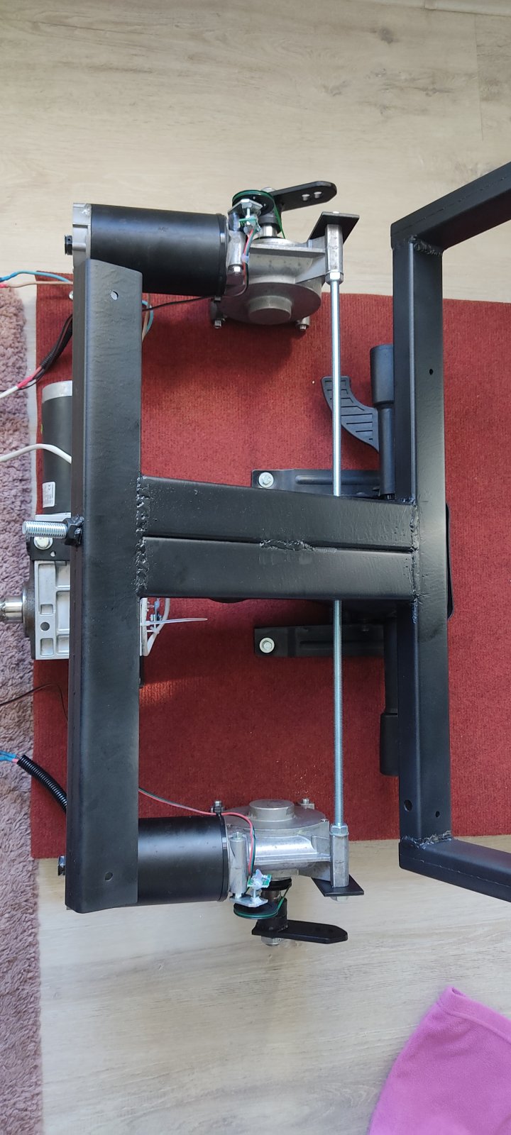

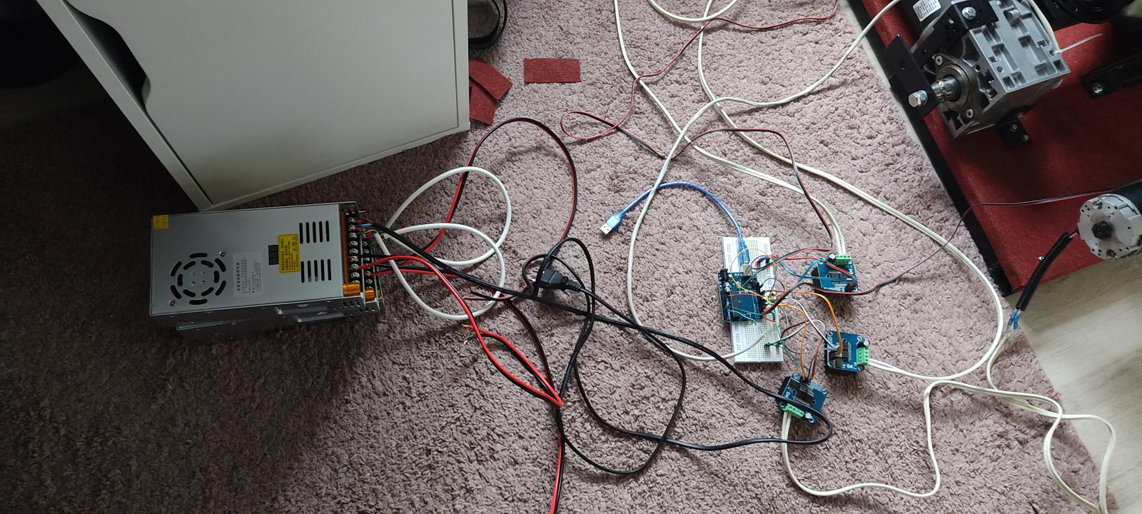

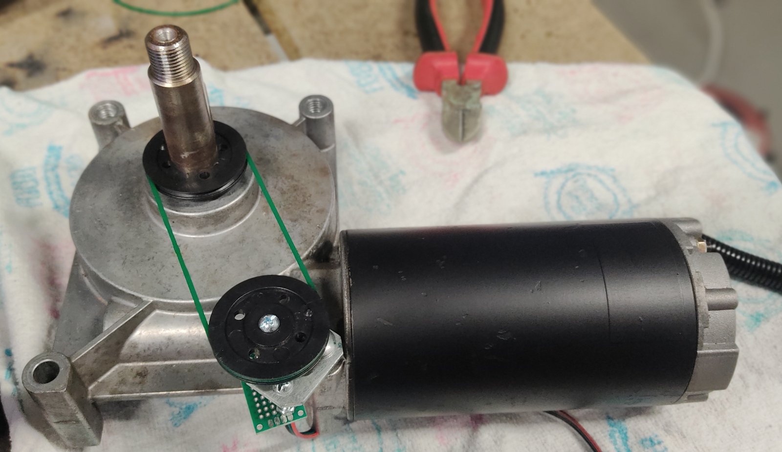

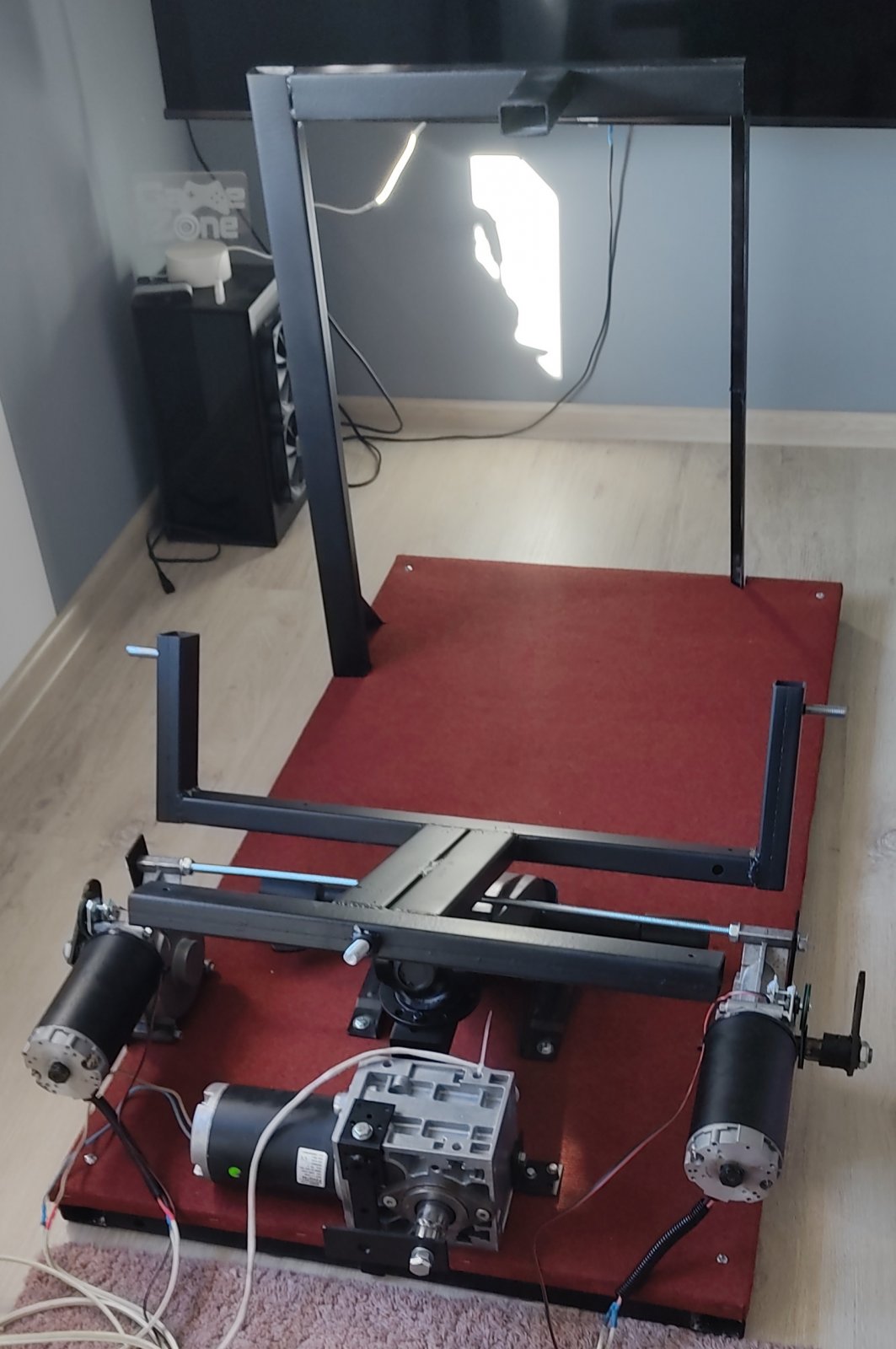

    let’s go forward :)
    i have installed belt drive and DIY linear hall sensor 49e
    time for color, felt carpet and the muscles
    the first wiring (3x 0-24V 480W PSU, Arduino R3, 3x BTS7960) and a successful tests in SMC3
    I chose adjustable PSUs because I read that the BTS7960 often cause problems at 24V and I will probably work with 18-19V. Or, if possible, even lower. I found out, that the motor drivers work most safely between round about 8-18V.
    My first issue was a low signal from 2 of the 3 hall sensors. Only 3,5V instead of 5V at maximum value. I changed sensors, tried other magnets.But after 45 minutes i found the problem. The sensors receive a weak input voltage. The breadboard has a voltage drop (maybe a sign of aging). Now, it works :)
    more coming soon…

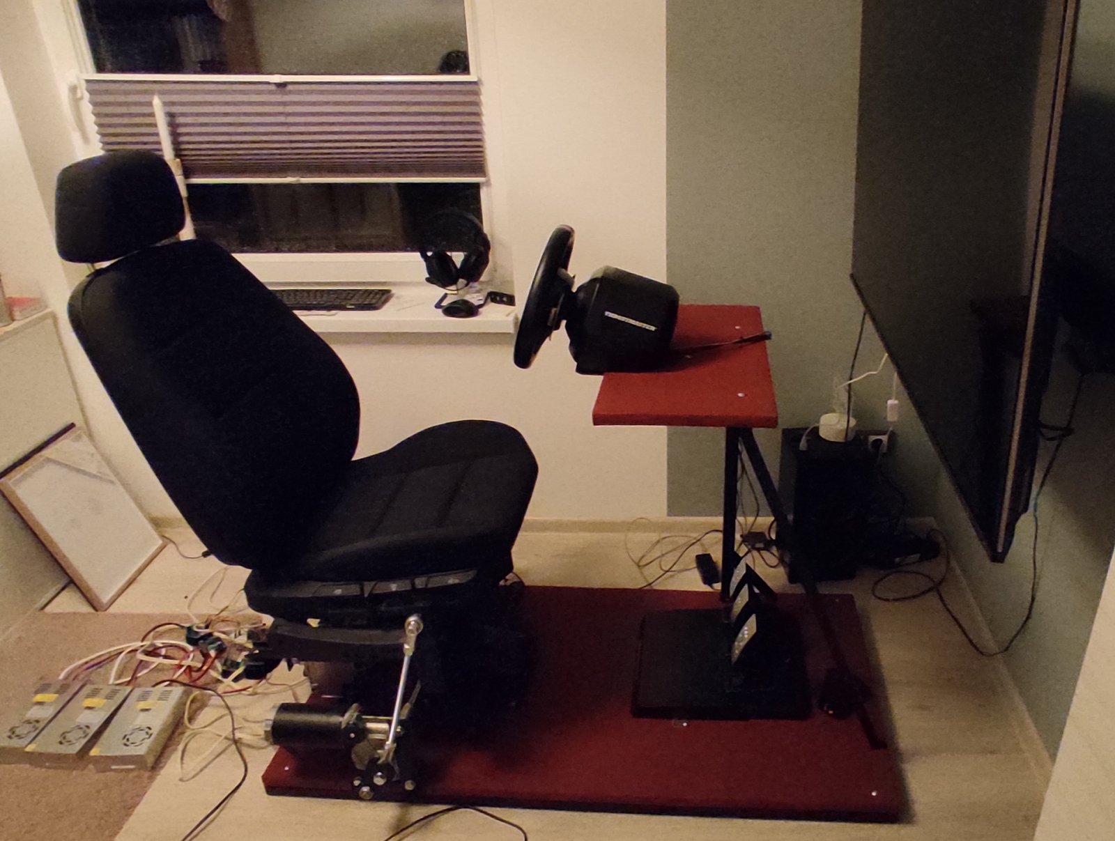

    let's go in the "final lap"
    the building is done and SMC3 and Simtools allows the seat to move.
    now, i will get the electrics in a box
    a video will follow in the coming days

    There are no springs, just a mechanism to keep the upper part of the seat from rotating and the lower part
    Components included
    1 top five cardan shaft
    5 bottom 10mm nuts
    3 iron plates about 12cm
    and components as shown in the picture below
  14. luu trung

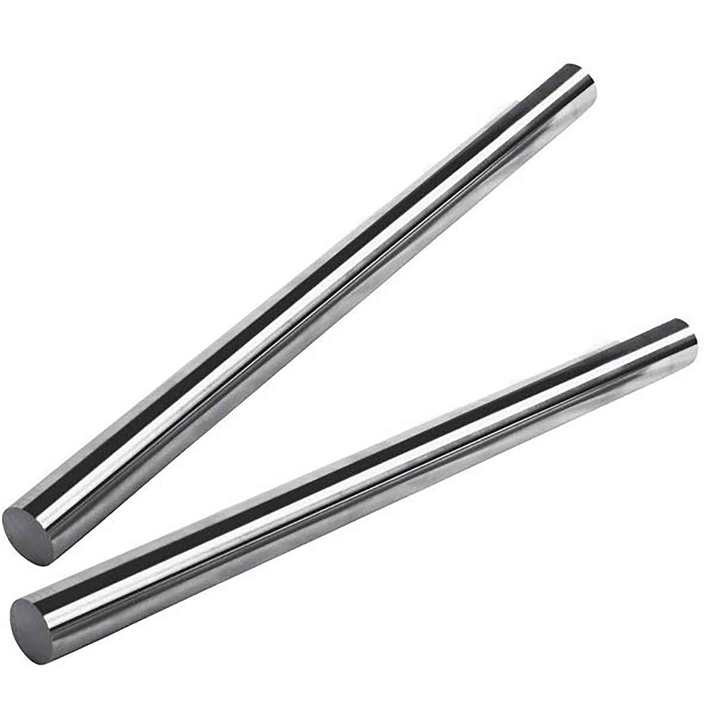

    metal bars and round sliders with a diameter of 16mm
