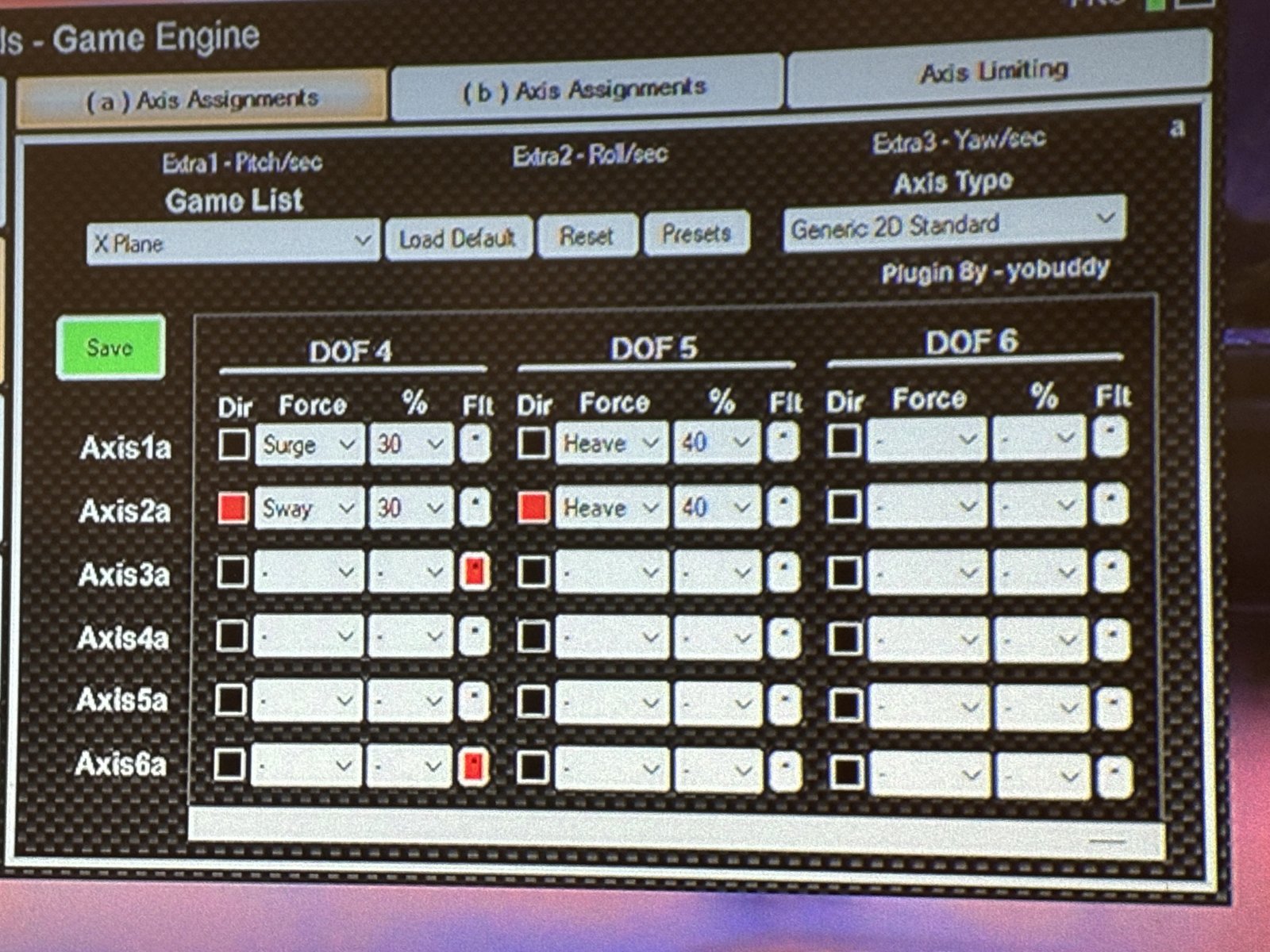

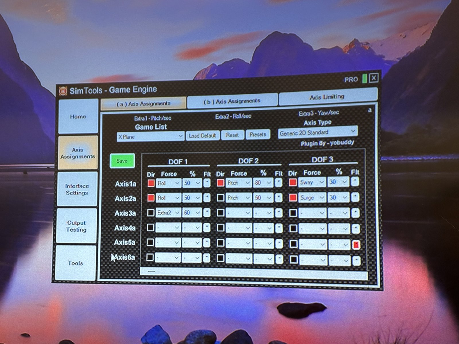

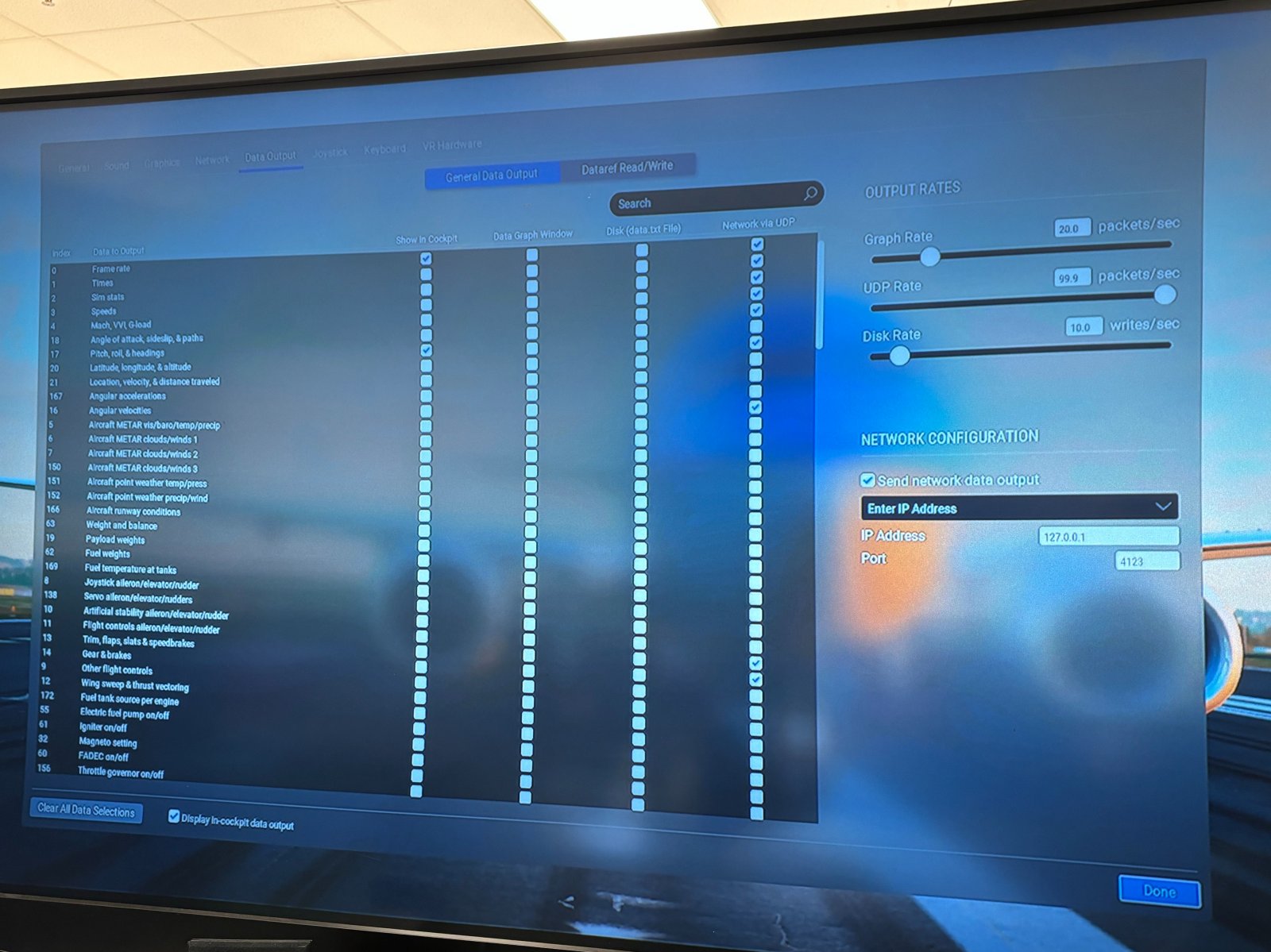

    I am setting up a 3DOF motion rig with XPlane 12 as a school project, and am having trouble getting XPlane and the motion setup to communicate. I have already configured and set up the hardware and software for the motion setup, and have confirmed that the computer can control the setup, but I am struggling to get XPlane to work with the motion setup. I have gone into XPlane and set up the port and everything. Sometimes when I start up XPlane it works for just a moment, or moves randomly, and then stops working. Any ideas on what I should try next?

    I believe you have the wrong Items selected for Network via UDP output. You only what items 3, 17, 37, 66 and 135. Take care :thumbs

    Hello, I recently began trying to use simtools 3 with Xplane 12. With DCS and MSFS it was as simple as loading the game and it works. Xplane seems I had to activate udp and ports and it address. I also had selected the output numbers you suggested. I get the program to connect finally and display telemetry. Otherwise I get no movement in a helicopter except on a crash. The motion rig behaves erratic, but it's not the rig, as soon as I switch games everything is fine.
    So clearly I don't know what I am doing with xplane 12 as it's requiring lots of directing for this to work.
    I think I an going to try selecting every output altogether to see if I can get movement with flight. I get no haptics to my butt kicker or seat pad so I'm convinced I just don't know what I'm looking at or what to do.
    Any tips?
