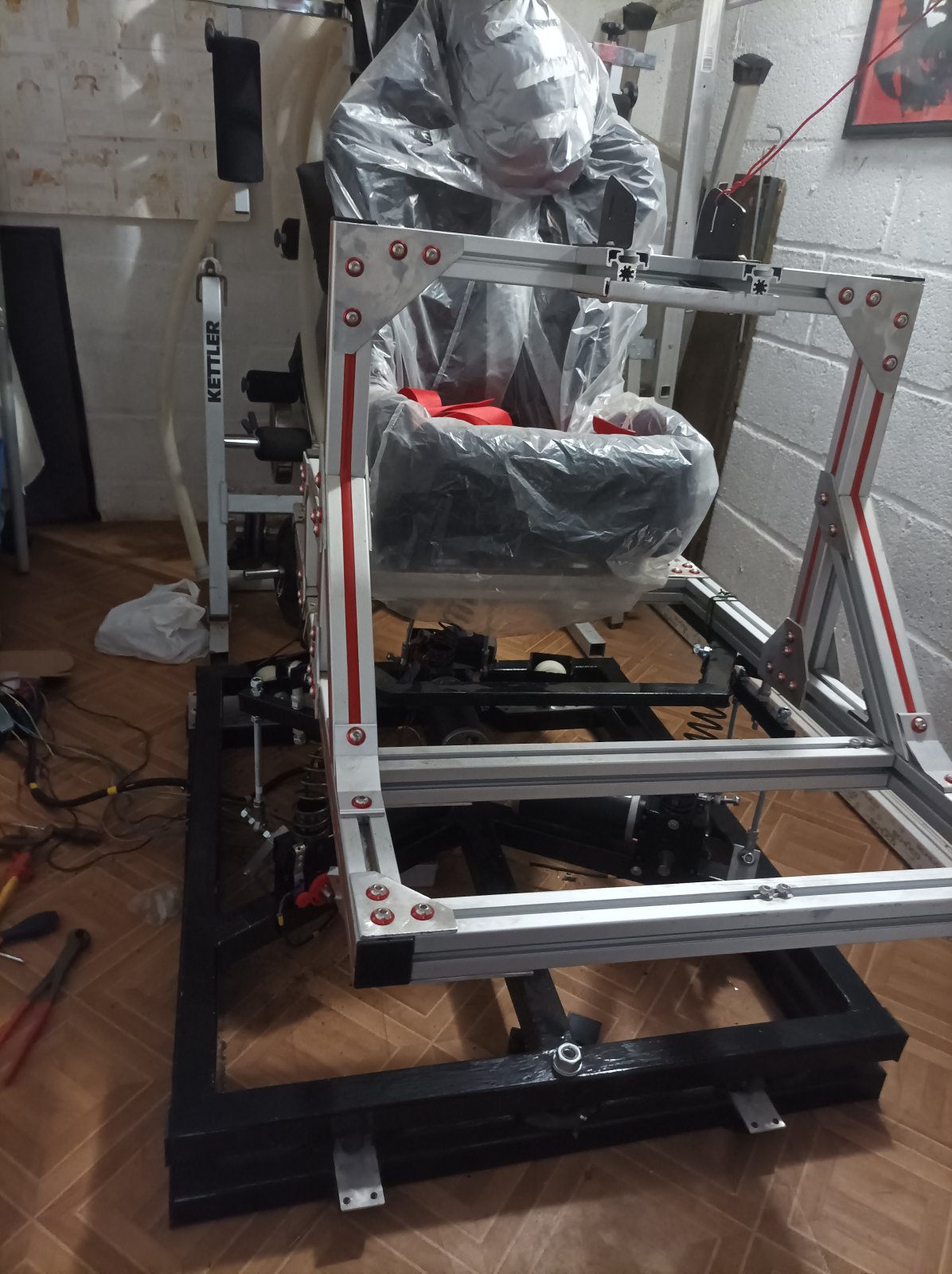

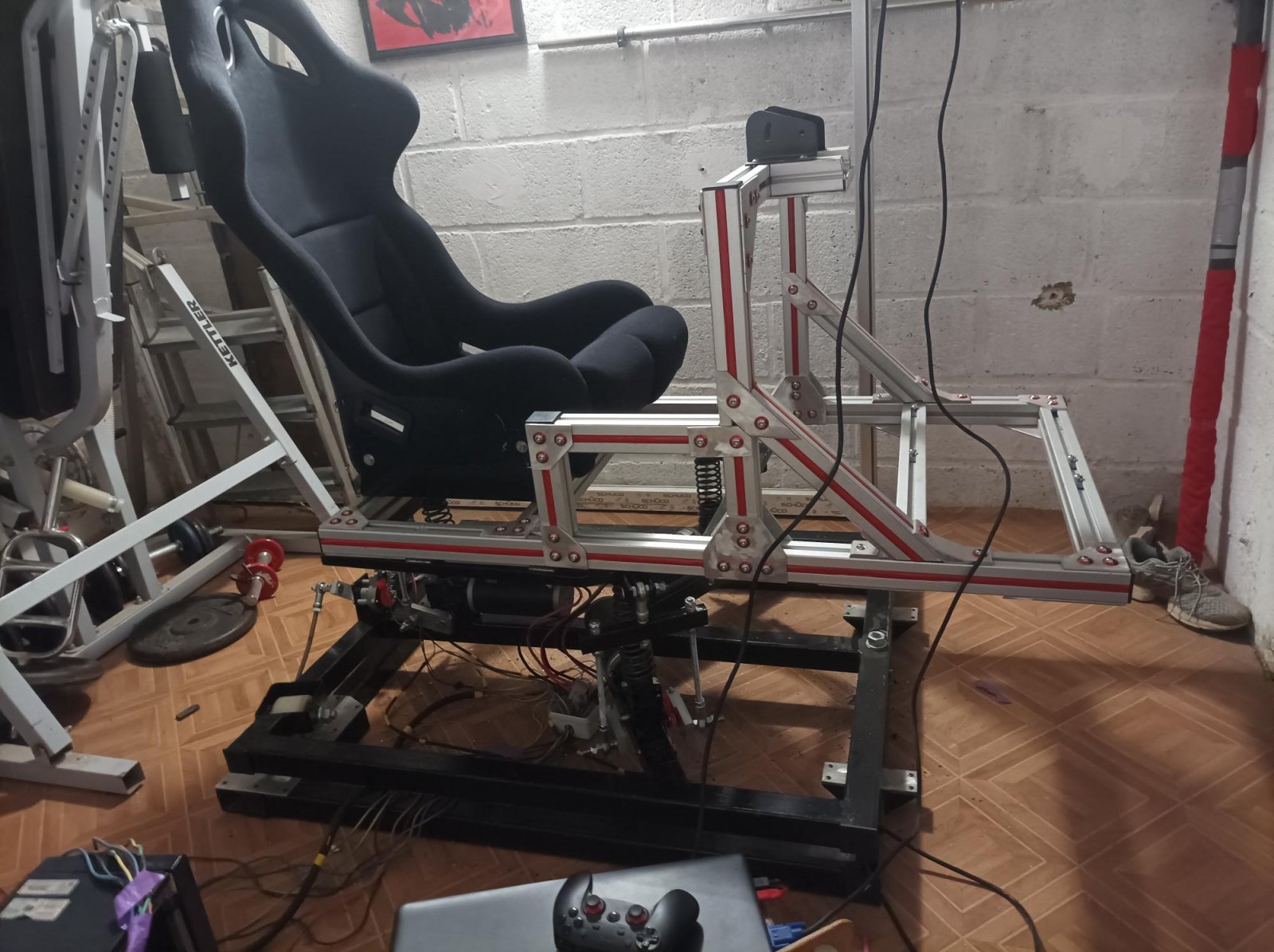

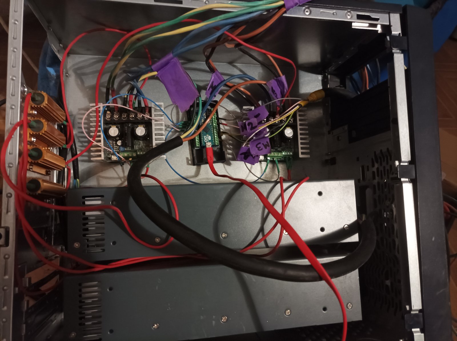

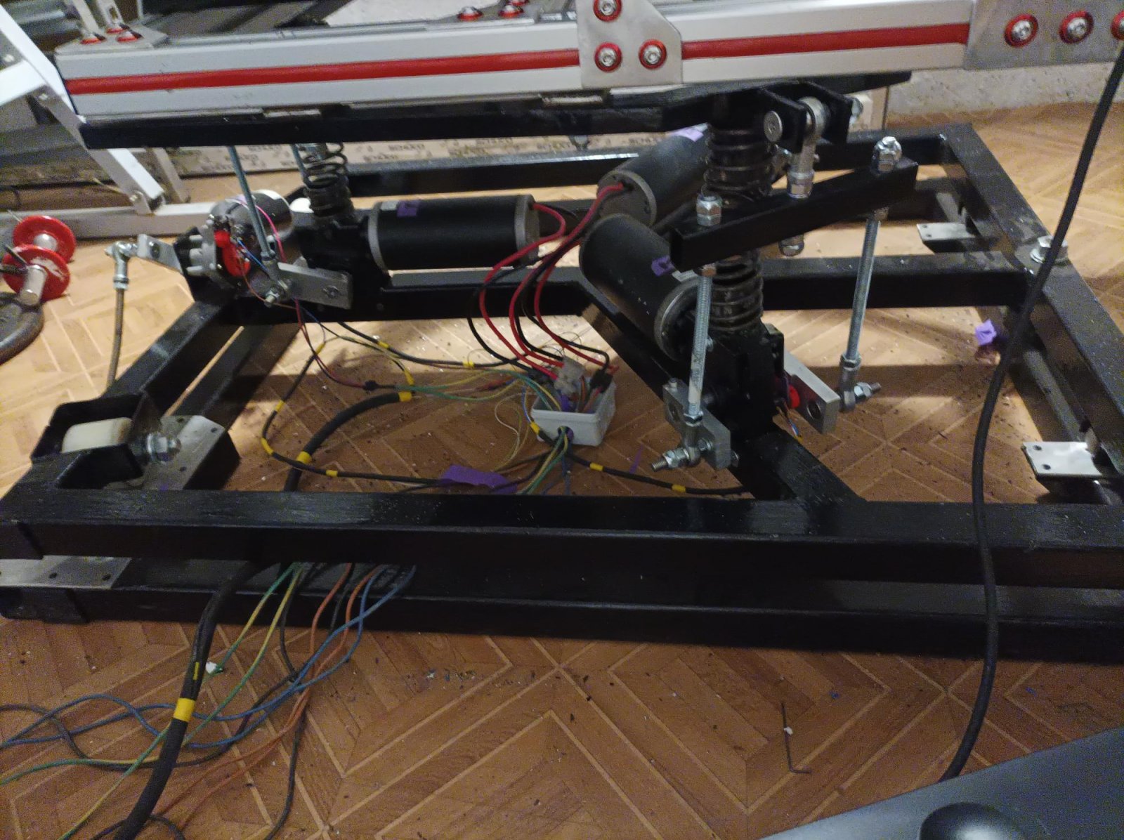

    I fixed the connecting rods, adjusted the height of the plate and made the settings in simtools. I still have to fine-tune the settings because the 400W motors are really more powerful than the 120w of my 2DOF. I understand why an emergency stop and strongly recommended:grin

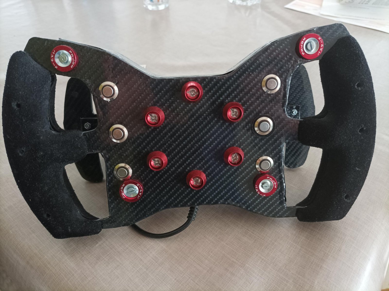

    And for those who are interested, I also made a fanatec compatible usb steering wheel. With 3d printer. IMG_20230506_093723.jpg

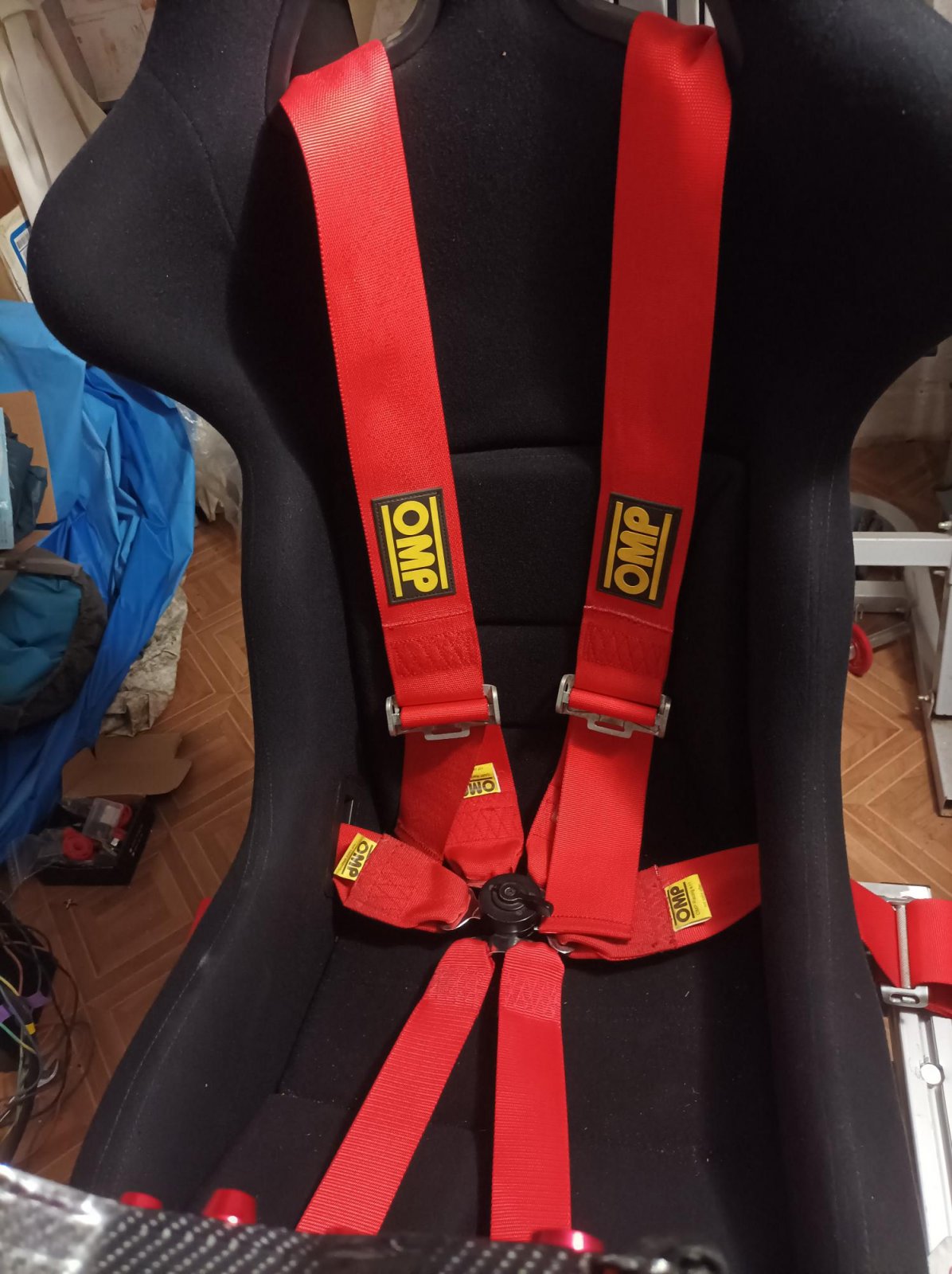

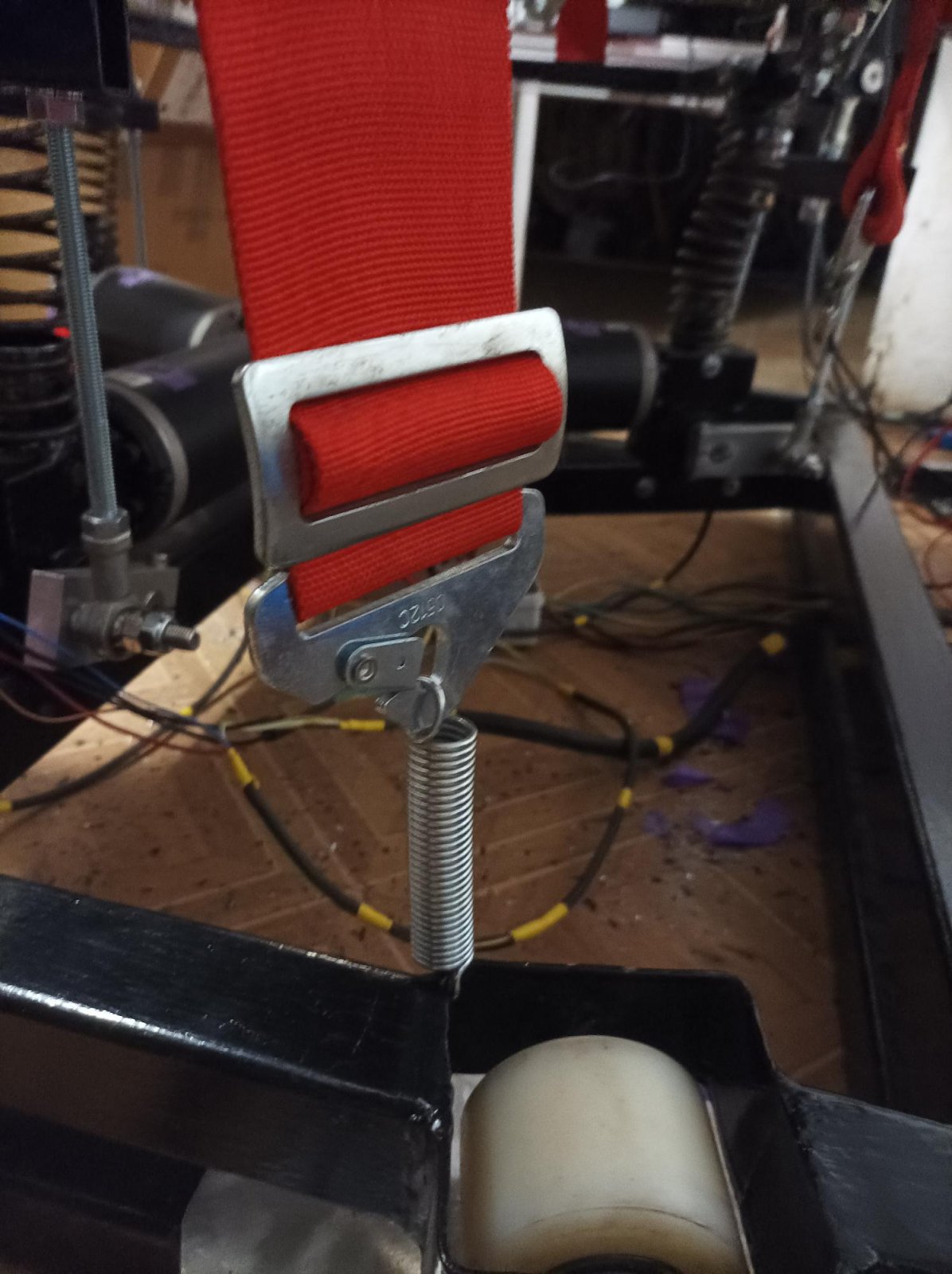

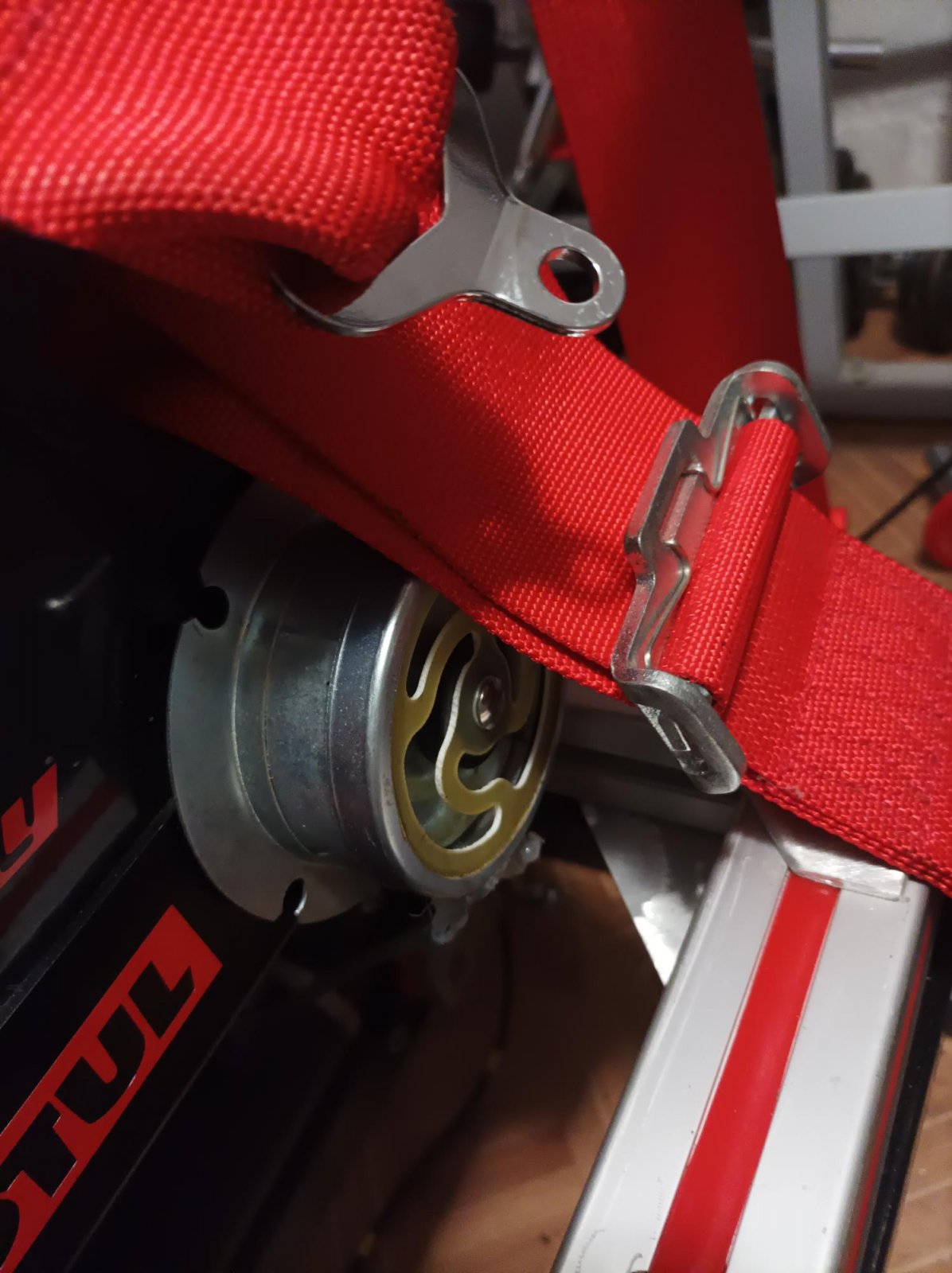

    I install a seat belt, which for this type of simulator is really necessary. On spring to simulate the tension of the latter during heavy braking

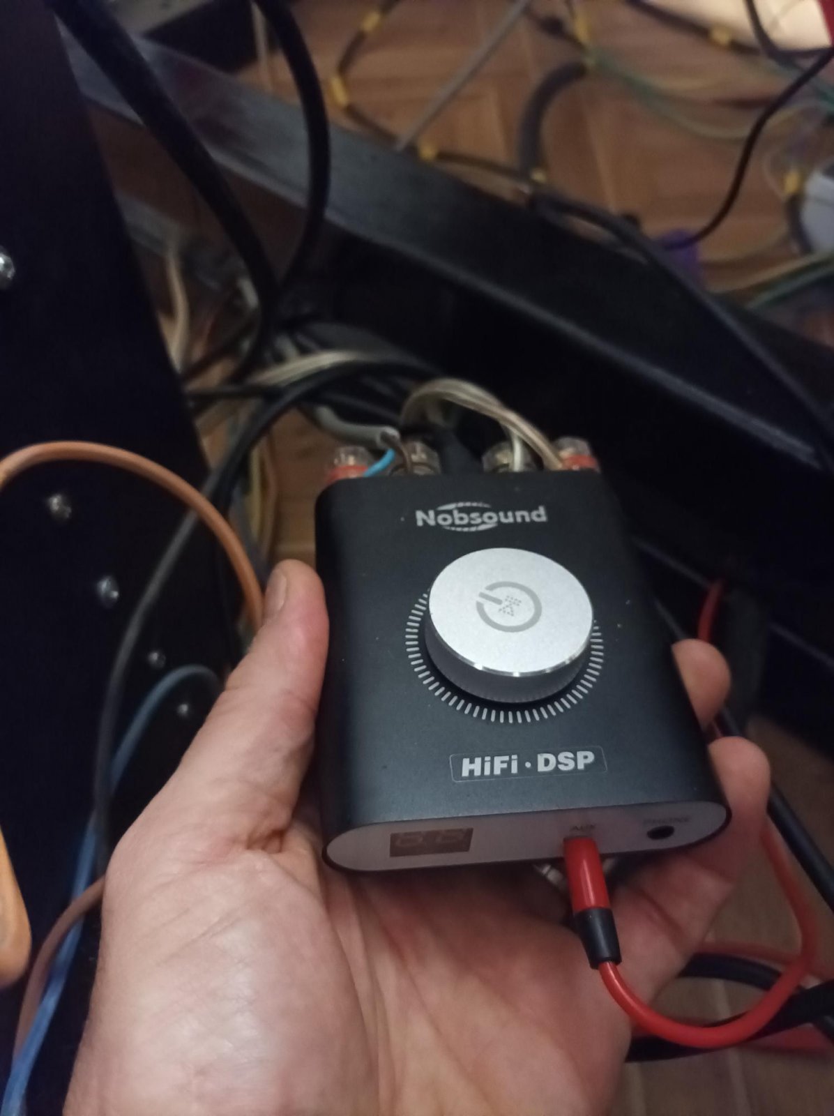

    Can be completed the simulator with bass shaker enclosure coupled with sim vibe
  15. Kenshiro27
    Kenshiro27 Active Member
    Apr 16, 2021
    199
    252Coins
    +81 / 1 / -0
    2DOF, 3DOF, Arduino
    Here is the installation of a vibration system that I installed recently
    I used bass shakers which are easily found on the internet for around €25 each

    and an amp which can also be found for around €40
    either all with cable for around 100€ and it's really interesting

    This brings a lot to the simulation because with simvibe you can adjust a lot of parameters such as collision, engine revolution, gear change and others. I recommend it to everyone
  18. noorbeast
    22,048
    153,884Coins
    +11,154 / 57 / -2
    I also use those small Nobsound amps, using slip in 3D printed bracket holders for them.
