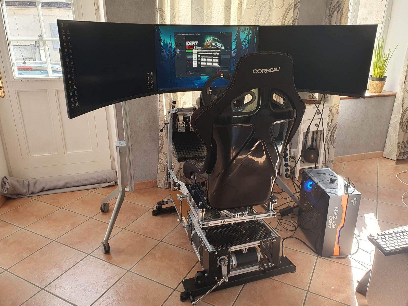

    Thank you Cgodwin !
    Here they are, not the best on the market but: 2K, 165HZ, VA, just what I need.
    I chose 32" because I think that's better for the immersion...

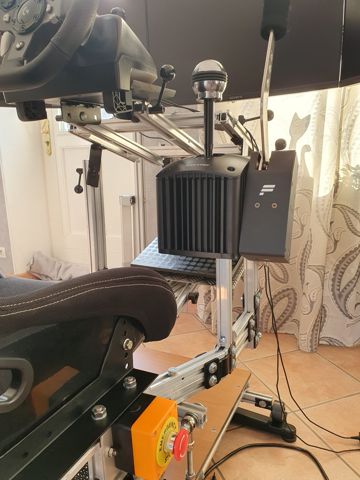

    We've made a custom aluminium support on wheels.
    I receive the Shifter, first test should be on monday... fingers crossed !

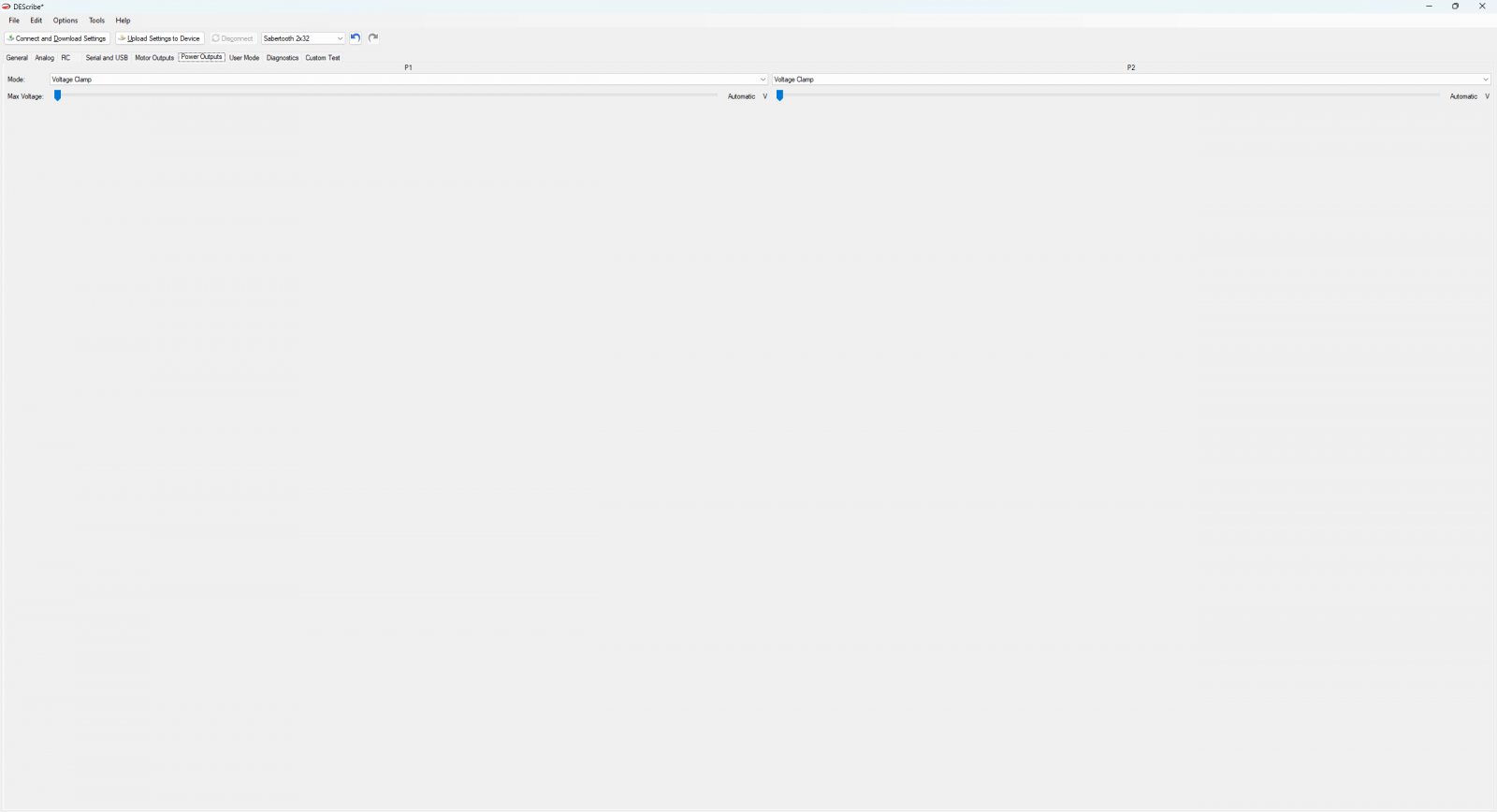

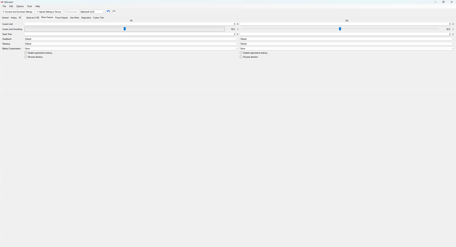

    So... not going qo well of course lol.
    Everything is moving, but it's like the motors don't have enough strength.
    Without the seat etc, we can stop the motor by hand .
    Motors 350W 50rpm, sabertooth 2x32 (x2), we can mesure only 4v on the sabertooth where motors are.
    Alimentation is 1200W 24v 50amp
    Where can i adjust the strength of the motors?

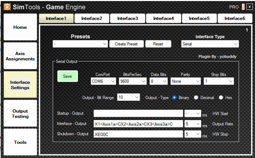

    I'm using the arduino micro.
    Here is my setting in simtools:

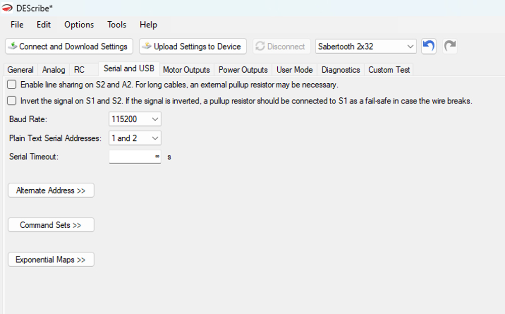

    In Describe I configured each sabertooth like this:

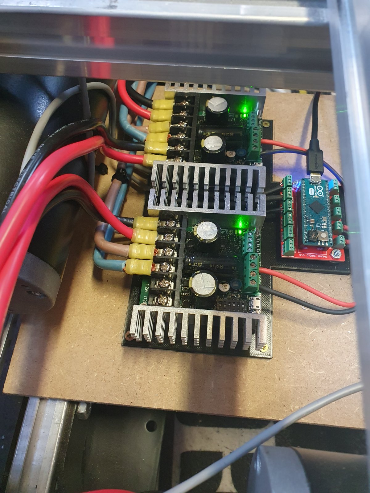

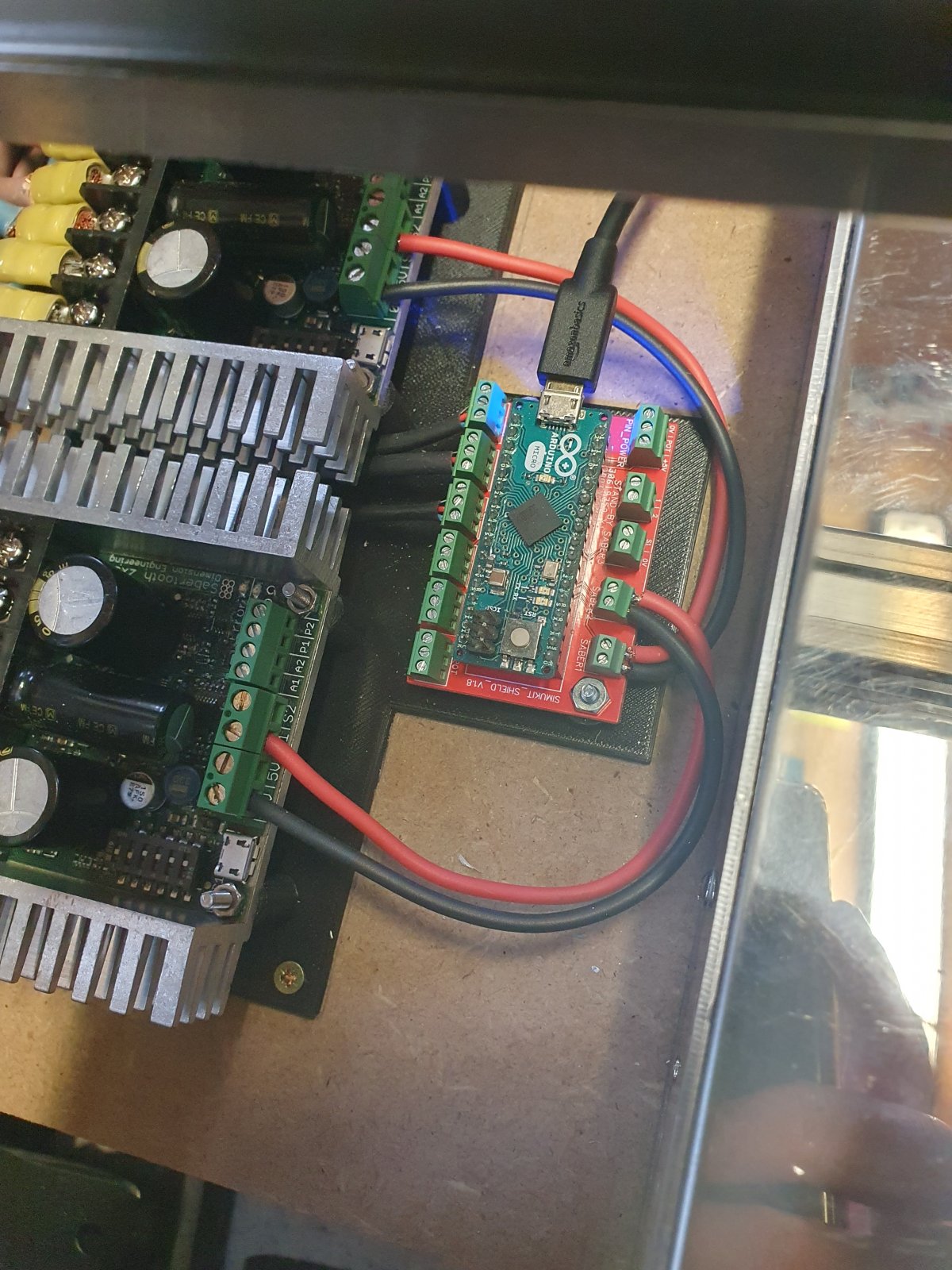

    First of all, nice setup you got there! Props to you!
    On second hand, do you have a connection schematic of your motors? Maybe that will help us to find out where is your lack of motor power coming from.
    Greetins.
  11. lebclem
    lebclem New Member
    Jan 1, 2023
    11
    Graphiste
    France, oise
    67Coins
    +7 / 0 / -0
    Hope it will help

    The motion rig is finally ok !
    I put an other code in the arduino, and now motors have strengh and energy.
    The last thing is that the 2nd motor on the sabertooth is less powerfull...
    Do you have an idea? I have now 18V on each motor on the sabertooth BTW.

    Hi everyone,
    My setup is finally done...
