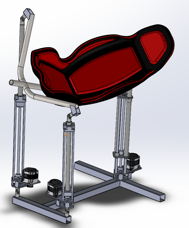

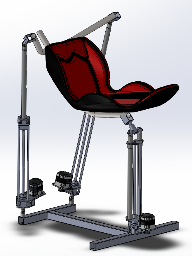

    I am in the brainstorming stage for my project i would like to have your opinion.
    This is my Concept for a 3dof FlightSimulator, the principal utillity is for Condor 2,
    What Do you Thing About The Fixed Double Shaft Actuator? and the mechanical principle?
    Take a Note ,The Drawing is a Rough draft its just for the mechanical principle.
    Specs:
    Pitch up 50Deg
    pitch down 26 Deg
    Roll : 46 Deg
    -Odrive
    -330W 3000RPM BLDC 86BLF03 Motor Ratio 1:1
    -600mm 1605 Screw (Stroke = 490mm)
    I Think This setup are power limited, if i compare with 6Dof with 6x 330w
    but for Flight sim With Slow movement 330w X3 motor its enough?
    And Im not sur witch software can Drive this,
    Maybe FlyPT mover with 3DOF Rig?
    The Video :
    Thankyou to tell me If somting Goes Wrong , Thanks

    Interesting idea.
    I think it would be a good idea to build a working model, with the same pivoting joints, my guess would be that it would be unstable under load with uni style joints top and bottom of the front actuators, combined with the rotating joint on the rear.

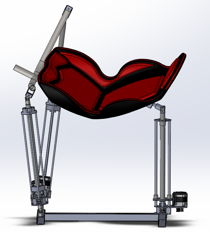

    Hi , maybe you will have some problem of stability , exemple on your last pic ,
    With this position your seat will goes back because the angle of the rear actuator follow the two others

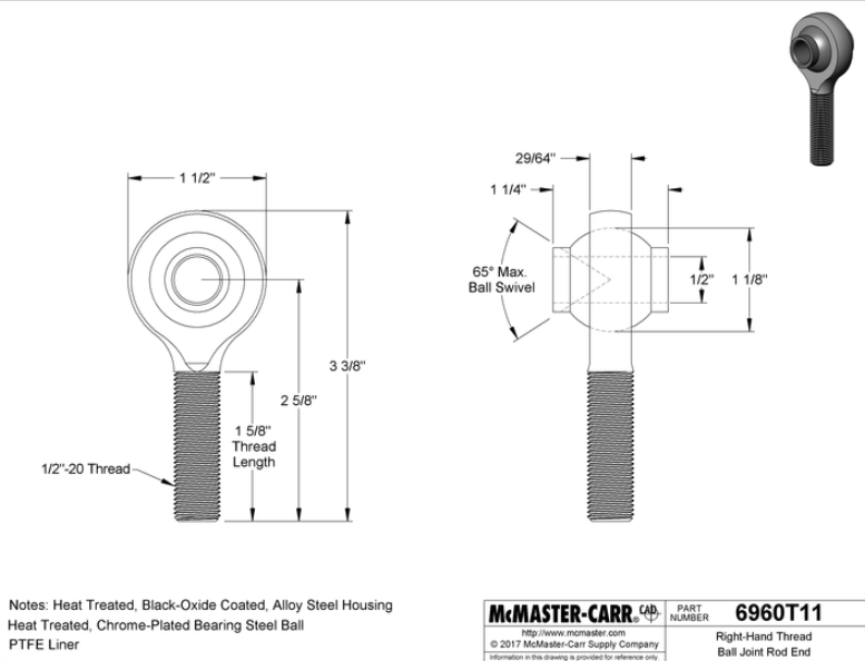

    Adding to above. Stability looks like an issue, maybe need spherical bearings at the bottom or top rather than two UJ's as they could bind or they wont re align when back in normal position.

    Thanks ,
    im agree with you , the upper ujoint have to rotate to allow this movement this can be a problem
    I have difficlult to understand what kind fo Spherical bearing you talk ? do you have a link or picture?
    in first version i have Rodend but this limit my max angle.

    What about a u-jount and two flange yokes from a car? I picked a Spicer 2-2-939 for $10 USD.
