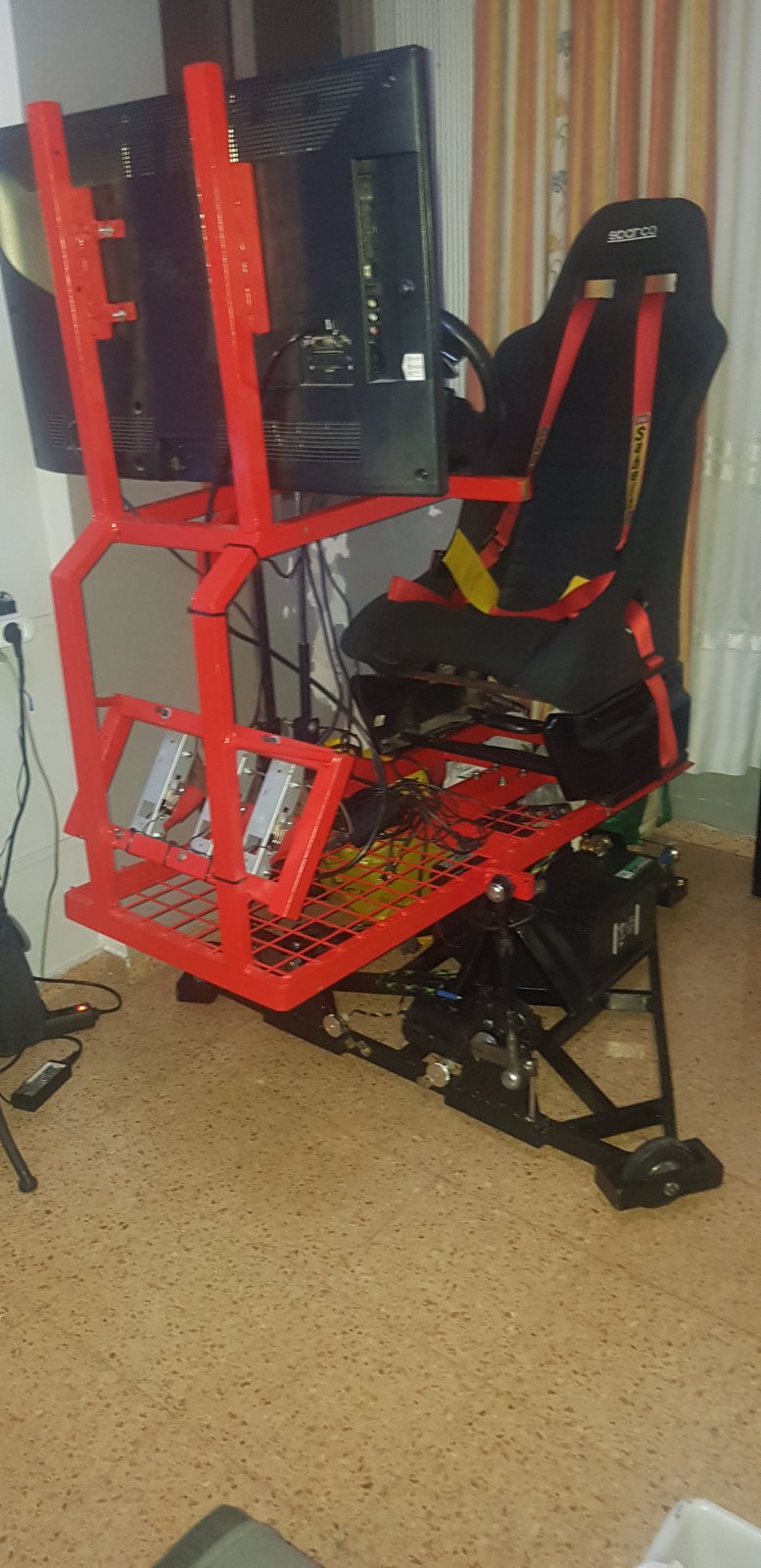

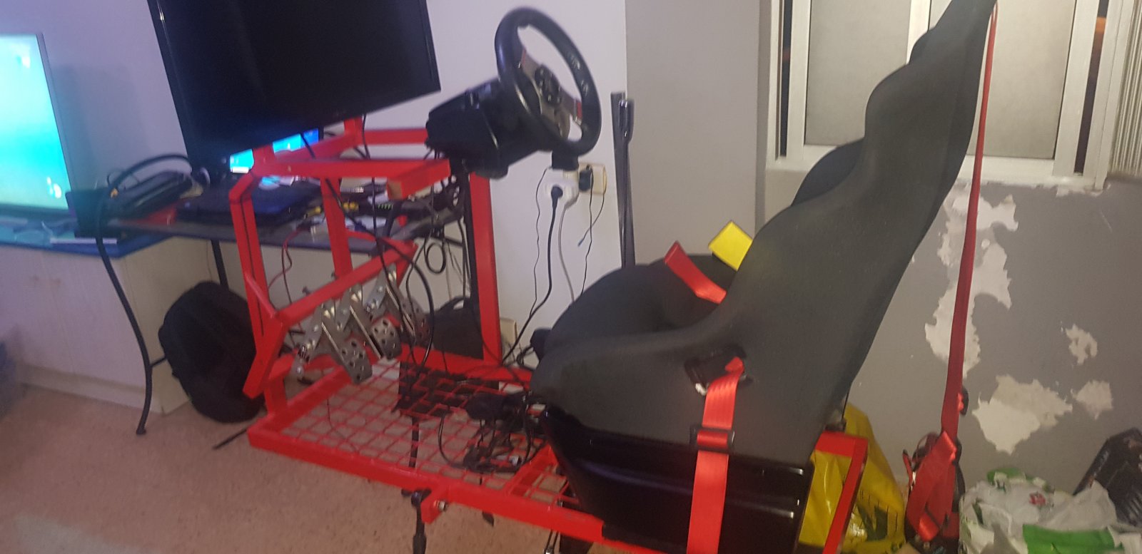

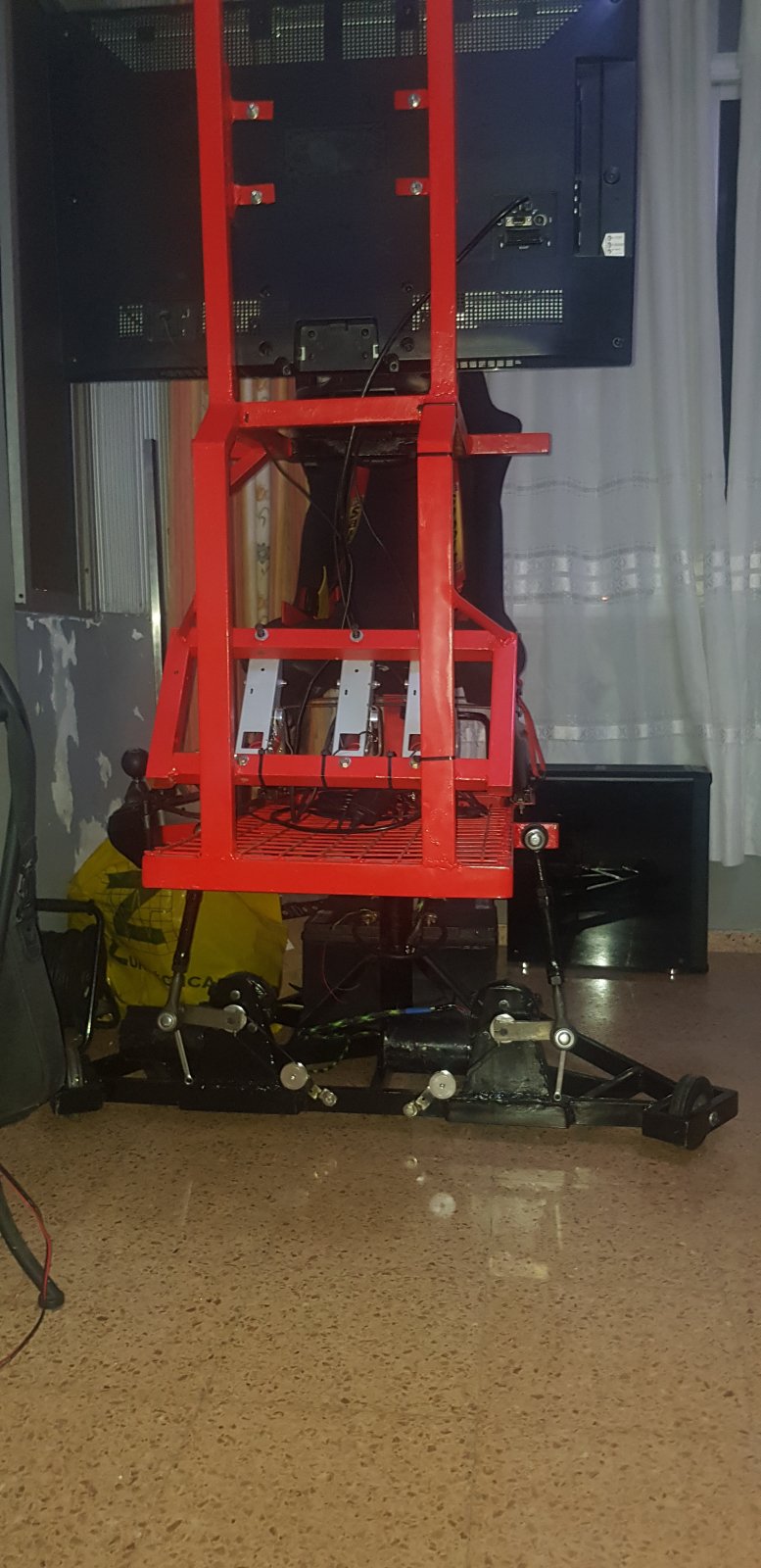

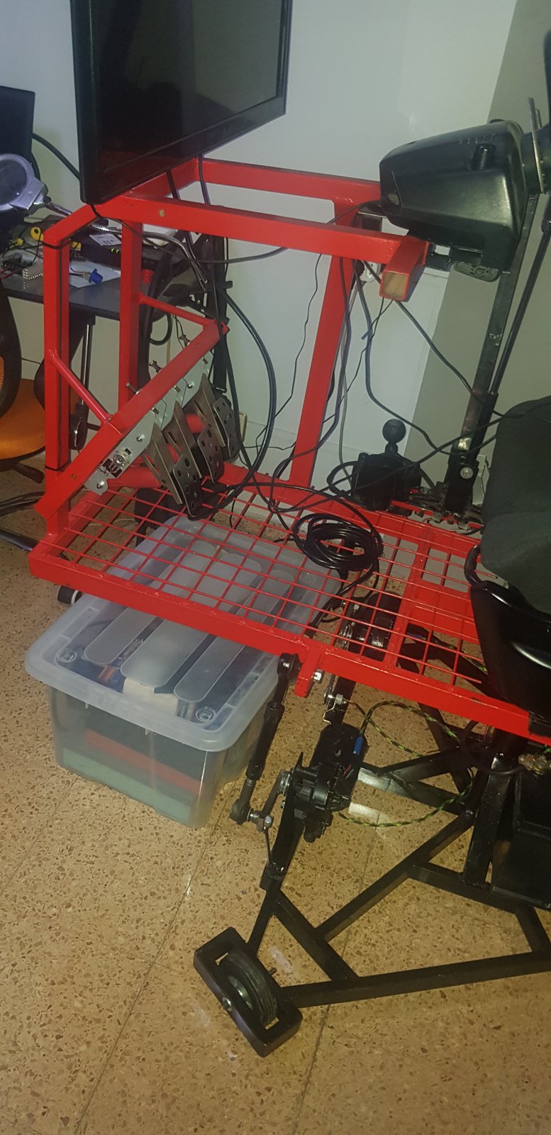

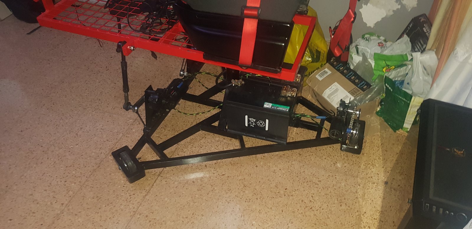

    I have long liked racing simulation, one day I saw this on the internet and wanted to do something similar:
    So since I am good at welding I started at times and with 2 24v bus wiper motors and one 12v for the turn in the lower part it is already built in the absence of finishing wiring well and creating presets and others .
    (See the pictures)
    I have 2 arduino one r3 and 2 h-bridges saberrtooth 2x60 and 2x32 and was thinking of using the racingmat scketch for 2 dof and arduino. Do you know any scketch that makes it easier for me when creating profiles? or any scketch with profiles already created that I can use? My idea was to use 2 arduino to get 3 axes so I do not care if the sketch is 2 or 3 axes, as long as there are some current profiles that work with my project.
    The project started a long time ago and I had it parked although it is quite advanced only in the absence of electronically installing photos step below, please I just need a sketch that works with saberrtooth. Help please thanks

  4. pedro santana
    pedro santana New Member Gold Contributor
    Apr 12, 2020
    97Coins
    hello, i would like to know if anyone has used a 2x60 saberrtooth, i have trouble getting it to work, when i turn it on after arduino, the motors are supposed to go to their central position and stop, and what happens is that one continues turning and the other reaches its center position and turns in reverse. Does anyone know if it is necessary to make any changes to the dip switches? i am using smc3 sps and a new 2x60 saberrtooh, if anyone knows and can help ... kind regards
