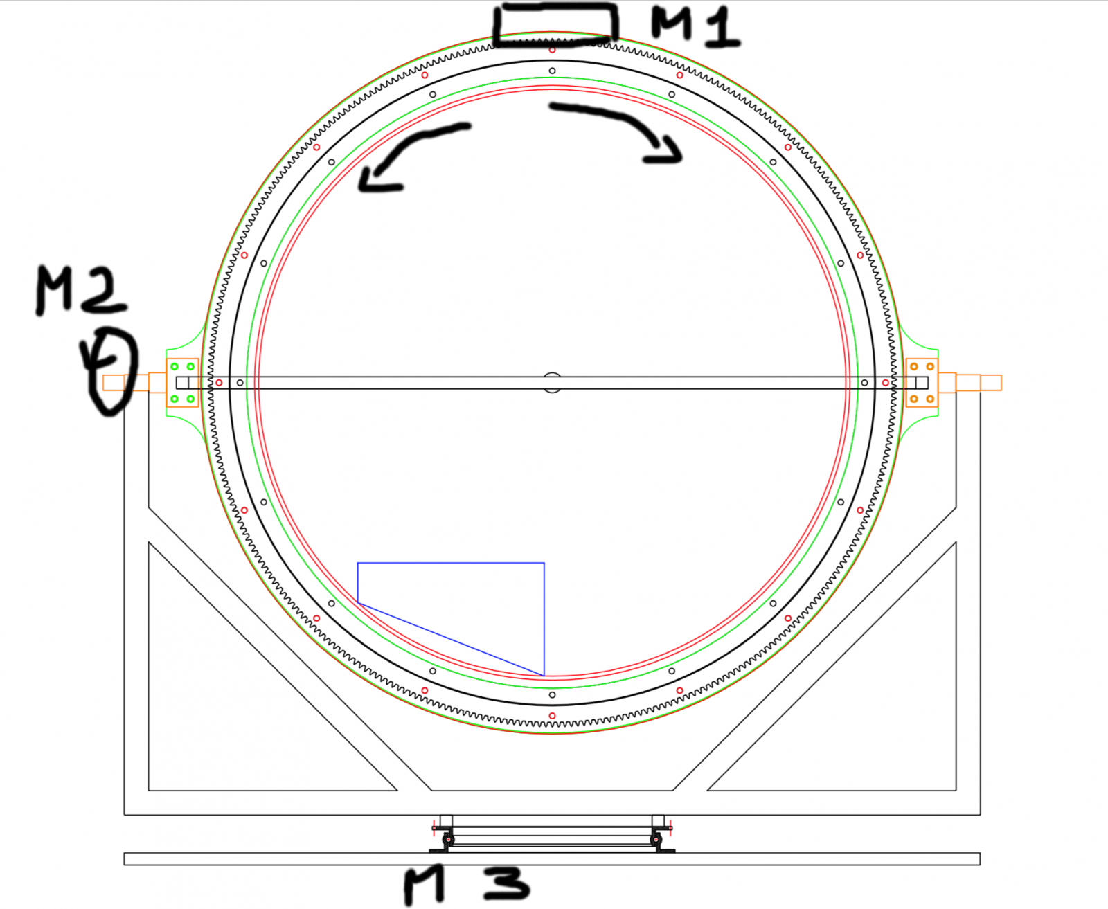

    My idea is to build a 3dof complete freedom motion sim where Roll, Pitch and Yaw shall move 360° using 1 motor per axis.
    Due to the weight I was thinking to use Arduino + Sabertooth dual 32A or 60A version and DC motor around 1,5Kw with brakes. I already design an sketch of my idea, with the help of a friend of mine.
    The M1-M2-M3 are the motors and where they should be attached, my apologize for the draw, it's just a draft.
    My question is, does SimTool support 360° with 1 motor per axis?
    I know it sounds weird as project but thanks a lot for any good advice, I'll start to post some pictures as soon as I'm sure I can do ithug:

  3. bruce stephen
    Jun 7, 2015
    1,286
    general contractor
    michigan
    9,114Coins
    +1,243 / 9 / -0
    reminds me of a joyrider configuration. m1 is usually on the same plane as m2 (offset 90 degrees). you will get the same movement.

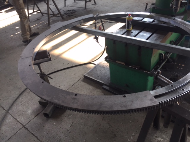

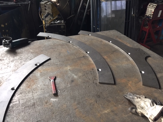

  5. Nibe
    Nibe New Member
    Jan 31, 2018
    8
    78Coins
    I decided with a friend of mine who is a carpenter to start to build the mechanical part, while I'm trying to figure out if i can use sim tool with 1motor per axis, here some picts to share :) Of course is a long way ...
  6. BlazinH
    BlazinH Well-Known Member
    Oct 19, 2013
    2,145
    Oklahoma City, USA
    16,650Coins
    +1,839 / 32 / -1
    Simtools works fine with one motor per axis as you put it but it doesn't output over 360 degrees total rotation on a given axis. So if you want your sim to do multiple rotations you have to program that aspect into a motor controller yourself or do it via an extension or custom plugin to SimTools.
    But I'm not sure your design is good for over 360 degrees anyway because motors 1 and 3 will gimbal lock when motor 1 axis is pointing upwards or downwards. What are your intentions?
  7. FargusFaustmeister
    FargusFaustmeister Member
    Mar 3, 2018
    46
    Engineering Technologist
    69Coins
    +31 / 0 / -0
    Holy moly that is a big gear ring. Are you designing around that component because you already had it or did you go and purchase it?
  8. Nibe
    Nibe New Member
    Jan 31, 2018
    8
    78Coins
    sorry guys for the delay, and thanks a lot for your feedback:
    @BlazinH thanks for the hint. I'm very happy that simtools can work with one motor per aixs. And it's fine if it will be not able to do a whole 360 degrees for the moment, once I'll understand better all the things i'll try to program it into the motor controller or create a plugin as you suggested. I hope you can help me on this to point me in the right direction.
    The motors are indipendent in the movement, there are 3 rotary joints to pass electricity and data. I know the draft was not really clear, my apologize, I'll try to post more clear information later once I finish the next stage posting more picts
    @FargusFaustmeister well I had it already, let's say it was a part of a machine that my friend, the carpenter, already had, indeed it has some pros and cons. I will describe later on once I complete the next stage.
