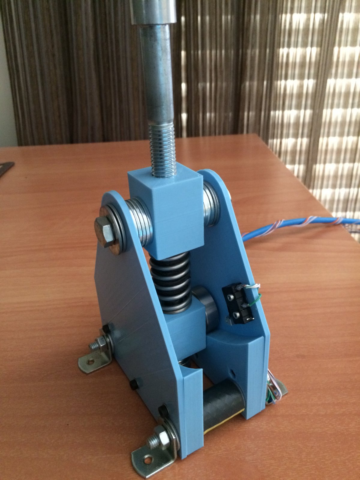

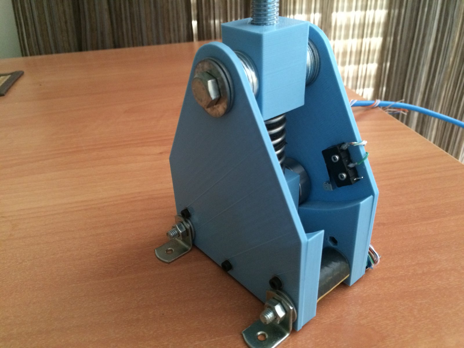

    this is my 3d printed sequential shifter.
    works really nice for a prototype.

    Very Smart. Are the printed materials pretty strong. I just expect it to be be brittle. I might have to treat myself to one of these printers one day though if they are as good as they look.

    Dude that looks sweeet....Whats the feeling like ? What other shifter's have you had in the past to compare to ?

    Pending the material and layout (infill setup) Yes 3d printed parts can be Very strong.

    i have printed it with PLA and with 15% infill 0.3mm layer hight and it seems to be strong so far.
    haven't had any other shifter nor i have played with another. just tried to copy some feeling from arcade shifters my kid has fun with
    roughly the cost is about 15-20€ with the limit switches but without any other electronics. i am using a old game-pad i had laying around.

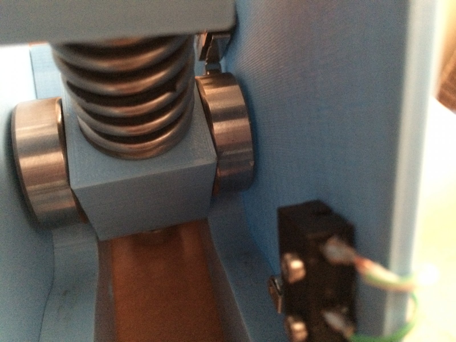

    PS: that's good to have a mechanical stop (black rubber rods) to prevent bumping and breaking the micro-switches

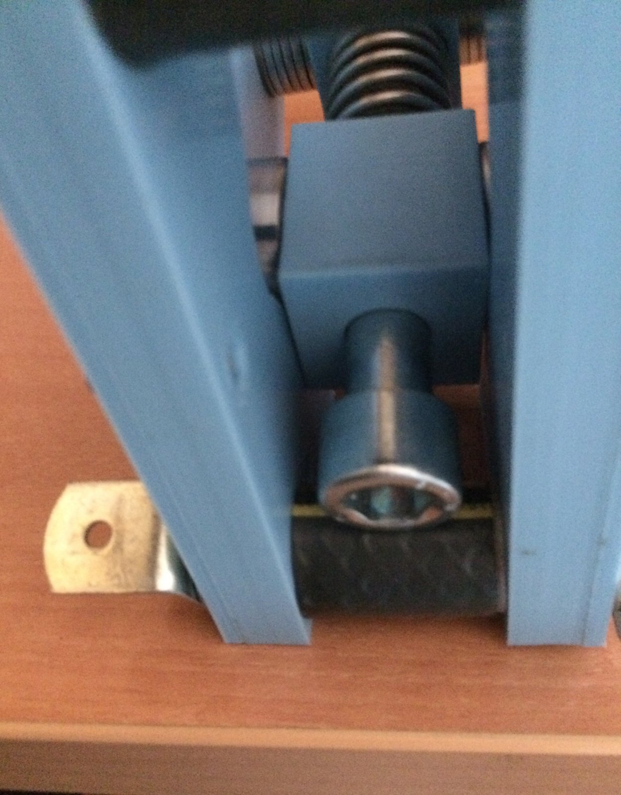

    have done it already .
    a bottom view

    @insanegr : yes, I was just describing what you'd done to give some hints to fellow members who may not notice the "black rubber rods" at the bottom

    @RacingMat sorry mate i paraphrased your post:oops:. english isn't my native language:rolleyes:.
    i had the long spacers printed and when the screw was hitting it was a bit annoying so i put them inside a water hose.
    spacers are mechanical stops too
