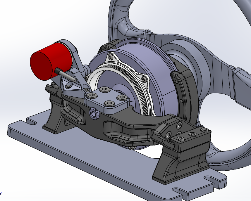

    Hi all

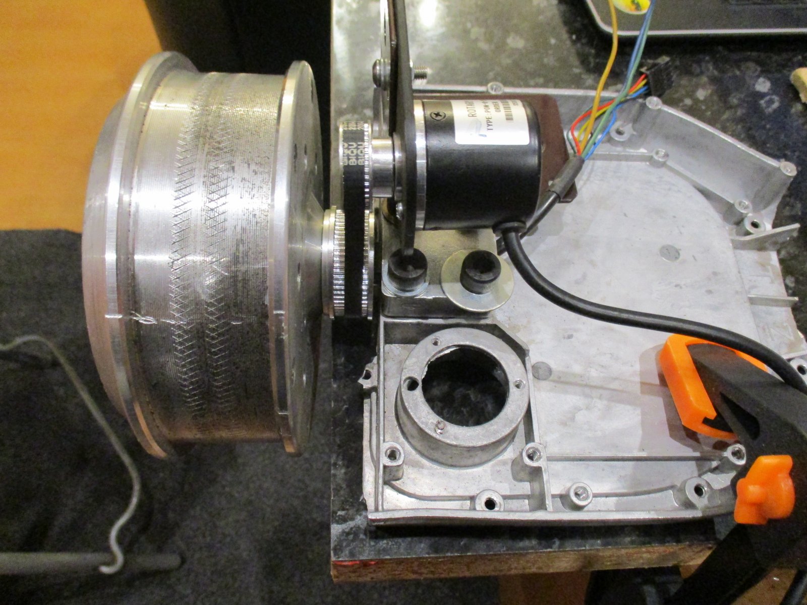

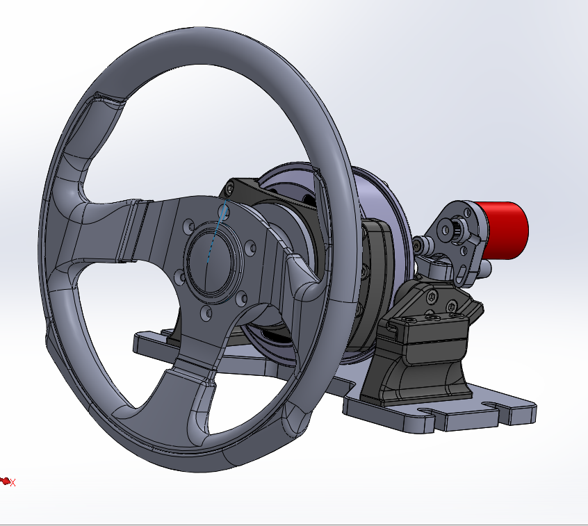

    This is the mostly 3d printed hoverboard motor based wheel I came up with.
    Its based heavily on Benu's work in this thread
    https://www.xsimulator.net/community/threads/dd-wheel-with-hoverboard-motor.13178/
    It has been working well so as promised the STL files are in link below.
    https://drive.google.com/open?id=1Hzi3nzk7vyPtMY0X6npvaA9akuJwJ5Vh
    It uses a 600ppr encoder like this one
    https://www.aliexpress.com/item/32877702646.html?spm=a2g0s.9042311.0.0.27424c4dBf3Gry
    A 400mm gt2 belt
    A 20 tooth GT2 pulley
    and 2 686 ball bearings
    More info to come

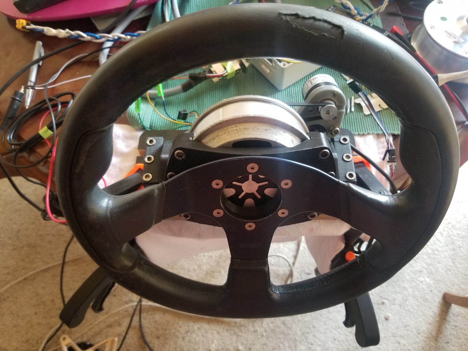

  7. Feisty
    Feisty New Member
    Mar 29, 2020
    21
    169Coins
    +11 / 0 / -0
    AC motor

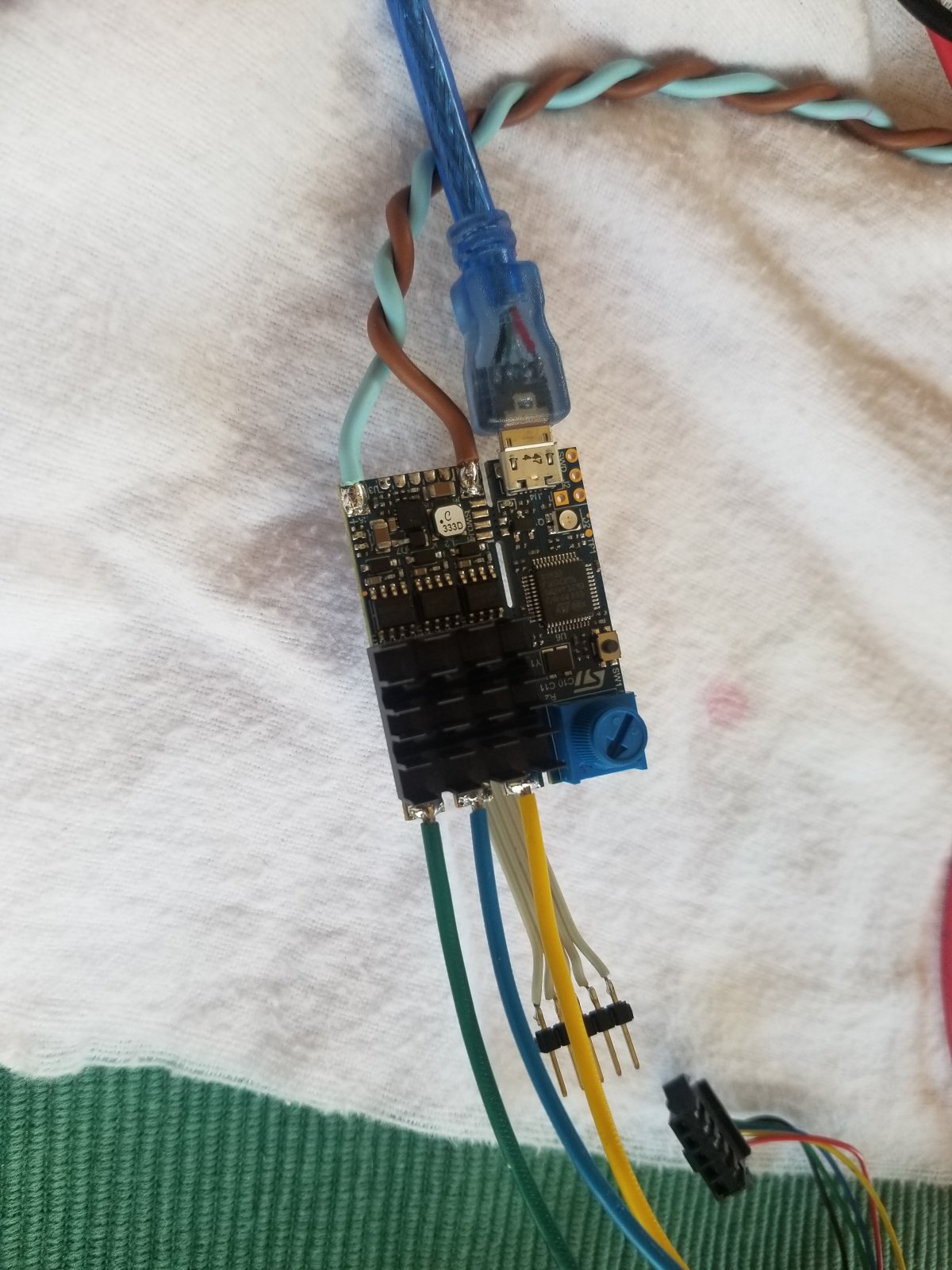

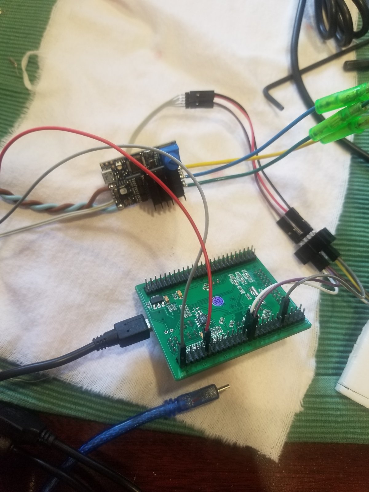

    Turns out the industrial drive is probably dead do thats a no go. I have however received two of the B-G431B-ESC1 boards. Ive got them all wired up to a core407v board with Mmos on it so should be good to go. The only thing not connected at this stage is a braking resistor circuit, I haven't worked out how to do that yet but I think I can prove everything will work without it.
    I will admit that Im really struggling with how to configure the motor controller.
    @danove_b could I bother you for some help?

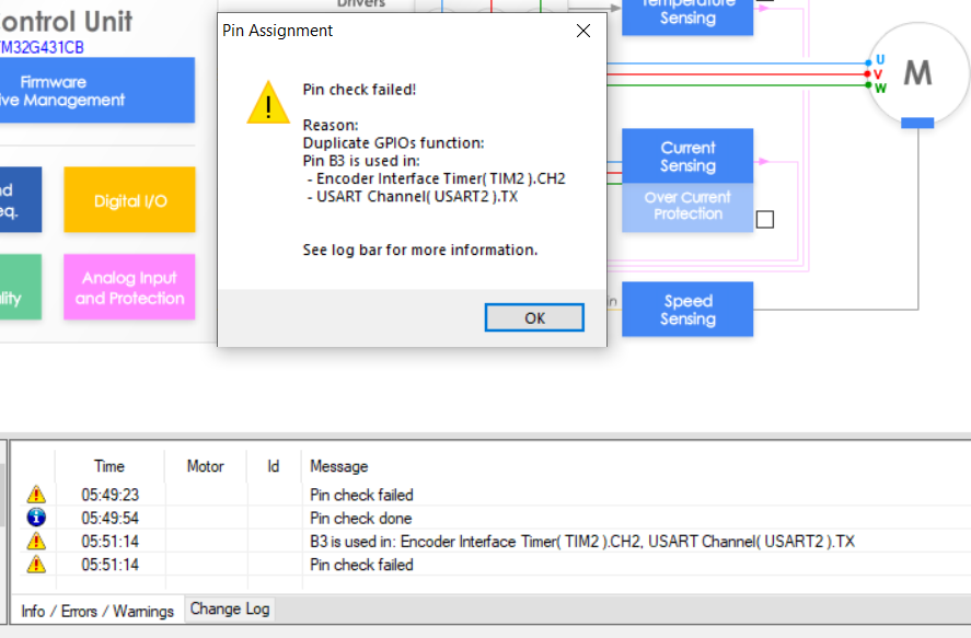

    So far Ive run the motor profiler and started a new project in the ST motor controller workbench software. Ive changed the motor sensor to encoder and also set it as the speed sensor for closed loop.
    Im getting the following error when I run the pin check utility. Im not sure what to change so there isnt a clash, I also can find where to set the input to PWM

    I have the code that @Benu sent me, but I don't want to give it away without his permission.

    The Z input. Also important to know is that the encoder value is multiplied with 4, so it cannot be more than 16384 without manually changing the code. That happened to me!

    AC motor

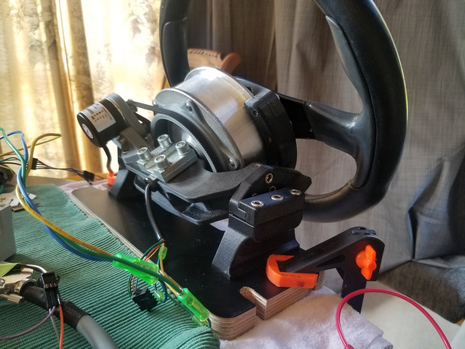

    Just a quick update. Thanks to Benu this wheel is now working!
    I havnt got a braking resistor set up yet which is absolutely necessary, Ive ordered parts for this which will hopefully be here in the next few days.
    I am using MMos which is working well. I want to try and learn how to program these motor controller boards but its rather involved which is again props to Benu.
    Id like to try 24v and to fine tune a bit more of the setup but this combination has a lot of potential and already feels excellent

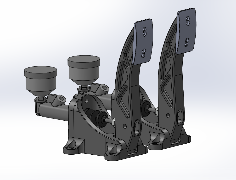

    Started on some pedals

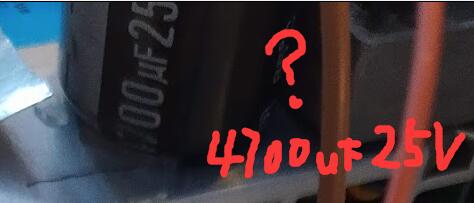

  20. fzxj520
    fzxj520 Active Member
    May 14, 2015
    176
    1,341Coins
    +90 / 1 / -0
    Ah, the noise is relatively small.
    This is a photo of danove_b may help.
    Can this circuit be recycled and used back EMF?
