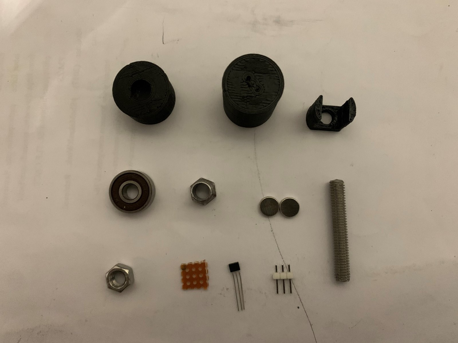

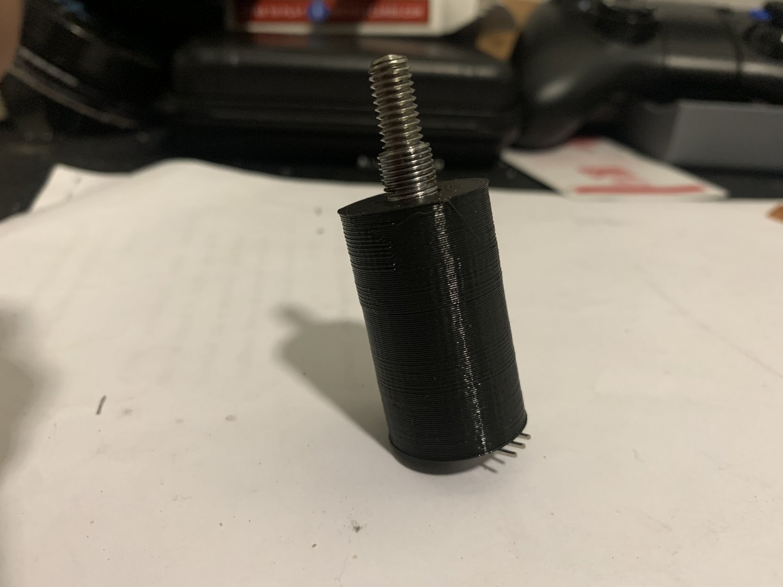

    So I've been wanting to upgrade the pots on my DIY pedals with some hall effect sensors for a while. After looking around and seeing the prices the commercial hall effect encoders go for (more than $50 each when converted from my local currency) I decided that I would go the DIY route.
    Here's the finished product first:
    Materials used:
    • 3D printed parts
    • 606 bearing
    • Threaded guitar tuner (8mm OD x 6mm ID)
    • 2 x neodymium magnets (8mm x 2mm)
    • 6mm x 40mm threaded rod
    • 6mm nut
    • Small piece of protoboard
    • SS49E hall effect sensor
    • 3 pin male header

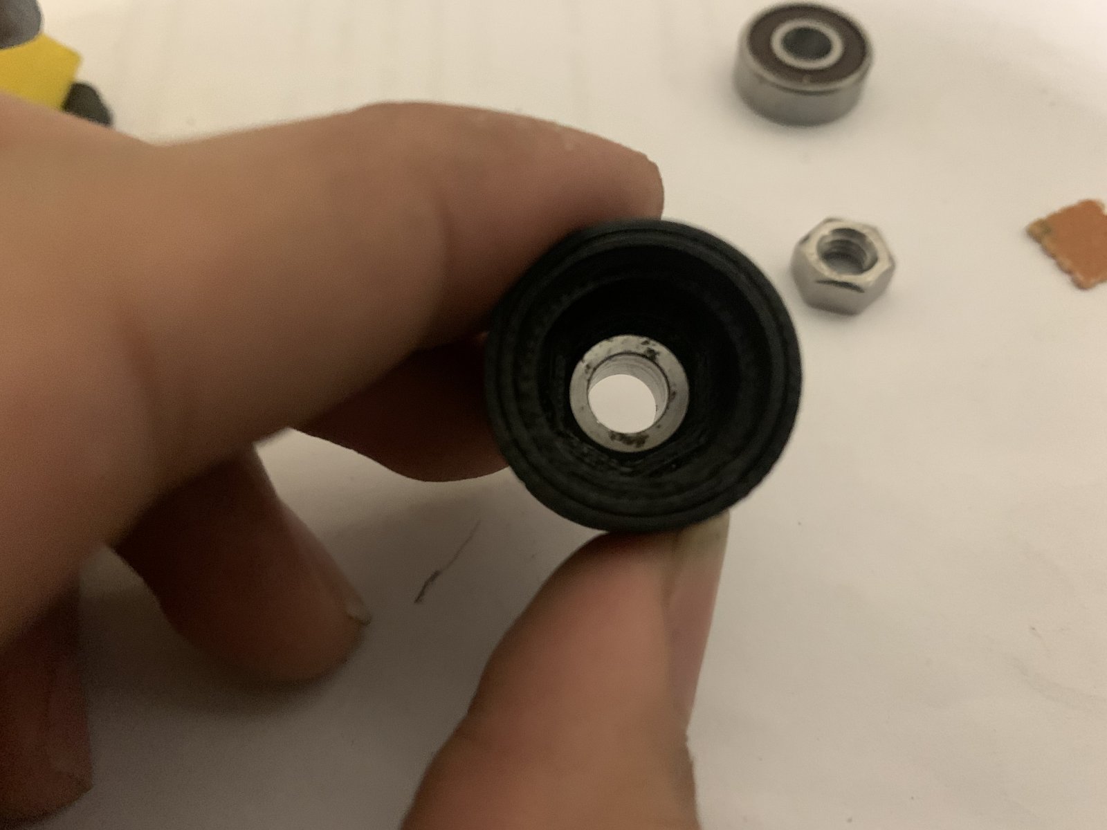

    *** I meant to say threaded guitar tuner bushing, it isn't really necessary but it gave me a nice way to panel mount it.
    Thingiverse link:
    https://www.thingiverse (dot) com/thing:4423750
