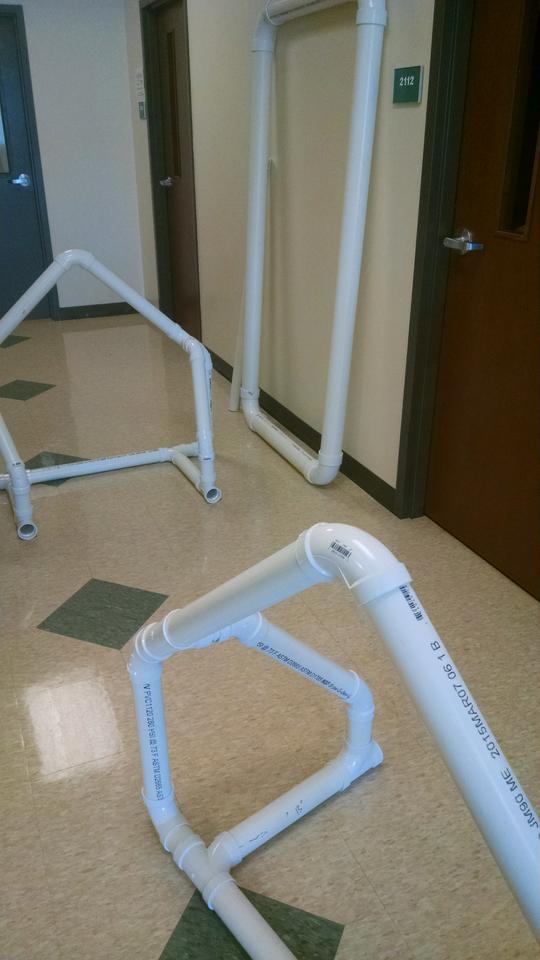

    UPDATE: Check my post below. Tl;dr, didn't finish it, won prizes anyways, still going to finish it (this weekend?)
    This weekend, myself and four others are working on a joyrider sim. First of, big thanks to @bsft and @eaorobbie for their advice and help.
    We're assembling this as part of a hackathon at our university here, running for 36 hours.
    We had to make significant sacrifices in the name of saving time, which led us to purchase
    https://www.sparkfun.com/products/10182 - Arduino Moto Shield
    http://www.robotmarketplace.com/products/AME-218-1001.html - Modded wiper motor x2 (sorry @bsft, this was the only thing we could find in time)
    JRKv12
    Unfortunately the motors haven't arrived yet. We still have 20 hours to go, however.
    So far, we've got some of the frame assembled and a game using the Oculus (3 people working on the game, 2 people on the sim).
    We're going to run our custom game as well as Elite: Dangerous. Looking forward to how this turns out!
    This is only version one, if it works we might have enough funds to make a second, improved version.
    Cheers

    Predictably, we didn't finish the sim. BUT, here's how far we got. (sorry for huge photo)[​IMG]
    Good news: it didn't matter that we didn't finish. We still won best hardware hack, and took home 5 leap motion controllers as well as 5 $25 in prizes of our choice.
    More good news: We got a space to finish working on this on campus.
    We ended up with 2x Dodge 1995 B3500 wiper motors because the modded ones we ordered didn't show up in time (still haven't, actually despite 2 day air). One of our PSU's was shipped DOA, and we fried the other one because we didn't ground the PSU first. Not a huge deal, $20 loss. Picked up another PSU at Walmart at 3am.
    2 of us worked on the flight simulator while 3 others worked on a game in Unity. This ended up being really good, because it meant we had a finished product we could demo. The game was a "paper airplane simulator", and the idea was that you'd get to feel like a paper airplane in virtual reality, flying around. We're hoping to make a custom cockpit and tron game (where you'd be laying forward on this), because that would just be awesome.
    Despite getting around most of our motor issues, we didn't end up getting the motors to work at all. We're going to do that this weekend, being a bit more careful and having the right parts. Since we've still only got one JRK controller, we're going for 1DOF until the other arrives. This being our first time, 1DOF entails enough issues and we are fairly confident that we can mod it to 2DOF with enough foresight in our design. We modified the bearing mount due to a lack of bolts and the fact that home depot was closed, though I think this led to the outer parts bending in rather dangerously.
    We're 90% sure that funding is going to come in for this project. We're hoping to build a 2nd version with better motors and conduit piping to sell to our university lump-sum (offload all the insurance/licensing issues to them, essentially). That part is still very much in the air though.

    We finally got the sim working with 1DOF as a temporary setup. Feels good in LFS with the Oculus on, though we didn't have positional tracking setup which made you a bit sick. We're starting on 2DOF now and tweaking our 1DOF design to be less of a hack. We ended up moving the chair up because it's way too low here. Also, you can tell how much of a death trap this appears to be. It's safer than you'd think, but not necessarily by too much.
    Pulley design is definitely not ideal. We're looking into either a better pulley design or gears for the pitch axis.
