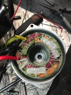

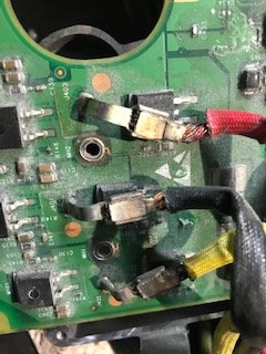

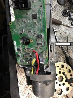

    I'm very excited to build my own FFB Steering Wheel, but unfortunately I'm not a programmer or electronics engineer. Instead, I work as a car mechanic.

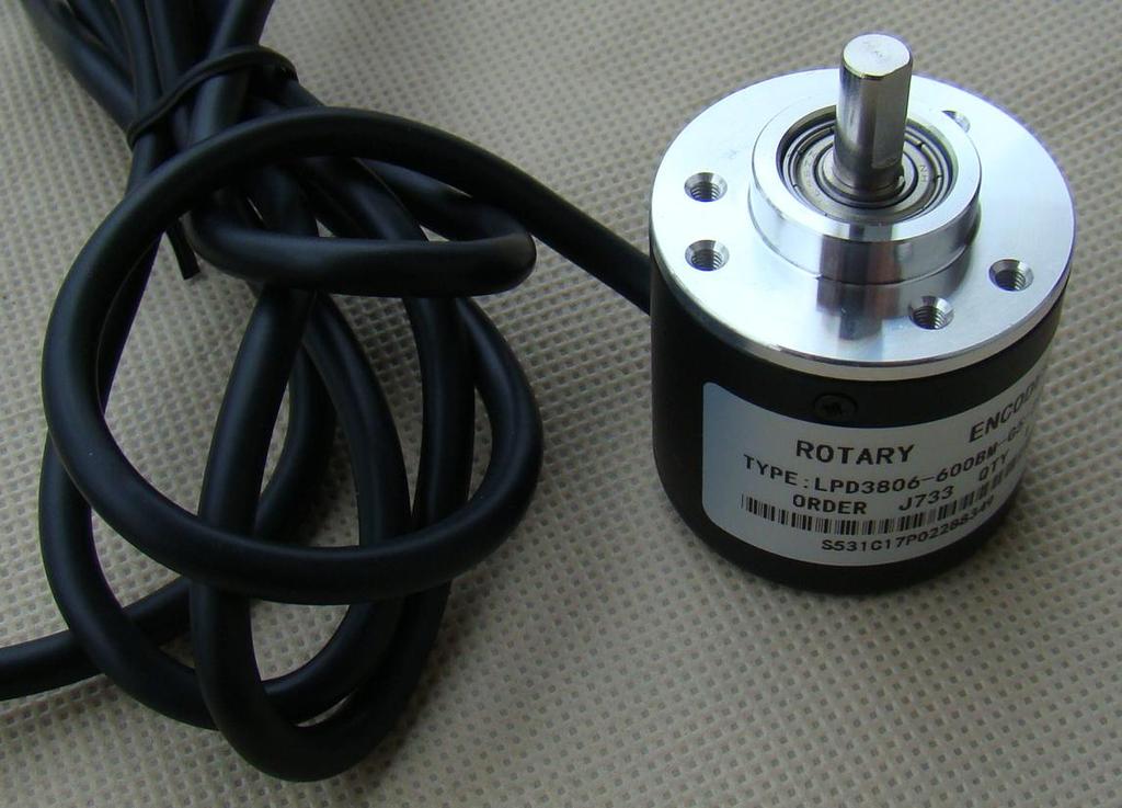

    I am in possession of an Alfa Romeo power steering. it has everything (engine, gears etc.), I just need to buy an encoder and arduino. My problem is that the motor is 3 phase, I have already searched the entire internet and found no way to connect it. is there anyone here to help me? I present some illustrative photos.
    Additional elements are:
    - Arduino Leonardo
    - Encoder
    - H bridge?
    - Power Supply eacb378842e282997738e665b99c.jpg image0.jpeg image2.jpeg image3.jpeg image4.jpeg

    is it a brushed motor ?
    where is the ground wire ?

    it is a stepper motor
    without a ground wire

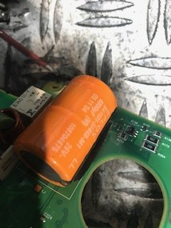

    I guess I know the solution. there is a capacitor on this circuit. I need to run two of these phases through this capacitor? Do I understand it correctly

    Stepper motors are not suitable for a ffb wheel
    They are activated by pulses, you need a dc motor or a servo motor
