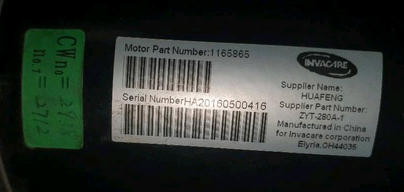

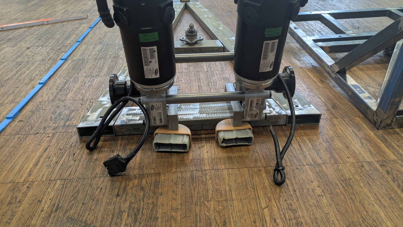

    I found these motors, (not ordered yet) unfortunately i can't find the power in watts, does anyone have experience with these motors?
    What current do they need? Unfortunately I can't find anything.
    Motor picture:
    Many thanks in advance.

    If a search fails to find the specifications you may need to try emailing the manufacturer.

    The motors should be powerful enough for a range of rig designs, it really depends on how easy the brakes are disabled.

    Most of the used motors here are between 250-350W or?
    21,907
    153,053Coins
    +11,117 / 56 / -2
    That range should suit most sensible designs.

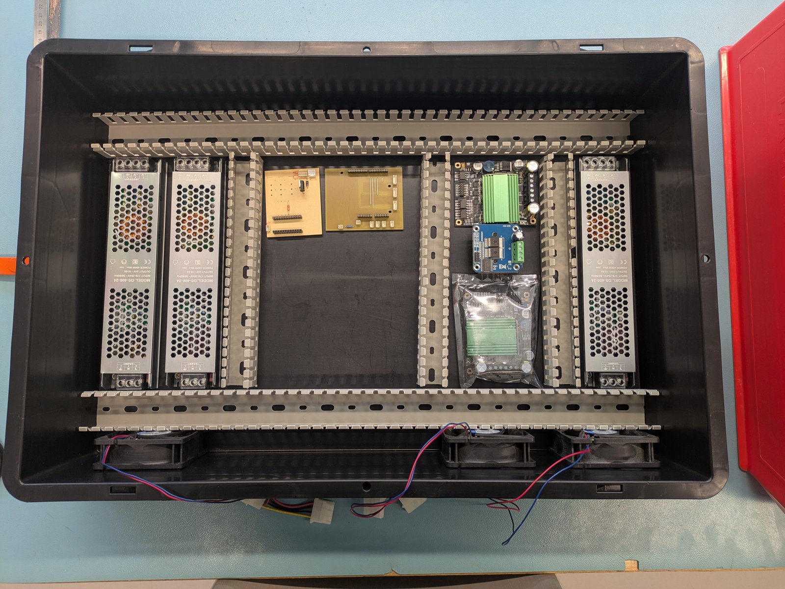

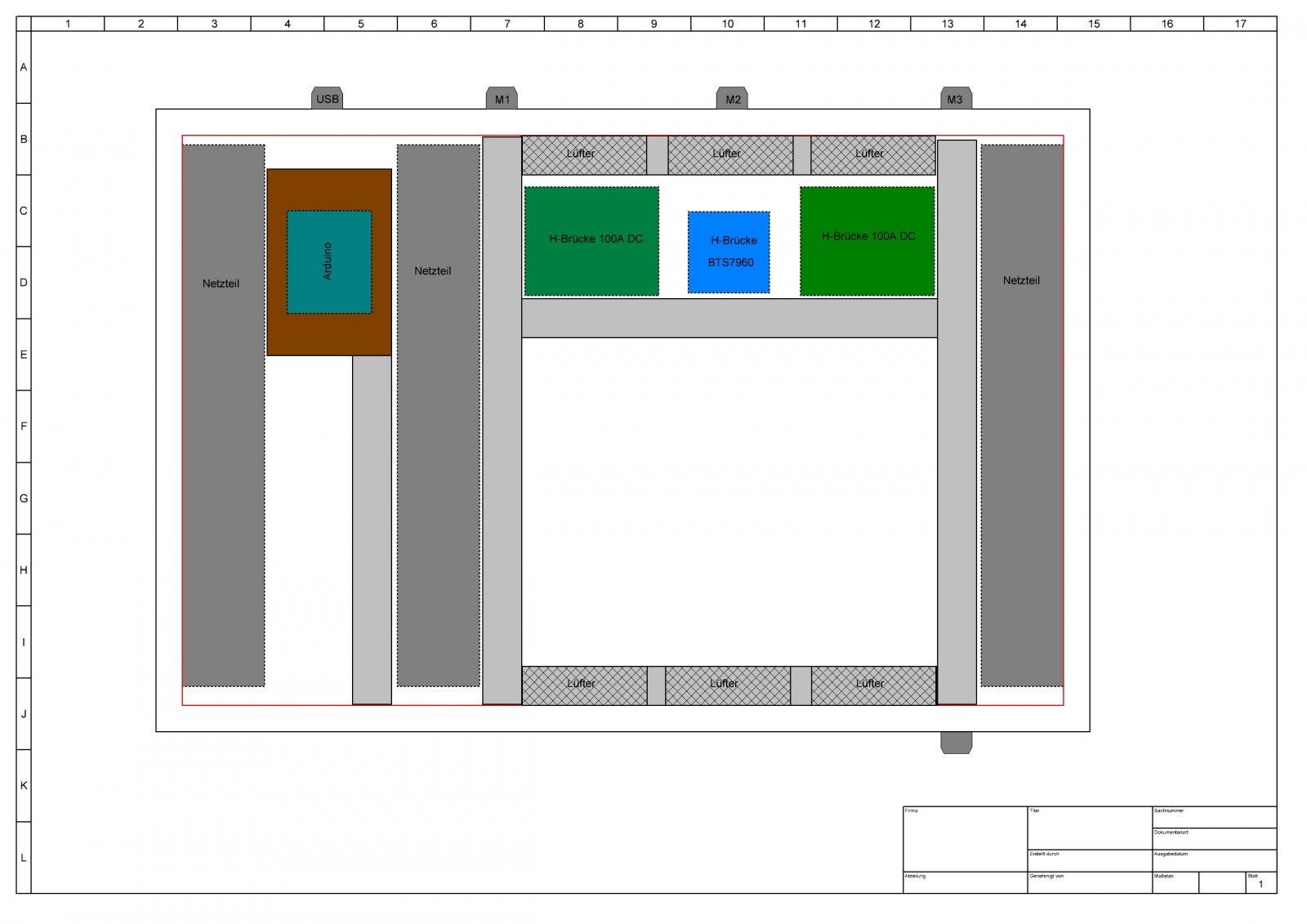

    Now that I'm allowed to post links, here's my list of components:
    - 2x motors (left and right)
    - 2x H-bridge 100A
    - 1x H-bridge 43A
    - 3x Hall sensor
    A "Eurobox" is to serve as the control cabinet.
    Here is my plan, sorry it is in German.
    Since the motor needs less power for the yaw movements, which one can you recommend? A cordless screwdriver motor? Or something more powerful?
    Thank you

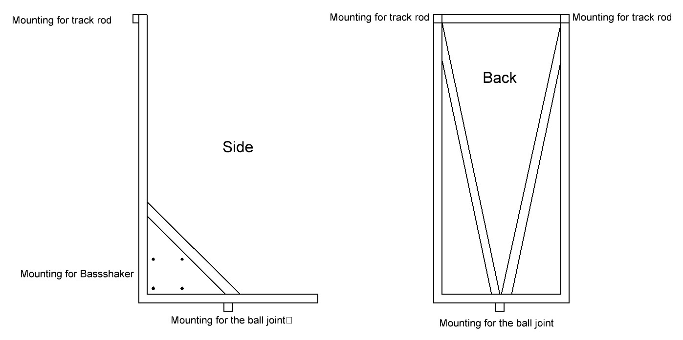

    After a long break, I will do my best to finally finish my simulator.
    This is my test to see if everything fits into the control cabinet.
    I also want to plan the bracket for my seat. You can find a sketch of this in the appendix.
    What do you think?
    Thank you very much for your support :)

    Just be aware the mounting point for the uni joint needs to be determined with you onboard, along with all peripherals, please see the FAQs here: https://www.xsimulator.net/communit...-of-gravity-to-balance-a-motion-simulator.55/

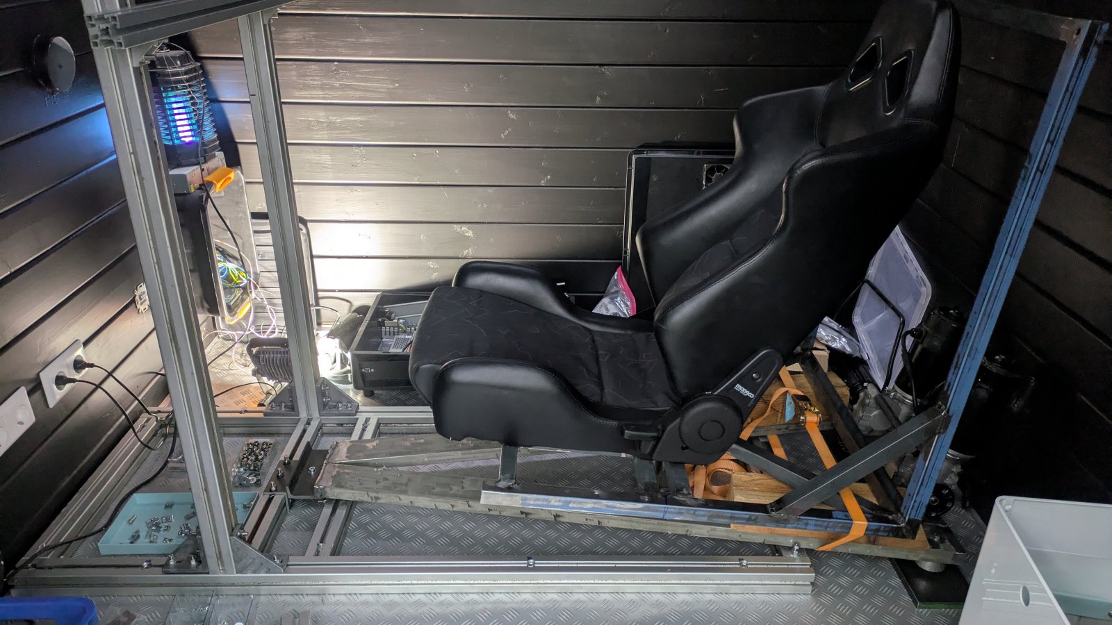

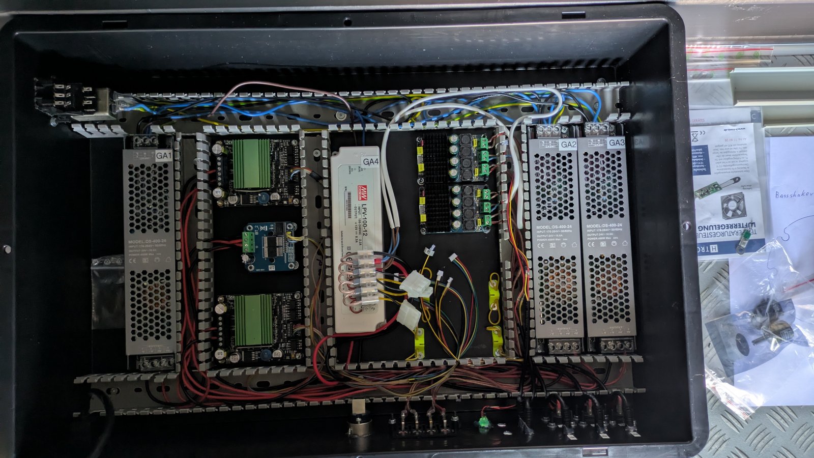

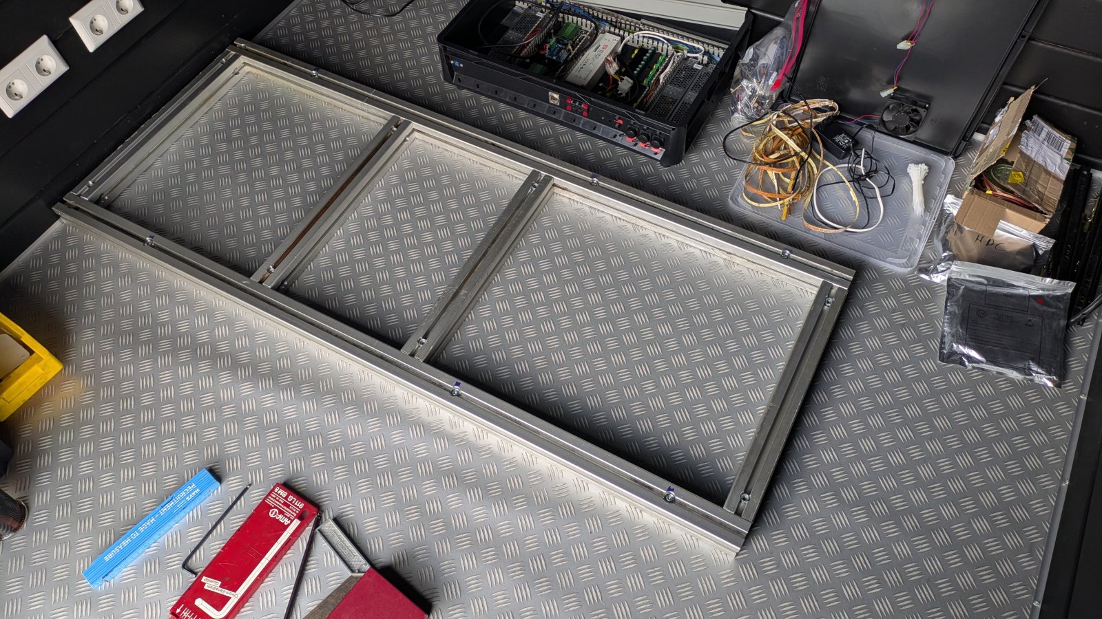

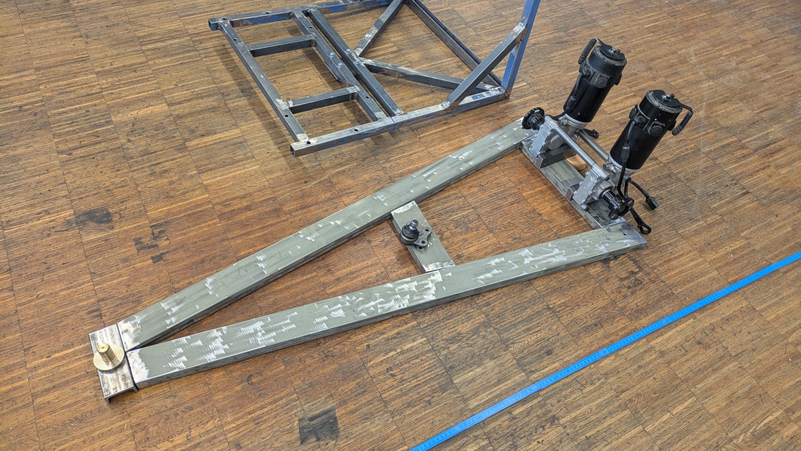

    Hello everyone, here I am again:
    In the meantime, I have continued working.
    1. The control cabinet is almost finished.

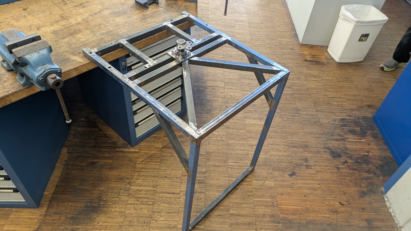

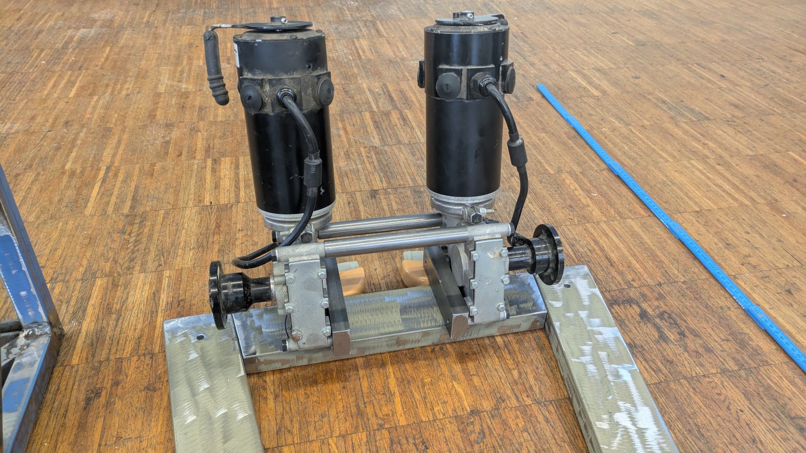

    2. First and second platforms for the three axes.
    Lower fastenings mounted on the floor
    Seat mount
    Frame for lateral movements
    All together
    And yes, I build a cabin in my garden just for the sim :)
    greetings
  12. Misanthrop
    Misanthrop Active Member
    Feb 5, 2024
    128
    766Coins
    +51 / 1 / -0
    It was already mentioned, be sure that your weight is balanced on the ball joint. When not, because it doesn´t look like it, your Motors will have much more stress and every movement doesn´t feel right. Looks like your seat has to be far more to the rear.

    Hey, thanks for your advise.
    Yes, it is balanced because the Seat ist leaning in the rear for GT3 Feeling.
