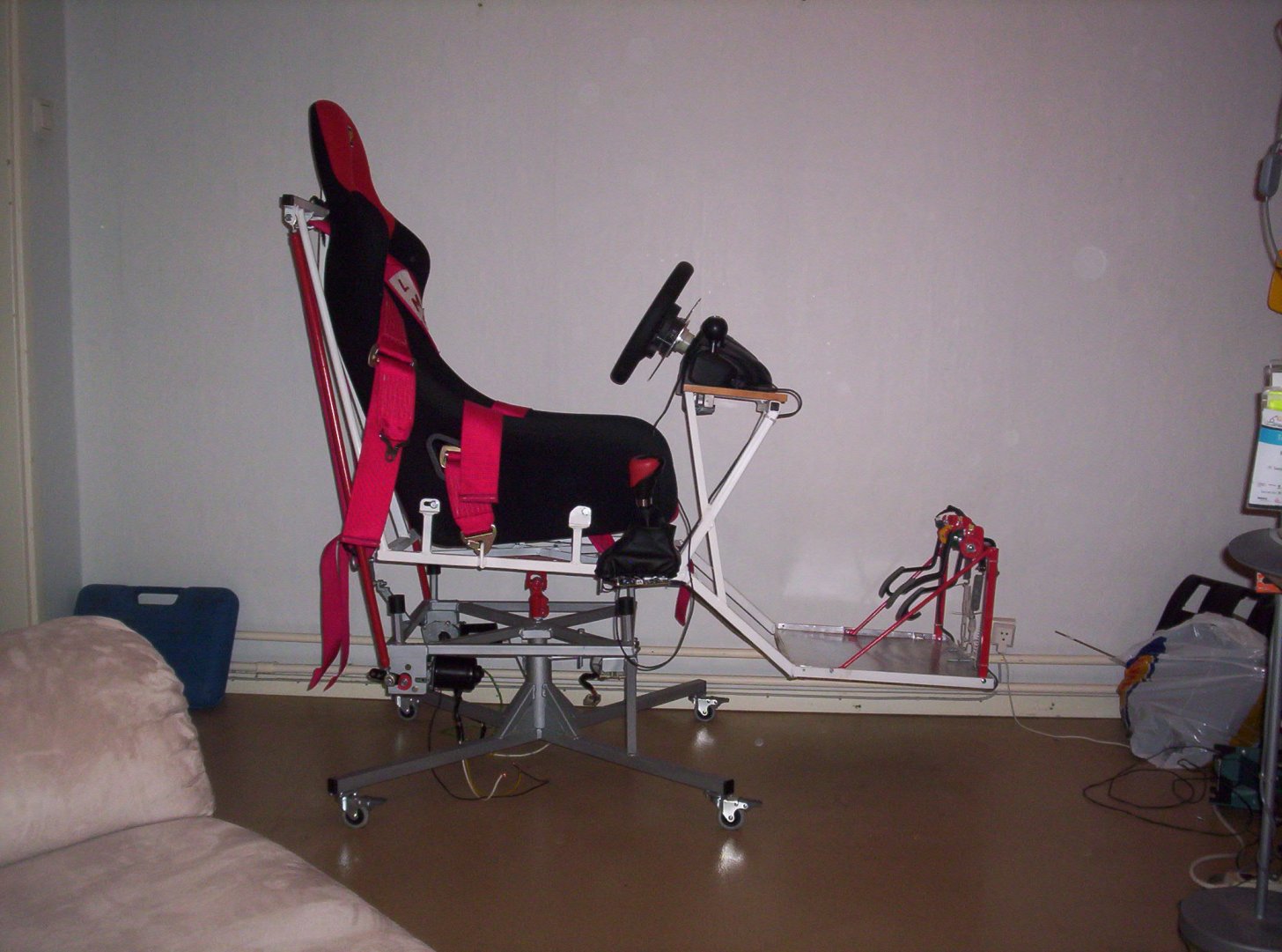

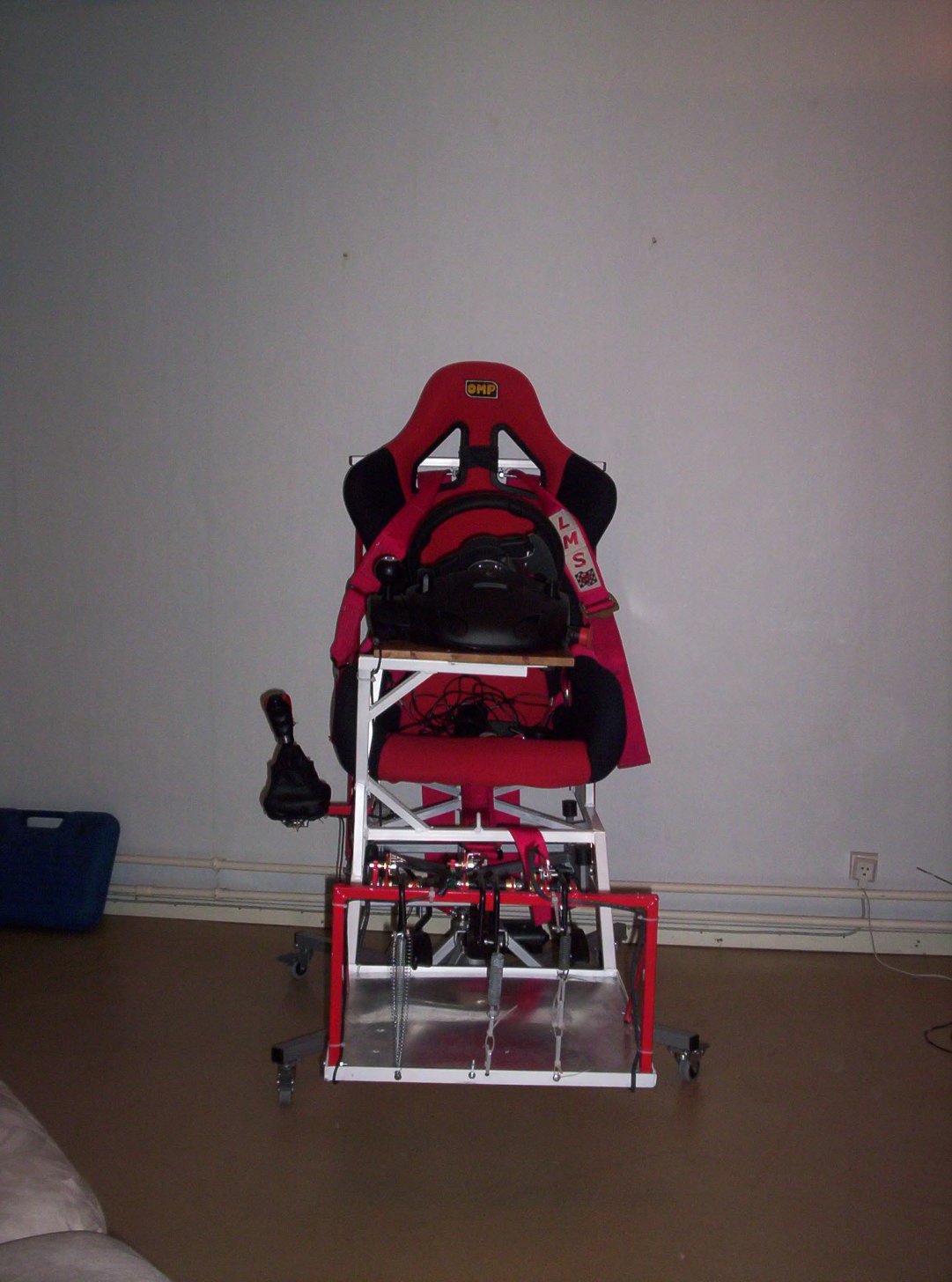

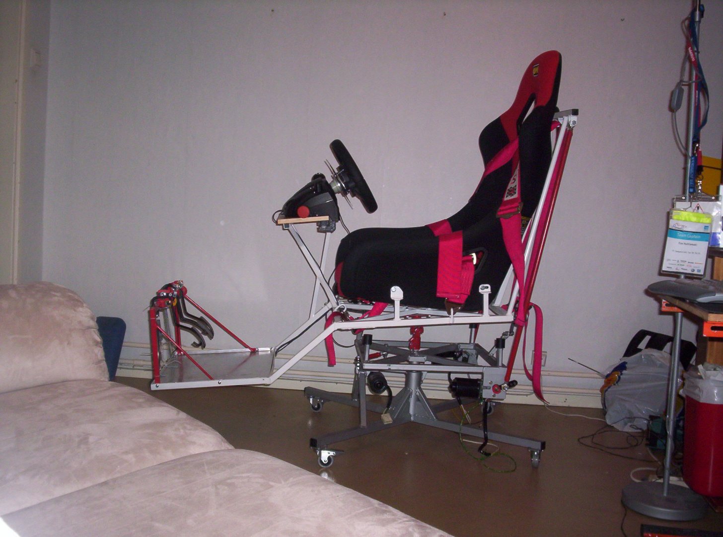

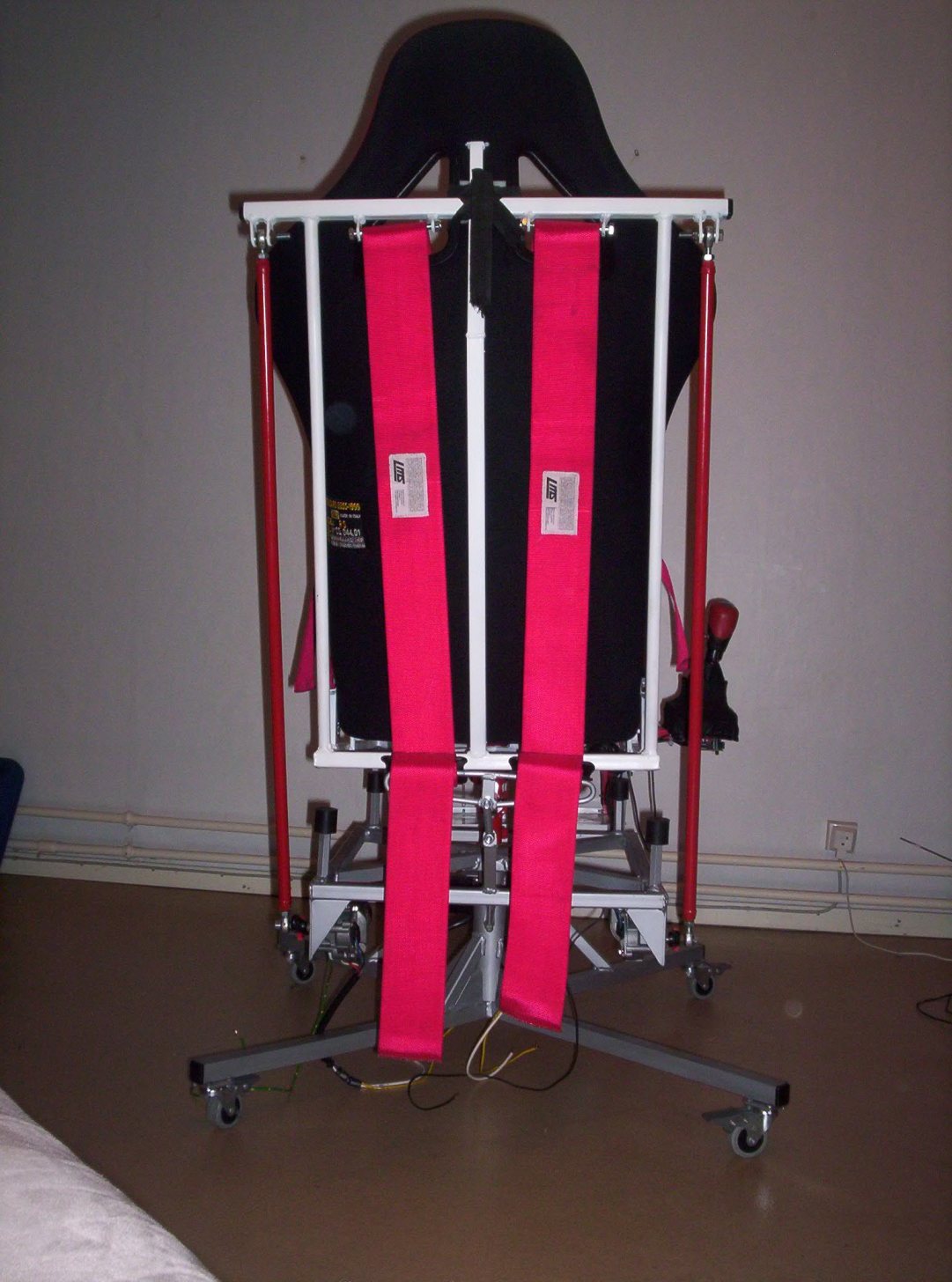

    After reading a lot about your simulator projects, I decided it’s time to introduce my sim project. A huge thanks for all of you, who have made this forum possible and all you guys sharing your knowledge with others. Before discovering the X-sim, I couldn’t have imagined that it’s possible to do-it-yourself something so cool as you guys have done.

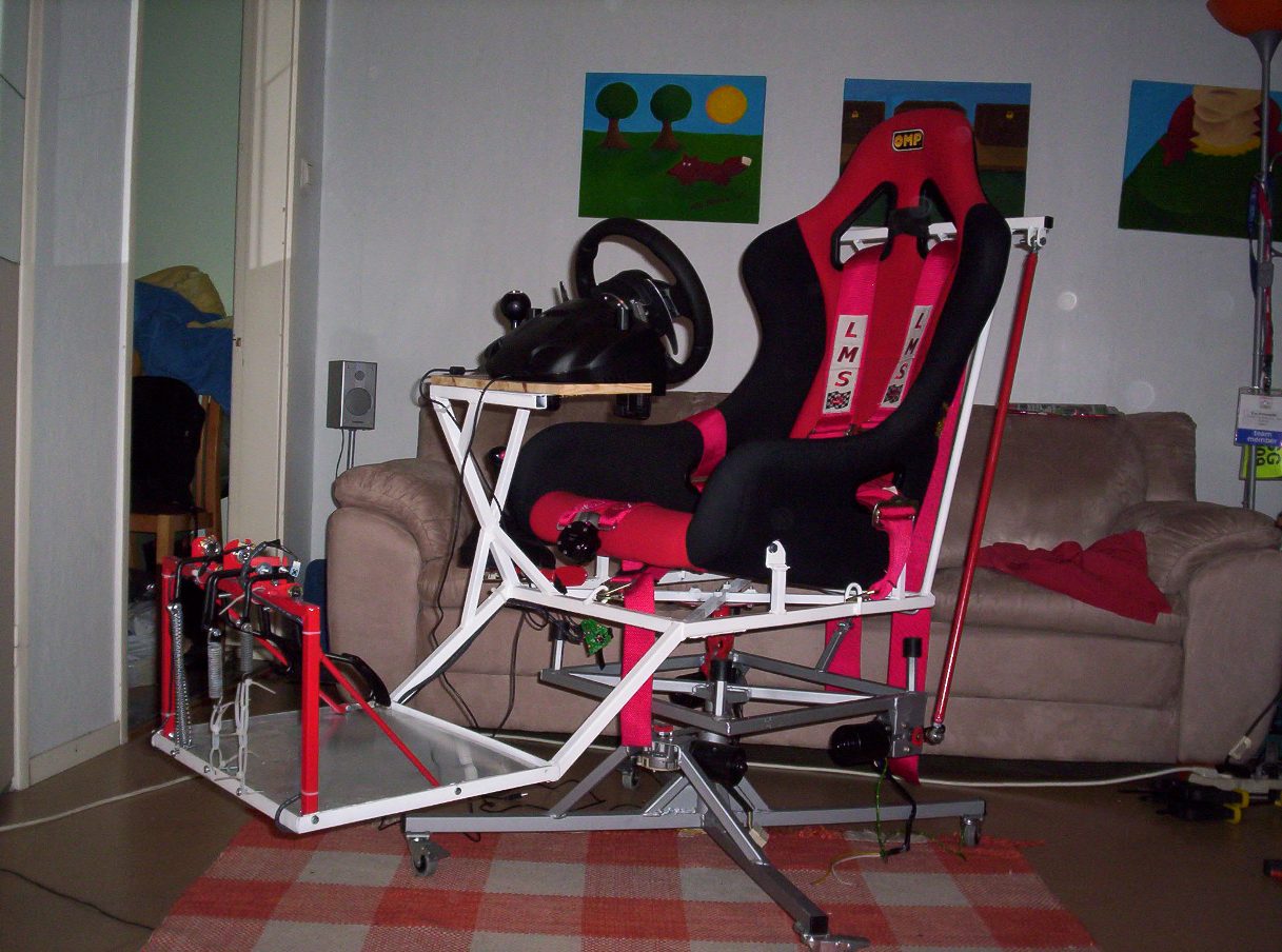

    I started my project in the beginning of 2010 and aimed to get the whole thing moving in the end of the year. I know, not too thight schedule. After thinking between SFGT and Joyrider style simulators, I decided to make a wiper motor powered SFGT with moving pedals and wheel. 3rd DOF is rotation around Z-axis, which is made with a basic armchair’s bearing unit. While the bearing is under the seat, it doesn’t require too much strenght to rotate the sim.
    After reading Thanos’ AMC thread a few minutes (hours, days, weeks, don't remember anymore :) ) I decided to take that route with electronics: AMC1.5 and DHSmb 1.2b. 3rd axis will require additional AMC/DHSmb, but they will be done once the first set is complete and tested.

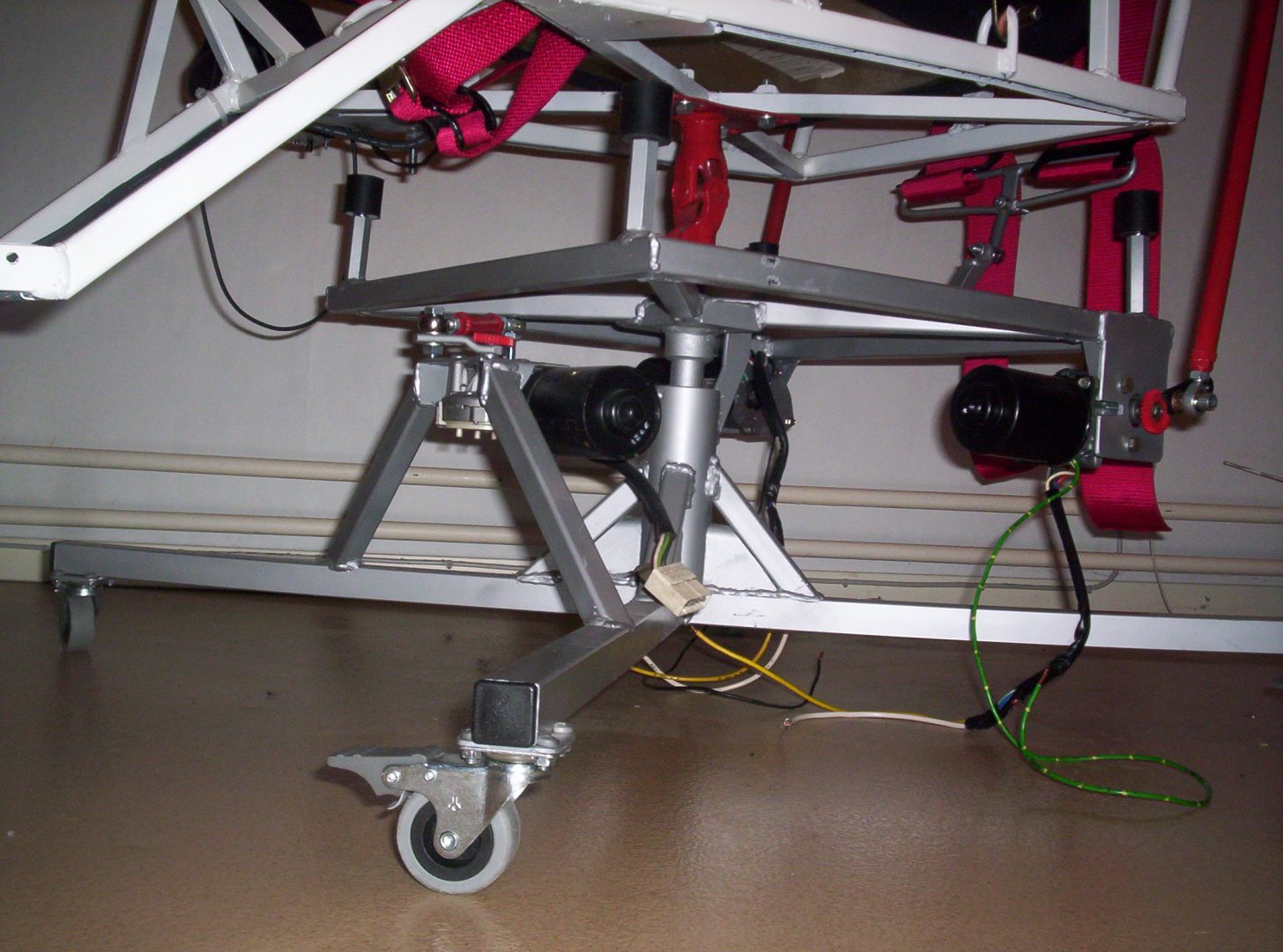

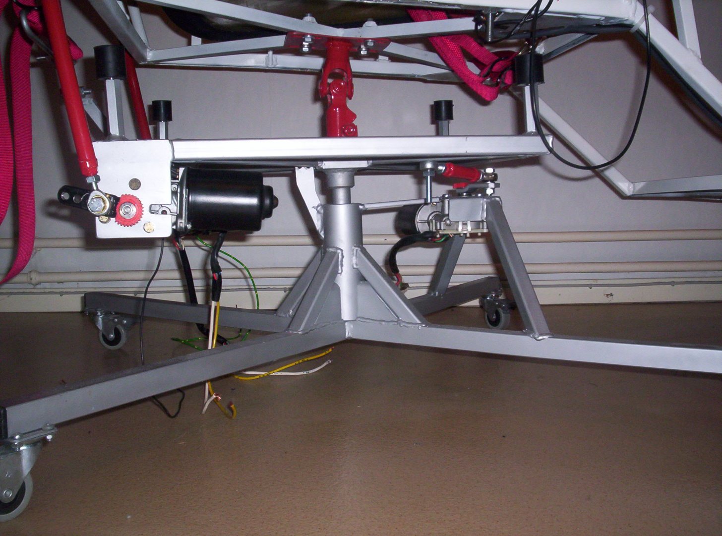

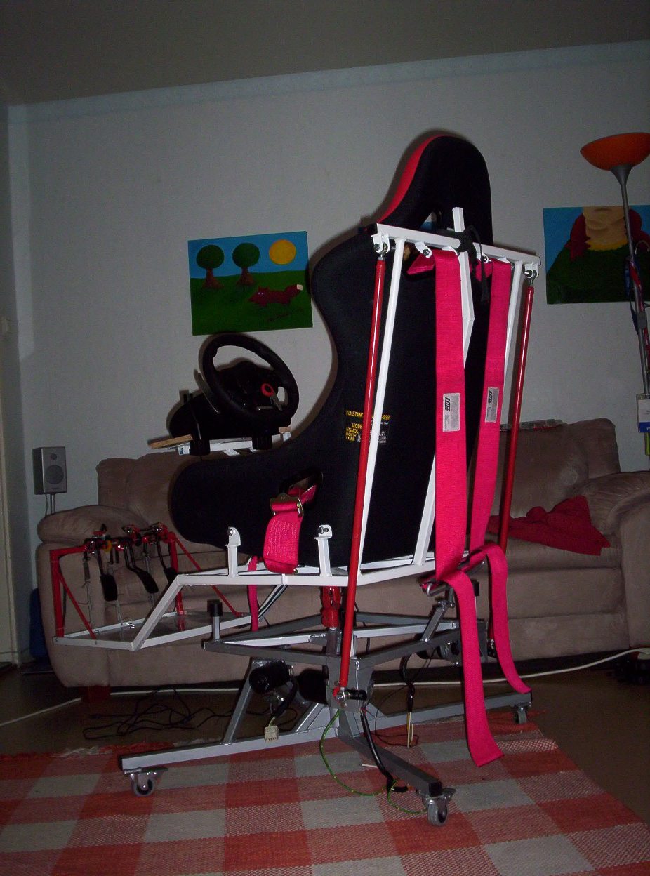

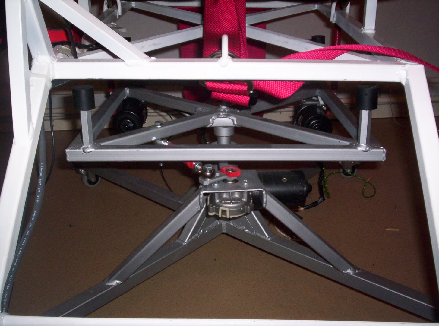

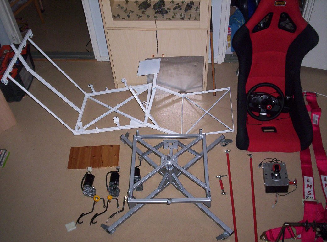

    In the first pic there are shown the major mechanic parts to assemble the sim: some painted steel pipes, three wiper motors, bucket seat and a cheap racing wheel, that’s almost all you need ;D . Pictures 2 and 3 shows the parts assembled.

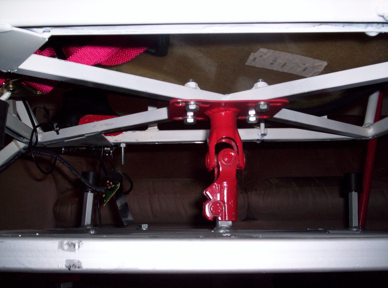

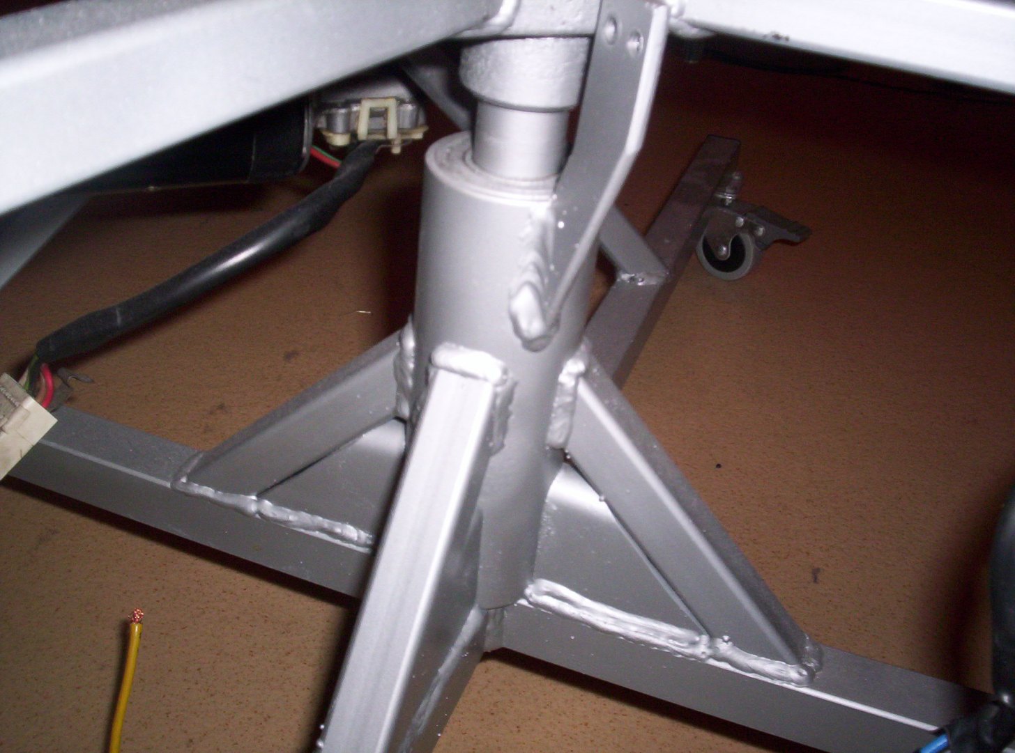

    Pic 4 shows a U-joint under the seat. Adjusting center of gravity is possible due to bolts’ grooves.

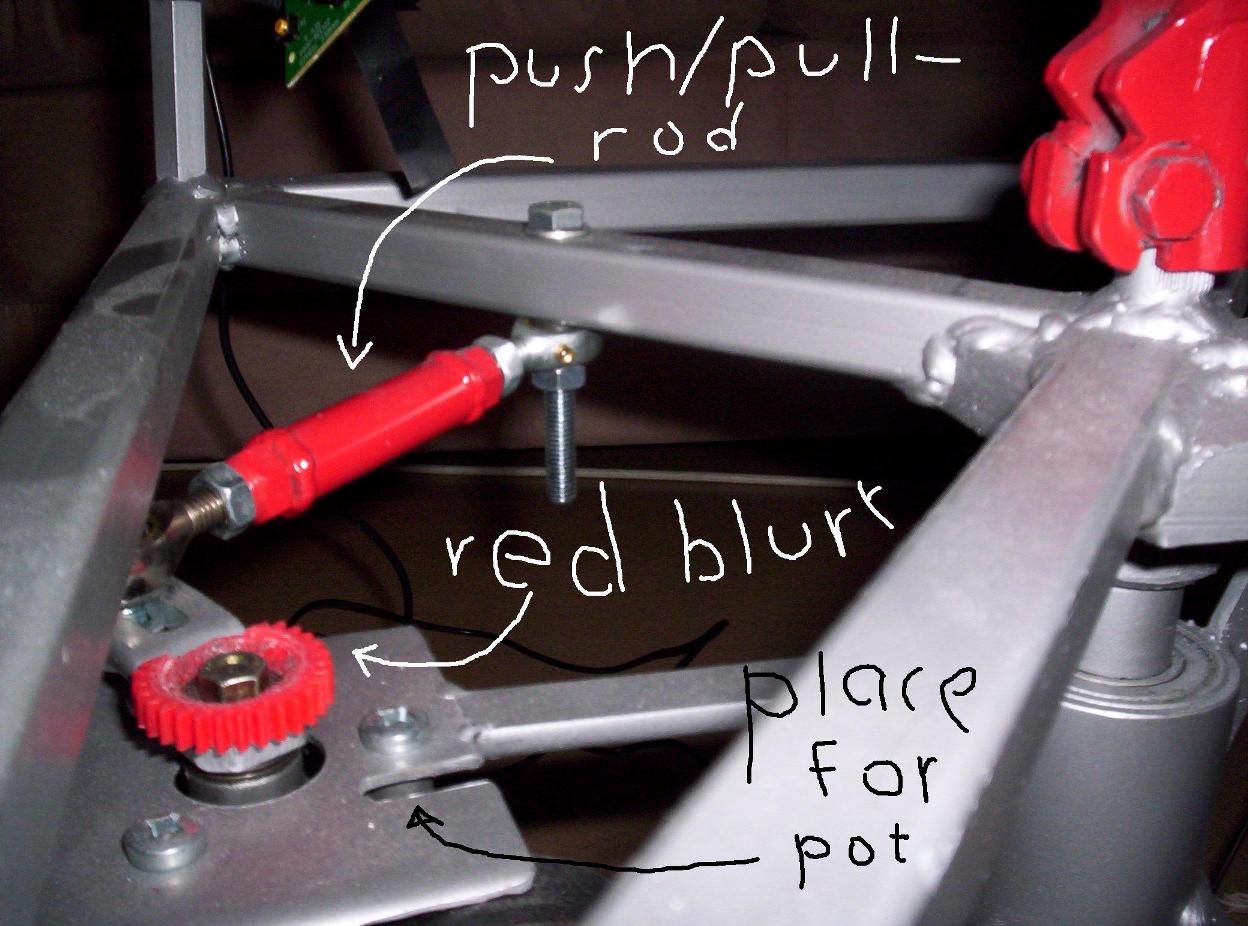

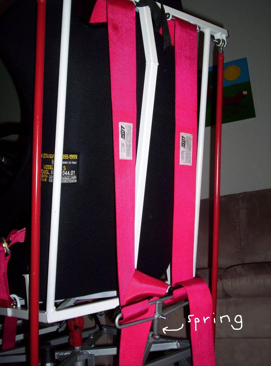

    Pic 5 demonstrates how the motion of third axis is carried out. Red blurr on top of the motor is a sprocket for potentiometer, which isn’t currently there. Since rotation will be quite small, simple push/pull rod will do the job.
    6-point harness’s shoulder belts are connected with a spring to the middle frame, so during braking the belts will get thighter. We’ll see how it works while driving.

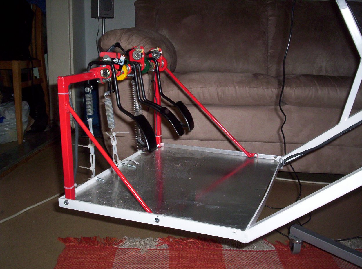

    Since Logitech DFGT pedals lacks the clutch, I made more robust diy-pedals. More pictures and details in Bernhard’s thread concerning DFGT pedals: driving-force-gt-potentiometer-output-values-t2674.html

    It looks very compact and light :)
    I think you should make a stand more robust (the cross bars with wheels). Maybe I'm not seeing it right, but I think the bars are a little bit bended, or you could just add one more wheel at the center.
    Keep up the good work!

    I have tried to keep especially the upper frame as light as possible. The upper frame itself weighs about 9kg. However I'm a bit concerned how the wiper motors will handle all the weight including those steel pedals, which aren't the most lightest ones. Lower frame's cross tubes are quite sturdy, they are 25x25x1,5mm in dimensions. Other square tubes are 20x20x1,5 and some 15x15x1,5mm.

    nice pedal you have

    Wipermotors are from Citroen Xantia, two are labeled as Valeo 53545802. Third is a bit different in looks and doesn't have a sticker to be recognised.

    I have done that sort of tests with one motor and other motor fixed. The motor could spin with the driver, but struggled from the lowest point to get moving again. That was the time I started to think are the motors enough for this sim. Of course SATO's and ua6aak's sims proves that wipermotors are strong enough (at least in their sims :D )
