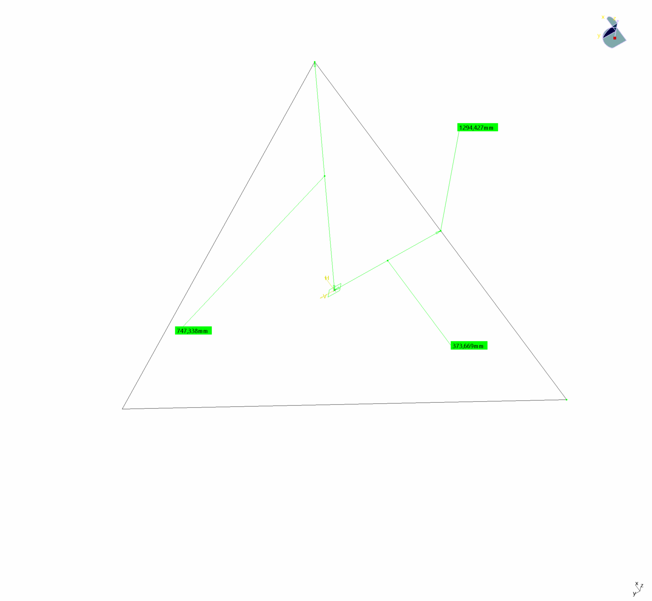

    Hi there,
    just starting a new thread, to have some help and to help further simmers :)
    The wish
    1-Use with Oculus Rift, mainly for DCS sim
    2-Use AC motors
    3-Add a g-seat seat next year if possible !
    Starting the project (2016-10-17)

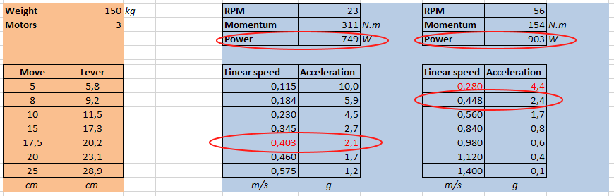

    Motor : 3*1.1KW AC 23rpm 311Nm, used on 120° not 180°
    Lever : 20cm which means +/- 17.5cm for 120°
    Angle : 17°
    Linear speed : 0.3m/s minimum
    Acceleration : 2g minimum
    My first drawing (it's really bad compared to others xsimers but it's just to make good choices for design and kinetics) :

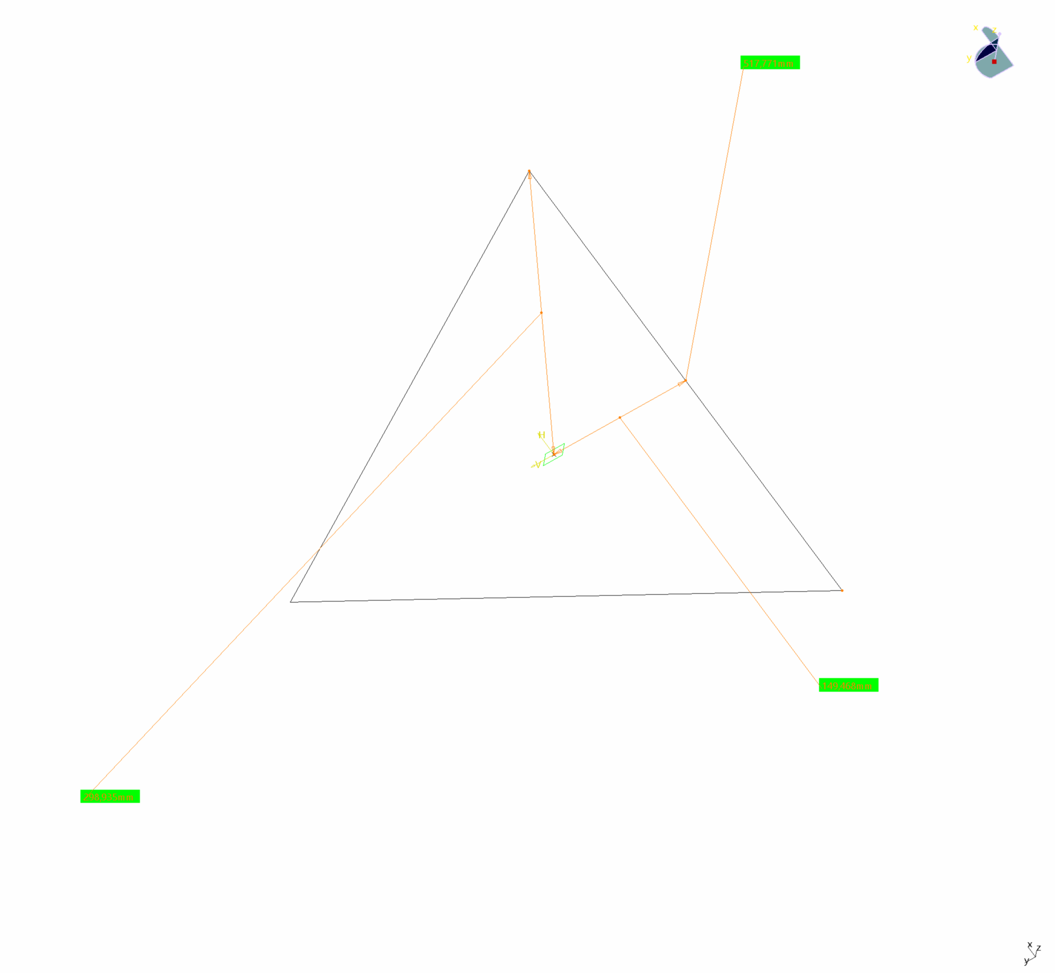

    I have 3 big questions before going on my project :
    1-Am I in the good way/choices ? :)
    2- I'm really hesitating between these 2 motors/levers lenght
    they have near the same linear speed and momentum, but one will have 16cm for heave, the other 35cm
    the first one will have 749W and the second one 903W for both 1.1kW input.
    For 18° angle, pivot points with 8 cm lever
    and 20cm lever
    3-what will be the current during the use of motors ? because it's 6time higher at starting, which makes 86A ???
    Will there be at all time 86A because motors are always changing direction ??
    Thanks a lot !!

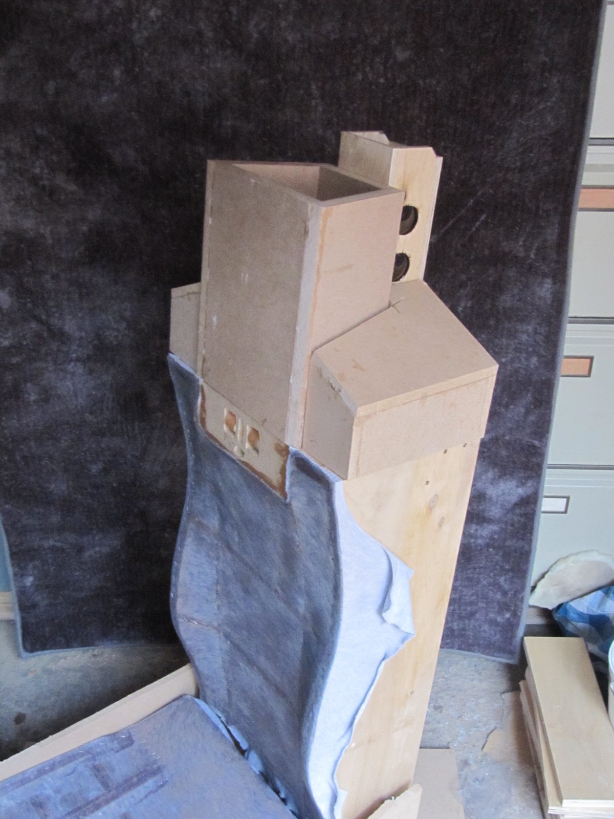

    3DOF, Arduino, JRK
    position on motros like your
    after one year. start change chair for this .
    It still is working on it

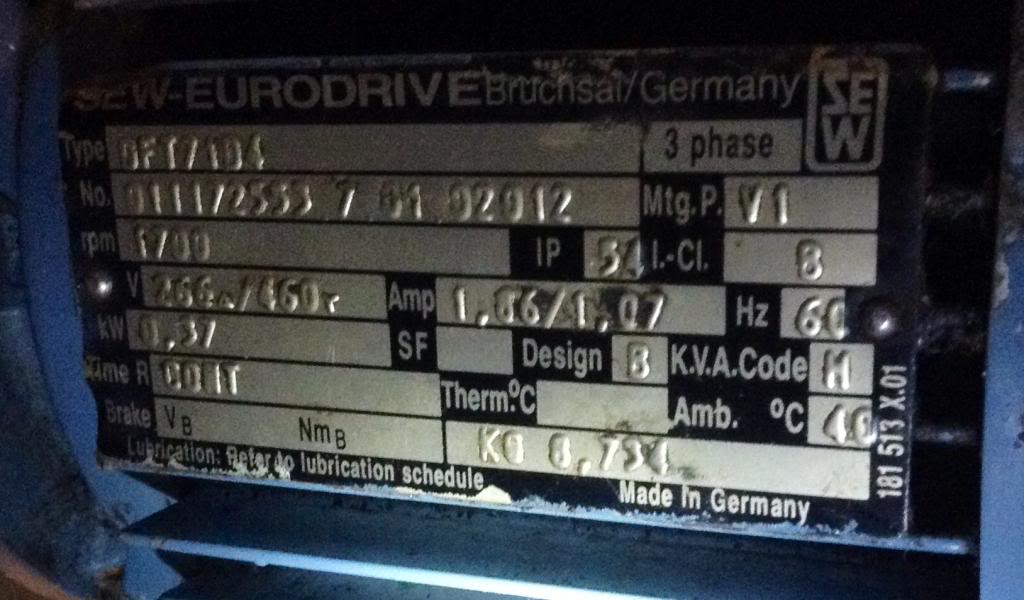

    Motors current will be written on the motor's name plate and for a [ 1.5HP=1.1KW ] AC motor it will never exceed 3-4 Amps
    when using VFD inverters it will be programmed to give you an S curve for holding a constant torque while forward/reverse/low RPM ... and it will automatically maintain the motor current for not overheating or damaging its coils ...

    It is really easy @dureiken to reverse calculate the max rpm required on the gearbox shaft ...
    For ex. If you want at any point of a 3DOF 1m. Equal sides Triangle base a linear speed of 30cm/sec. and a travilling distance of 20cm up and down ...
    1- You'll use a 10cm CTC "center to center" crank arm lever that will rotat a 180 degree to get the 20cm up/down displacement ...
    2- then caculate everything normally and multiply the resulting rpm by 1.5 to get the 30 cm/ sec. linear speed ...
    So ...
    [ 180deg./sec * 2 ] = 1 revolution/ 2sec = 15 revolution / minute
    The min. required RPM will be = 1.5 * 15 = 22.5 RPM
  18. dureiken
    dureiken Active Member
    Sep 28, 2016
    252
    1,254Coins
    +171 / 2 / -0
    Yes thanks but why are you talking about this ? my first table shows all these calculs, for different levers and 120° rotation of gearbox (not 180)

    Yes sure I saw that :) ... but you just didn't explain how you got these values ??? ... and it felt like it has been copied and you're not sure af what you need .
    More detailes are always welcomed .:cheers
  20. dureiken
    Sep 28, 2016
    252
    1,254Coins
    +171 / 2 / -0
    They are not copied from anywhere, just made by myself
    I took an angle of 120° not 180° for full amplitude on a motor, and I used different lever lenght to found linear speed and acceleration.
