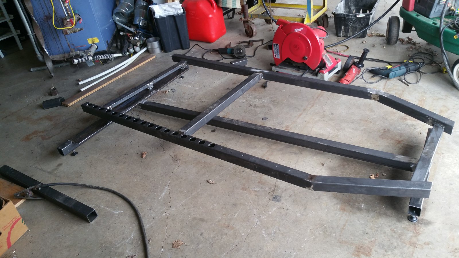

    Hi, Im bulding a 3dof rig using 3 scn5 actuators. I have been busy fabing my frame the last couple of days. I will post pics of my progress as i go. I have used this site to give me ideas and inspiration. Without it I could not do this project.

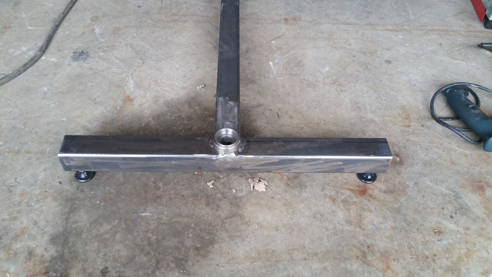

    Today i did a little more work on my rig. I got the bearing cup holder mounted on the front of the frame. Im using a timken cup and bearing for the front pivot point.

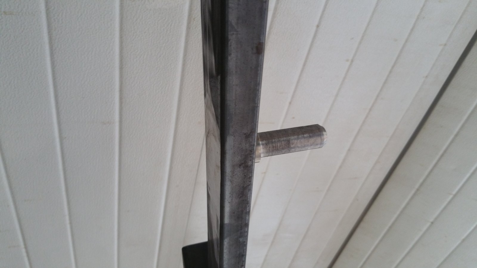

    On the top side of the frame I have welded in a stud to receive the bearing.

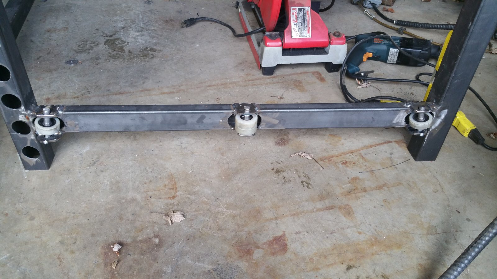

    At the back of the frame I have recessed nylon rollers with bearing inserts to ride back and forth for the traction loss.

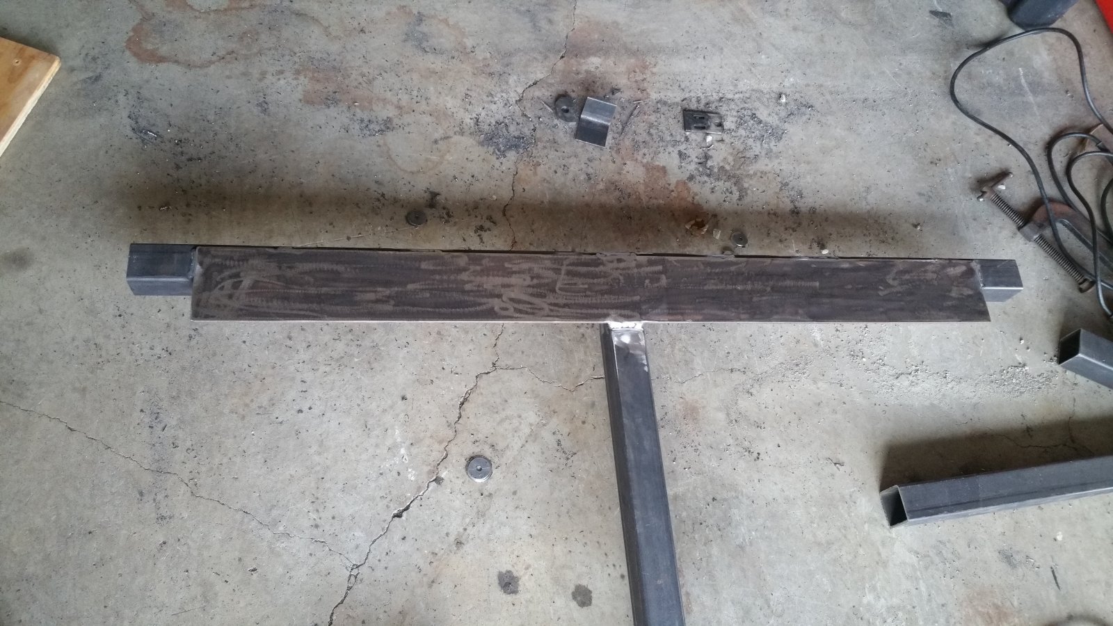

    On the base frame i have welded a plate for the rollers to ride on.

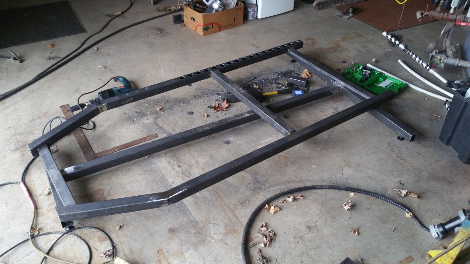

    This is what it looks like with the both parts of the frame assembled.

    I am curious about the load rating of the nylon wheels, they look pretty compact.
