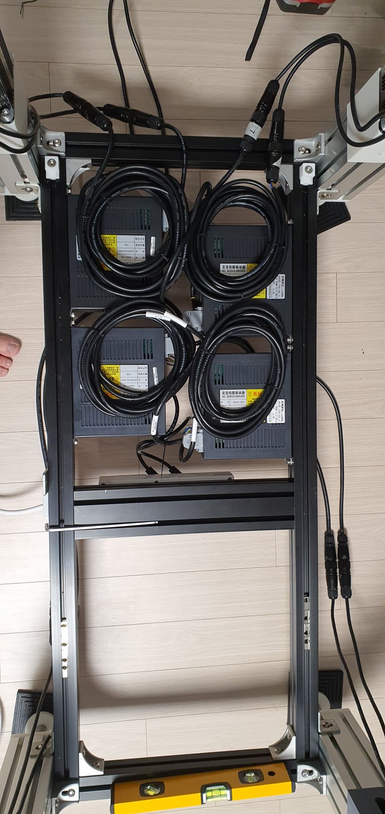

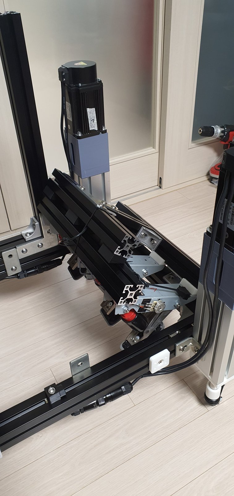

    Hi, everyone.

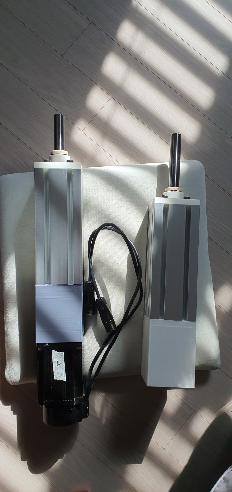

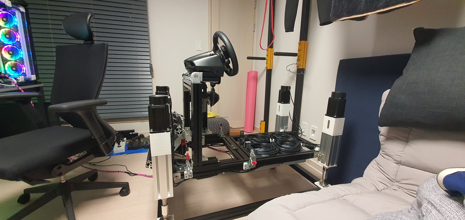

    I'd like to introduce my 4 axis motion simulator.
    Linear actuator is based on SFX-100.

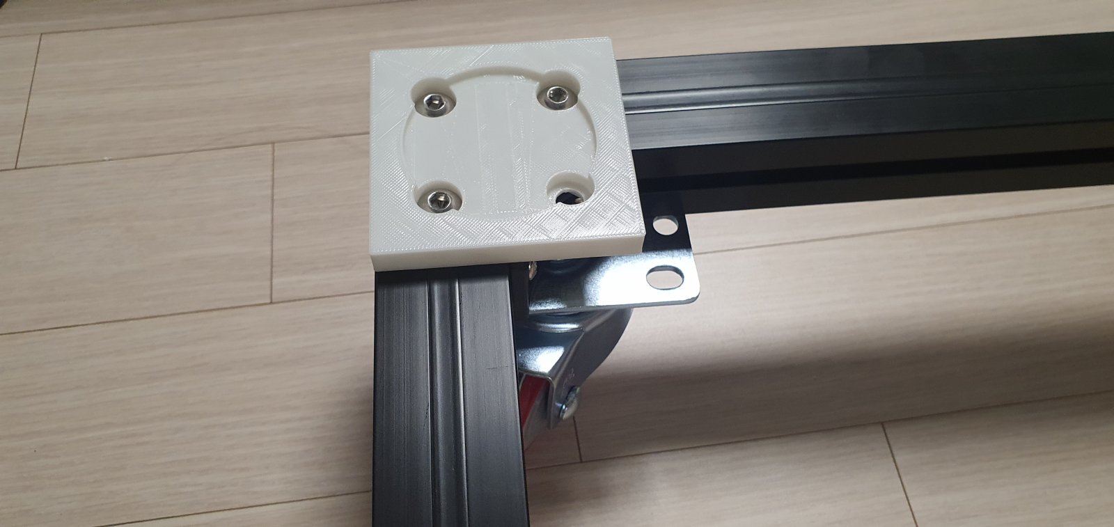

    But, I used 8080 aluminum profile and 80ST-M02430 motor with MODBUS for PC control.

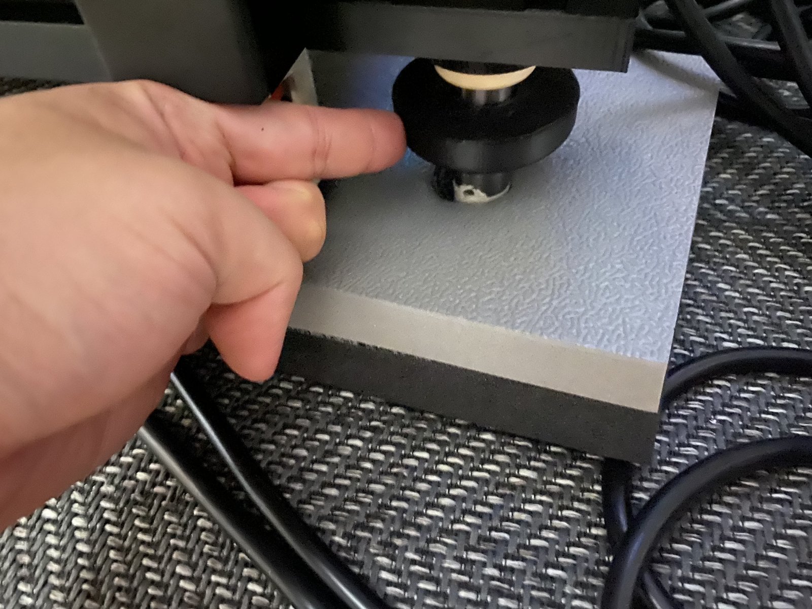

    I modified 3d printing parts for the changed parts.
    Also, I added swivel leveling foot to prevent breaking foot part.

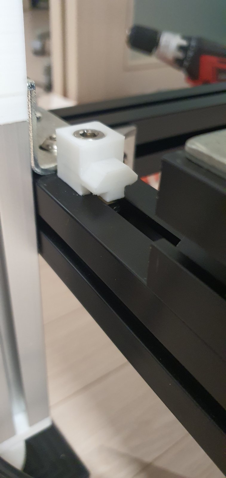

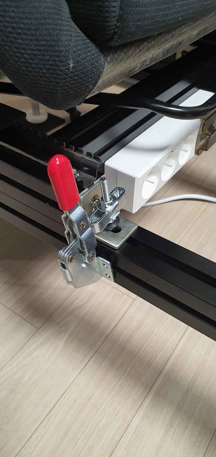

    Motor drivers are fixed on the main frame.
    I designed detachable seat using hooker and clamp to repair and tune motors easily.
    KakaoTalk_20210603_132253043_03.jpg KakaoTalk_20210603_132253043_01.jpg KakaoTalk_20210603_132253043_02.jpg

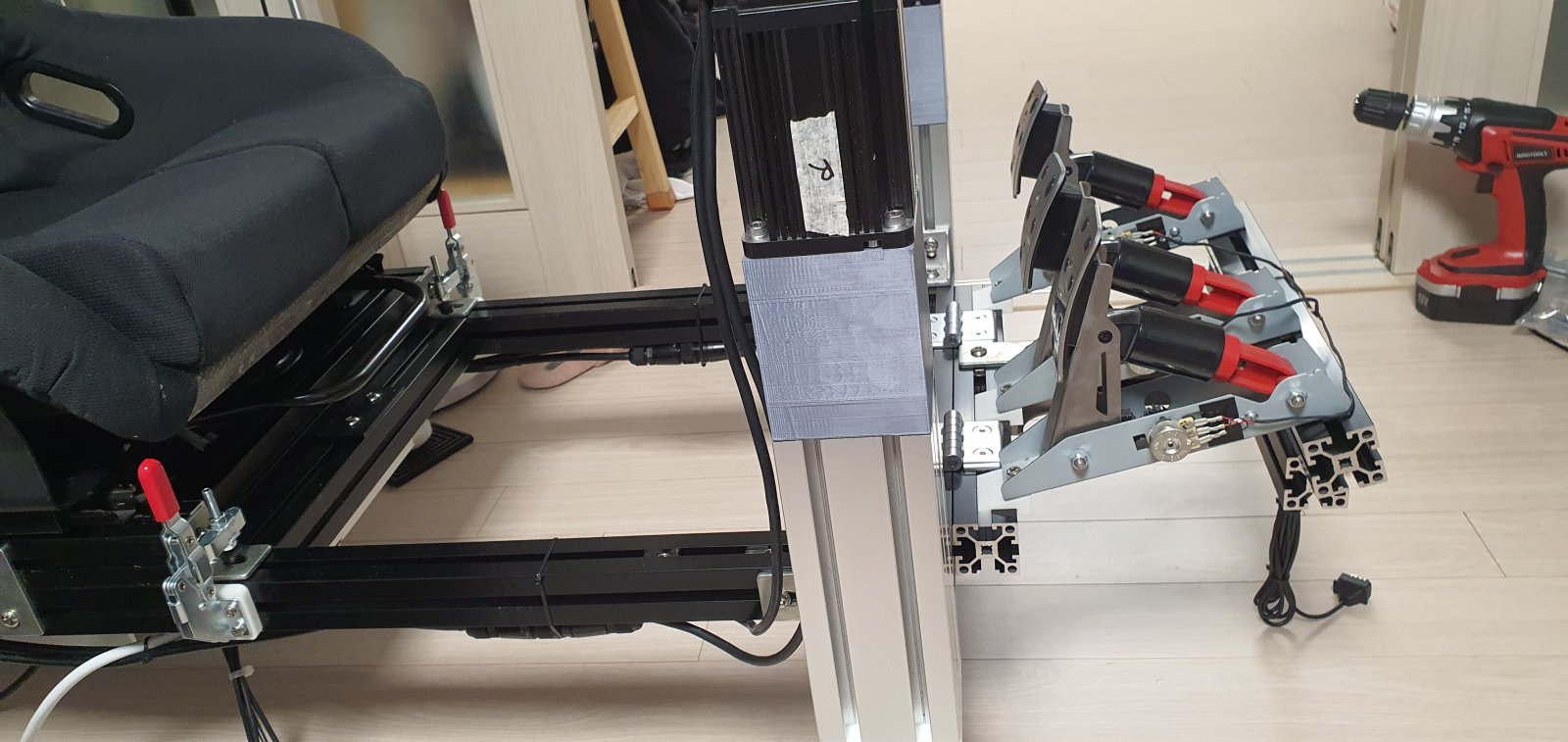

    Because of limited gaming space in my house,
    Pedal module can be folded using hinge, and my system is installed on caster frame.
