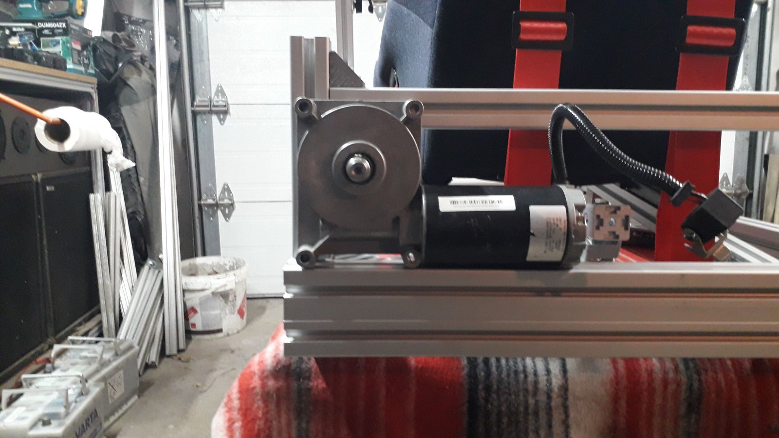

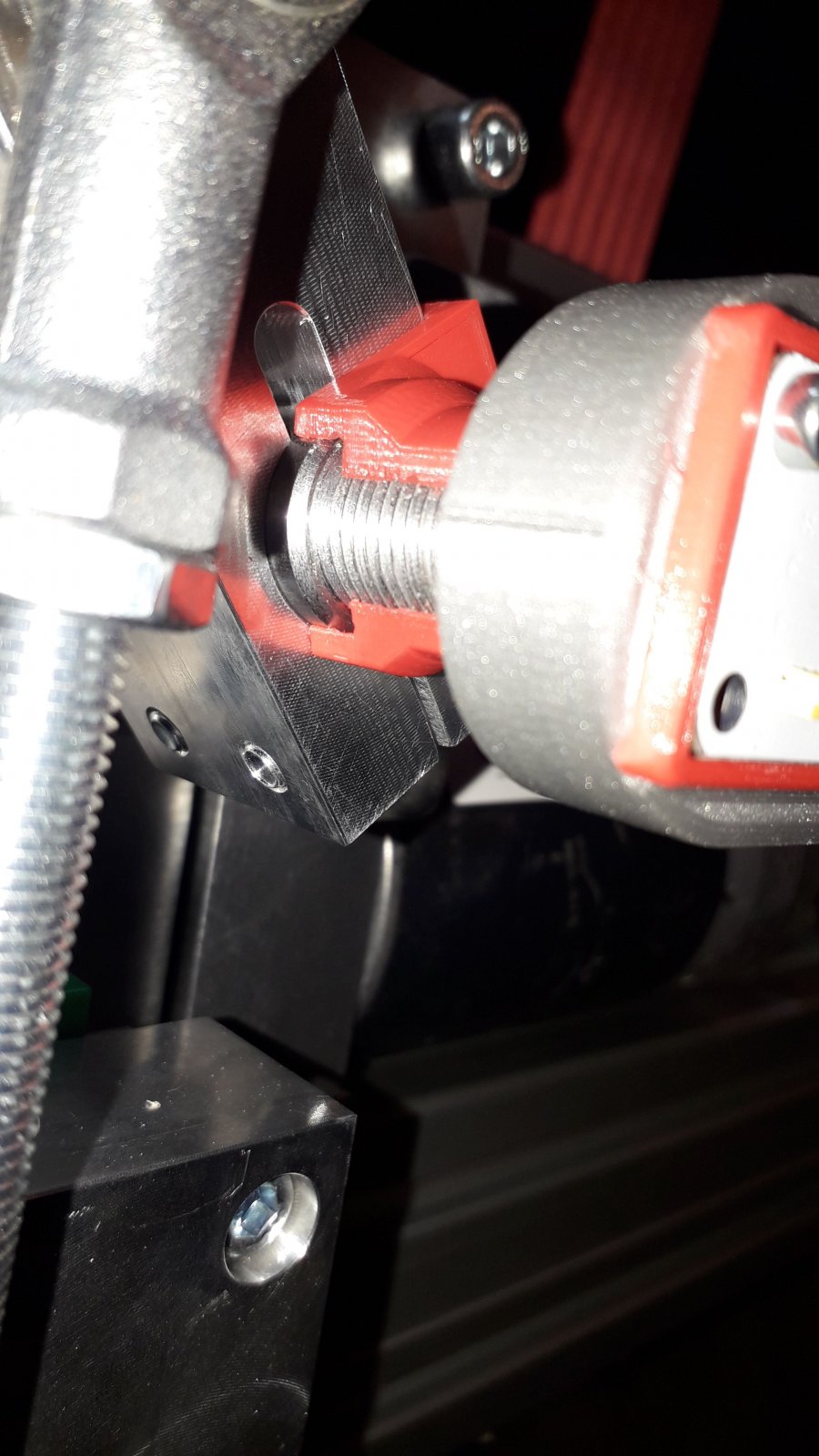

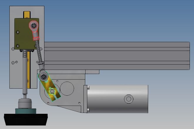

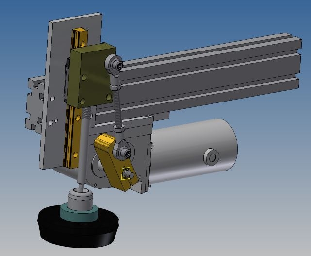

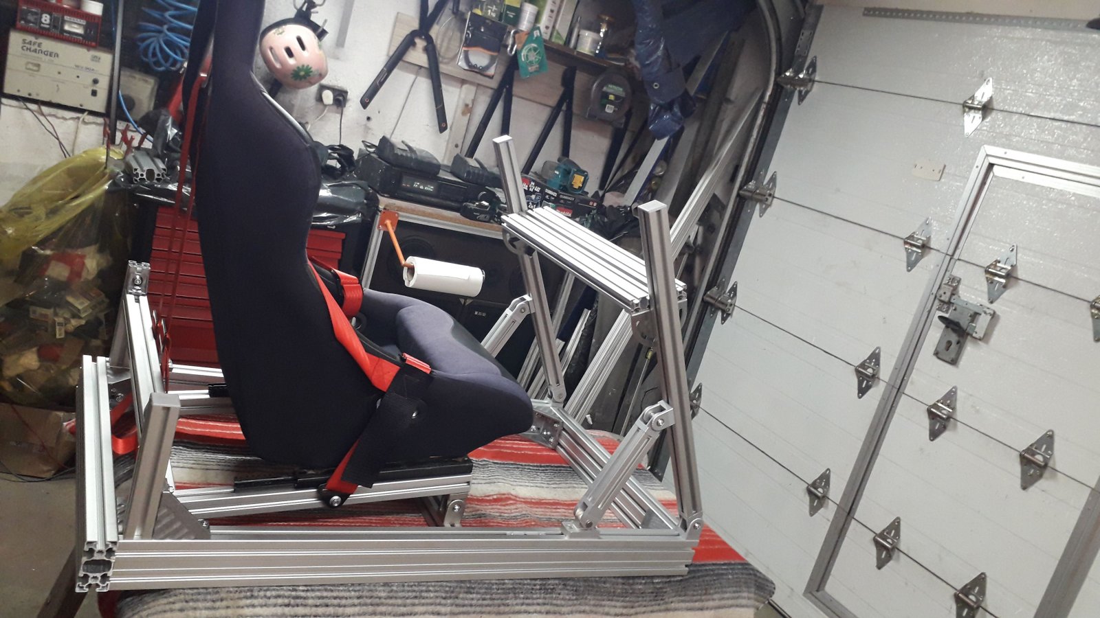

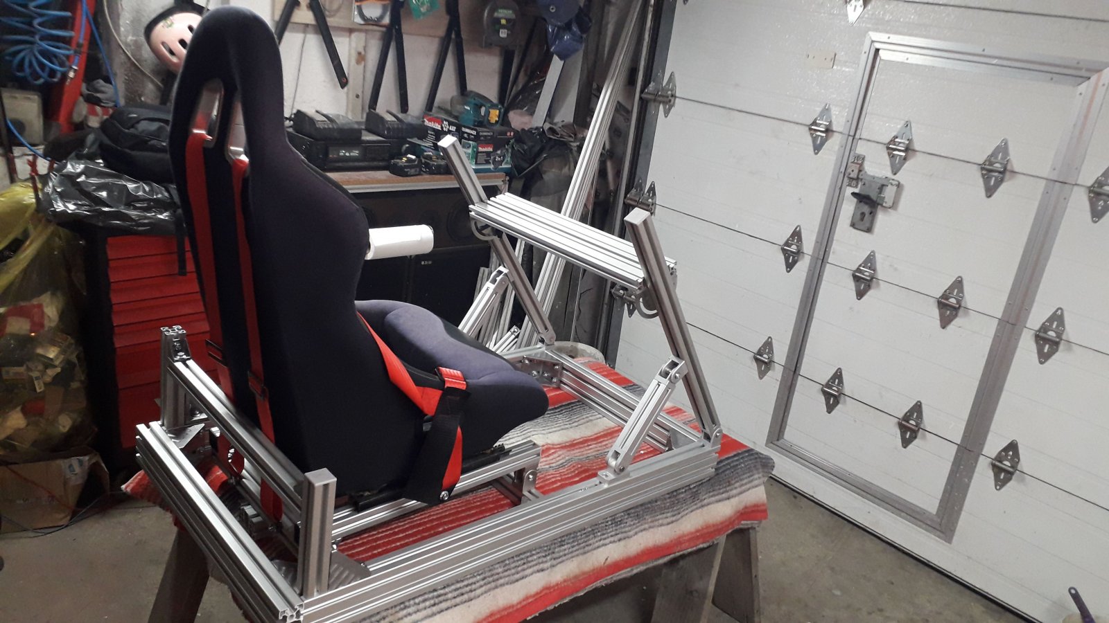

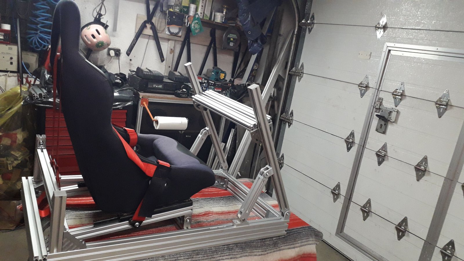

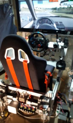

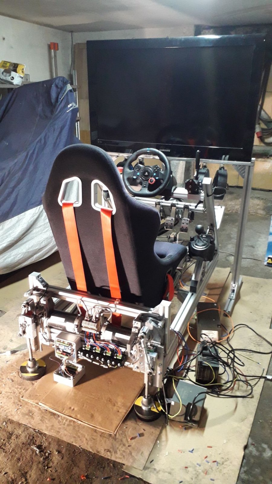

    Hello all
    I started thinking about the simulator after encountering structures based on wiper motors. Due to the fact that I do not want to build the simulator twice, I turned to a heavier structure based on 3 electric motors with the elimination of the lower frame.
    So I thought about lever driven linear actuators, their characteristics will not be linear but I had carriages and rails after cnc plasma construction and the ball screws are out of range.
    Moving on to the point (secondary market):
    - I bought 2 motors about 200W 24V (I'm looking for the third one)
    - INA KWVE20B rails and trolleys
    - aluminum profiles 40x80,40x40
    - bucket seat
    I modeled the drive mechanism (below its 3rd configuration :)
    I have initially assumed the frame size of 1200x600mm
    Motors located on the outer contour, rear ones will be in mirror but I was not waste time for that now.
    Actuators arre not finished, plates need be stronger on the back and will be installed on profiles by using 2 surfaces.
    some weeks later:
    Updates (12 2021) all information bellow
    -1 motors with gearbox
    -2 motor with one gear
    -arduino uno, 3x BTS7960, 3x AS5600 hall + housing printed 3d, dc power 10A and 20A
    -G29 whell,mod pedalls, gear knob
    -aluminum profiles 45x90,40x40 (frame 1200x700)
    Update (03012022)
    need to add 2 parallel ibt-2 for each motor
    add 2nd arduino to drive 3rd motor
    motor tested smc3 and front spring on monitor support
    add hanbrake and separate g29 pedals connection

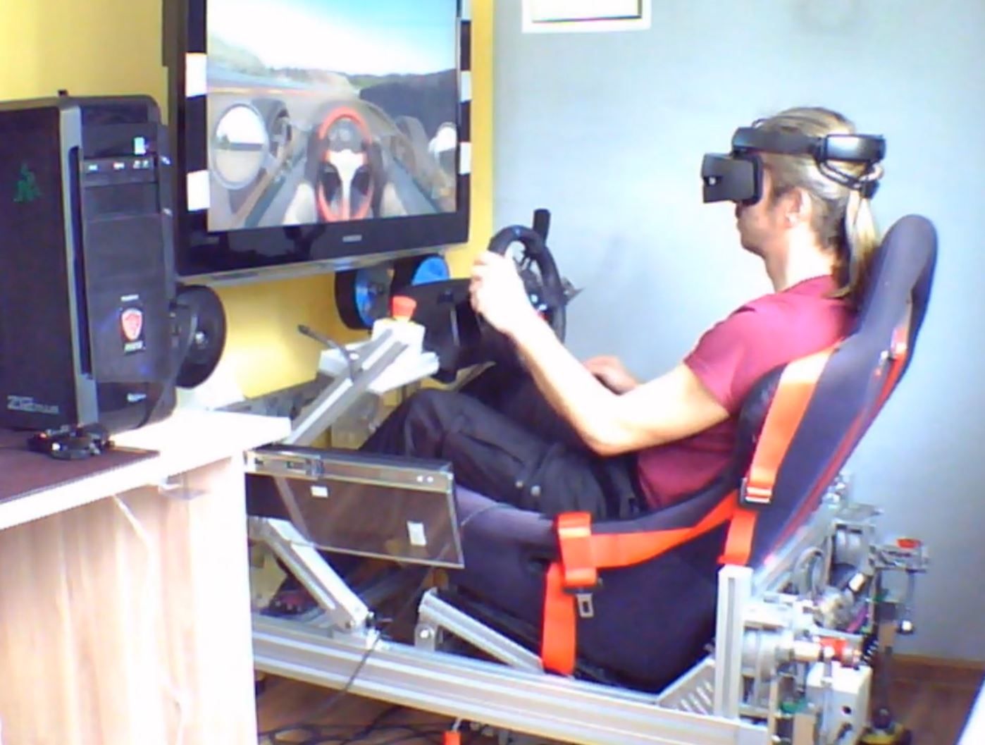

    Update (08012022)
    rig is runing
    front need 2nd ibt-2
    still have some isuess (details during thread)
    movie below
    I just receive DIY KEY from SIMTOOLS
    Some movies:
    https://www.bitchute.com/video/UQ470ENrmbKe/
    Update (22012022)
    https://www.bitchute.com/video/Icsw8mWBu3Nz/
    Update (27012022)
    instal galvanic isolation ADUM3160 for arduinos (motor drivers)
    instal cooling for motors and BTS7960
    instal second keyboard , mouse and watt usage measurement
    need to:
    instal rumble motors for traction lose
    some safety shields for rear mechanics
    change drivers cable for IDC-10 tape
    Update (21022022)
    Change rear levers from 50 to 35mm (motors hot)
    Change arduinos from ch340 to 16u2 (lost motion in game)
    Add arduino schields and change drivers cable for IDC-10 tape
    connect all grounds

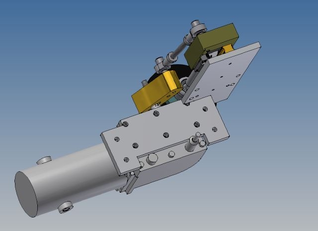

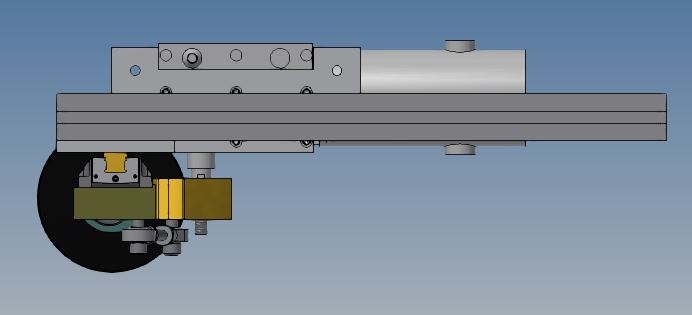

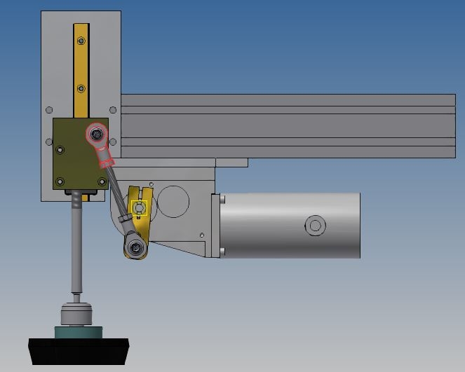

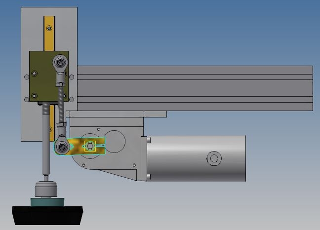

    Design is little bit change. Previous plate was too huge.
    Now, device was build on two plates is more compact.
    Stroke is some 70mm or 100mm.

  3. Gadget999
    2,020
    12,331Coins
    +497 / 11 / -0
    I like your vertical actuators - they look neat
    However there is no advantage over a fixed base and lever arms
    Have you built the actuators yet ?
  4. Gadget999
    2,020
    12,331Coins
    +497 / 11 / -0
    Google - scotch yoke mechanism

    Due to the fact that the aftermarket is not the supermarket ,plan is changes and requires redesign.
    I did not have access to the seat models, so I failed to measure the dimensions to prevent collisions (photo 10b, 23b)
    I changed the profiles, based on the assumption of 40x80, to 45x90. frame extended by 100mm (1200x700).
    This change requires a redesign of the engine mounting plates. (photo 11b-16b)
    The next engines that I was able to buy have a different design than the previous ones ... should be more reactive, they will be mounted at the rear (photo 11b, 12b)
    As potentiometers for motors, I wanted to use a ten-turn potentiometer and connect the motor shaft with a printed gear in the proportion of 1/16, which was to use 8 turns of the potentiometer for half the shaft.
    I have printed the samples, but there is no possibility for the gear to fast run potentiometer (hevy to fast rotate) - too low teeth (increasing the height of the teeth does not make sense because it allowed the entire structure to go away from room :) (21b)
    A colleague gave me the idea of replacing the potentiometer with the AS5600 hall sensor as a module:
    https://kamami.pl/enkodery/580650-modul-enkodera-magnetycznej-z-ukladem-as5600.html
    And another thing that needed improvement was the floating feet.
    When changing the geometry during the movement with the maximum tilt - the foot moves more than 8mm. (photo 19b, 20b)
    The feet are supposed to have 10mm of play (photos 17b, 18b).

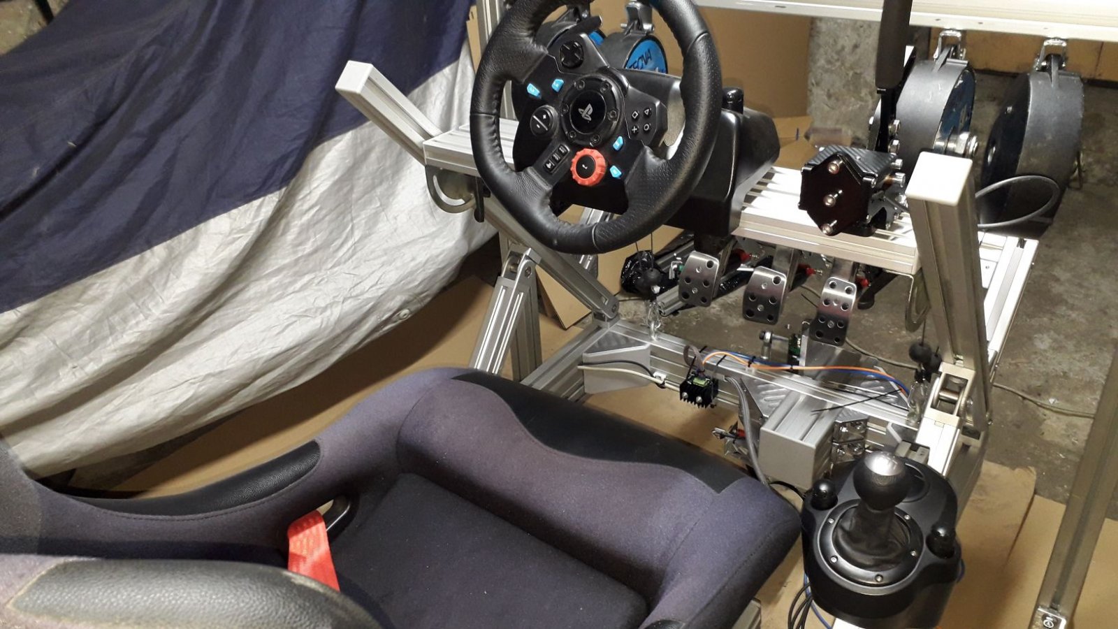

    The pedals will be mounted upside down so I changed the throttle and clutch mechanisms
      File size:
      223.3 KB
      Views:
      346
      File size:
      199.6 KB
      Views:
      359
      File size:
      182.8 KB
      Views:
      350
      File size:
      199.5 KB
      Views:
      358
      File size:
      257.7 KB
      Views:
      351
  10. seuszok
    seuszok Member Gold Contributor
    Nov 8, 2021
    89
    Poland
    465Coins
    +55 / 0 / -0

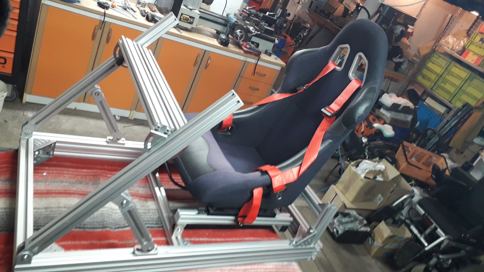

    After mounting the steering wheel, pedals and gear knob - I checked my hidden plan.
    The system can be configured to be close to f1 or a normal car. Joints and locks serve this purpose. It is enough to mark the places on the profiles and secure the positions. I have to say that it looks promising. Both positions are ergonomic, but we'll see in motion.

    This week is drawing and printing.
    Installation of the hall sensor AS5600 using printed elements as below. White is prototypes and improved fits.
    Ender printer: 0.2 nozzle / 0.1 layer / temp 200 / speed 150 / wall 1.5 / filling 20 / PLA material

    I assumed that the worm gear motor will not start without applying tension, but after mounting the arm, it can be turned using force.
    This causes joint collisions with the printed magnet element.
    New and improved elements have been printed, but it is not possible to adjust the angle of the magnet. You have to take out the magnet and insert it at the correct angle.
