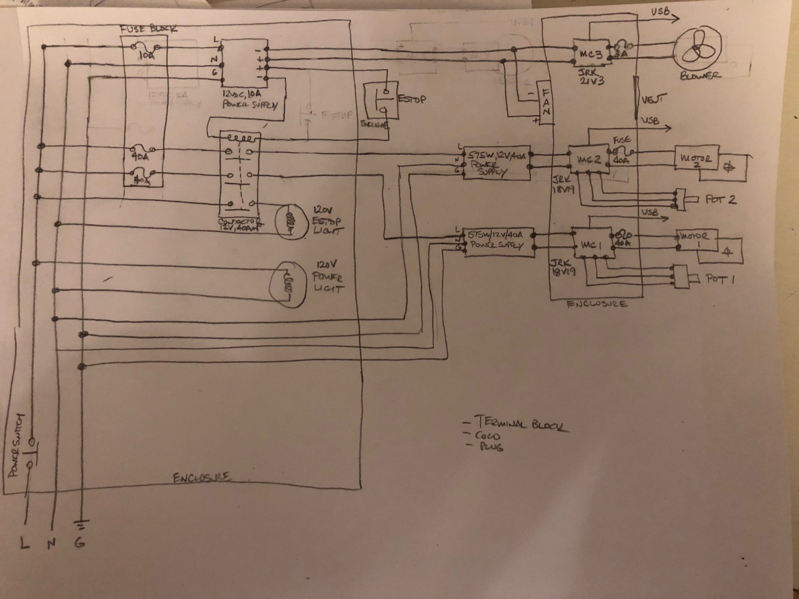

    First time posting in the forum. I'm building a 2DOF sim with a bilge blower for simulated wind. Here are the main parts that I'm using:
    • JRK 18V19 for Motor Control
    • JRK 21V3 for Blower Control (Blower is 12V, 3A Continuous)
    • PGSaw 50:1 12V Motors
    • 10K Wirewound Pots
    • HP 398713-001, 575W Power Supplies
    Questions for the community:
    • How is the USB connection from the JRK to PC (micro USB from the JRK to PC with a cable)?
    • If so, does each motor controller need a dedicated USB cable?
    • I've attached a copy of my wiring diagram. Does anything look off? I'm including an e-stop circuit. Wiring Diagram.jpg
    Thanks in advance!
