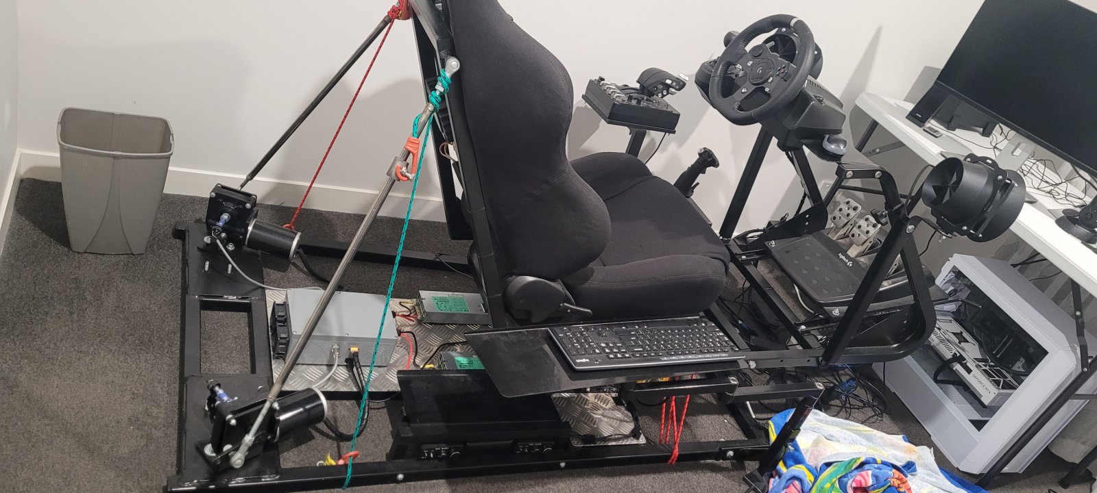

    I have been happy for a year now on my 2dof 12 volt dc motor project but the lack of resolution,backlash and generally jerky stepping during flight simming is becoming unpleasant,so time to upgrade.
    Thought about a thanos and x2 linear push pull actuators like maybe the sfx 150 might be just right.
    My question is this would I just mount these like my old control rods were mounted on my old system I.e shoulder mount or remount at the front directly to the frame?
    And help and advise would be much appreciated cheers.

    You can probably do either but it would likely help if you post a picture of your rig so others understand the current configuration.

    Given the existing design I would suggest sticking with the current shoulder mount is the easiest way to go.
