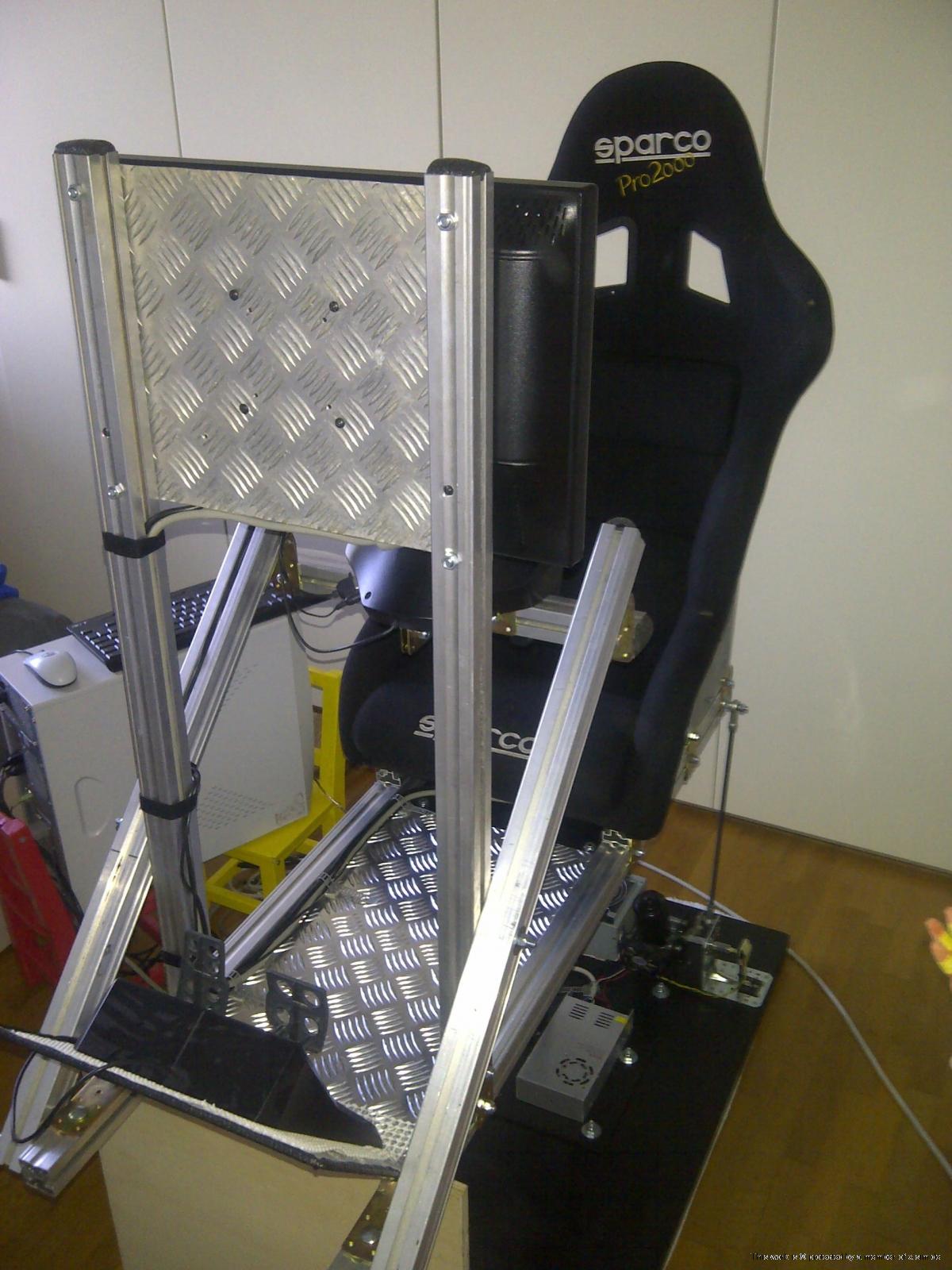

    actual assembly:
    ...racing playseat or virtual reality ?
    presentation video
    I start view this web site casually.
    After see other project like :
    http://www.gamoover.net/Forums/index.php?topic=25907.0
    http://www.x-sim.de/forum/viewtopic.php?f=37&t=842&p=7106&hilit=siki+luna#p7106
    I decide to start my project.

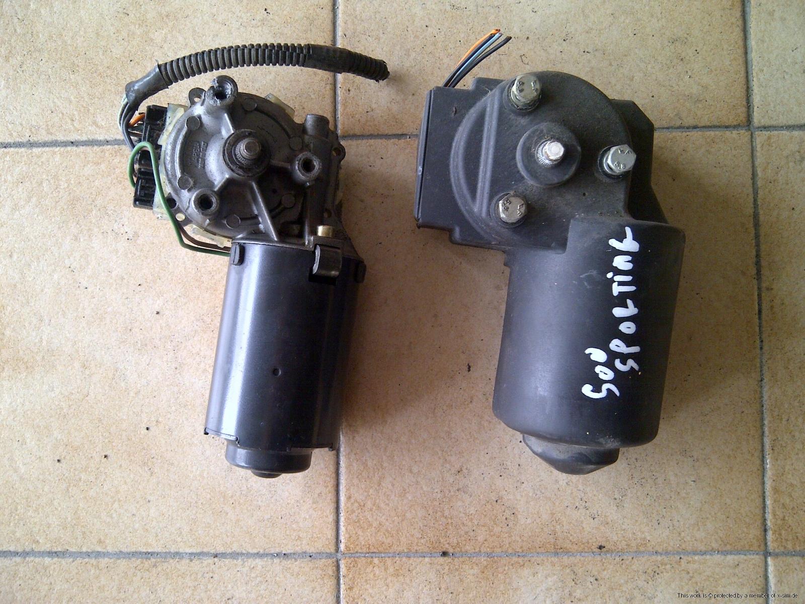

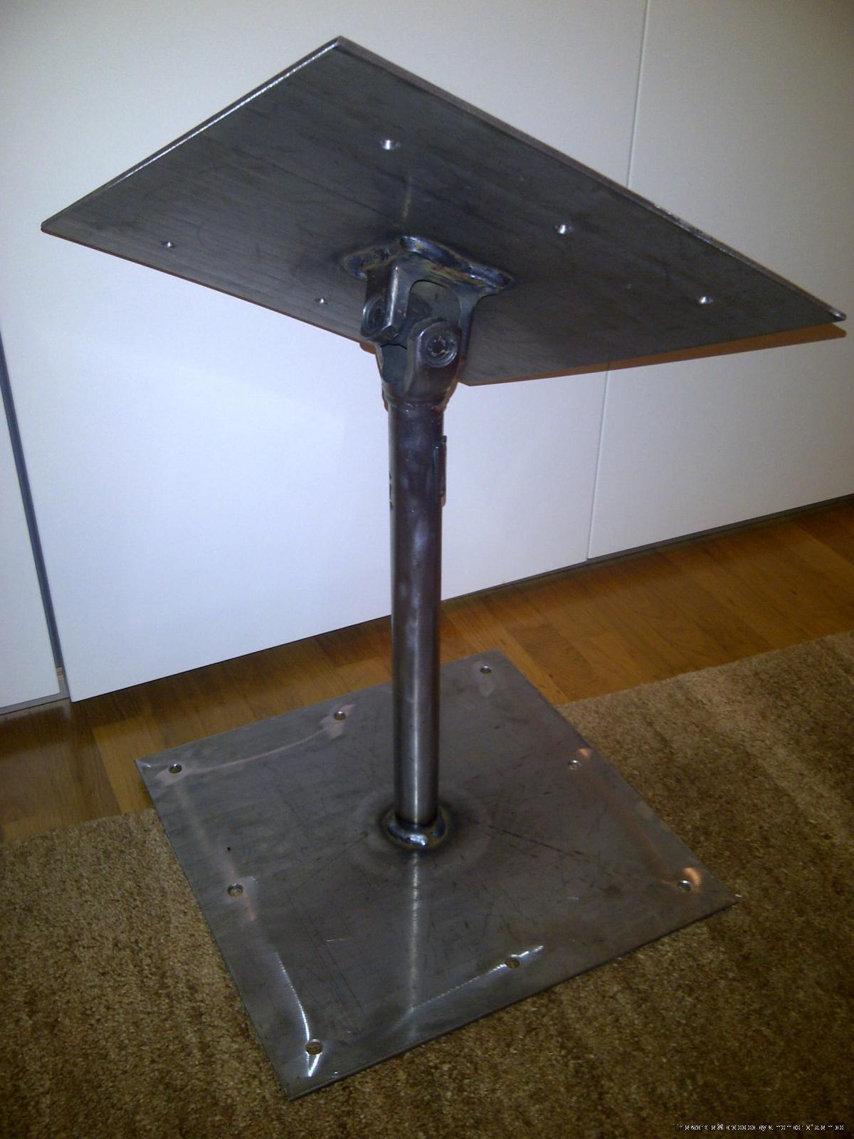

    from car demolition
    (first version : wiper motor fiat 500)
    from a race car driver
    from a photovoltaic installer (aluminum profiles 40x40 mm)
    profili alluminio
    and after some time
    primoassemblaggio
    and more

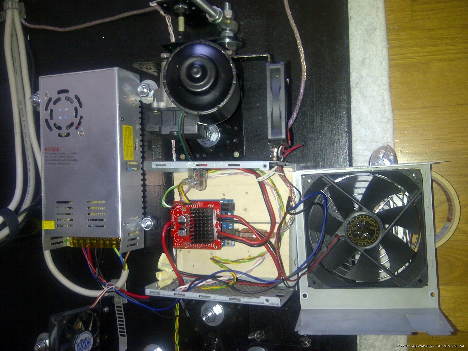

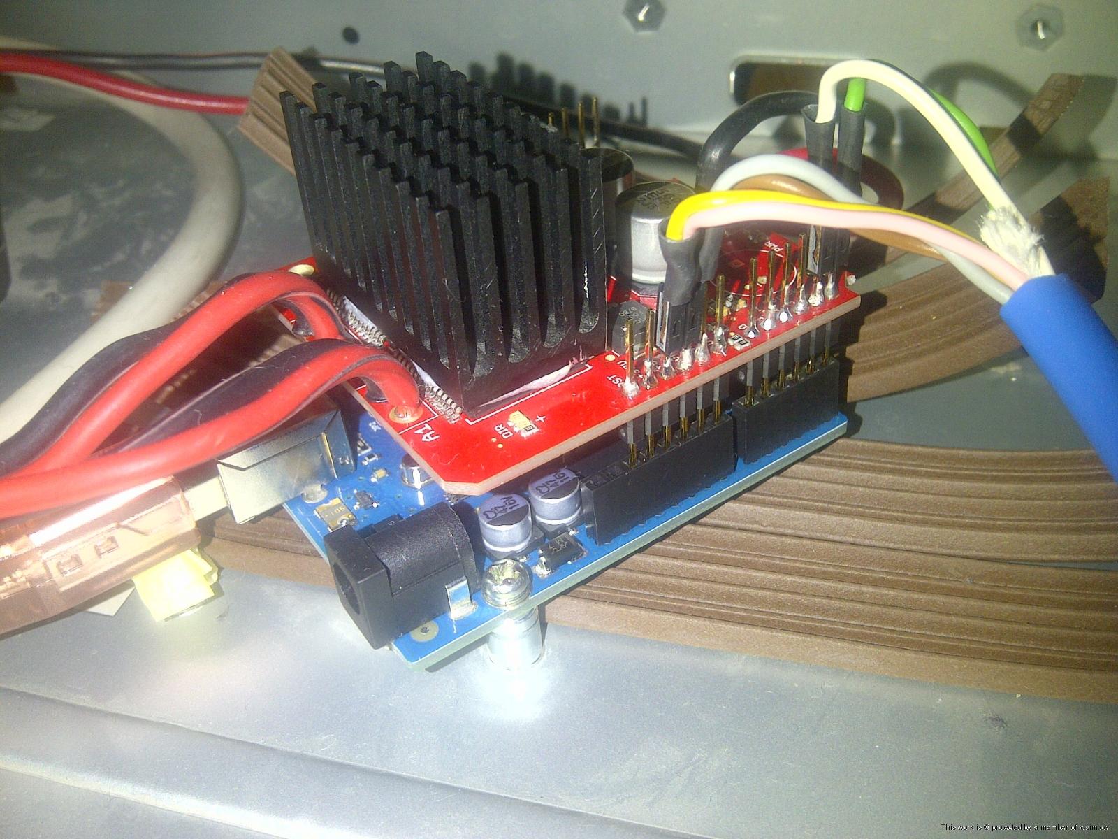

    now must assembly and test controller parts.
    with
    power supply 12V 30A
    Arduino UNO R3
    Monster Moto Shield

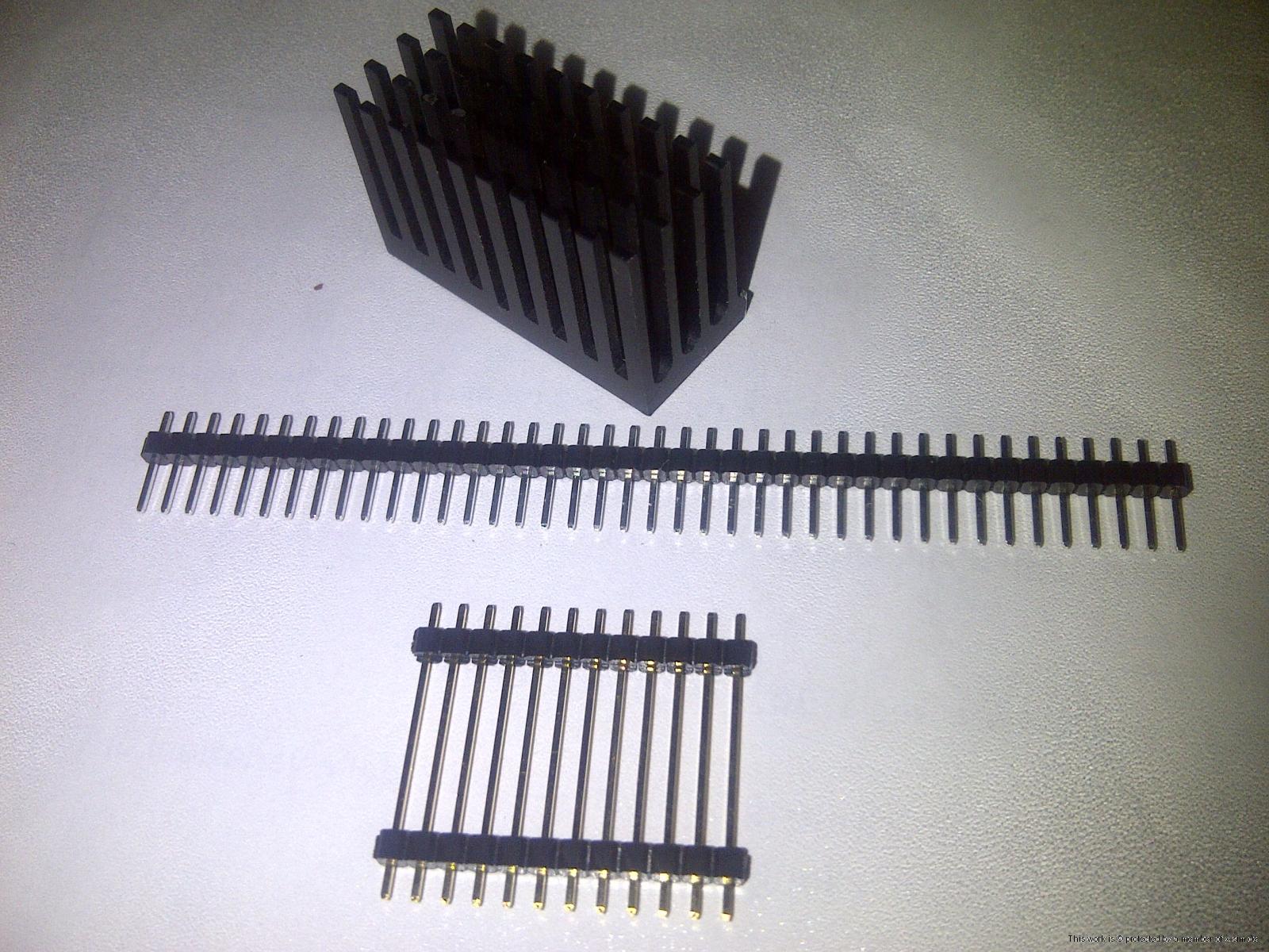

    some pins and a cooling fins
    Assembled as you can see
    if you chose not to stack the two cards:
    Arduino .../... Monster
    ... GND .../... GND pin
    ..... 5V .../... 5V
    .. pin 4 .../... pin 4
    .. pin 5 .../... pin 5
    .. pin 6 .../... pin 6
    .. pin 7 .../... pin 7
    .. pin 8 .../... pin 8
    .. pin 9 .../... pin 9
    left pot
    right pot

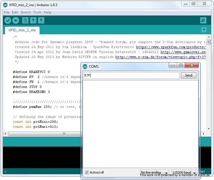

    install arduino software and driver
    load firmware from RacingMat found here
    https://www.xsimulator.net/community/marketplace/arduino-code-2dof-and-2-pins-direction-hbridge.67/

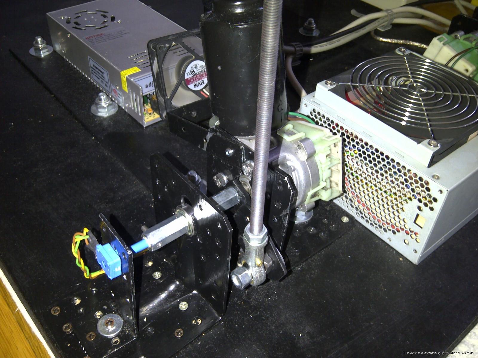

    mount motor for test
    (before check isolation = http://vos-playseat-stephaned61.xooit.f ... e.htm#p642)

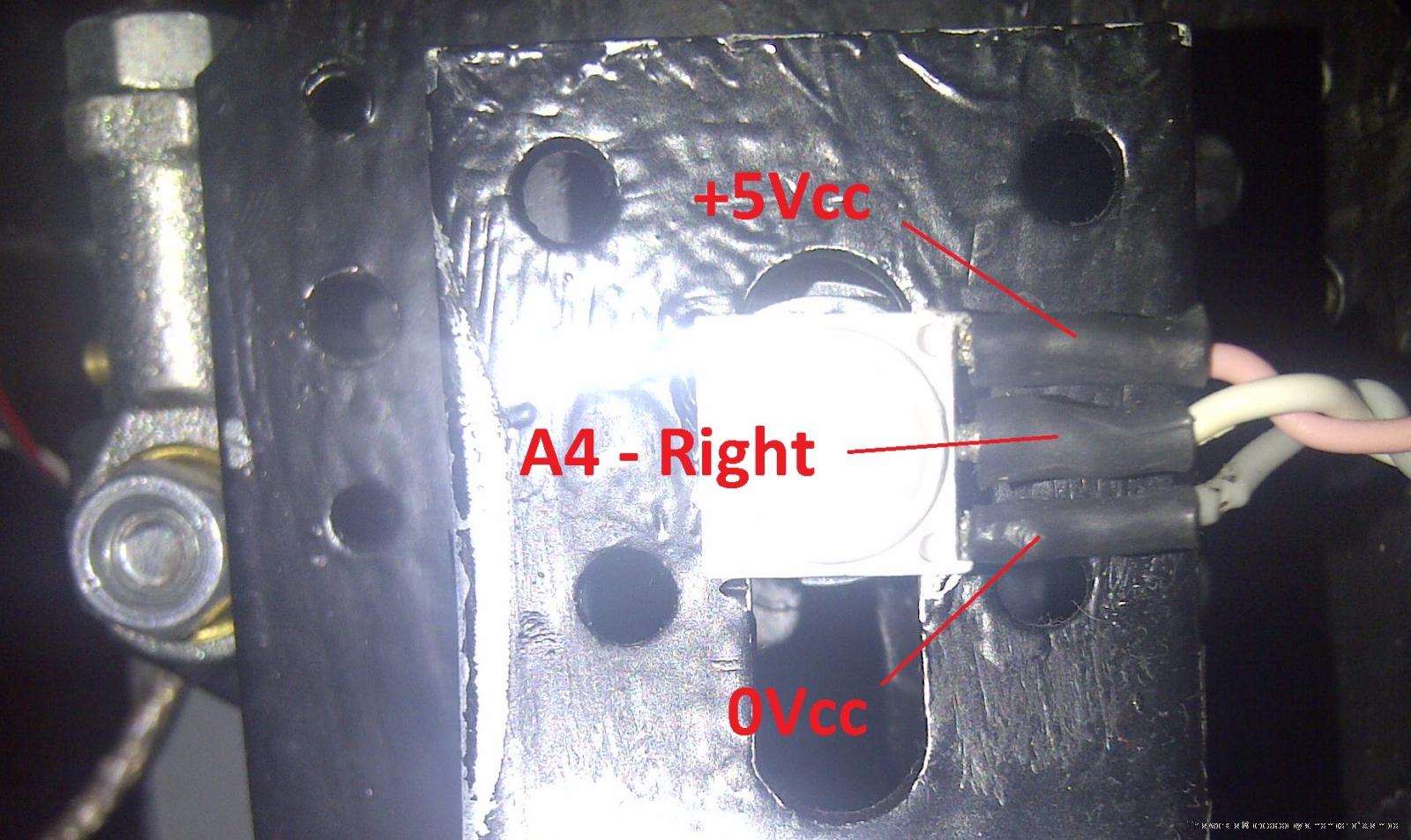

    - Left Motor power attached in A1-B1
    - Right Motor power attached in A2-B2
    - Left pot 10k control connect in A5
    - Right pot 10k control connect in A4

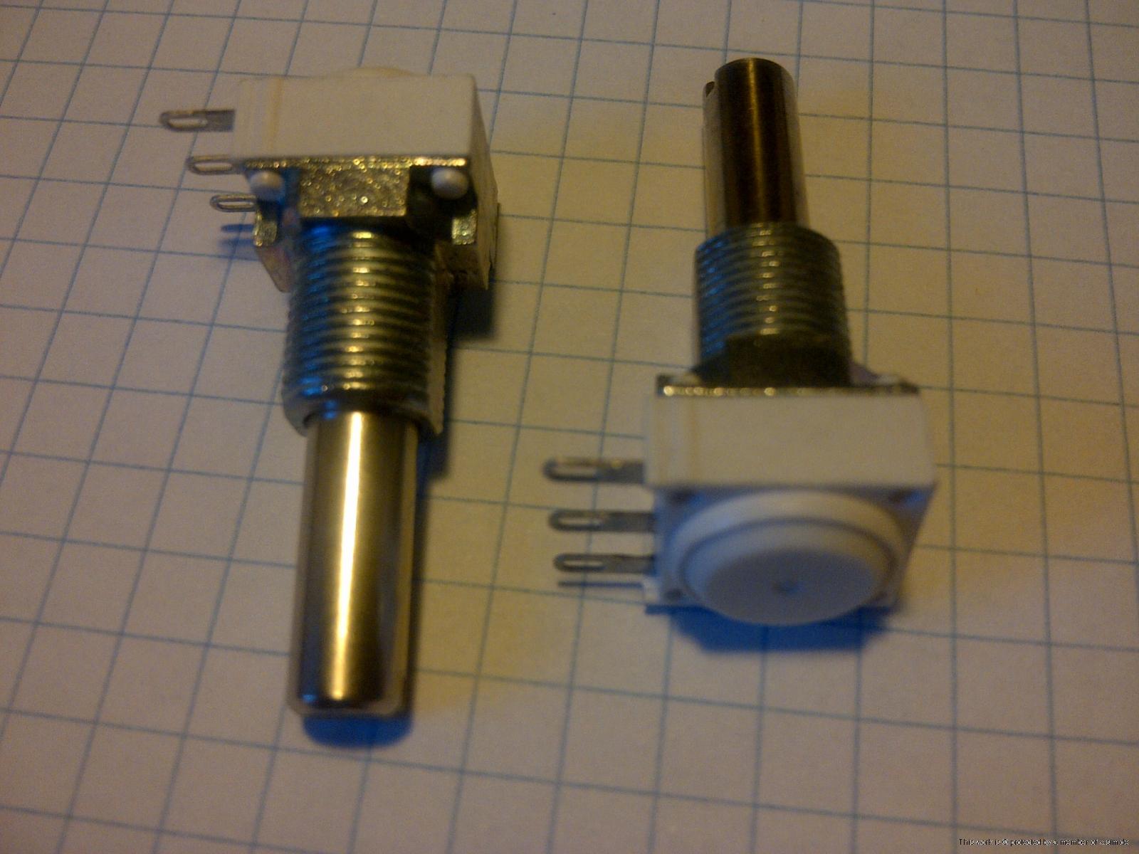

    like reported from racingmat, prefer CERMET (ceramic + metal) track rather than cheap carbon track.
    when you power on power supply and connect Arduino to usb (i use only usb 5v), motors move in middle position. if they move continuously, you must invert A4 with A5 wire.
    if mount motors in opposite position remember to attach the wires in opposite ways for one motor and relative potentiometer (the centre remain in centre).
    you can test motor movement with arduino serial monitor writing L00<cr>, LFF<cr>, R00<cr>, RFF<cr> and you can see move to lower and highest position.
    the result can see here :

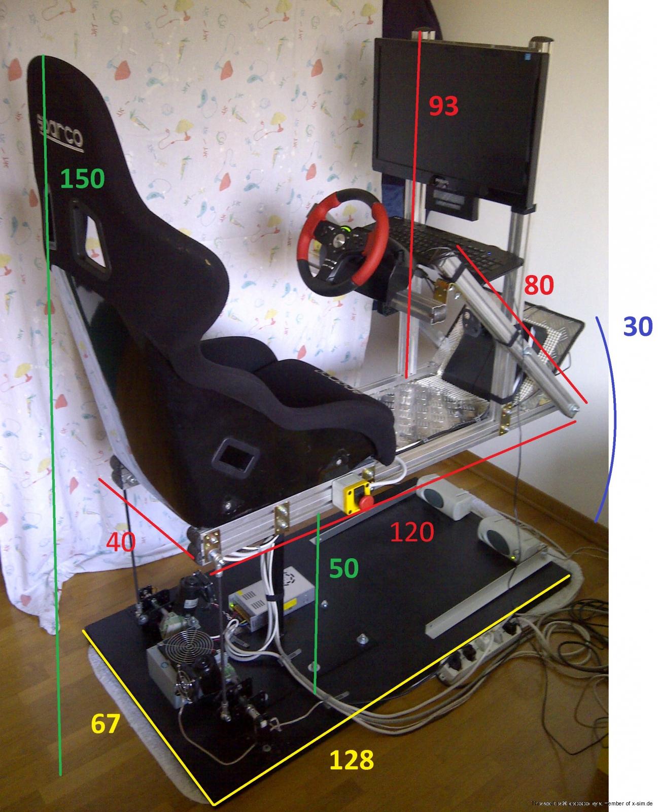

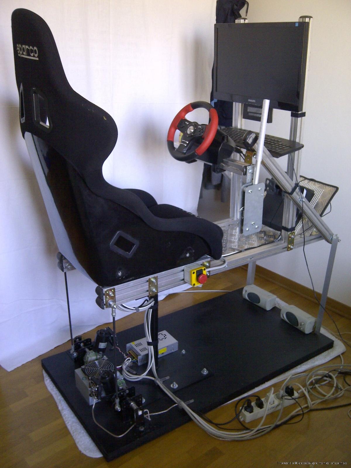

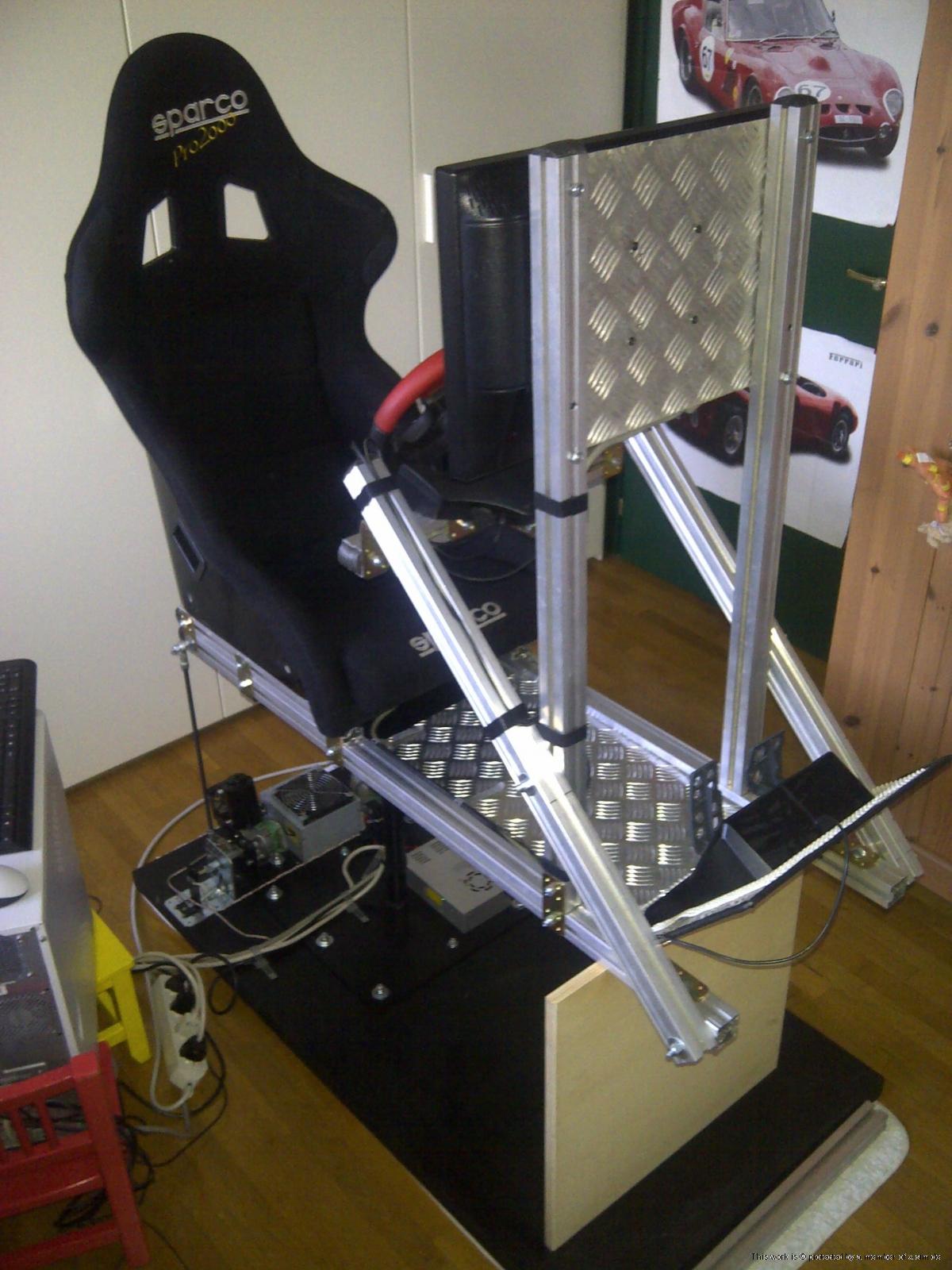

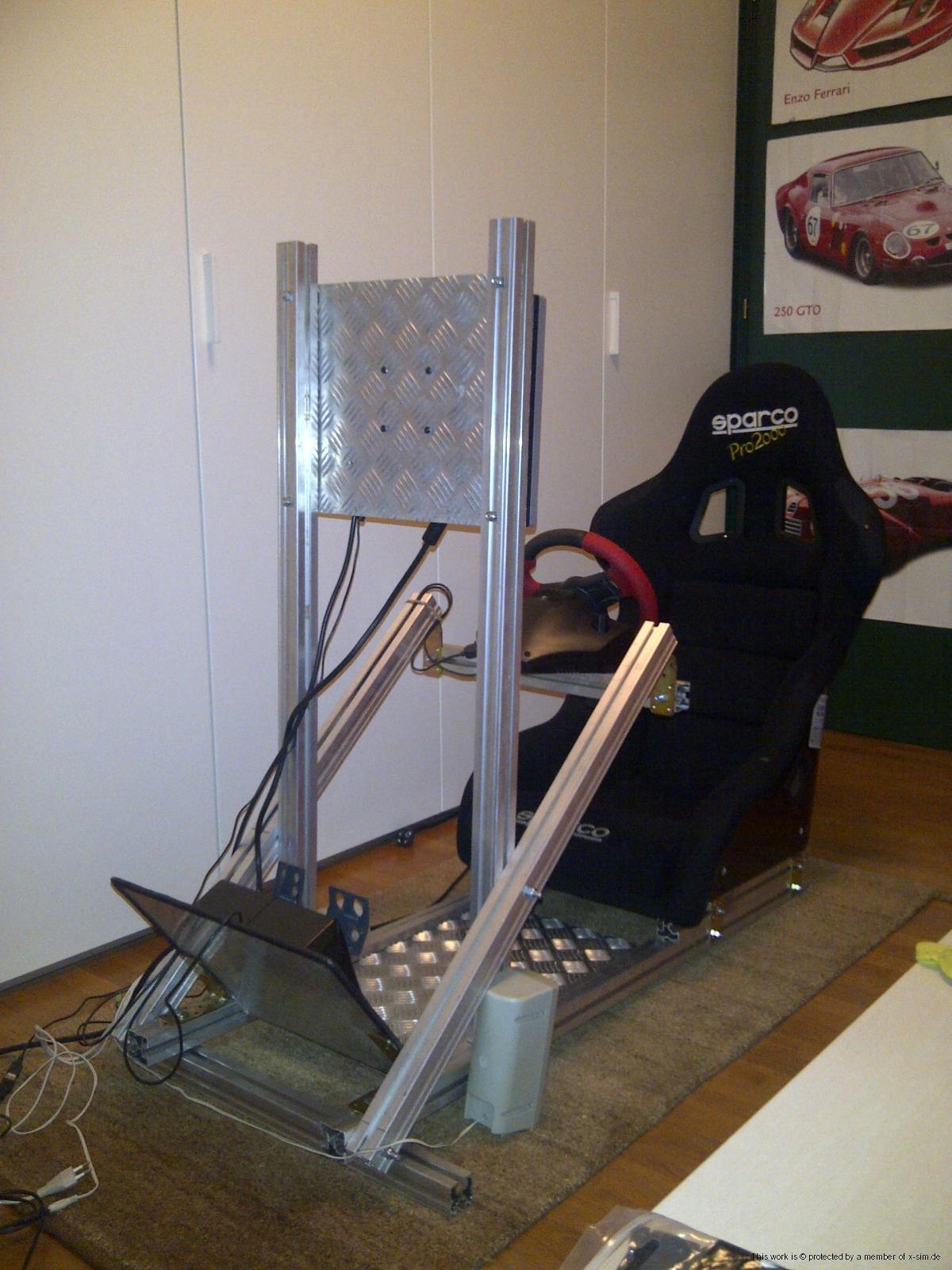

    when i received last part:
    i can assembly my racing playset:

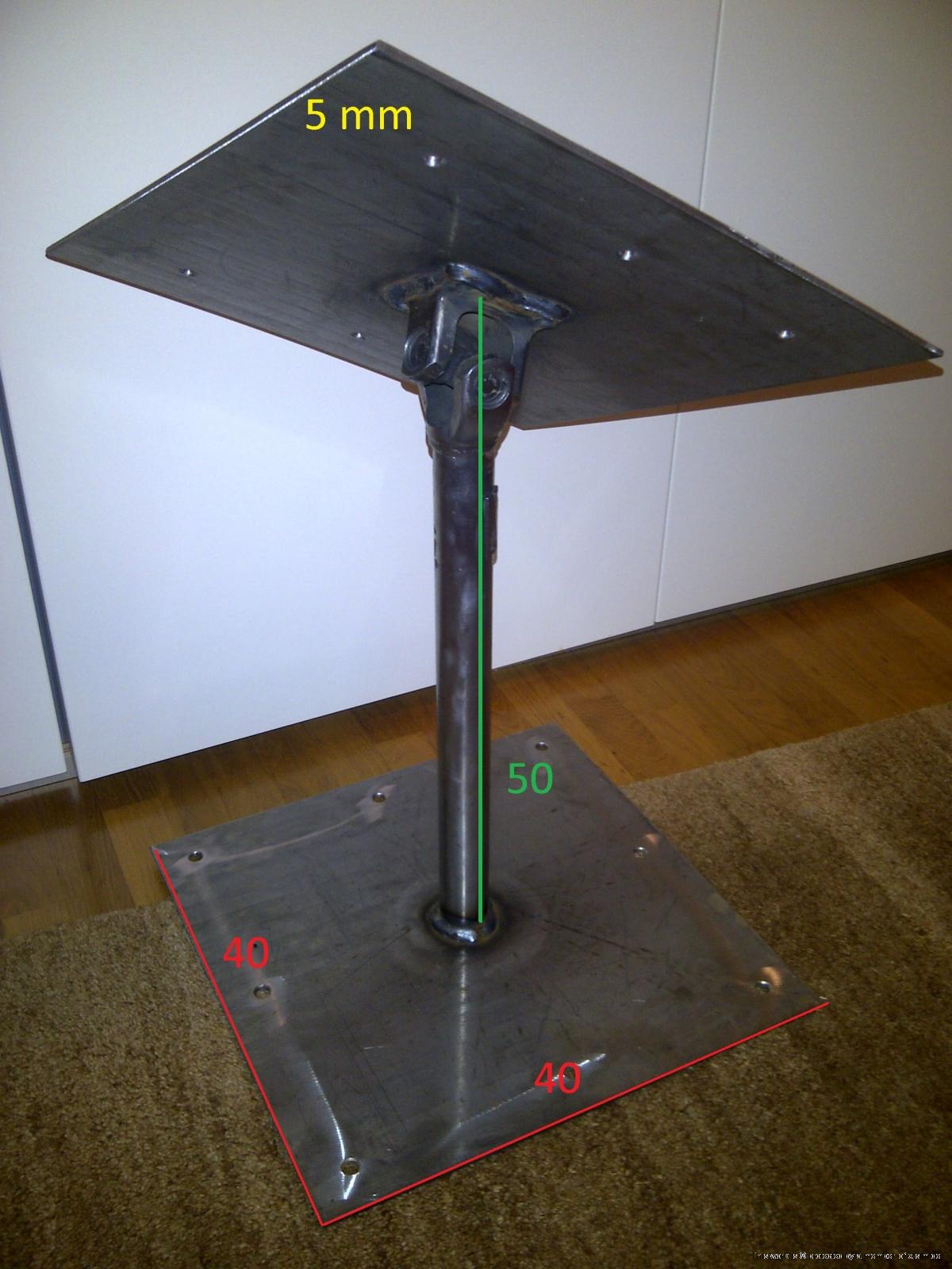

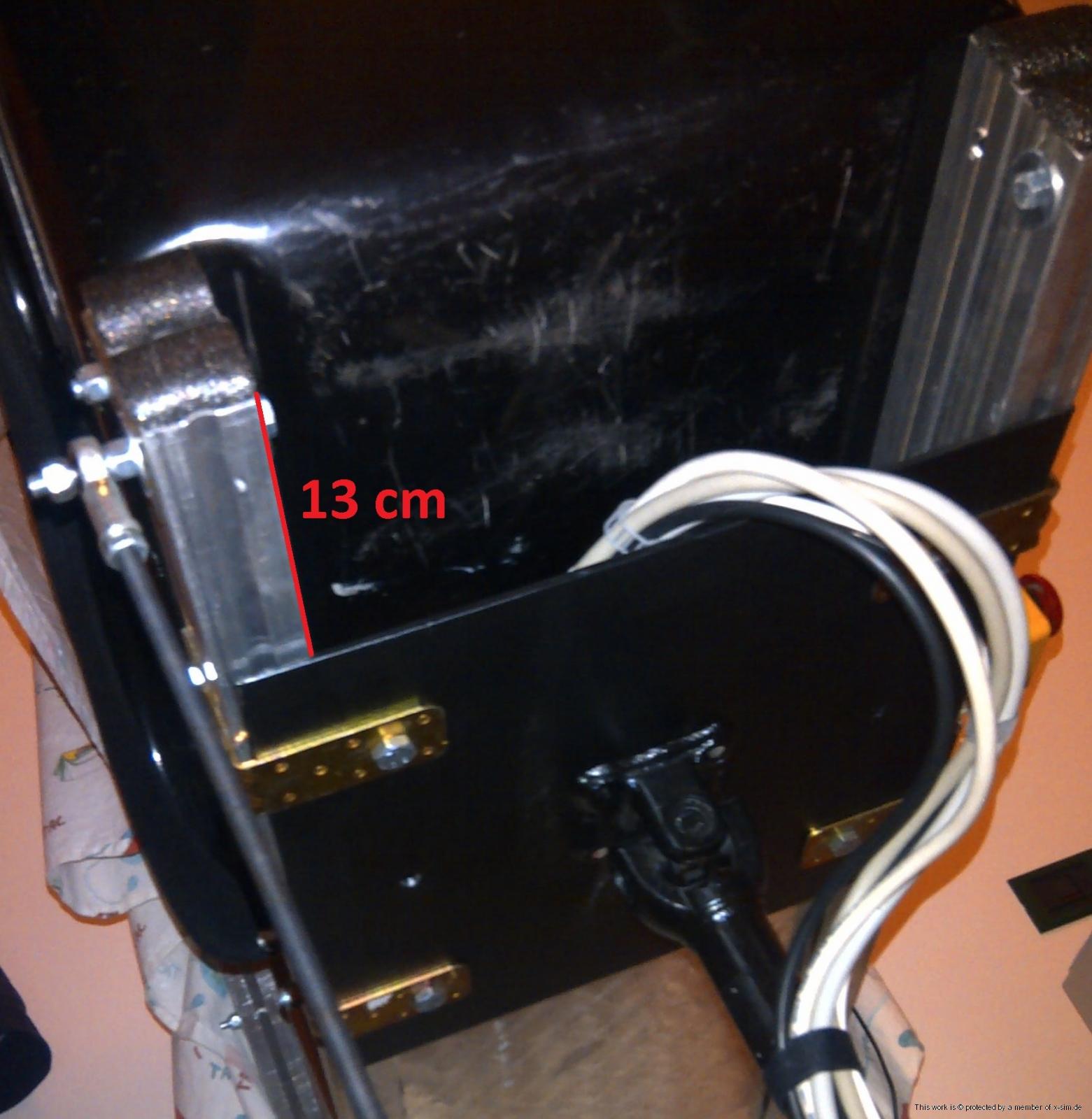

    adding some pics with quotations; total weight 73kg
    [​IMG][​IMG][​IMG]
    and after some electrical and mechanical adjustments
    we decide to make first video:
    we want to extend special thanks to:
    Alfio, Jody, Luca, Matteo, Mauro, Paolo, Saverio, Walter, RacingMat and sirnoname

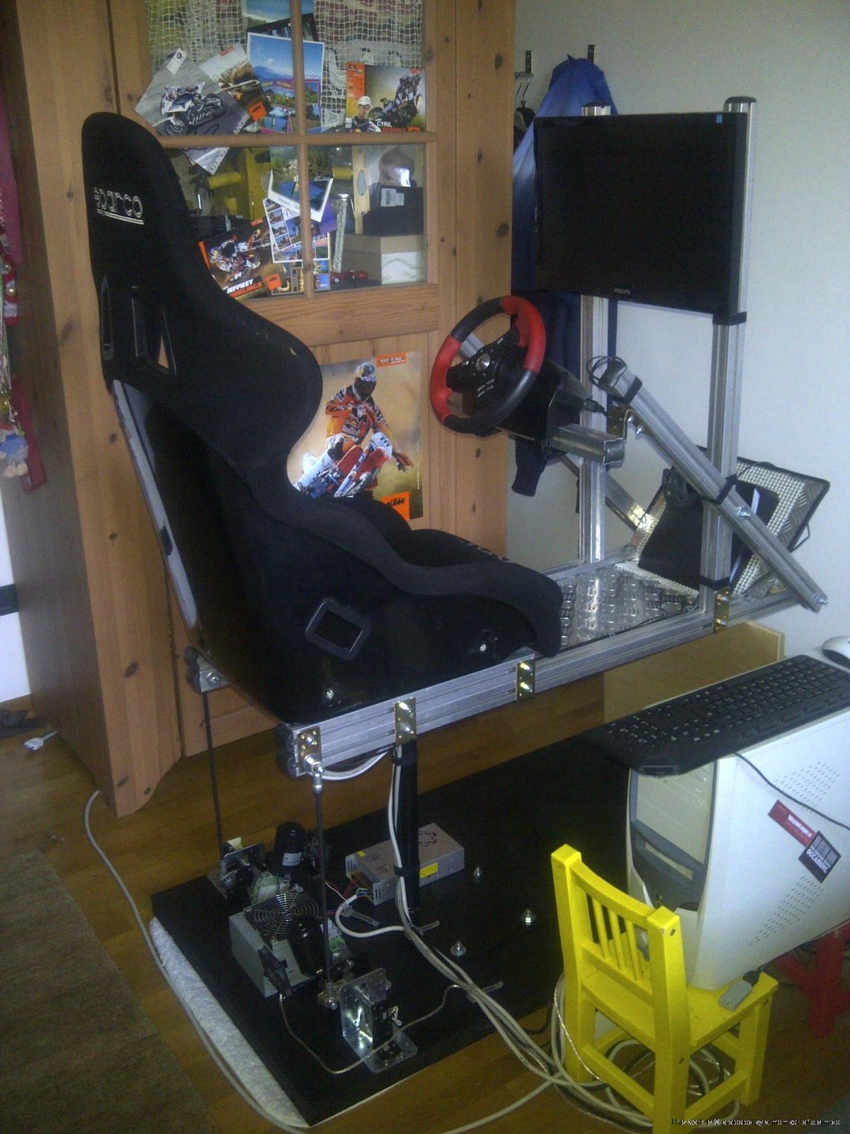

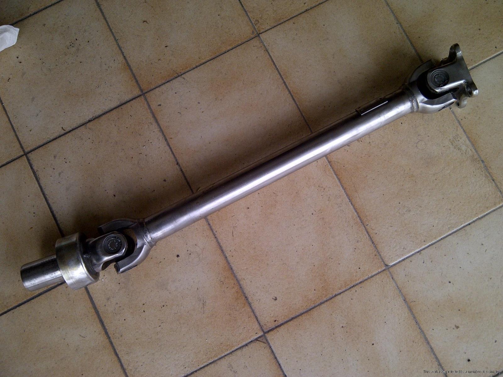

    after a shorts tests broke both motor shafts

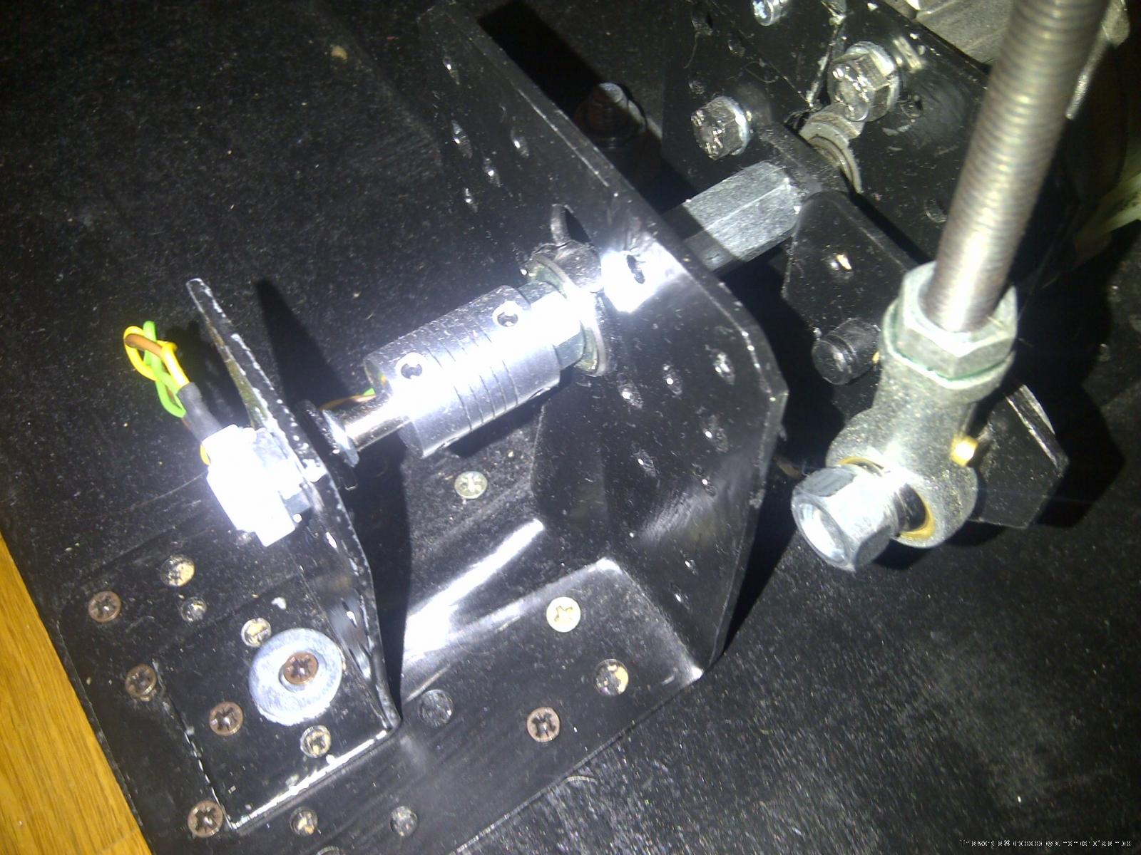

    therefore i decide to different motor assembly and now i have this structure.

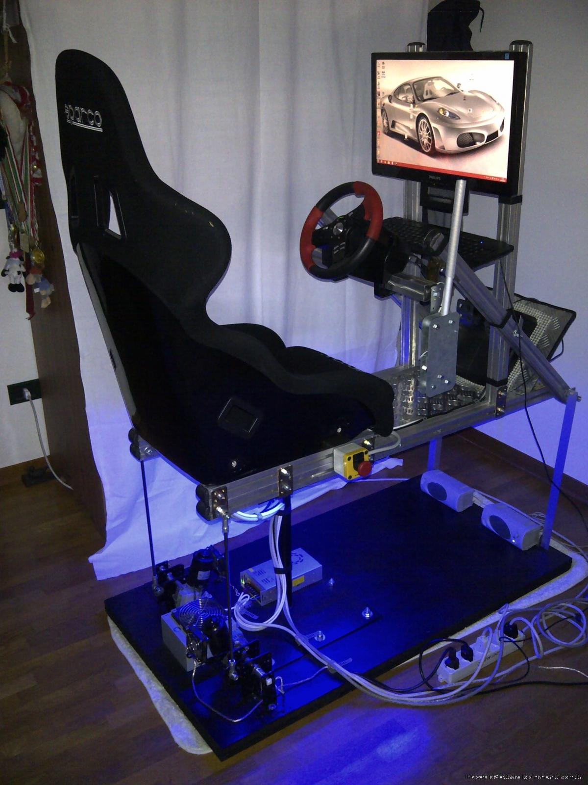

    panoramic final assembly of playseat

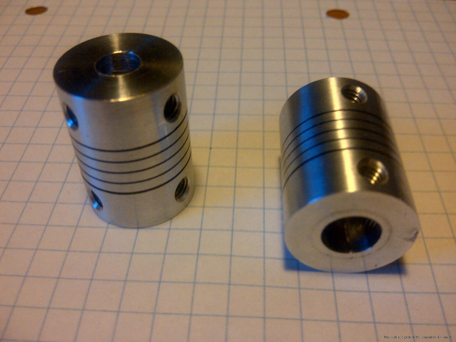

    after further problems with pots, decide to buy cermet pots
    i hope have more long life
    and if my mounting calibration is not perfect, buy also flexible couplings
    assembled
    and now other tests.
    after some adjustment the playseat move ok with new cermet pots

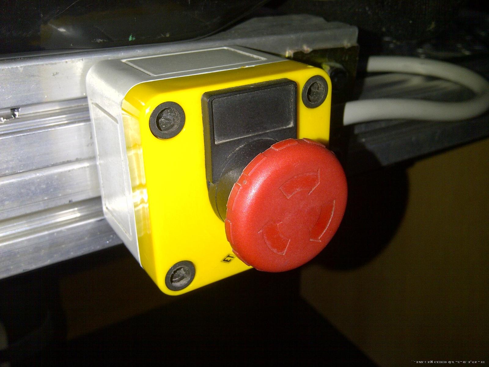

    another add-on: decide to install a safety switch to break motor power.
    this help me for a problem in power on sequence.
    i have Arduino power from pc usb and 5v for pots is from arduino.
    sametime in power on, my motors rotate casually with the possibility of broken.
    now i power on pc, attach arduino to usb, sit on playseat and release the power for motors.

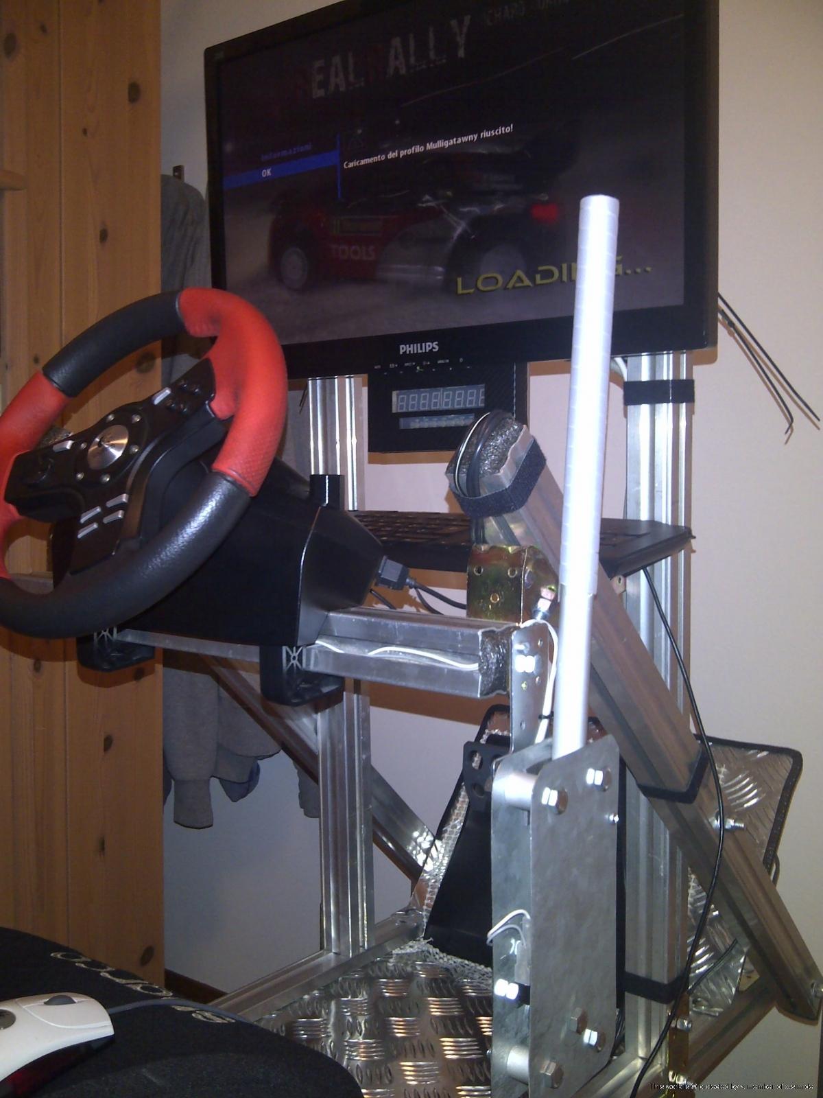

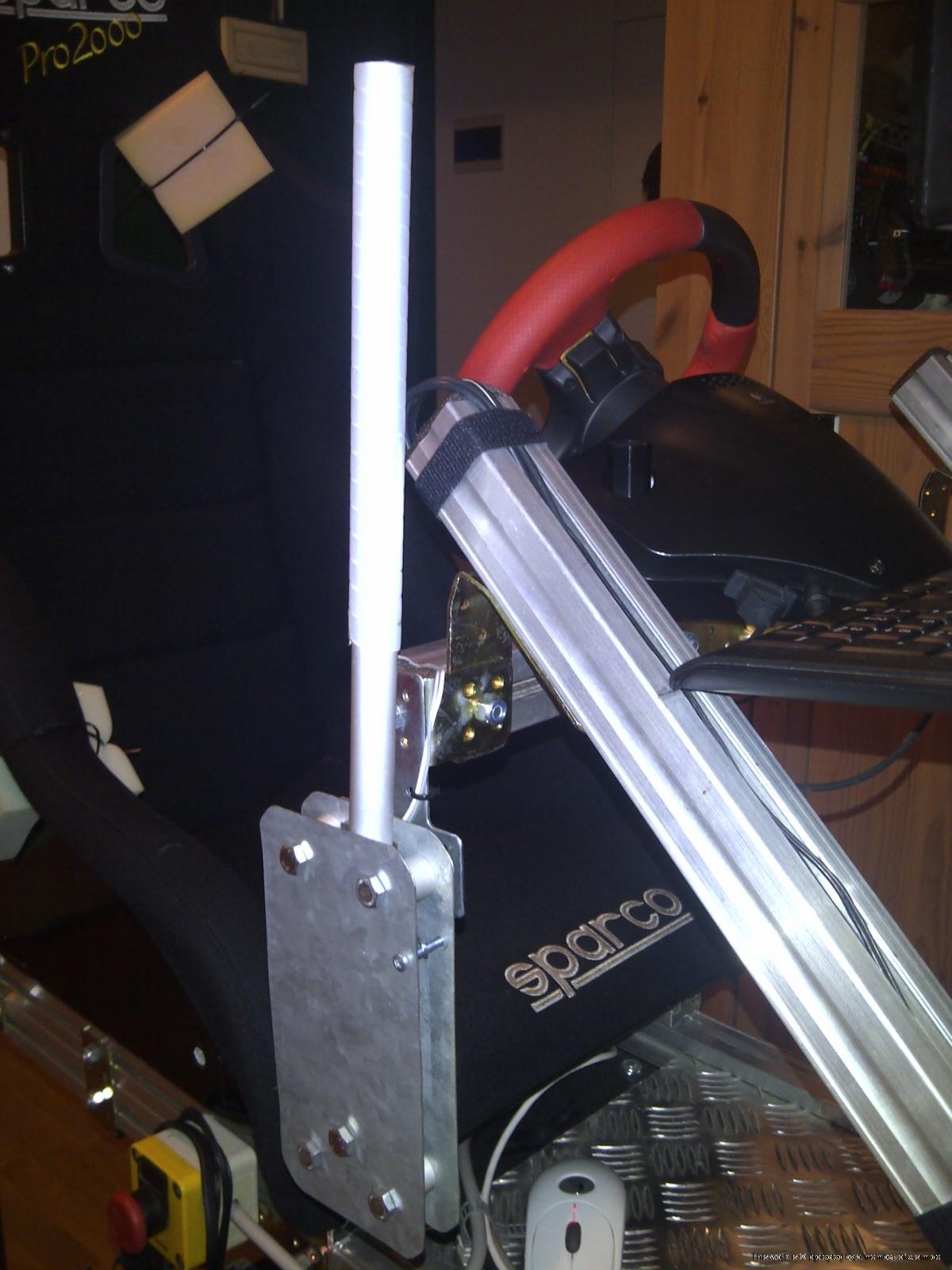

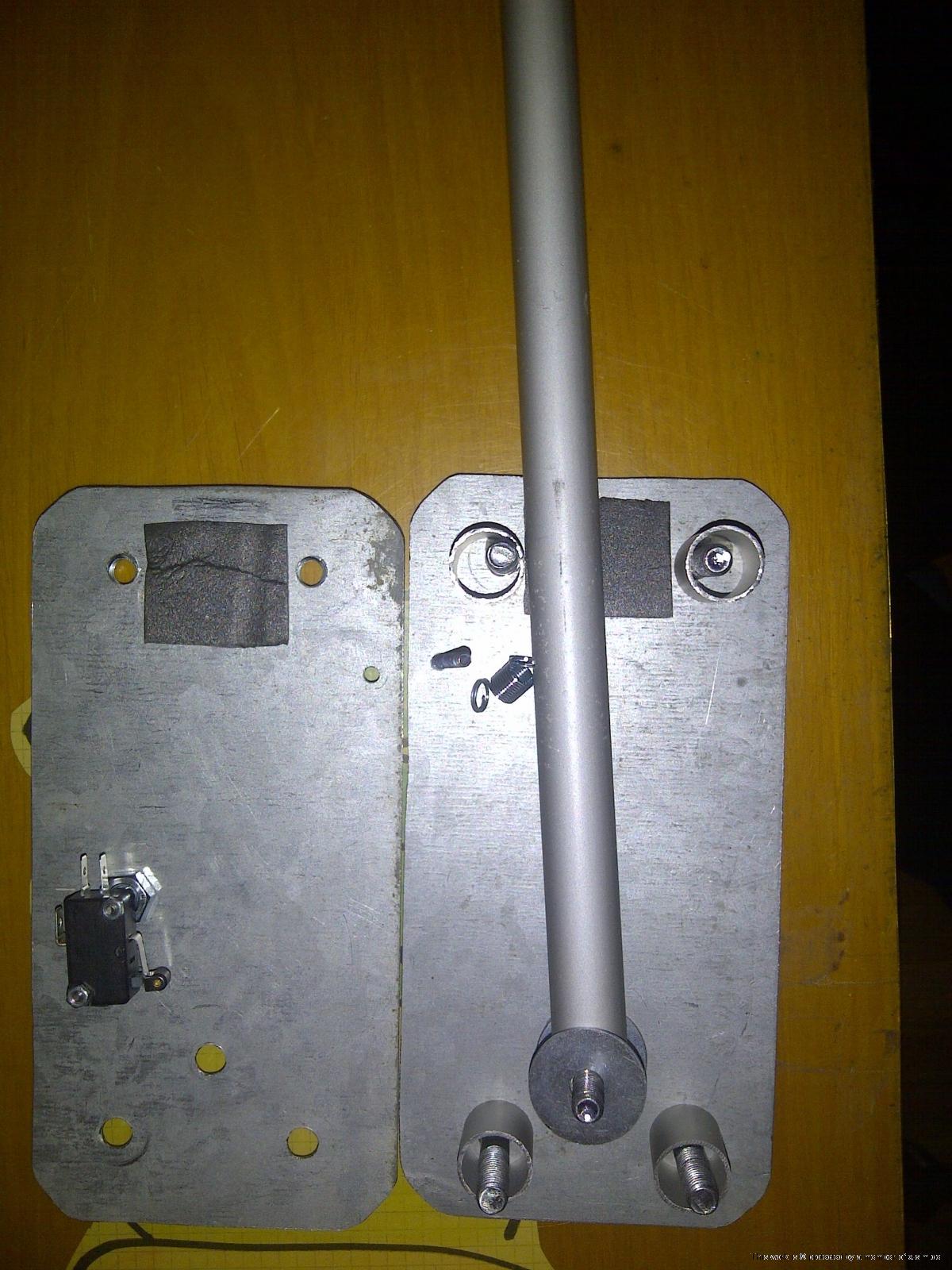

    added handbrake :
    i have attach a micro-switch in parallel of a button inside the steering whell
    [​IMG][​IMG]

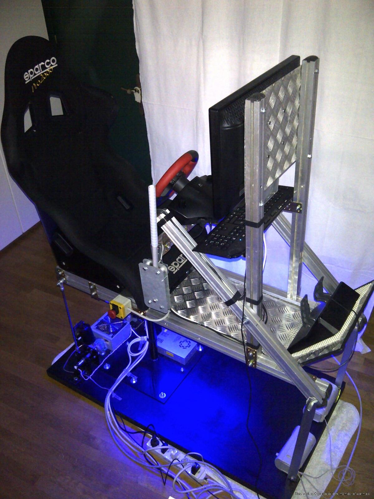

    LAST : added blue led strip
    before .................. after
    [​IMG][​IMG][​IMG]
