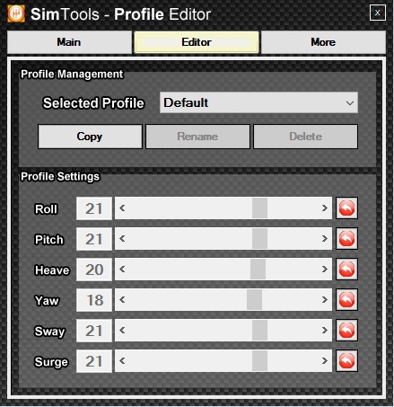

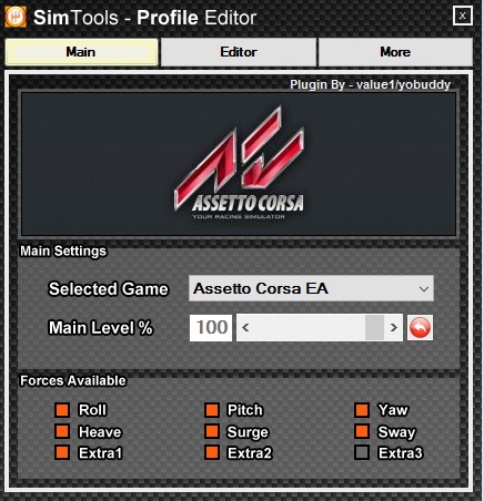

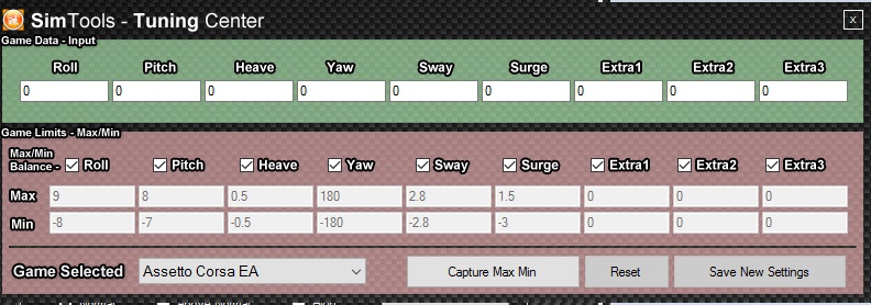

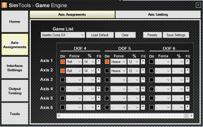

    and this is my setting

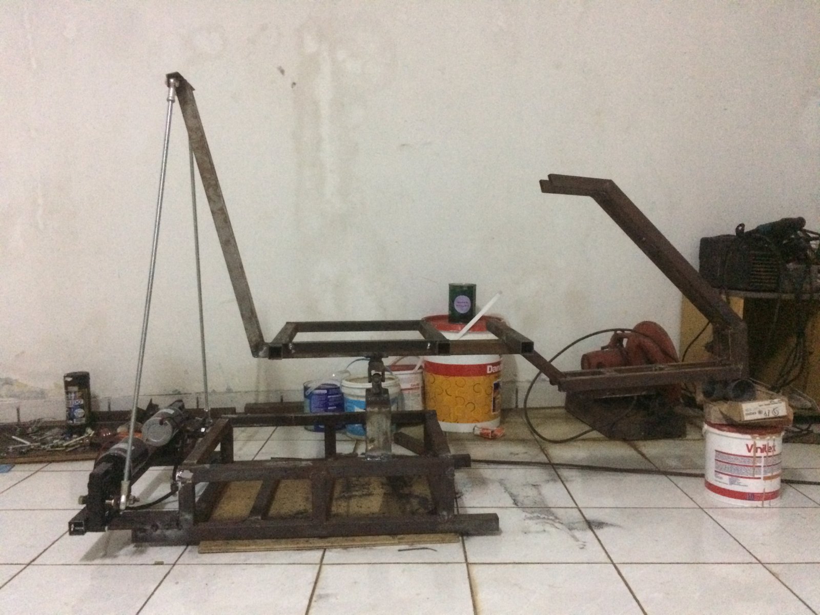

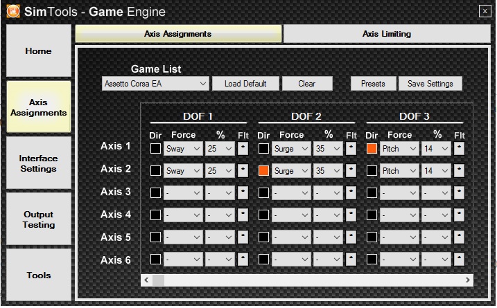

    Update from previous :
    1. Re-build my simulator to simple seat shaker (previous full frame).
    2. Re-make motor shaft from threaded rod to custom shaft (milling).
    3. Evaluate wiring.
    4. Evaluate @Wanegain arduino sketch (Min & Max pot. I decide to using +60 -60 degree movement, to prevent over travel lever).
    5. Will send my simulator frame to be powdercoated.
    6. Back to drawing board, traction loss coming soon (motor already on hands, board still thinking Sabertooth?JRK?).
    With current setting and condition, my movement as you see in video. I still learn to get finer movement. Playing AC for 2-4 hours (playing with motion sim is really addictive) my motor is Normal (even no warm), my Sabertooth is Normal, my PSU is Normal. the only problem is my PSU is very loud.
    Playing Dirt Rally with AC setting. Everything is warmer. I play only for ONE Stage (6-10 min).
    some question :
    1. I am thinking about giving some "safety protection" to my electronic configuration, i see several nice idea from this community (using car battery, fuse, even relay). i really want to put all that to may simulator (Overkill?). what do you guys think?
    2. Am my simulator eligible for free SimTools 2.0?
    That's all my current status. please dont hesitate to comment about my simulator (i really need input from all sim expert from this amazing community).

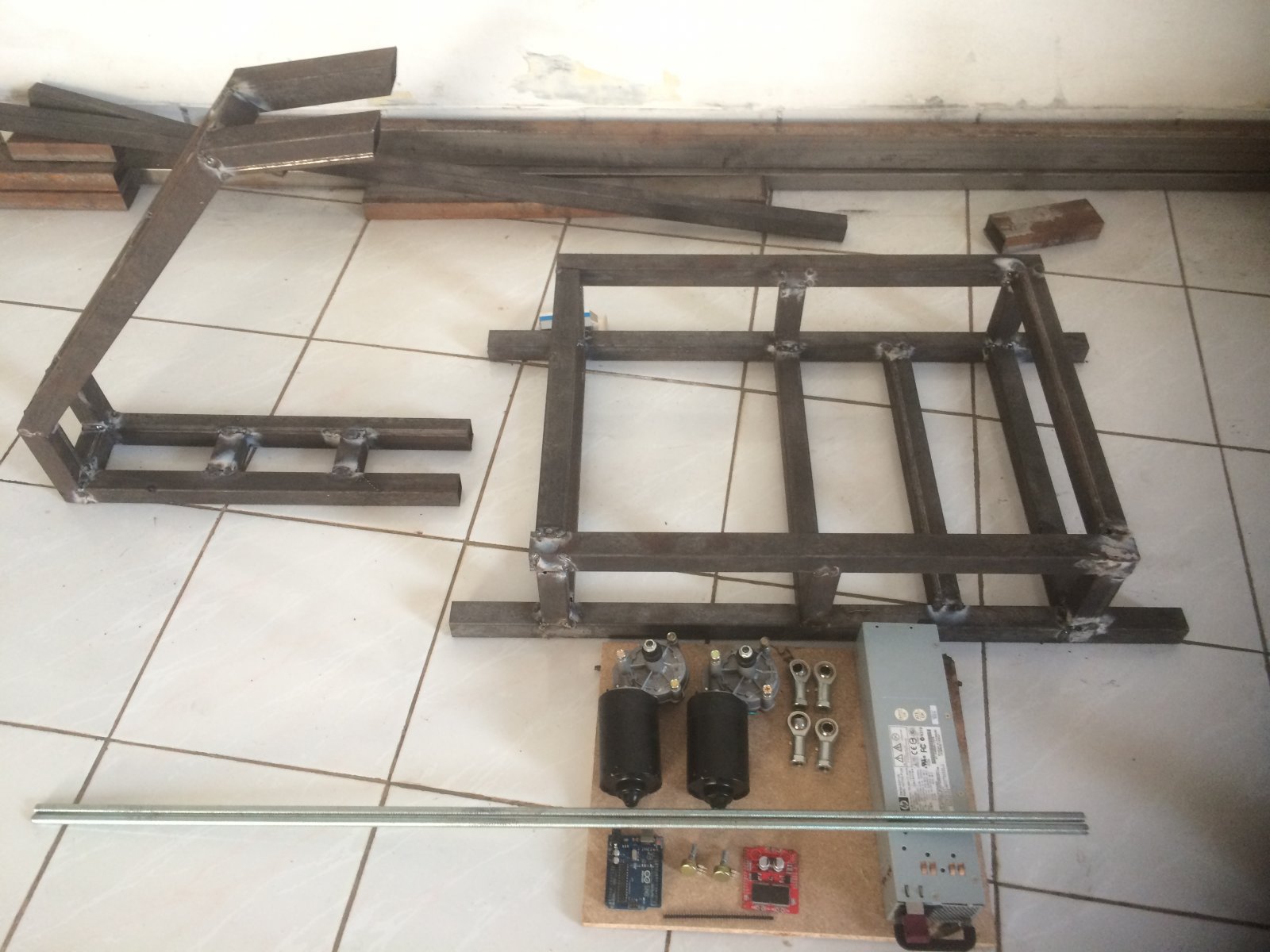

    We already collect all parts and electronics (minus uni joint):

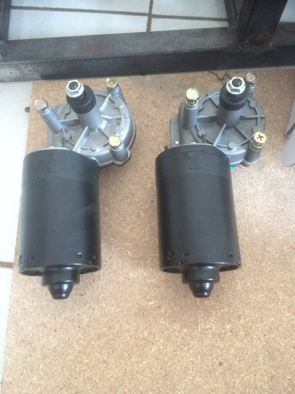

    1. Here's our wiper motor, it is from Suzuki Trooper
    Hope it will move my sims:)
    2. Here's our complete parts and electronics:

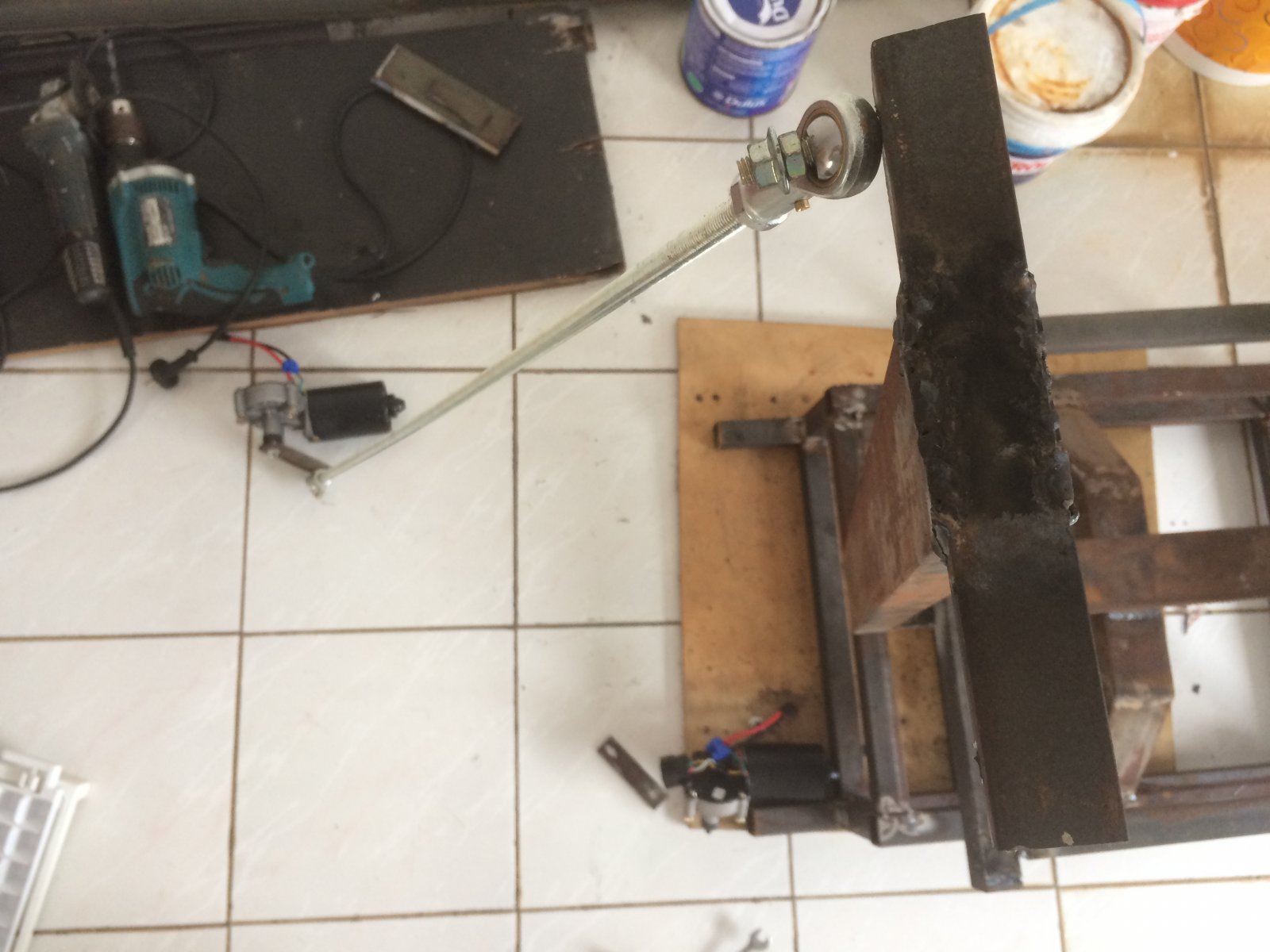

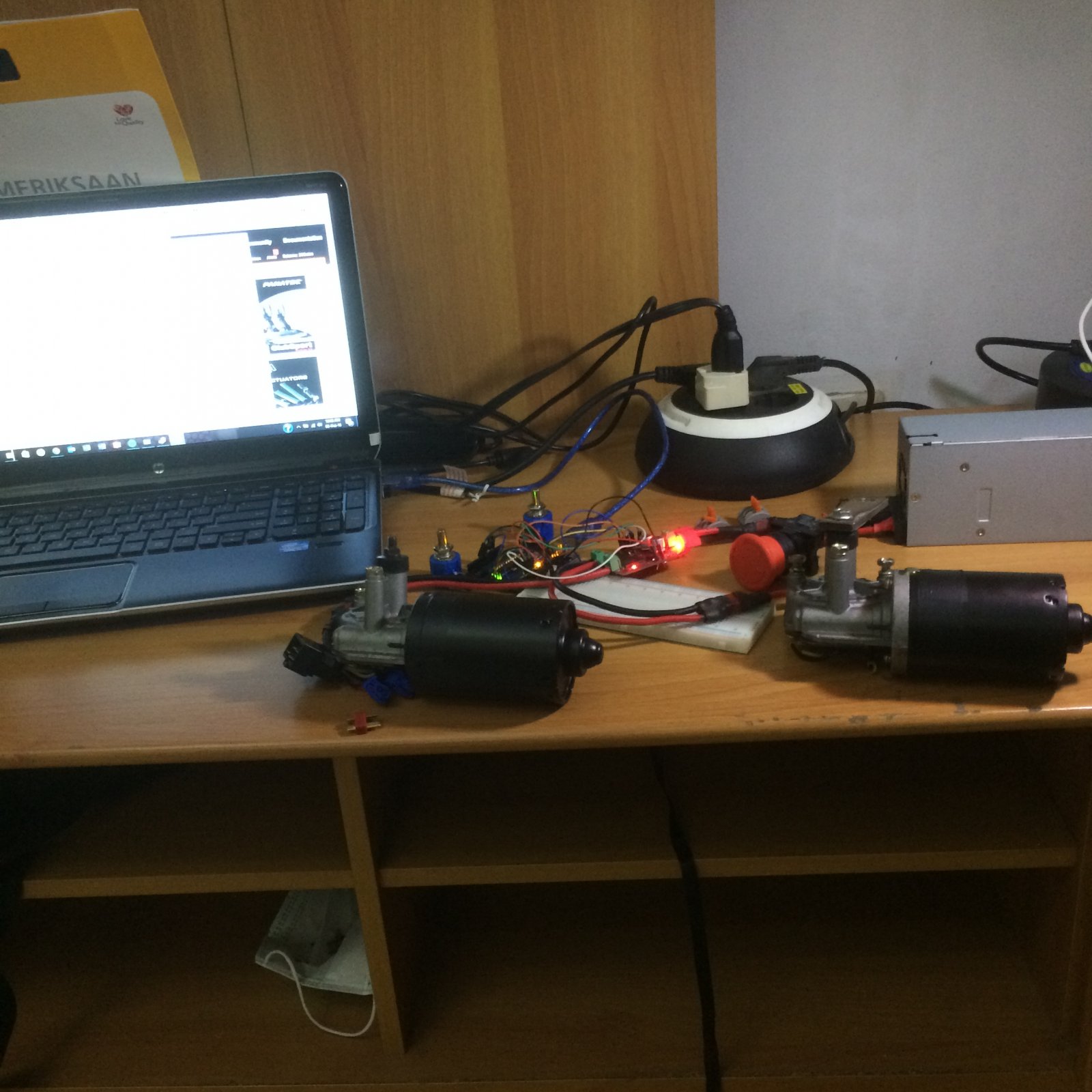

    I am decided to use arduino uno and MotoMonster

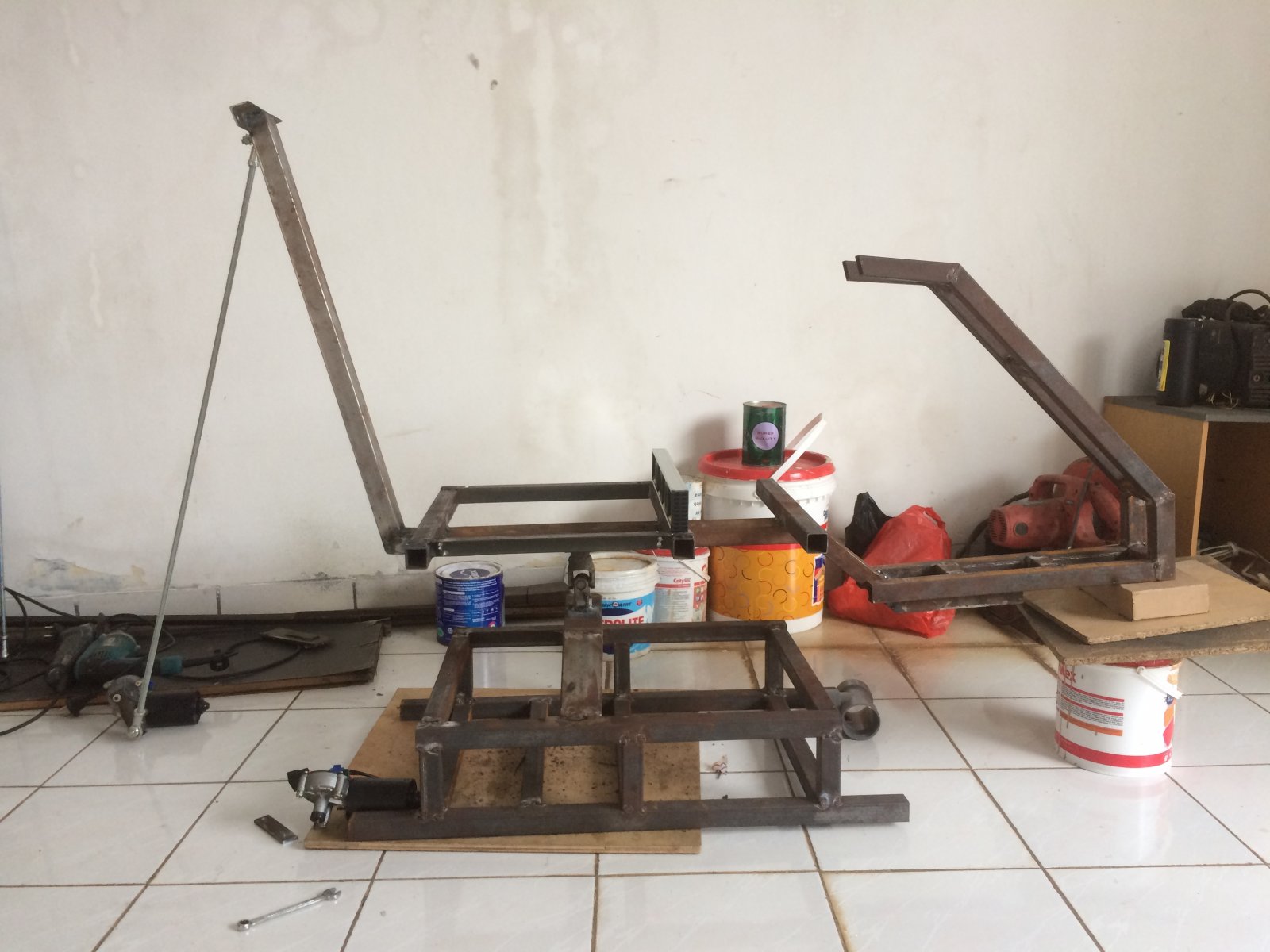

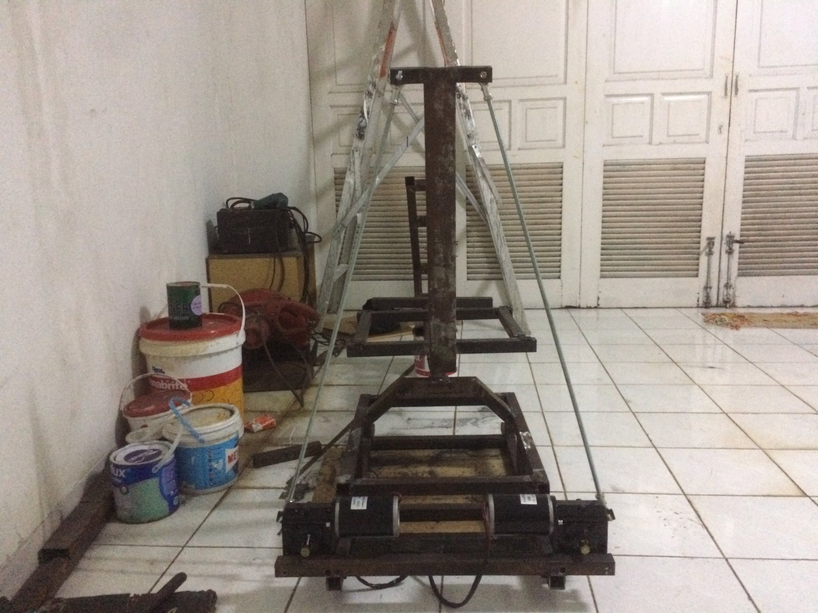

    3. This is my welded platform, our intention is to build knee mount motor. I know maybe some of you think the motor is small for this kind of build. But i know somewhere in this forum somebody already success build this.
    Regarding this build we have several question (noobs question):
    1. How we suppose to mount the motor, as in picture motor have same direction. As we have to make left and right, what is rule of thumb on how to mount the motor?Must be align between shaft?
    2. Continuinng from poin 1, if so from our thinking the motor will move in opposite direction?to counter this.
    That's it for know. Bear with me guys, as in the progress i will have more question, noobs questions.;)

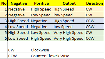

    another question, after watching some youtube video regarding wiper motor and from this forum, we only need two wire, so which wire ?1, 3, 5, or 6 configuration?

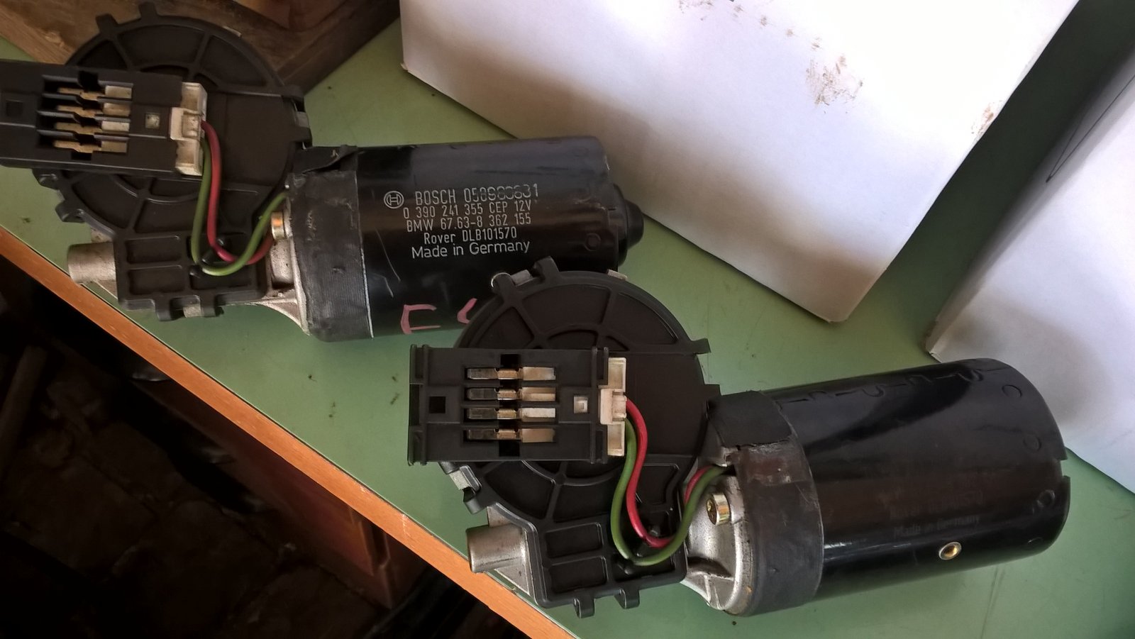

    2DOF, JRK
    What connections do you have on your motors @DonCorleonez ?
    I've got wiper motors from BMW and they are equipped with just 2 wires as seen on the picture.

    the connector just the same as you, but i have 5 cables, 2 straight from motor side and then to connector, and 3 is "connected" to body and then to connector

    auchh..I'm affraid my very limited experience can't help there:(

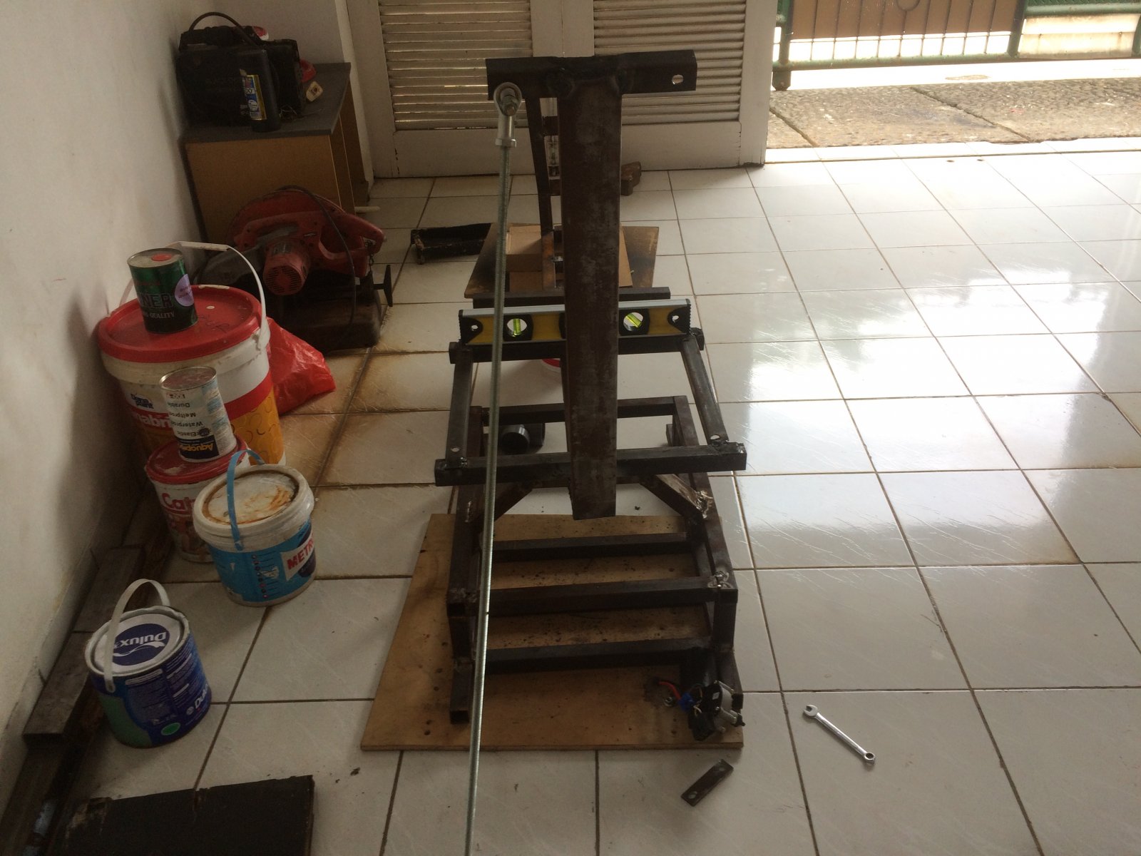

    Proceeds with our build,
    today i try to fight with SMC3 Utils, i already follow step..but in step where we have to slowly increase PWMax, when motor moving, the green feedback line is not moving towards/away blue line
    but when i switch cable between 5v and GND..the only difference is green line move to below blue line, but still not moving towards/away to blue line.
    when i rotate pots knob same direction with motor movement, the green line is moving towards blue line and stop when it reach same level.
    ..is it normal?can i proceed with simtools?
    Or is it we suppose to connect pots with motors before conducting SMC3 initial setup?:sos
    pots i am using Bourns 3590s 10kOhm linear
    http://www.mouser.com/ProductDetail/Bourns/3590S-2-103L/?qs=ka0oSW1bB1LlqwdMBlB3qQ==

    still waiting comment:nerd
    meanwhile some progress
    any comment and suggestion are welcome :)

    2.....Make sure your language settings are English: https://www.xsimulator.net/community/faq/language-setting-bug-change-to-english-local.233/
    3....Review the SimTools documentation: https://www.xsimulator.net/simtools-complete-documentation/
    4....Set up the SimTools Interface settings.
    5....Set your axis/forces up to move in the correct direction: https://www.xsimulator.net/community/faq/which-way-to-set-simtool-axis-movements.230/
    6....Create a motion profile: https://www.xsimulator.net/community/faq/steps-to-create-a-motion-profile.228/

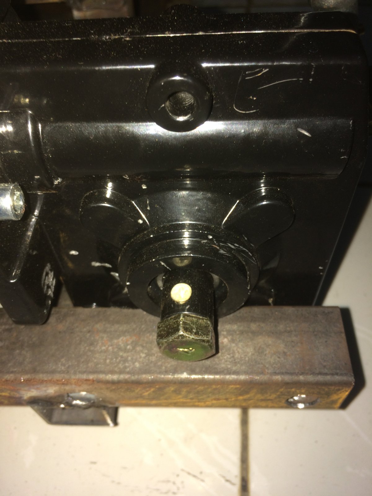

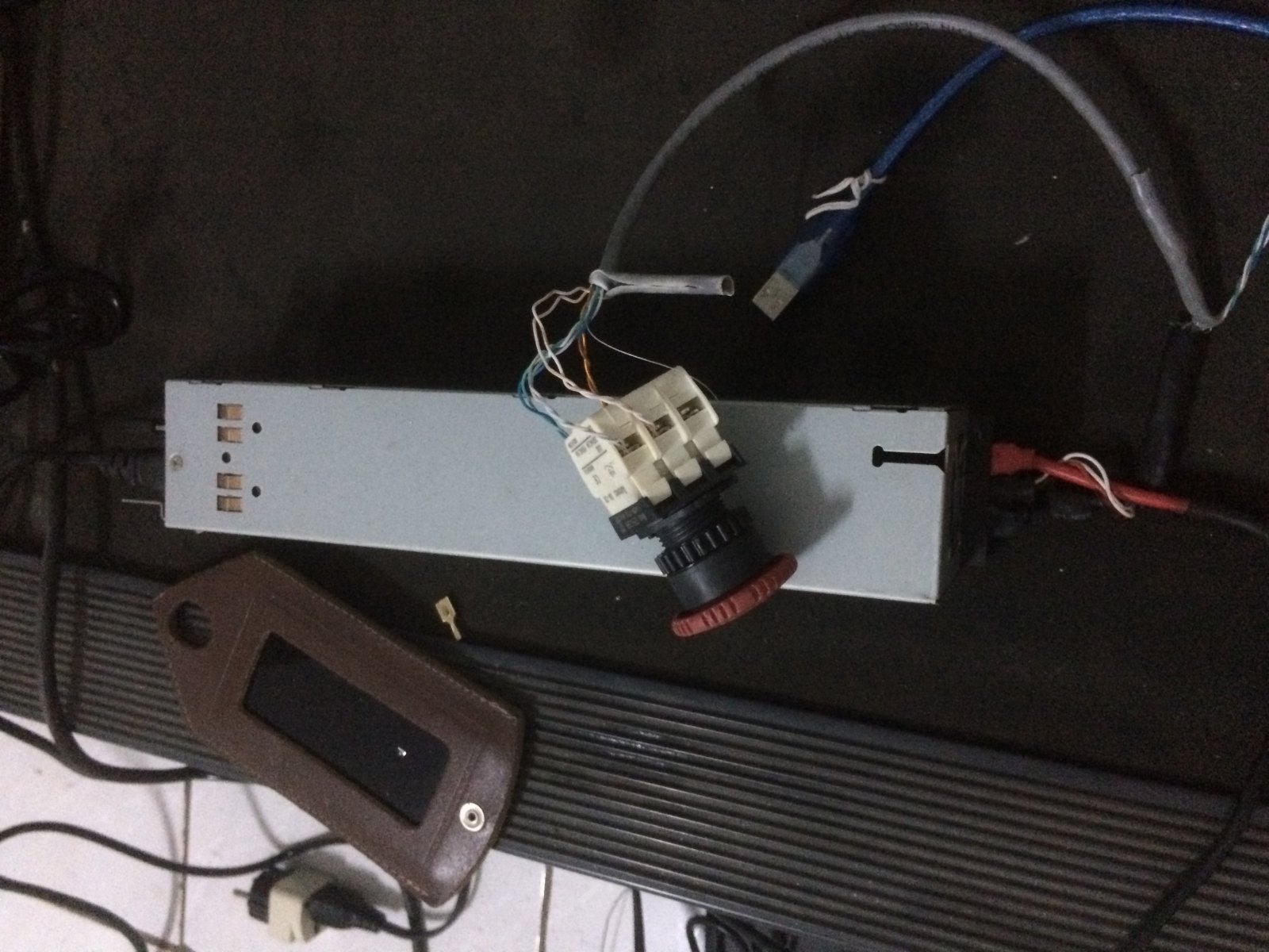

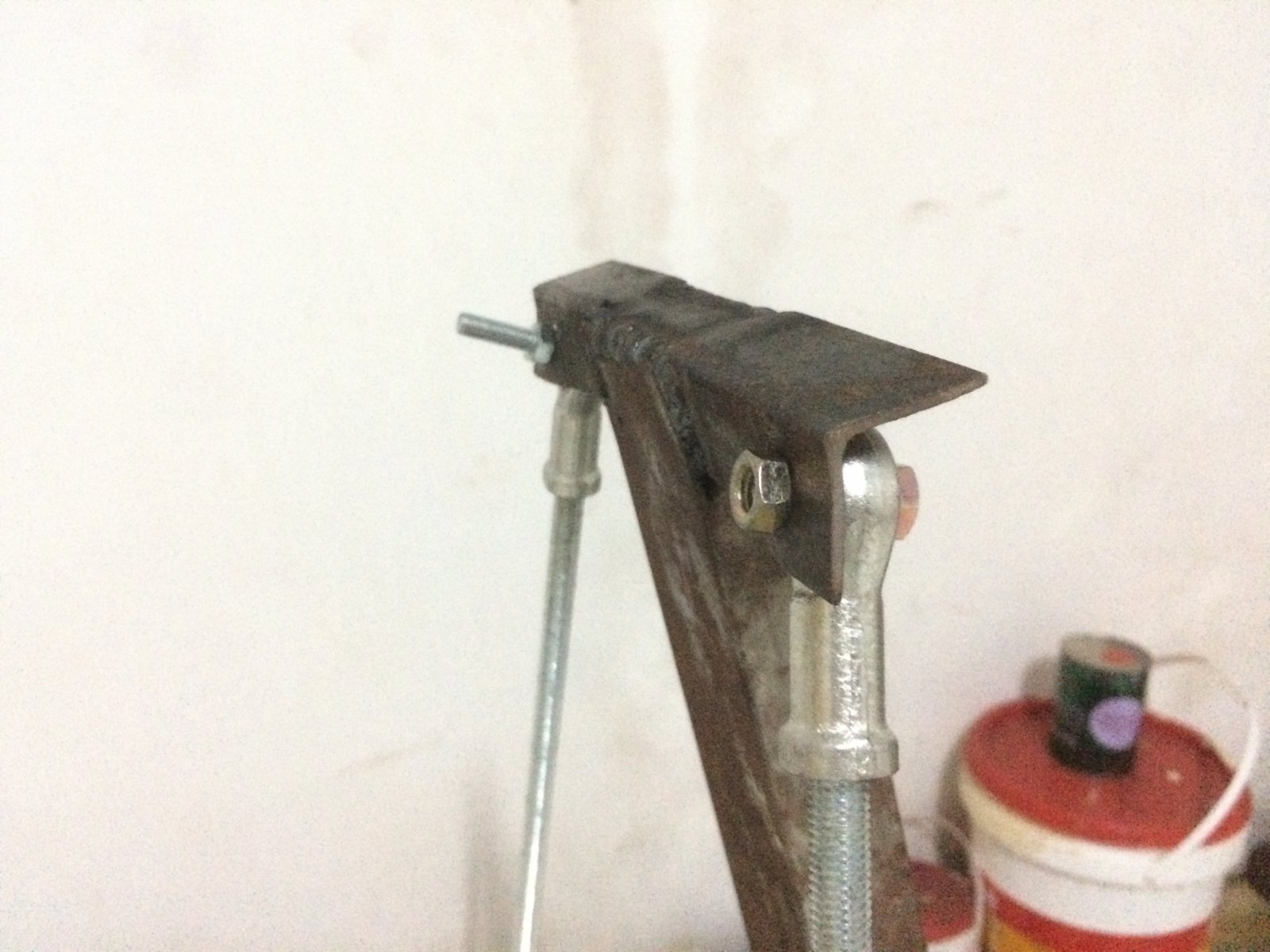

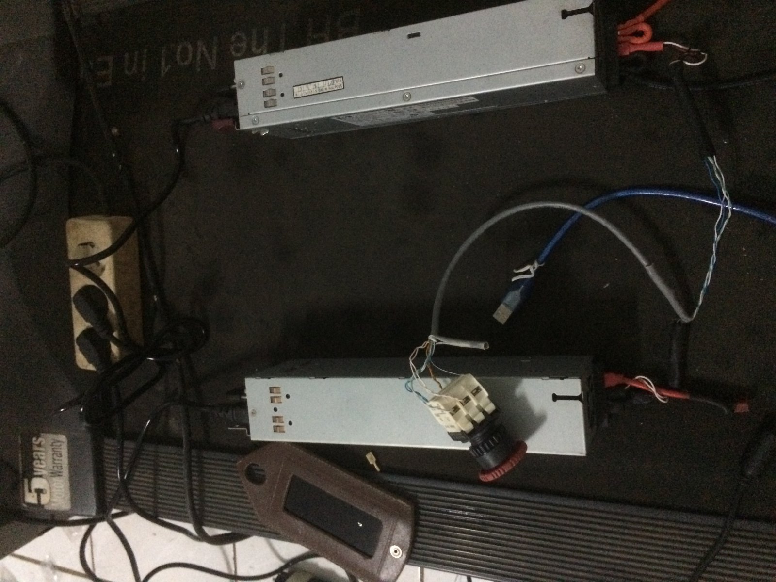

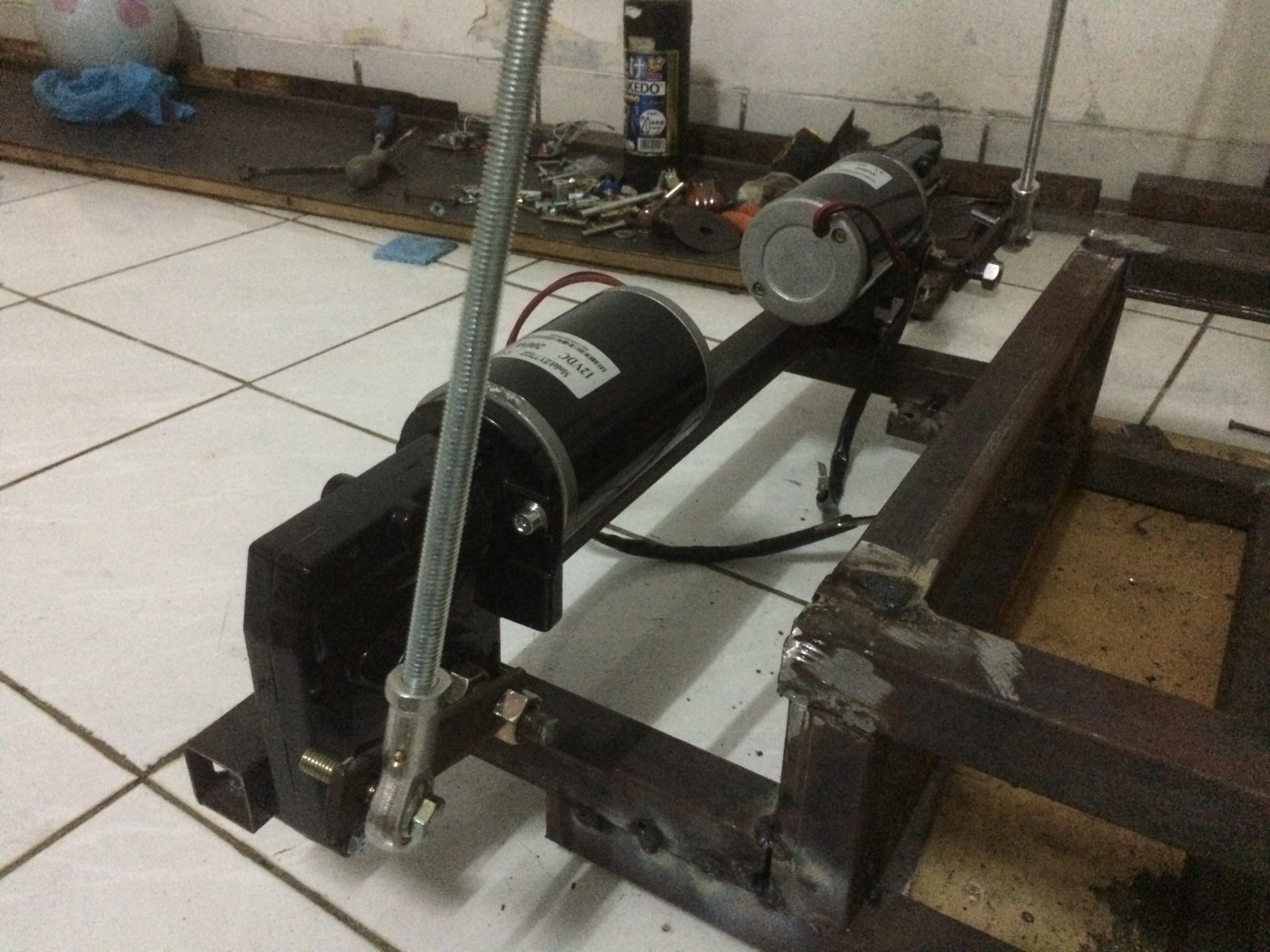

    emergency stop mechanism credit to @Nick Moxley , this button will cut power to MM but does not turn off PSU. it have 3 NC contact block, but only use two, i prepare for next upgrade
    please comment about rod positioning, is it better like in photo or i should move it to side?
    and also motor position, what do you guys think?
    any comment much appreciated
  20. Daguru
    Sep 4, 2013
    719
    Kitchen installer
    Wales uk
    453Coins
    +632 / 1 / -0
    Motion platform
    I would turn the motors as I think you would get more movement
