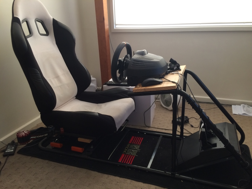

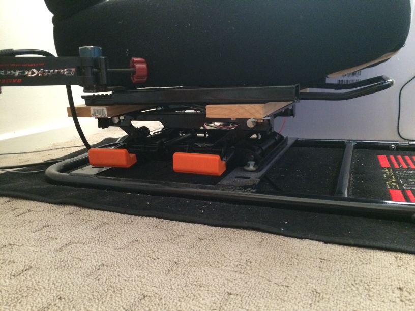

  5. STEELJOCKEY
    STEELJOCKEY New Member
    Dec 9, 2015
    20
    AUSTRALIA
    441Coins
    This is what I have to start with, so I'm guessing 2DOF with heave would be good, probably cheapest too IMG_5127.JPG IMG_5128.JPG
  6. STEELJOCKEY
    Dec 9, 2015
    20
    AUSTRALIA
    441Coins
    Do you actually need a uni joint under the seat if doing a 3DOF setup? Wouldn't the three motors hold up the seat?
    21,506
    150,656Coins
    +11,018 / 55 / -2
    Mine is a spring assisted 3DOF to take some of the load, so yes you do need the uni joint, or else you could use far more powerful AC motors for an unassisted 3DOF.

  12. STEELJOCKEY
    Dec 9, 2015
    20
    AUSTRALIA
    441Coins
    Thanks for the info.
    I think my main problem though is going to be the seat slider. My current setup allows me to slide the seat back and forth for pedal and wheel reach, which is handy for getting in and out of the seat also. Though I could imagine it difficult to have a stable pivot point under the seat and still retain the slider.
    Thoughts?
  13. noorbeast
    21,506
    150,656Coins
    +11,018 / 55 / -2
    You can have a fixed seat and instead use the slider to move the pedals.
