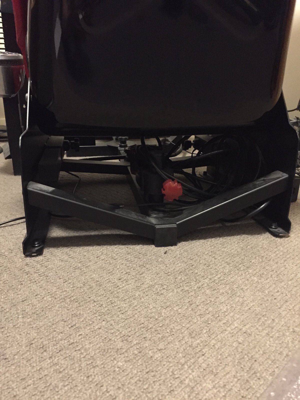

    Finally started my own thread after reading many others thread
    Ive decided I would like to build 2DOF with traction loss with car racing being exclusively used at this stage
    I currently have a static RSeat seat, triple monitors
    The build I would like to end up with would be similar to @Pit, neat & tidy with an aggressive edge
    Reading @eaorobbie & @bsft I have decided to travel the road of JRK... Not into programming
    I am currently trying to order / secure
    • 3 x Worm Drive Motor 12V/24V 200W, 180 RPM, 20Nm Torque motors
    • 3 x Pololu Jrk 12v12 USB Motor Controller with Feedback
    • 3 x BI TECHNOLOGIES / TT ELECTRONICS 6127V1A180L.5FS SENSOR, HALL, 0.2V, +20V TO -10V, PIN
    These have all be recommended for seat shakers throughout the forum
    I have been reading about PSU using LED PSU though still don't have a clear understanding.
    Will one PSU be enough for each motor?
    I would like to utilise my current "frame" to help my first version motion simulator
    I do not want the wheel / pedals to move, static only
    Any pointers in the right direction would be greatly appreciated
    Ive uploaded some photos of my current rig, input would be greatly appreciated
    ... I tried to include my current seat though unable to upload until 5 posts..
    I intend to build a RC servo model to test and fiddle with software to enhance my understanding

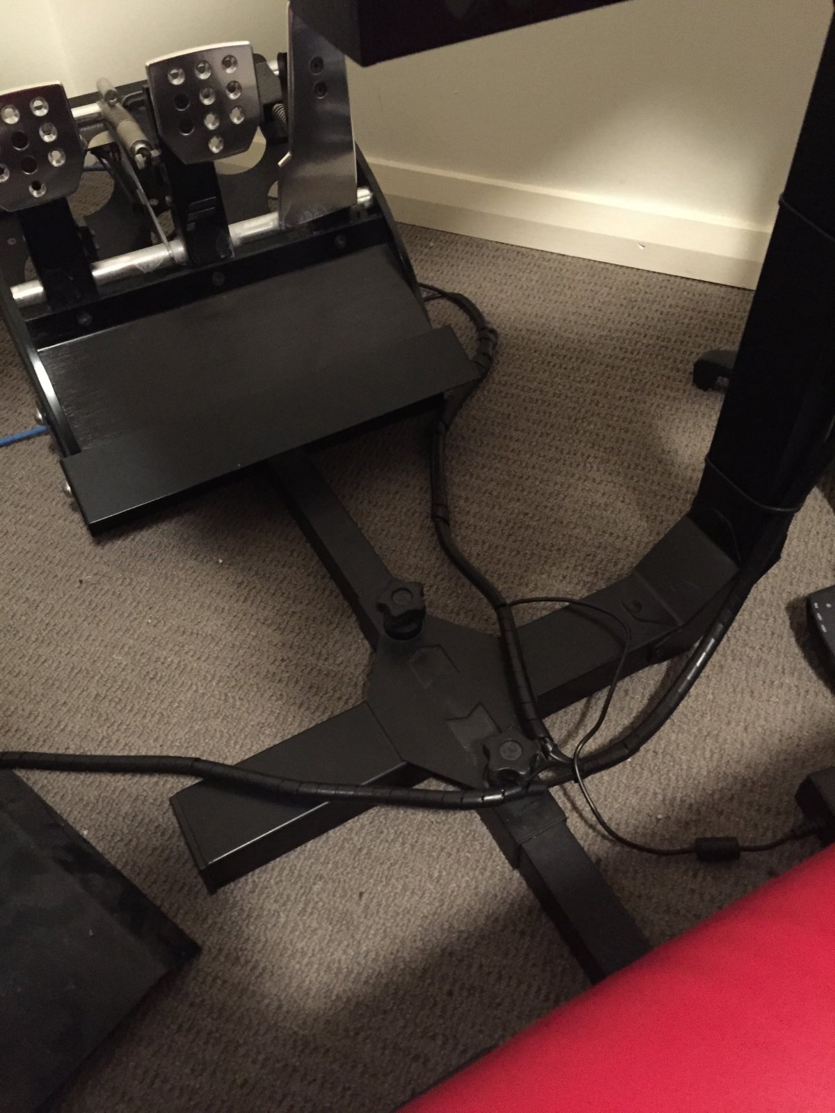

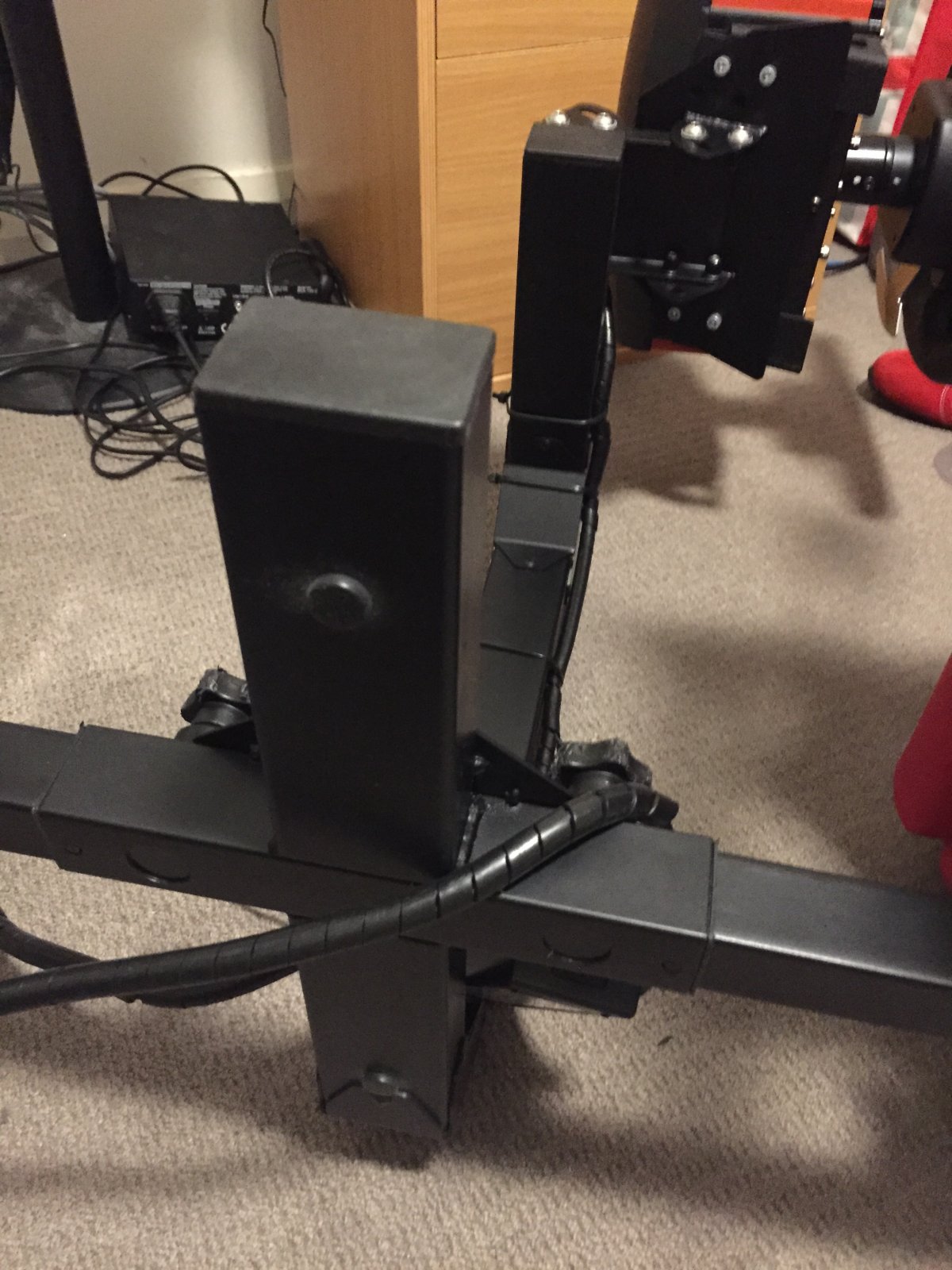

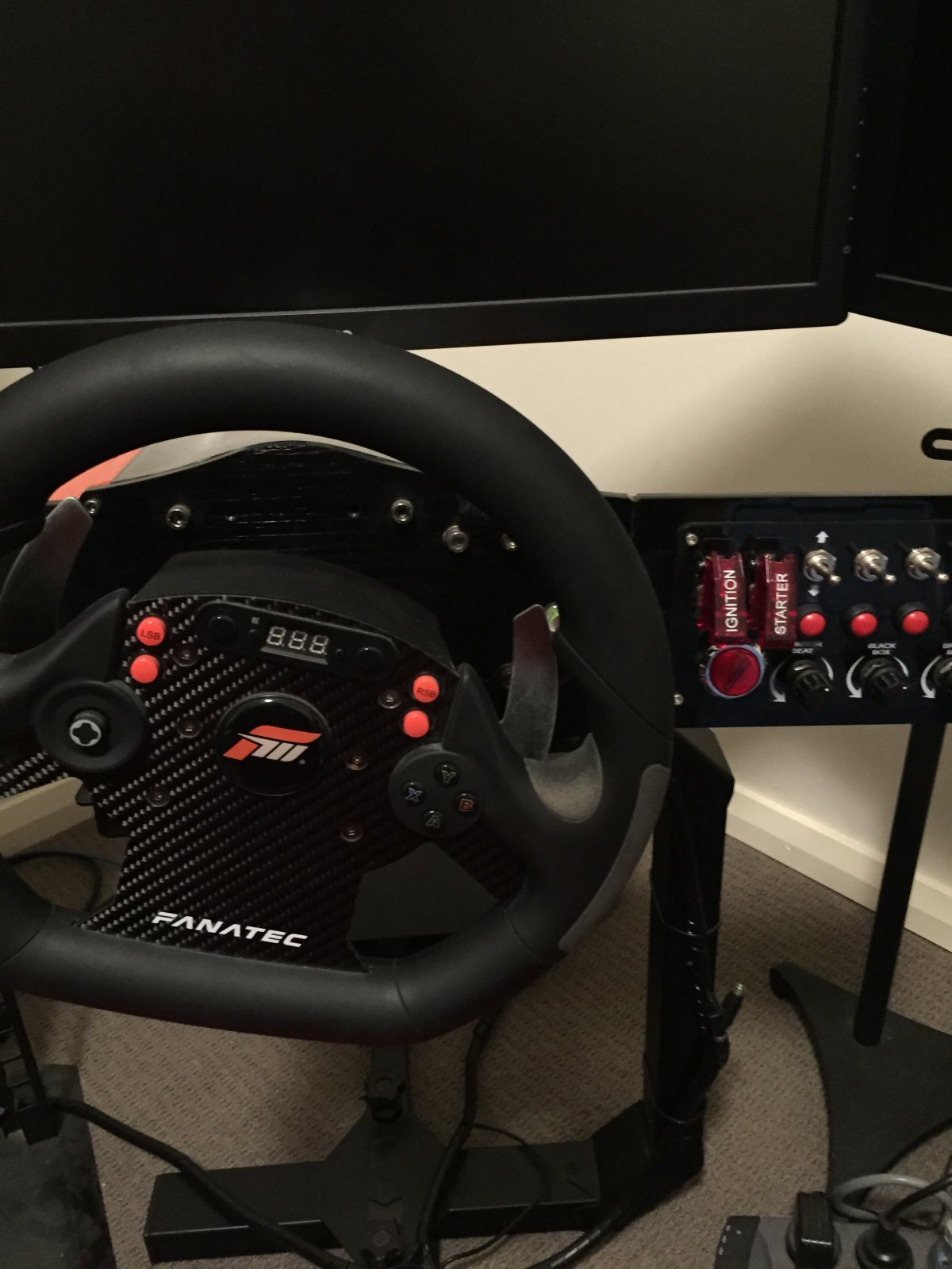

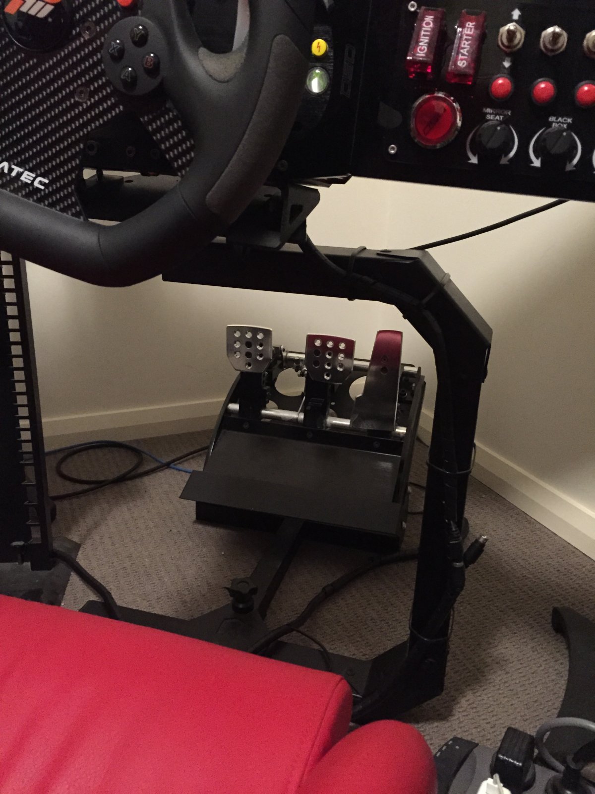

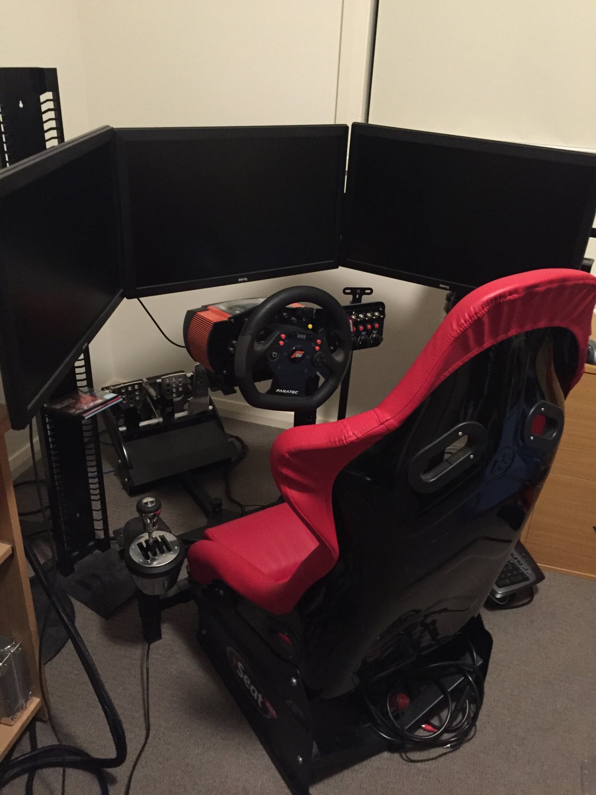

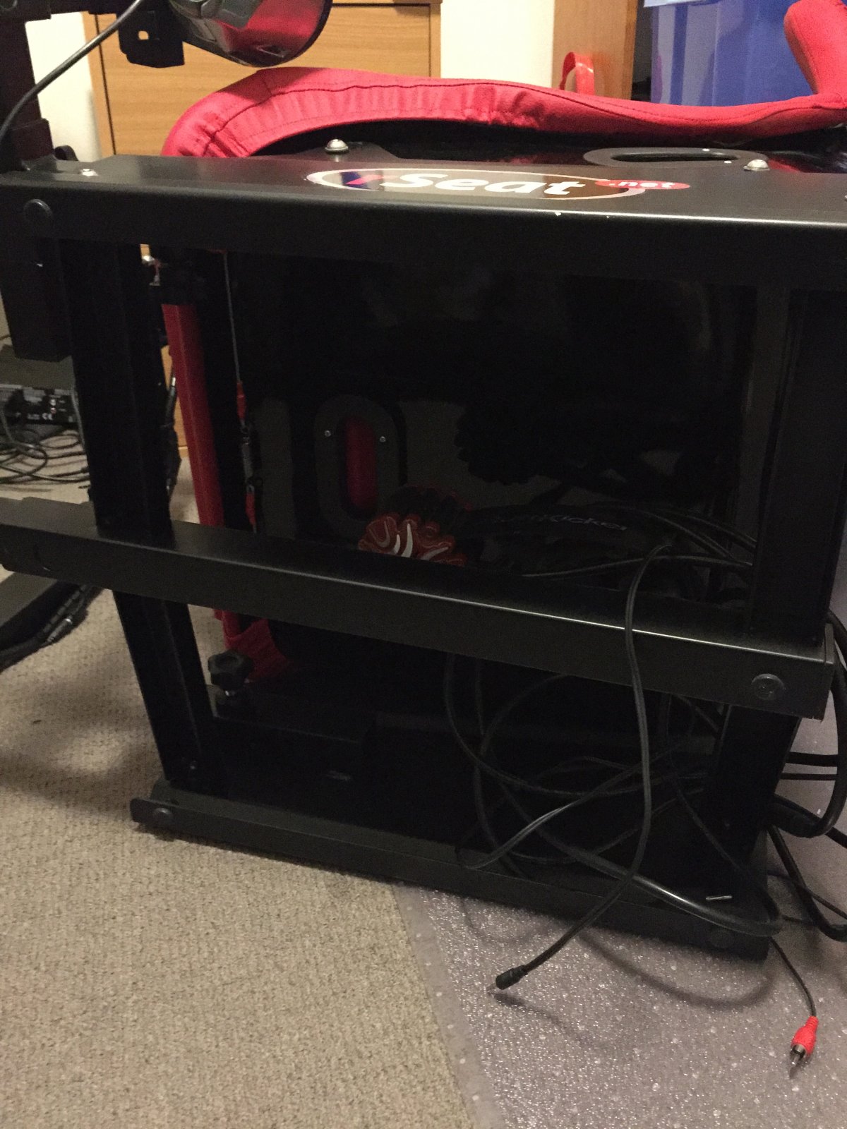

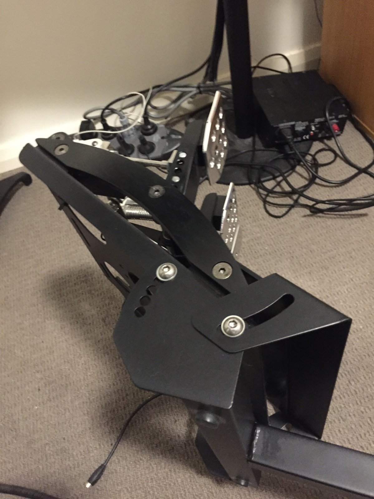

    I would like to utilise the equipment I have to improve my understanding of the building process and my requirements including enjoyment and available space
    Ive upload some photos of my current static rig, RSeat, and would like some personal opinion on designs that could be carried out by me
    My intention is still to build 2DOF + traction loss
    My thoughts with the RSeat would be to have a compact seat shaker design
    Tractions loss has me a little confused with two concepts being either lazy susan bearing under my chair on top of the U joint though I feel this will give too much movement
    The other, an better thought, is to placate bearing at the front lower to the frame with wheel at the rear of the rig as displayed in many posts here. If I too this path I am unsure who the bearing would fit into the front of the frame and design
    Im also thinking about including a 3rd servo in the RC model, after success with 2 to allow me to understand the correct movement that I am looking for
    Thoughts and ideas?
    IMG_2028.JPG IMG_2025.JPG IMG_2024.JPG IMG_2023.JPG IMG_2022.JPG IMG_2020.JPG IMG_2018.JPG IMG_2017.JPG IMG_2016.JPG
    21,724
    152,057Coins
    +11,064 / 56 / -2
    The traction loss lazy susan should go at the front. If you place it under the chair the effect would be yaw, which is a different force altogether.
    If you go with a compact design use @bsft's brilliant desk racer as a basis and give it as much leverage as the seat allows by having the front bar as far forward as possible and the mount point above the COG: http://www.xsimulator.net/community/marketplace/desk-racer-2-dof.91/

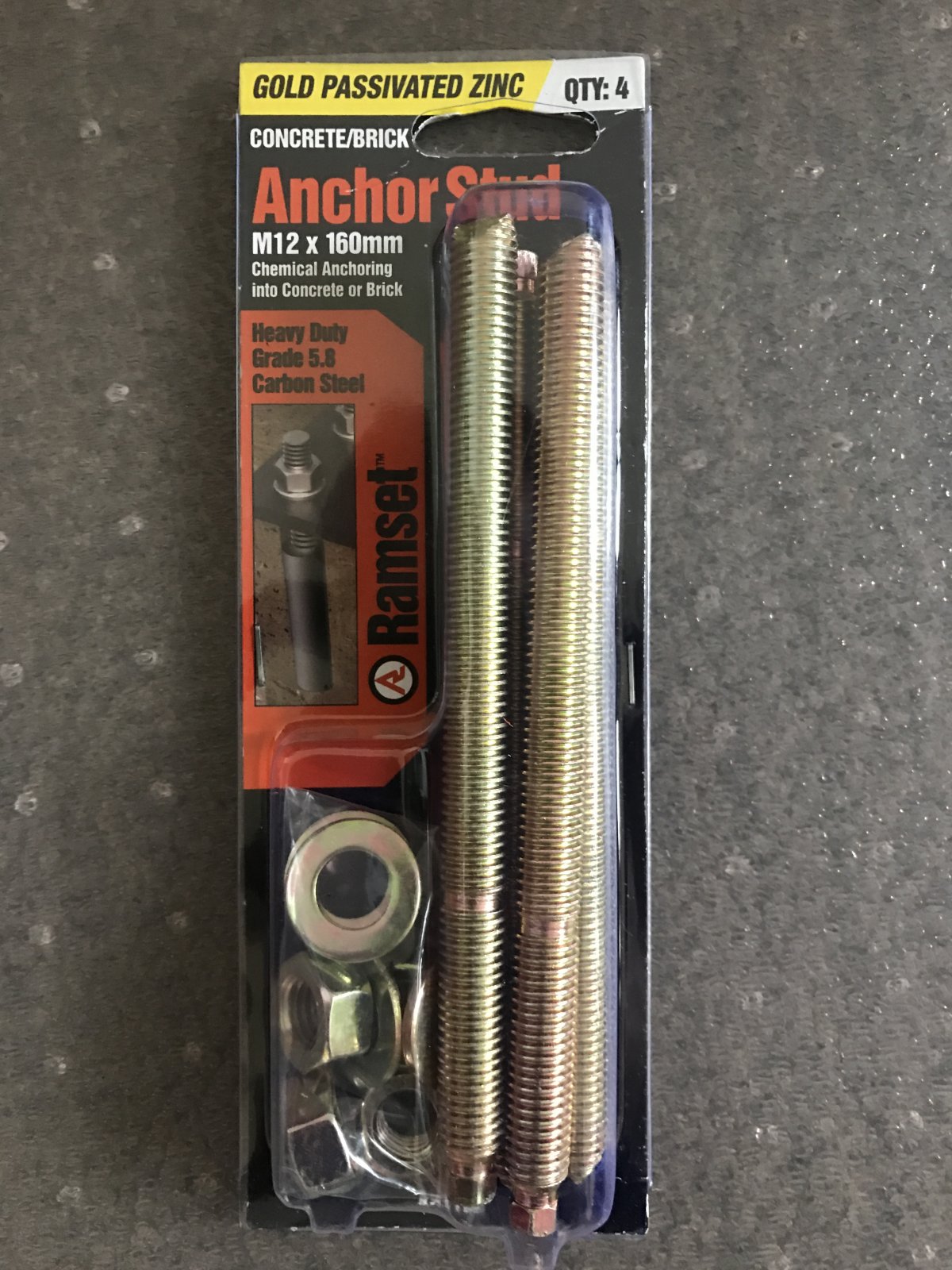

    I found these in Bunnings - M12 x 160mm Anchor studs - would these work as my main shaft through the worm gear motors? Nylon Lock nuts would follow if suitable
  20. noorbeast
