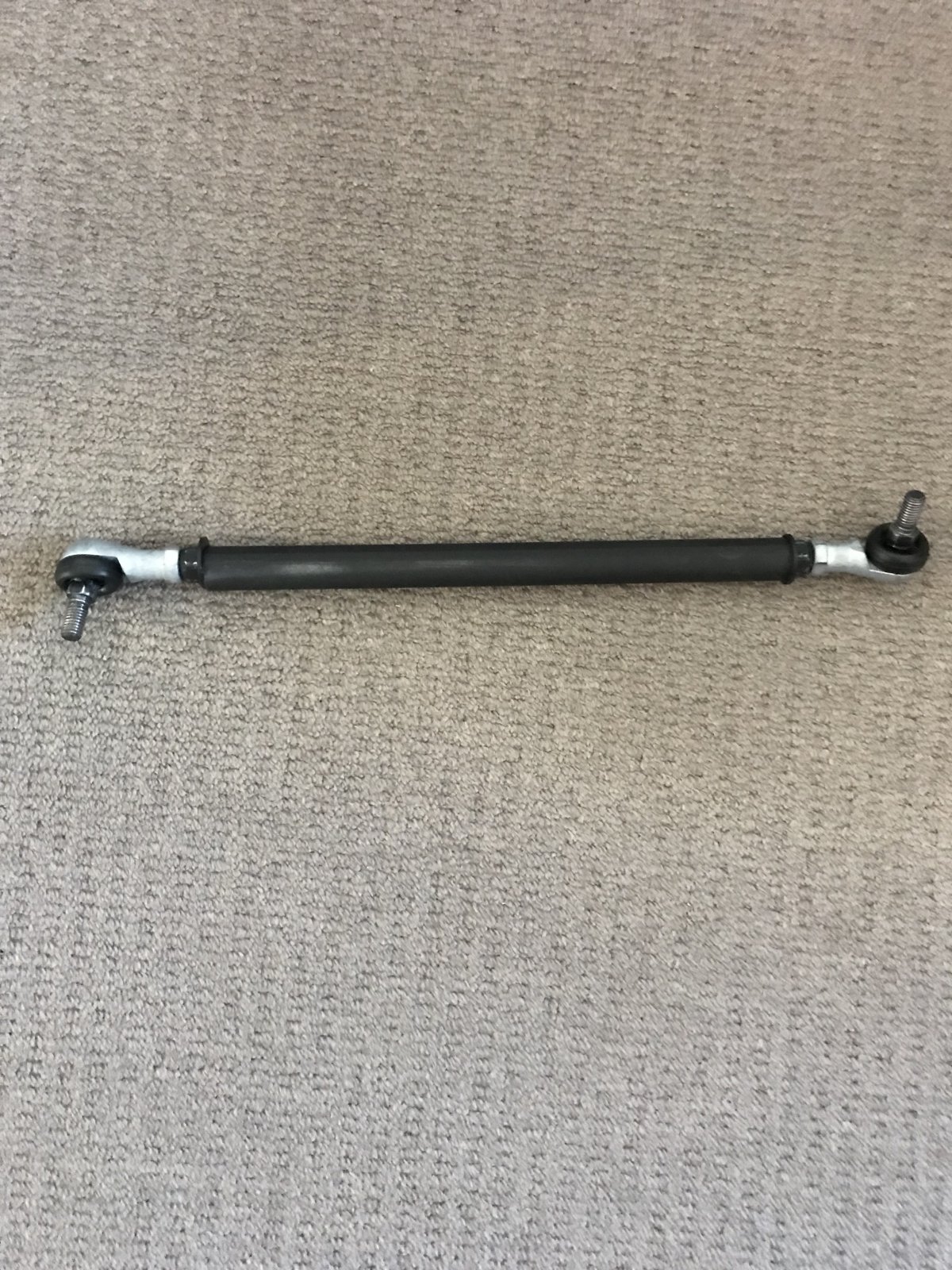

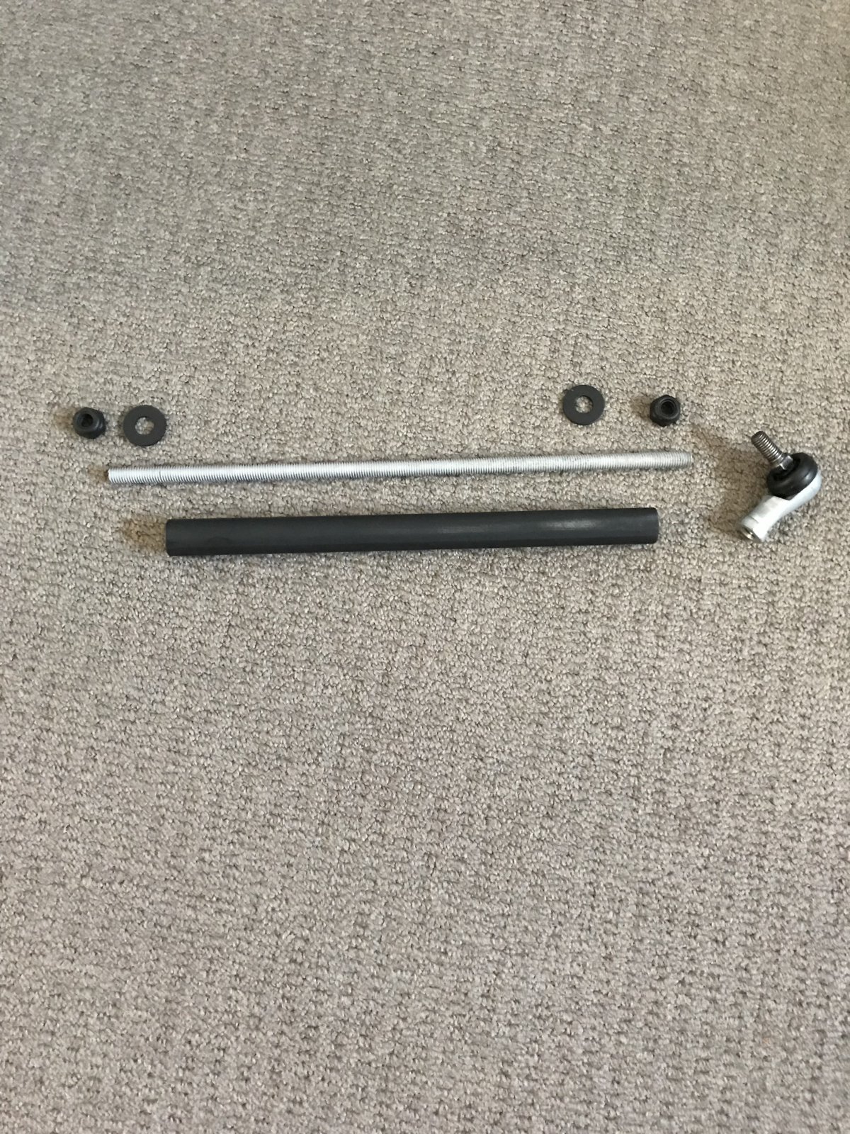

    @noorbeast I checked MD motors, all the same
    i read @Nick Moxley link that you provided, I understand the with welds etc though how do I find the length required for the main shaft?
    Is the 160mm enough or should I buy a threaded rod and cut to size
    I am working the next few days and will have a look after work to get a rough idea of length
    I am trying to have as many "ready made" parts due to living in a unit with no garage or welder
    20,551
    145,124Coins
    +10,778 / 52 / -2
    How long the rod will be depends on your design to ensure it clears everything it needs to and allows for the nuts and lever.
    Personally I just got a threaded rod length and cut it to the size I wanted.

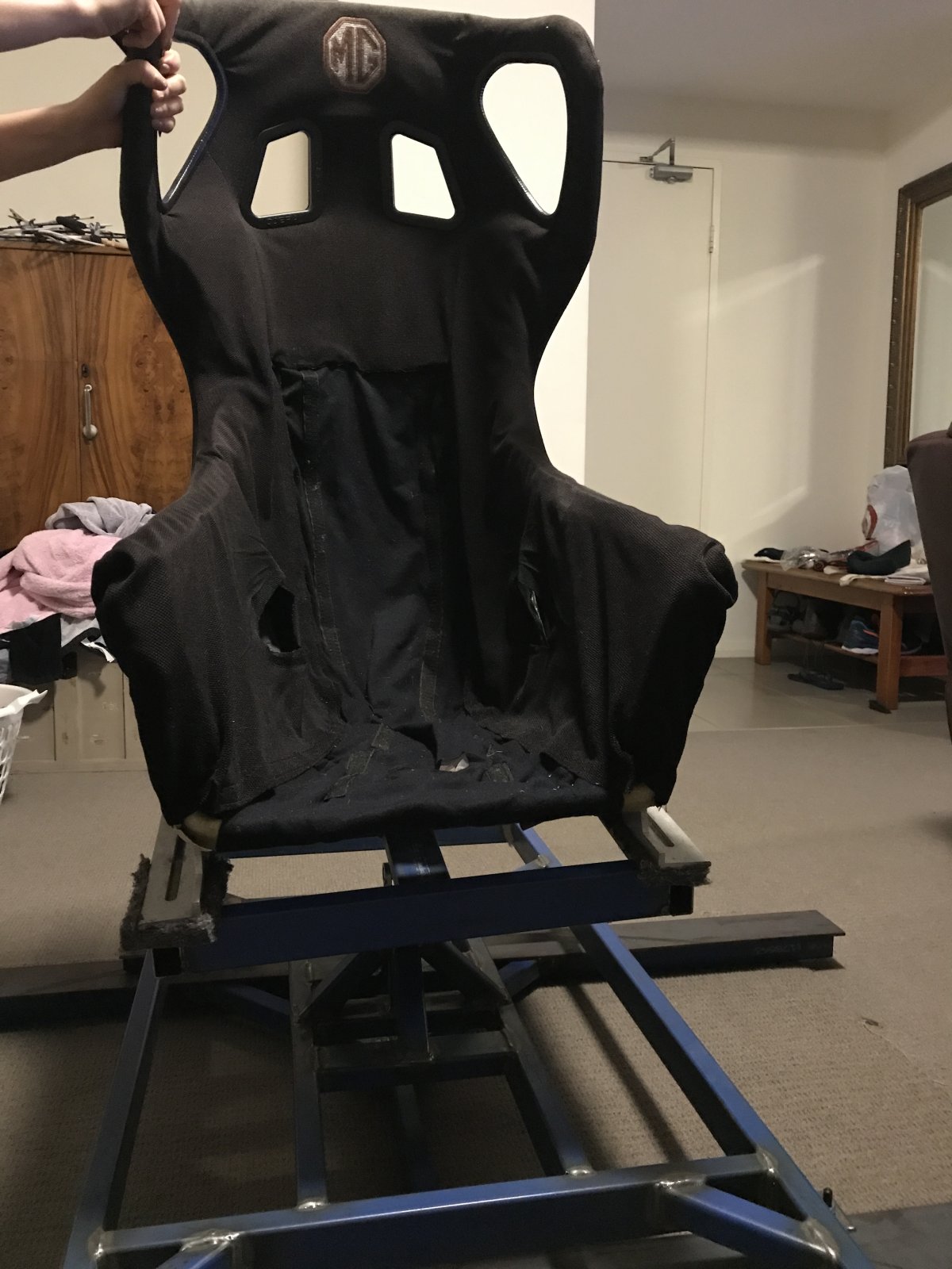

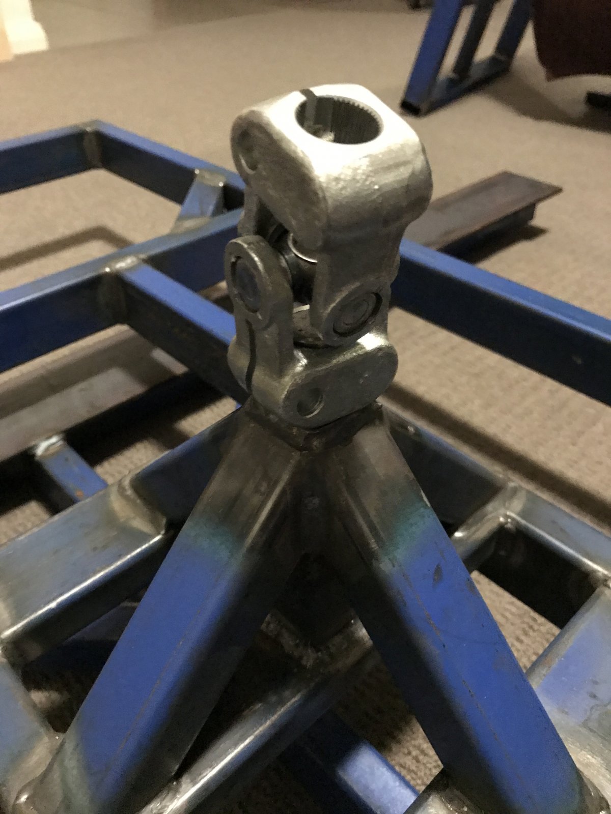

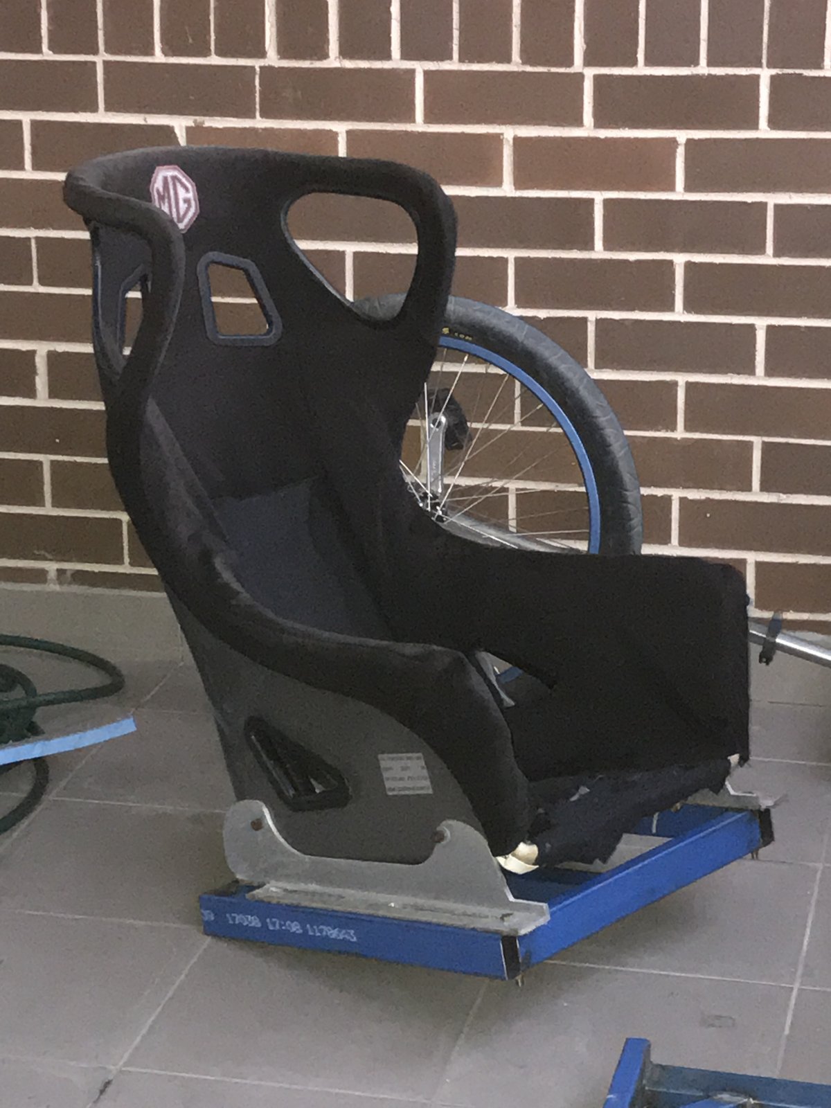

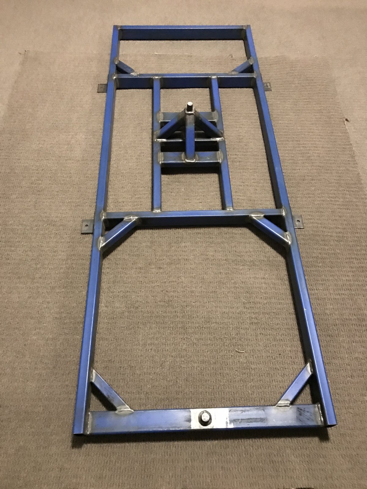

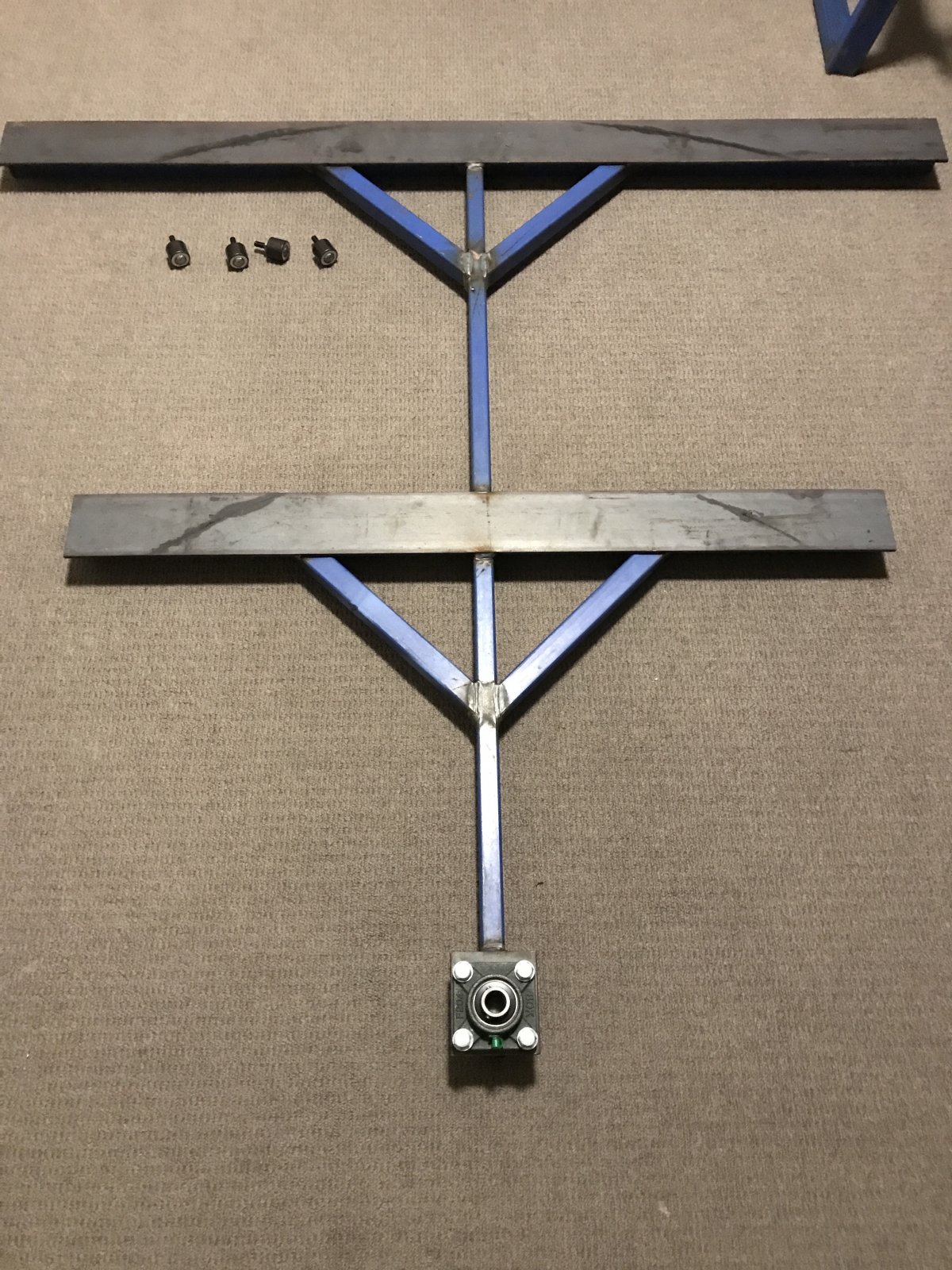

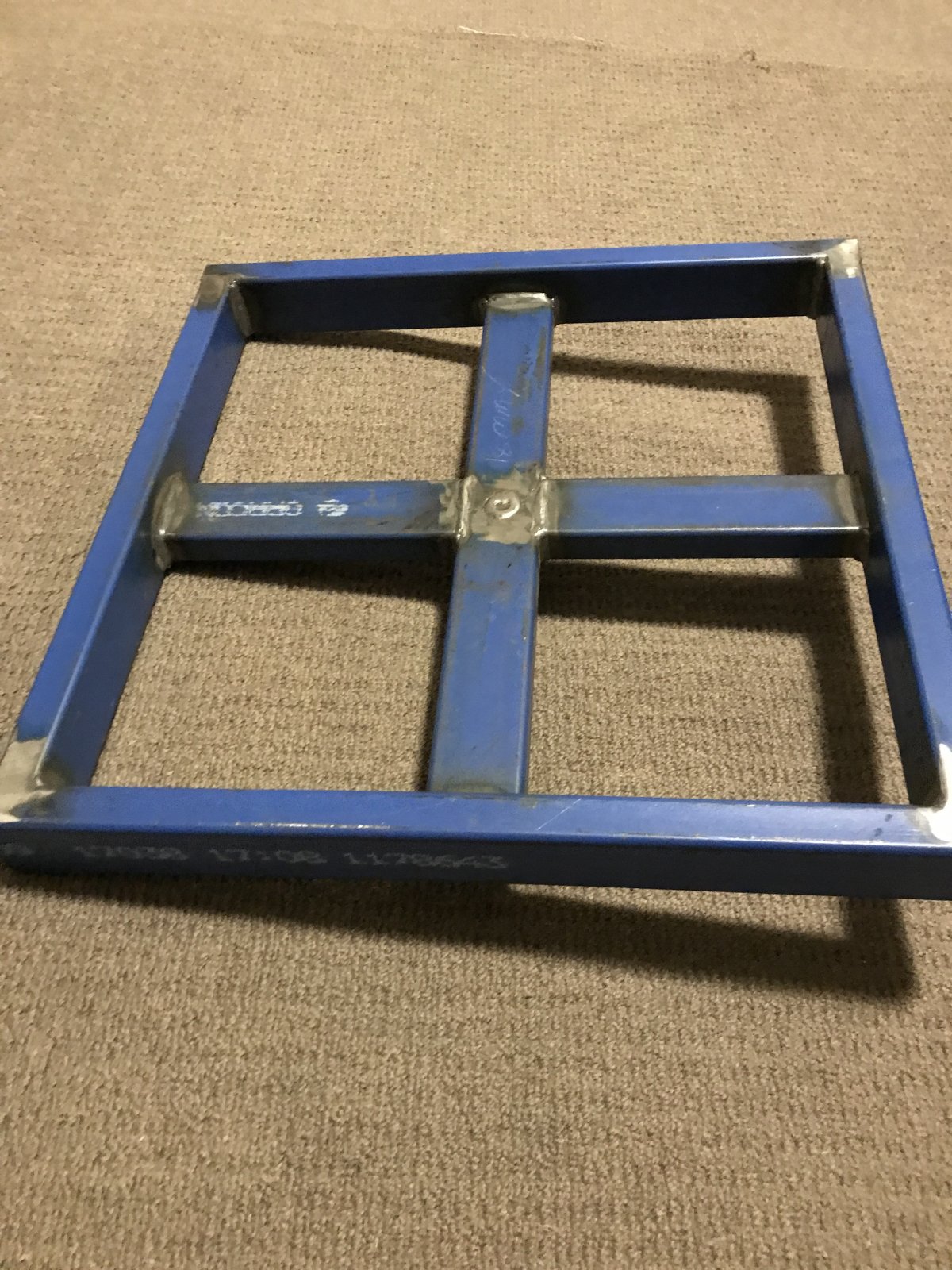

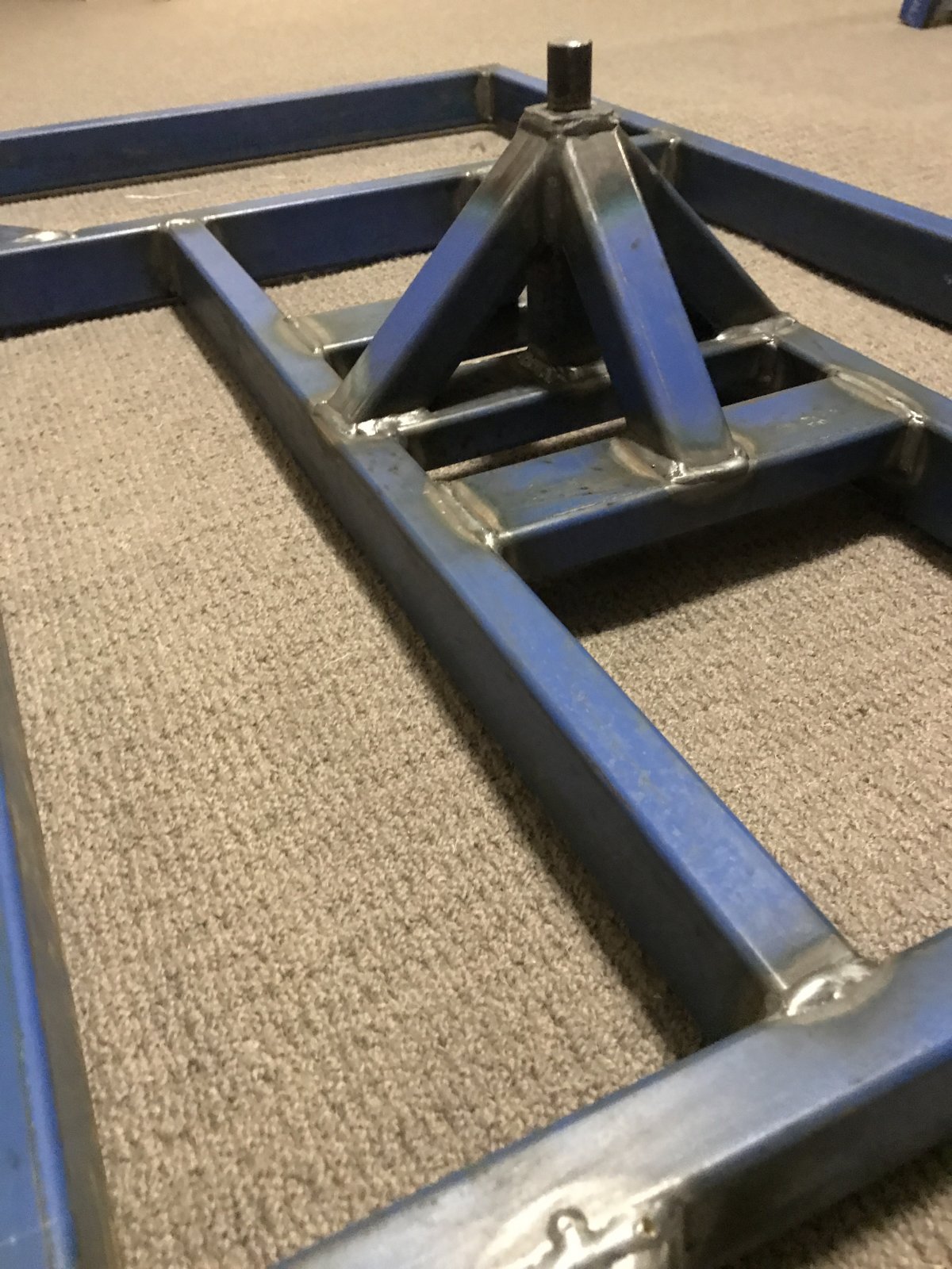

    Finally some forward motion.
    A local welder helper with my frame. I unlocked his inner child so he revised the frame numerous times as more ideas feel into his head
    My only considerations was the ability to come apart as I'm in a unit and space is at a premium with lift being the only access to my floor
    Some photos attached of the frame
    Intend to mount wood for motors to bolt onto.
    Also to use my Rseat frame for wheel and pedals until I can find some 8020 aluminum frame pieces

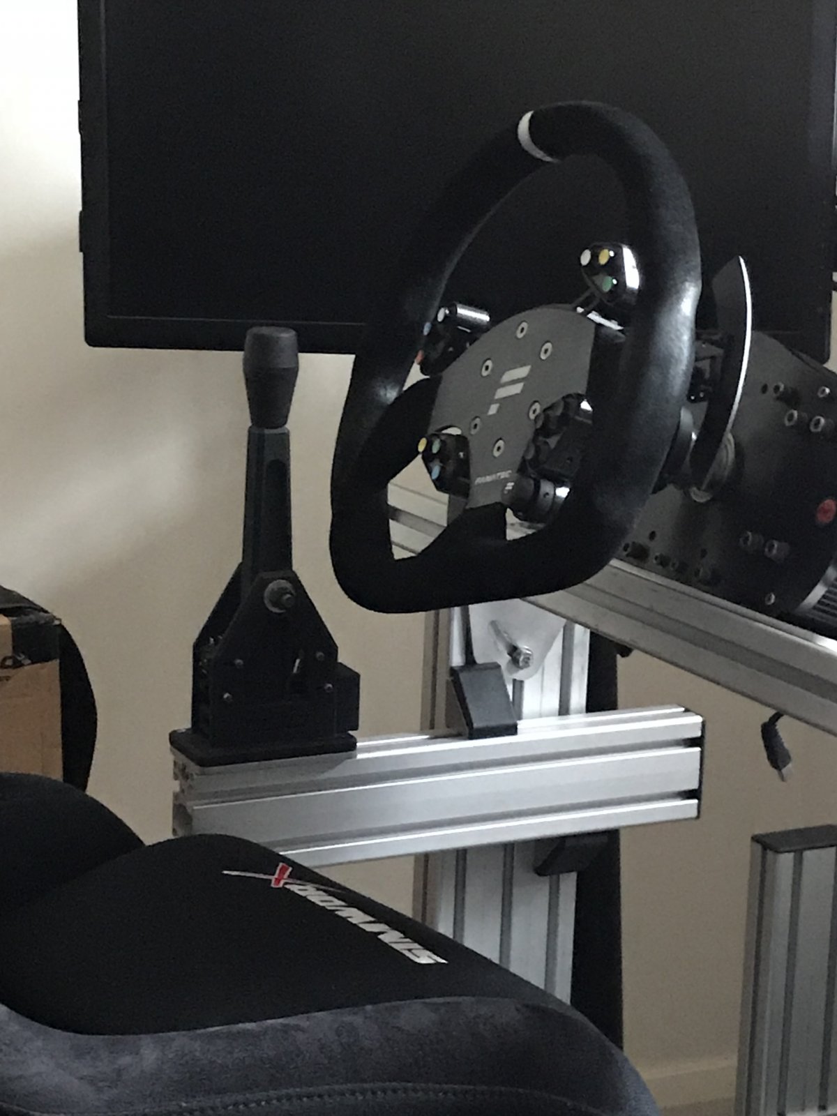

  4. Shyboy
    Shyboy New Member
    May 4, 2015
    20
    Campbelltown, NSW, Australia
    0Coins
    +17 / 0 / -0

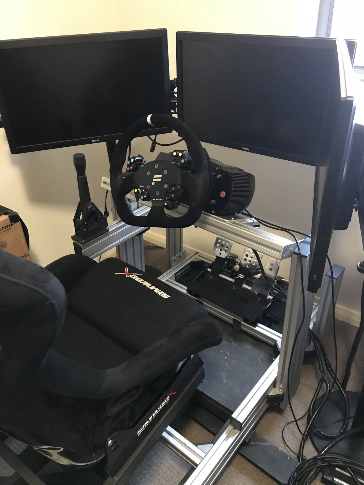

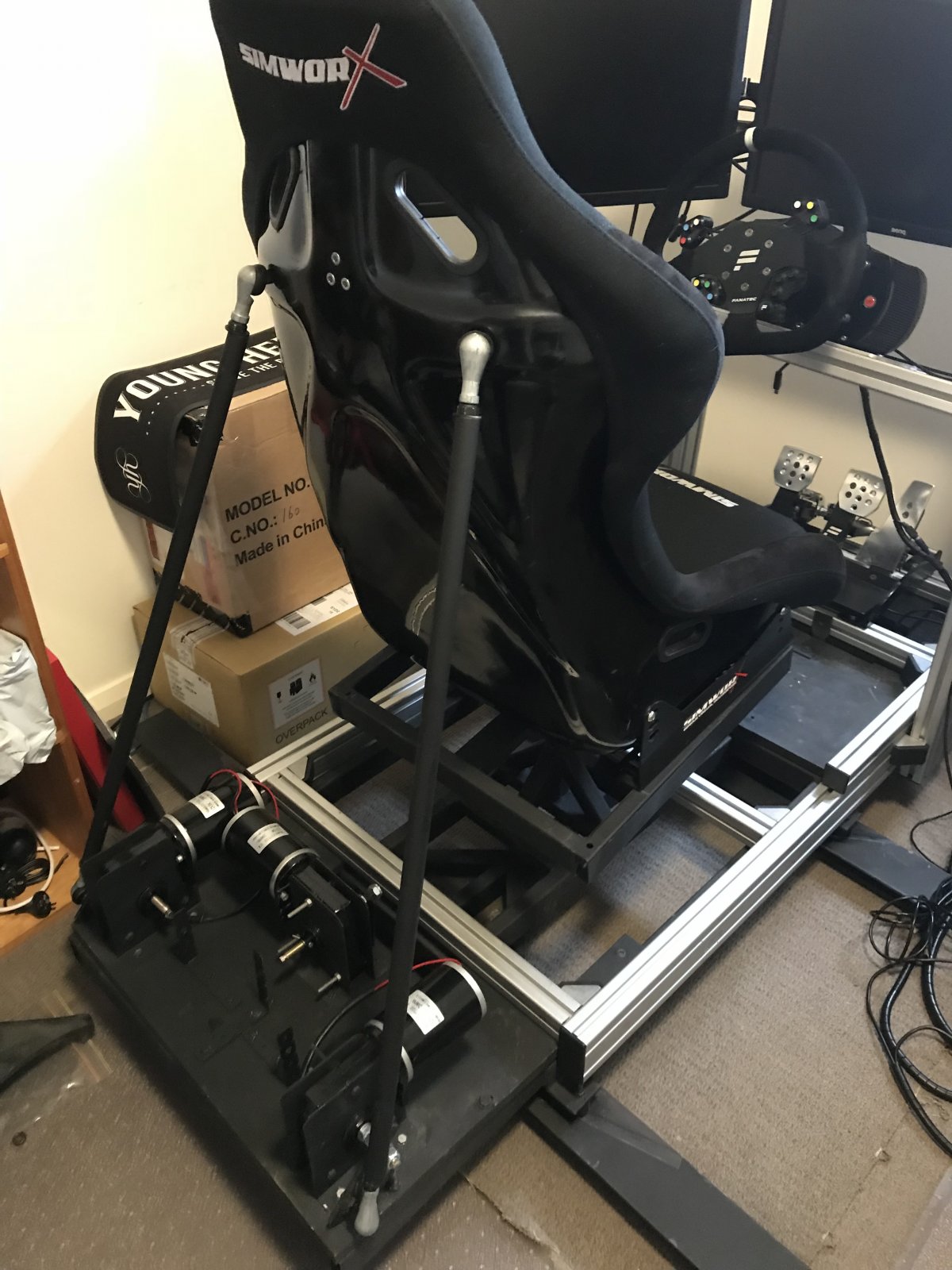

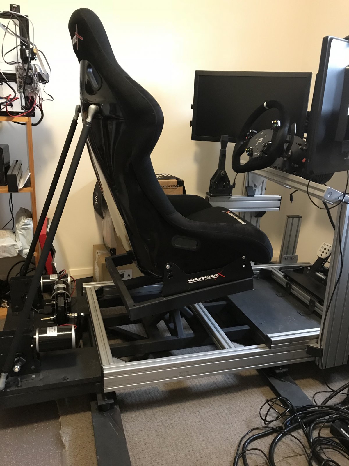

    RSeat base is gone and replaced by 8020 frame - very impressed with the solid setup
    This fitted on top of my metal frame for motion
    I have mounted the motors, attached the arms and now just need the electronics to come together
    Hasn't helped that I bought a Vive and that seems to take a little bit of my spare time :cheers
    Will update more once electronics are attached and working

  6. Brett Horton
    Brett Horton Active Member
    Aug 18, 2016
    310
    Program Manager / Pilot
    Tampa FL
    118Coins
    +202 / 2 / -0
    Looking good!
    One piece of advice, After I spent some time on my sim, the Middle lower leg (horizontal) could have been shortened to the extents of the caster "tracks". I was initially worried about the whole rig being top heavy, But mine is no where close to being top heavy. If I where to do it again, I would narrow the whole piece.

  7. Shyboy
    Shyboy New Member
    May 4, 2015
    20
    0Coins
    +17 / 0 / -0
    @Brett Horton Thanks for the tip.
    My other concern was the throw available with the traction arm as it now hits the lower horizontal frame.
    I've decided to limit the arm throw and see if that is noticeable (less TL throw) enough whilst in game
    Once all is set up I will be happier to fiddle a bit more
