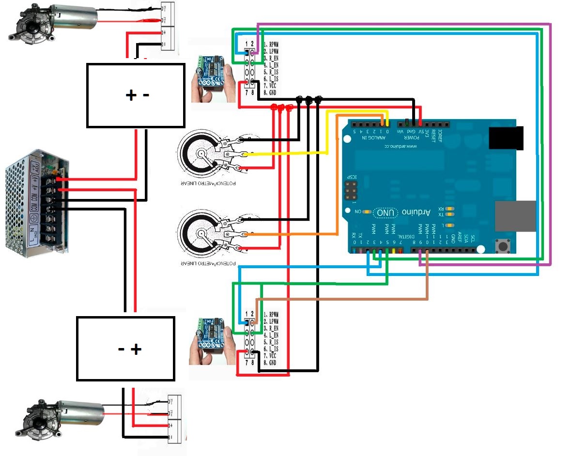

    sorry @noorbeast but i don't understand . this is the normal diagram
    Where is the connection from power supply to the battery in parallel or you mean something like the following diagram ?
    connection battery.jpg ?

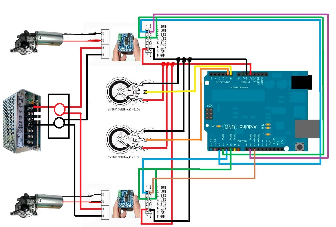

    20,539
    145,052Coins
    +10,777 / 52 / -2
    I meant like this:
  12. SuperMarioRacing
    SuperMarioRacing New Member
    Feb 5, 2018
    15
    sicily
    42Coins
    +10 / 0 / -0
    Ok. Now is clear. Thanks a lot
    so one only battery for 2 motors. ok
    I use 3 motors and 2 power supply (24v, 40Ah) in order to don't overload each power supply (for each power supply, max 2 motors connected) .
    So, I think I must use 2 battery (one for each power supply). Is it correct or in this case i can use only one power supply, connected to one battery, for all the 3 motors ?.
    Also, please, Is necessary to add protections or fuses between power supply and battery or from battery to ibt2 43A to avoid problem?
    From Ibt2 to motor, is necessary to use fuses or protections ?
    With the old motors i didn't use protections and never had problems but with this high powerfull motors i would want to avoid "risks of fire":):)
