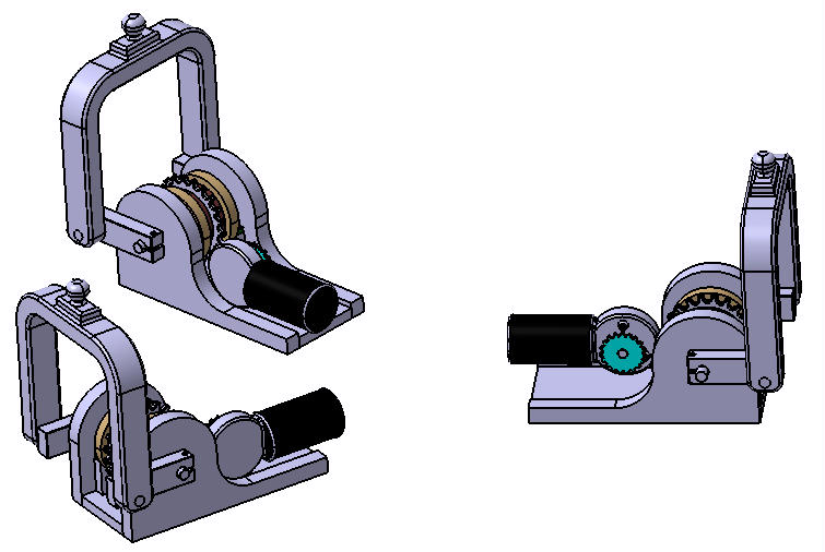

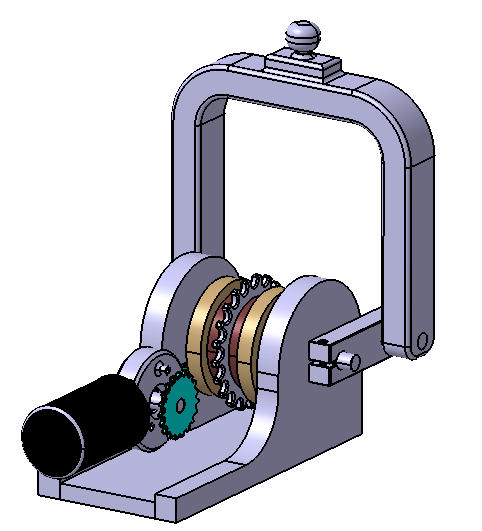

    Here is my idea of build...I designed these axis from CATIA...possible 4th dof for yaw in the future.
    3 DOF Wiper Motors.jpg Fwd (Pitch)

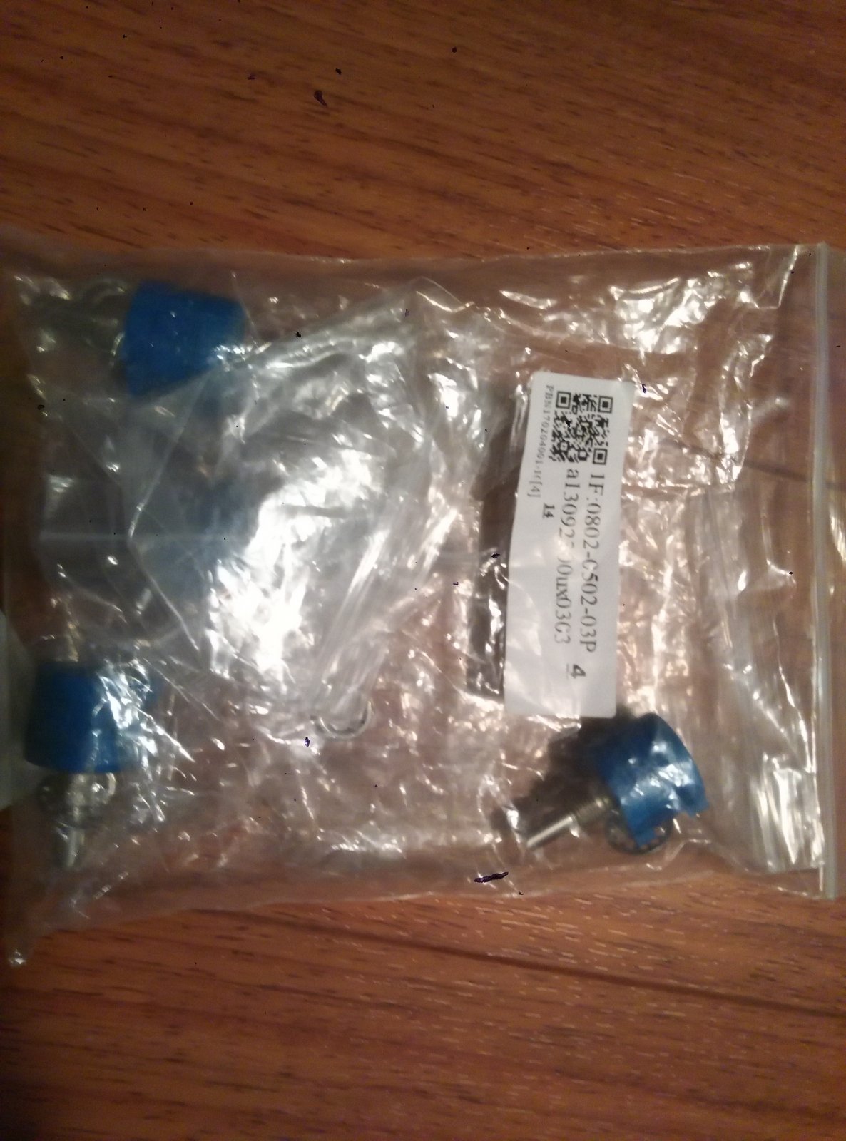

    It will be Chain driven Axis With Pot attached to gear on Wiper motor.
    10k pot

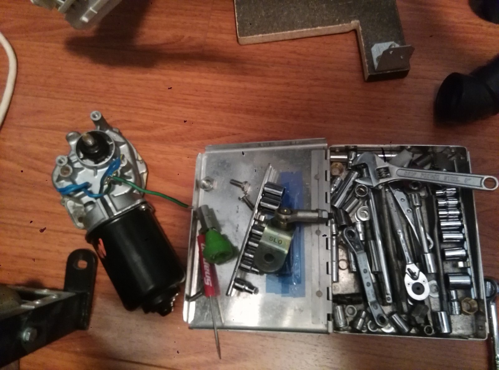

    Wiper Motors from 1st Gen 2 DOF sim

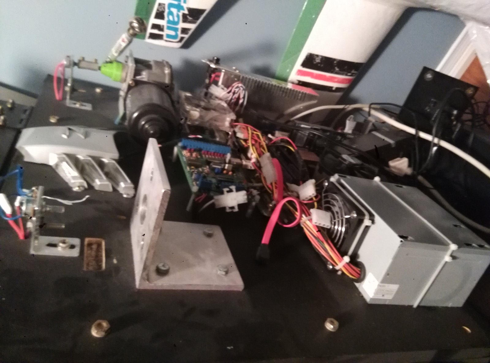

    Complete teared down of my 1 st Gen 2Dof
