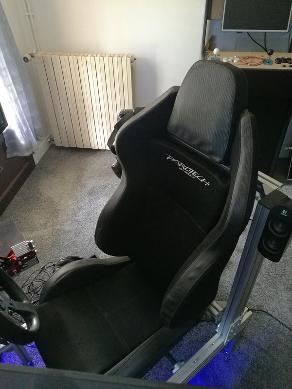

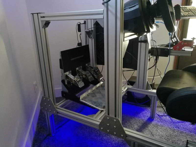

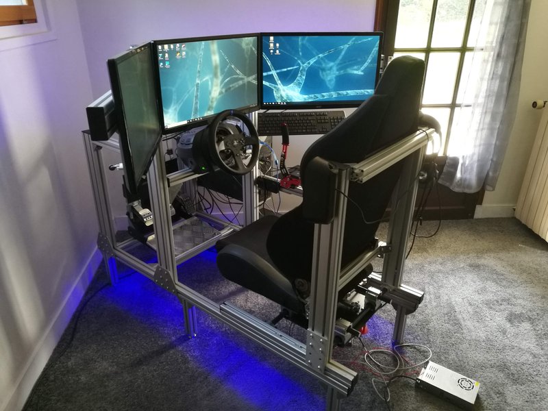

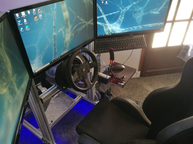

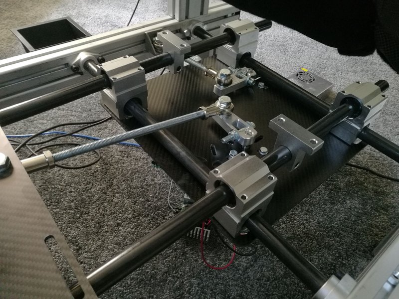

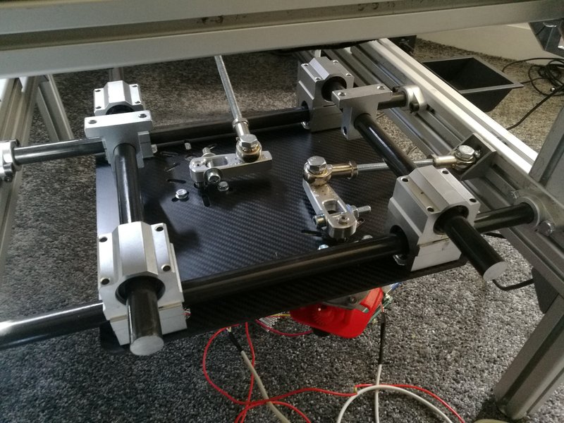

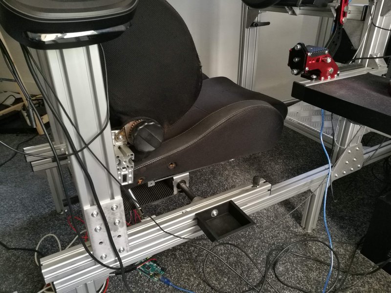

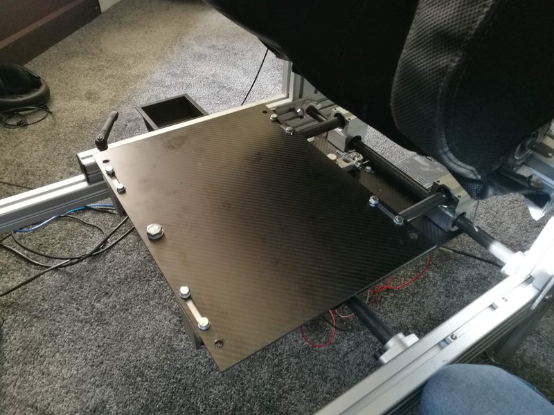

    I built a simulator with a concept different from what we can see usually.
    I used a race seat, that I separated in two parts. The top/back of the seat is fixed on the rig, while the bottom is mobile (sway & surge)
    Just finished the first test and it's very promising! I love the feeling and immersion !
    Especially the acceleration movement !
    Here are some pictures of my installation and 2DOF system.
    Under the seat:
    [​IMG] [​IMG]
    From the back of the seat:
    And some first test videos:
    Now I have to build a proper box for electronics and resolve minor play on the motor shaft.
