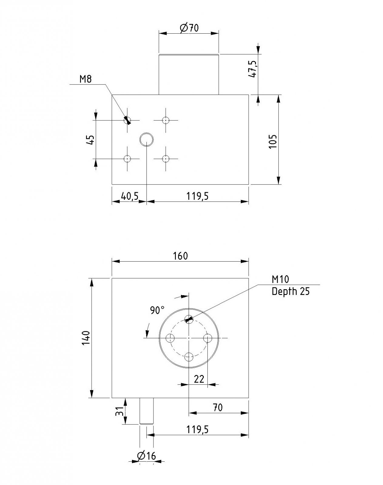

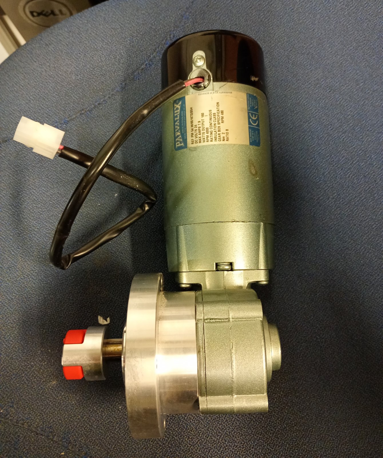

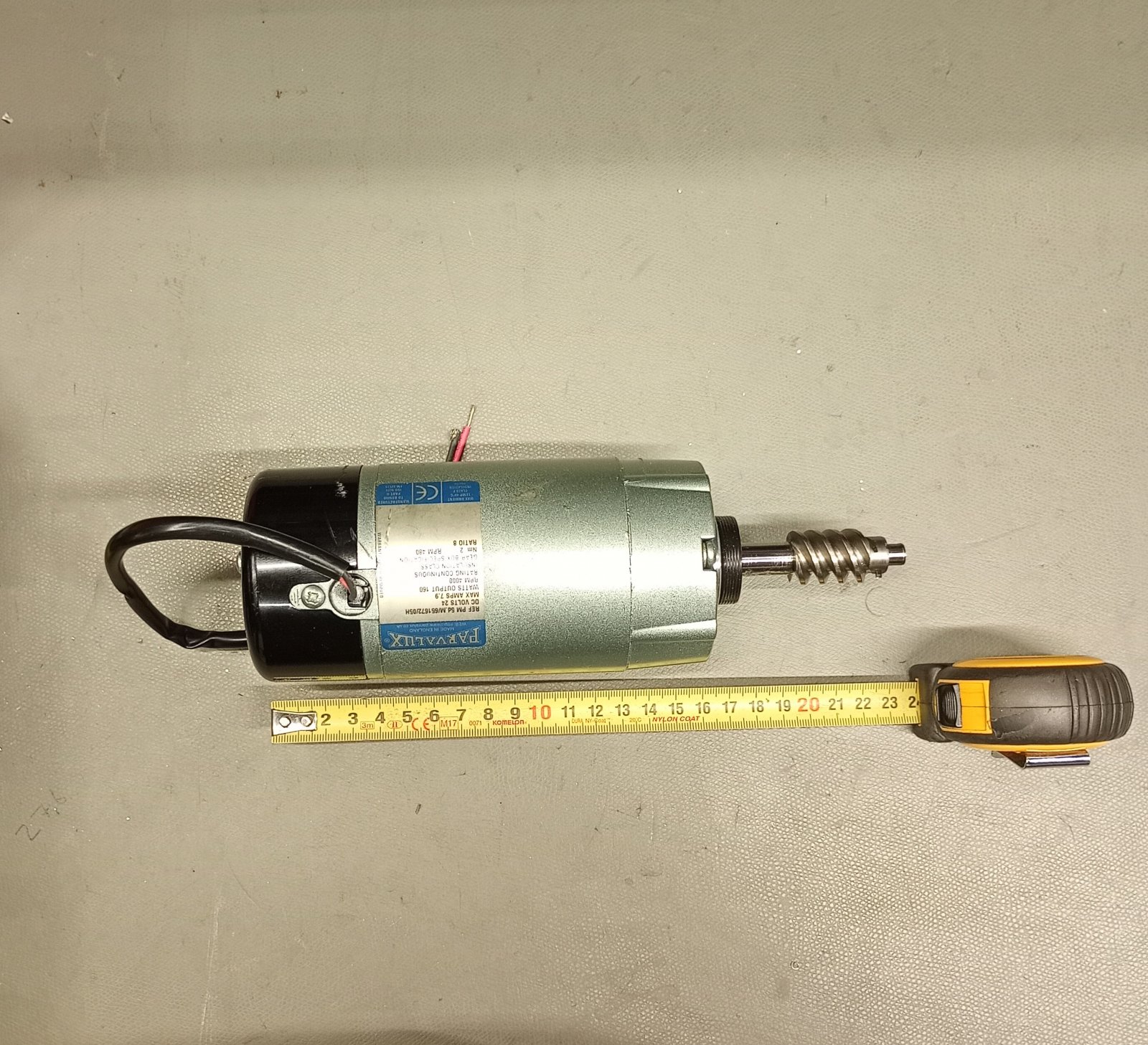

    Hi, I'm new here and just starting to build my first 2dof system. I have very strong industrial worm gear drive 1:51 and 160w 24v motor that also have 1:8 angle drive build in and out puts 480rpm. Motor it self puts out 4000rpm without worm gear. My question is should I take motors worm gear off and use that heavy duty industrial worm gear and get 78rpm out? If I would use them both as is I would get 9.5rpm and that do not work or am I wrong?
    My whole rig would be moving including wheel and pedals and maybe monitor that is 70" tv weights 20kg or 44 lbs

    The motor (according to the label) has 2 Nm or torque at 480 RPM. 20 Nm at 48 RPM is closer to what you need but still weak. 9.5 RPM is too slow to provide a satisfactory experience.

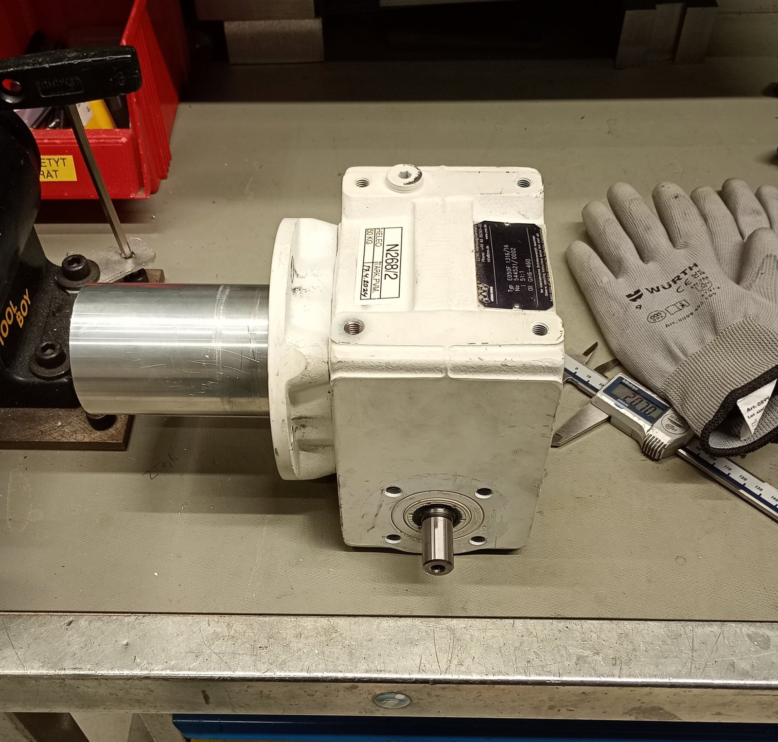

    I removed worm gear from the motor so now it puts out 4000rpm and if I now use that large worm gear that has 1:51 ratio, then rpm is 78. But how many newtons? I can buy new motors and that is no problem but I just would like to use those worm gears that I have because they are really heavy duty so they would last for a life time.

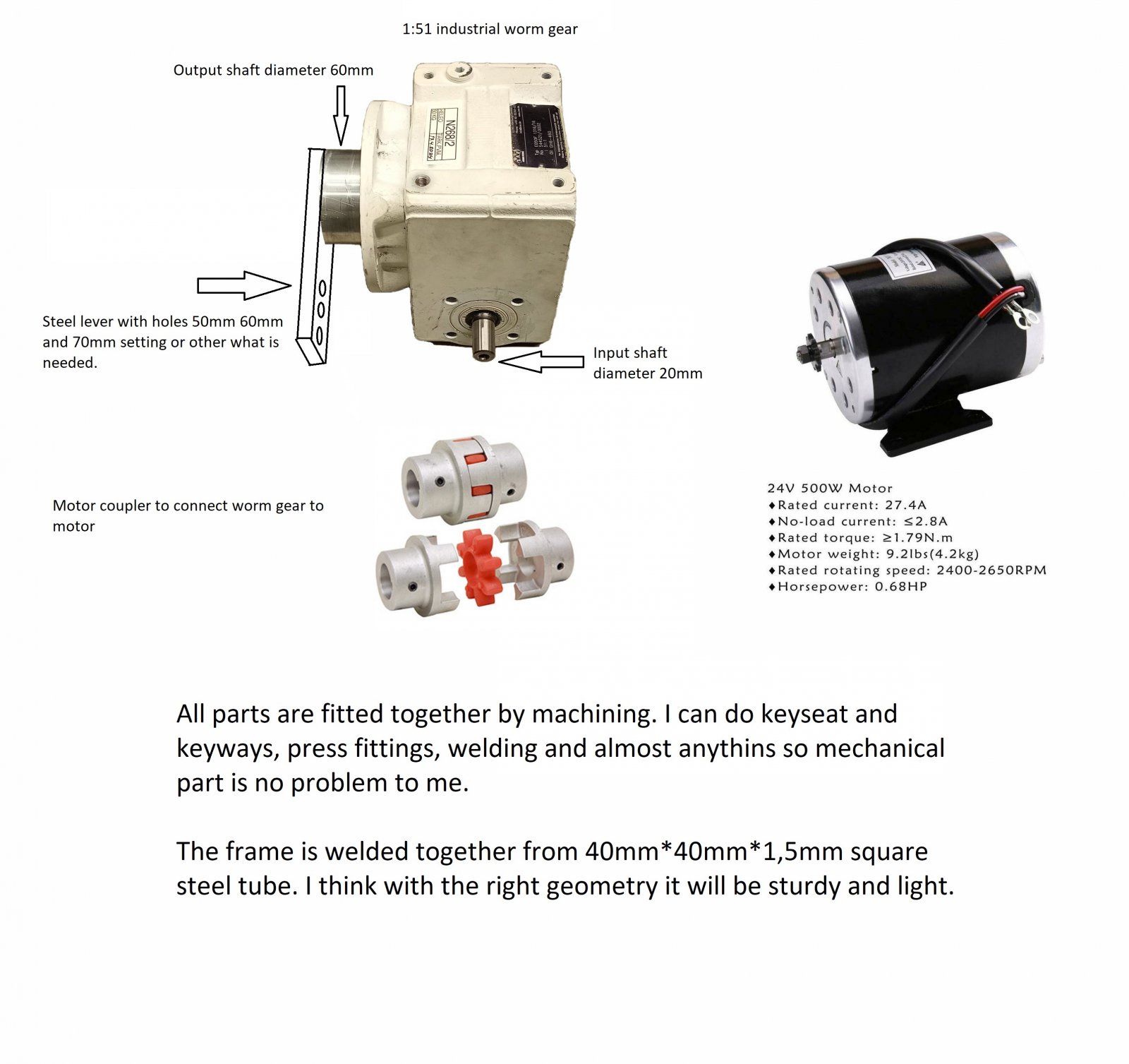

    I think I'm gonna use MY1020 24v 500w with my 1:51 worm gears. Another option is MY1020 24V 350w if that would be better from the motor controller point of view. Can someone tell me what kind of controller would be sufficient in either case? It would also be interesting to know if there is anything bad about these motors for this use.
    I'm pretty sure the 70" TV isn't on the rack, just the bench, steering wheel, and pedals. I would be very grateful if someone could give me answers to these questions and I could get started on my project. My plan for the frame is to welded a tubular frame that is 40*40*1,5 mm steal square tube.
    Those motors are for electric bikes and sold in ebay, Alibaba and such places.

    I really would like to try these 500w motors if there is motor drivers that can handle 27,4A current. Torque would be 91Nm at 1:51 ratio! Maybe this is asking for troubles :D
    From what I looked at the power supplies don't cost much. 24V 30A 720W cost around 50$/each.
    Of course, it is not wise to oversize too much if the need for power is not going to be very great.

    No. I would attach worm gear to the motor. These motors don't have gearbox. I would use axle couplers that I already have. You can see that worm gear in my first post.

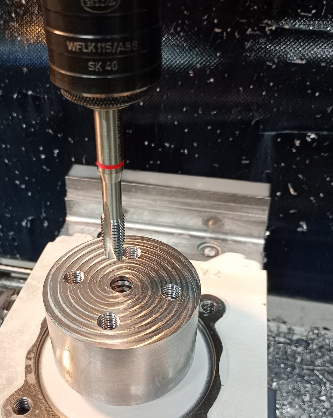

    Actually it is 60mm aluminum shaft that's attached worm gears output shaft with keeway but it is so hard attached that I didn't get it loose so I'm making 3 pcs M10 threads in it to attach lever. That will hold:D

    What do you think about that 500w motor? There is 350w version too but I thought that 500w gives sharper movements and it has an extra reserve available if needed.
    Lord only knows how much peek current that 500w motor takes in actual use... depending rigs weight and balance but I think that 100A controller will manage it.
    On the other hand, the Chinese may tend to overestimate the power of their motors. I have an excavator bought from China with a nominal weight of 2000kg and a real weight of 1700kg. Sales tactics are their specialty, regardless of what they are selling.

    I would opt for the 500w. Then if you decide on a different configuration in the future it may still be viable motor.
    I have used the cheap ibt-2 controllers for three years and they drive the motors fine until they don’t. So for $42 you could buy 8 of those at Amazon but to be fair they are single channel.
    Recently I bought the single channel version of the eBay one and it melted the power supply or coincidentally my power supply melted shortly after plugging this in. Worked for awhile but is suspect because it seemed to not recover after I removed 24v power. The ibt2 I remove 24v often and sometimes if there is a problem removing the 24v fixes it.
    My lever arm is secured with two M6 bolts but it’s all steel. I don’t know how the aluminum will fair but 60mm should drive a backhoe.
    I bought a slide hammer to remove the key ways from my shaft. Now I don’t worry so much about pounding on them.

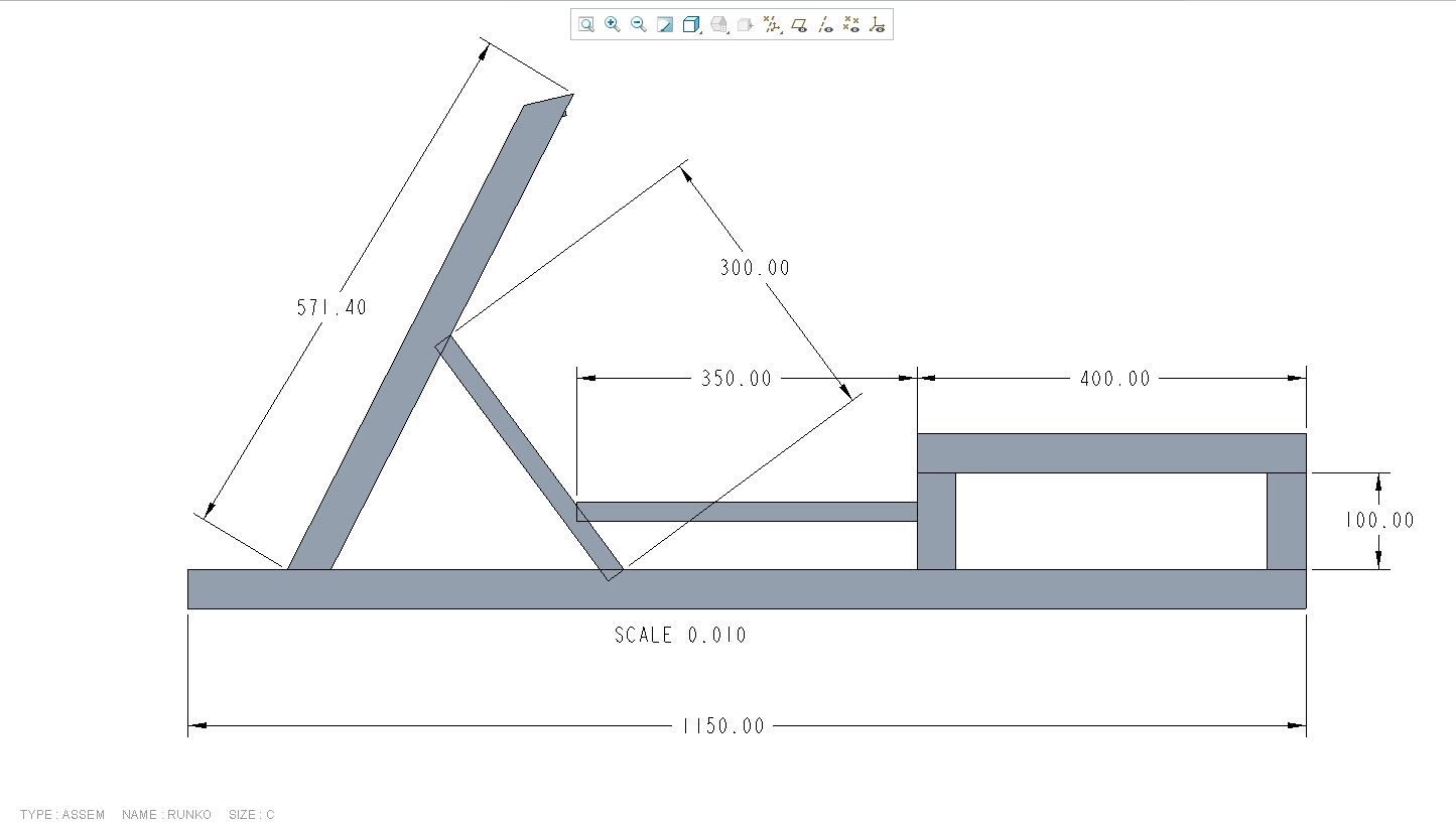

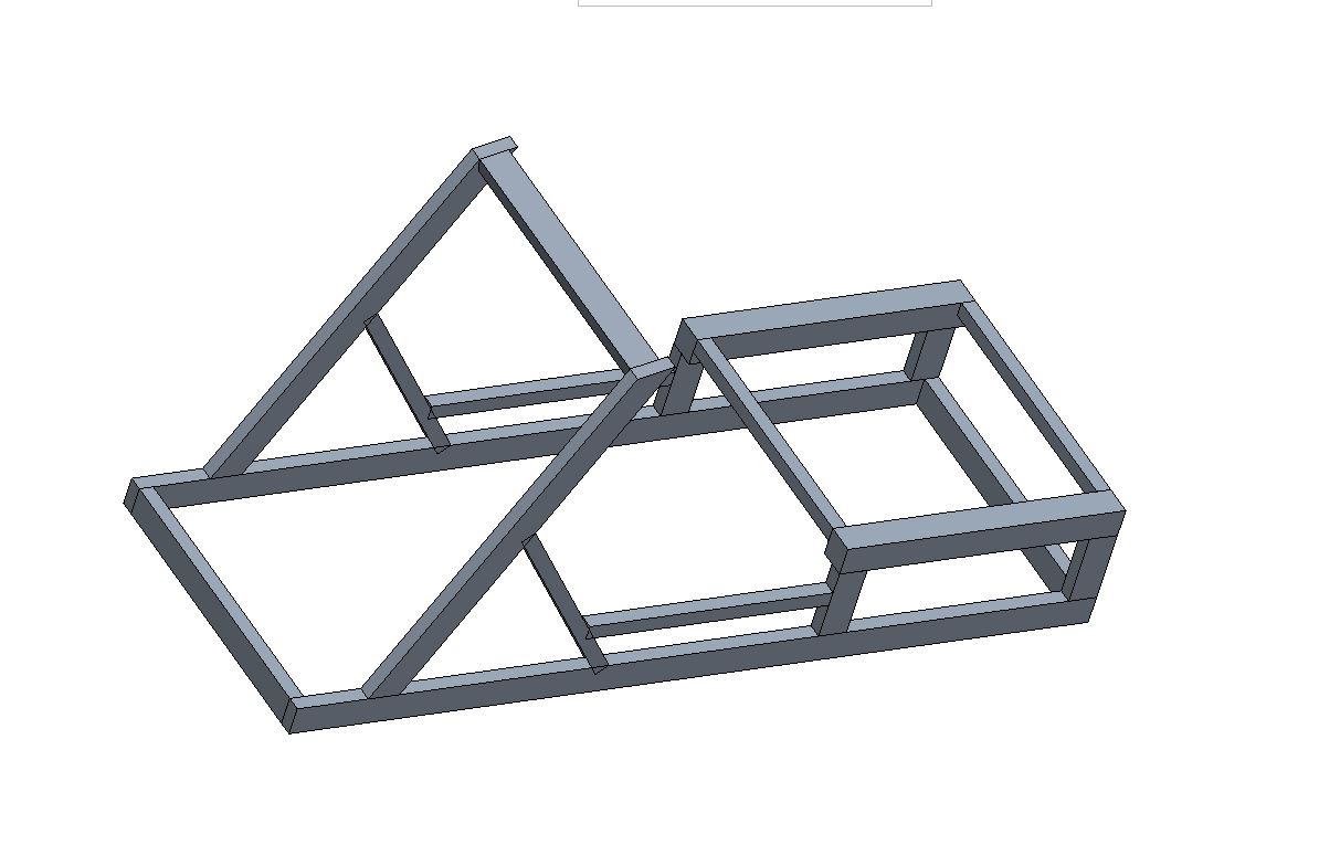

    Little by little, progress is being made. M10 threads done and the frame sketched. Should start welding the frame this weekend. The draft of the body is partly valid but some points will change.
    The pipes used are mainly 20mm*40mm steel with 1,5mm wall thickness. Under the bench will be 2 pieces of 40mm*40mm* with 2,0mm wall thickness. Support structures will be 20mm*20mm with 1,5mm wall thickness. Interesting to see how lightweight it will be.
