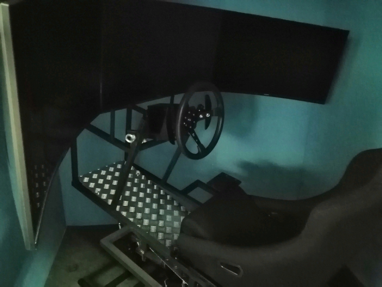

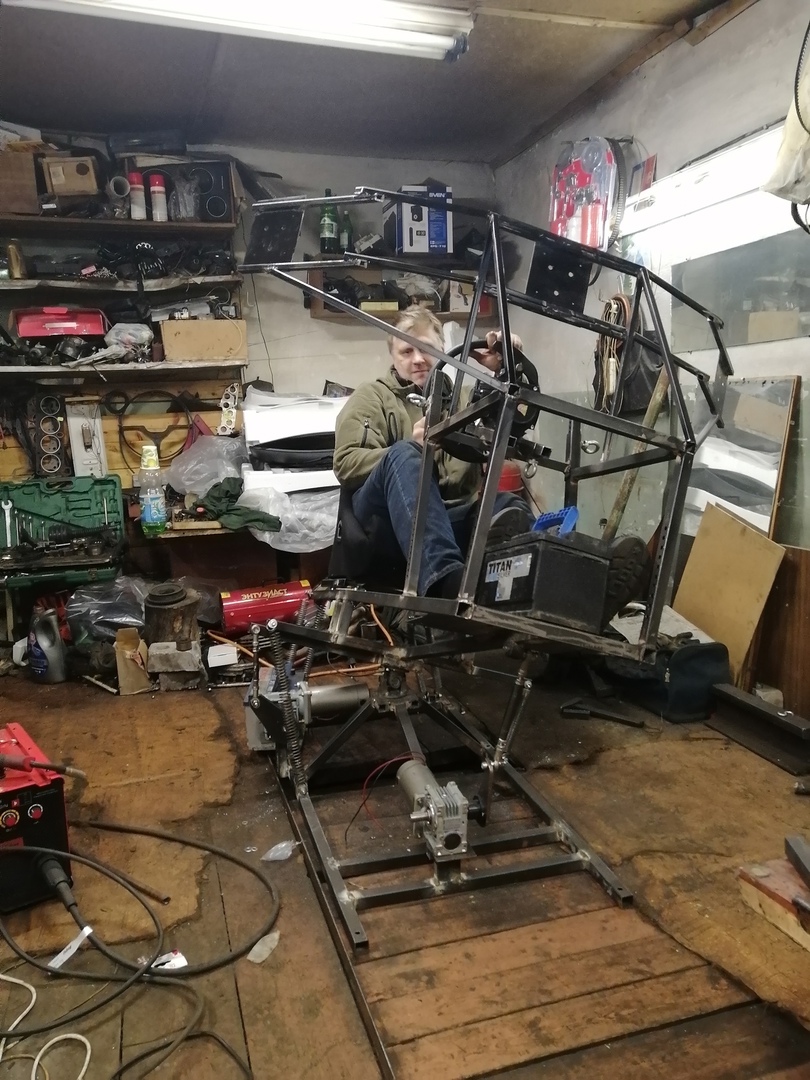

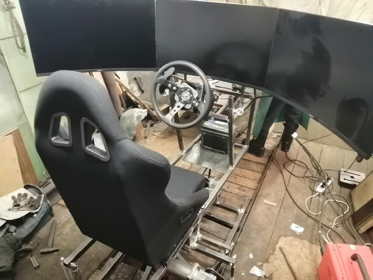

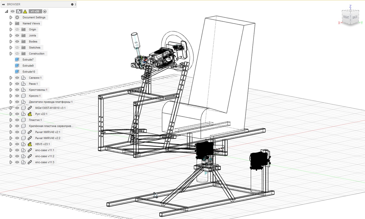

    2DOF simulator.
    Wheel: 130ST servomotor + MMOS

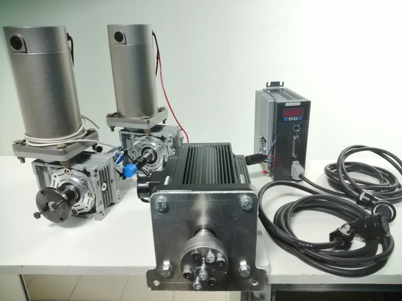

    Motion: 2x450 watt NMRV motors
    Handbrake: magnet based.
    Shifter: FFB shifter (vibration - just one secondary function).
    3x32'' Samsung Odyssey G3 displays.
    Pedals: Hall and LC-module.
    Some iron :)
    Source 3D model. Later the motors was moved to other places.

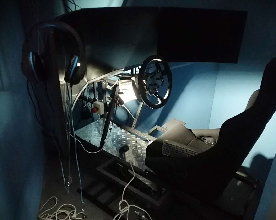

    After paint:
    sLfyl_aIv5GKKMmRhTRDZ4iwPPCJ4znmvEJ0actCX0hFZgW15zGGdgshrZuXtKvo6mGjMkEpGanB8DdxqJybLkpK.jpg Общий вид.png
    Motors:

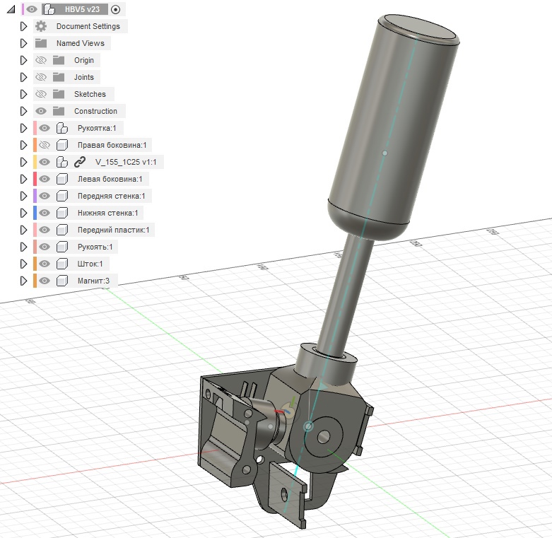

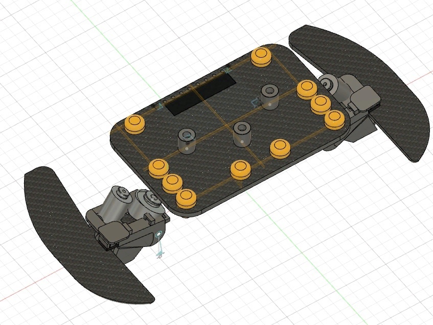

    Wheel: Rally wheel from Aliexpress + DIY magnet shifters.

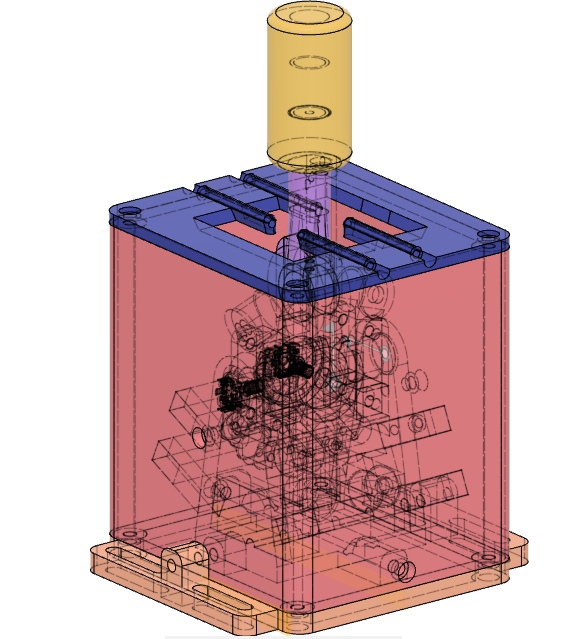

    FF shifter:
    Handbrake. FFB-version - later :)

    Motors: https://aliexpress.ru/item/4001350295051.html?sku_id=10000015769731604
    Driver: https://aliexpress.ru/item/1005003379631297.html?sku_id=12000025507667763
    (IBT_2 burning out for less than one second with this motor).
    Simtools. And a bit modificated SMC3 firmware. I used precision potentiometers with 1000 degrees work zone. So default SMC3 firmware need in correction. Also I added the potentiometer filter to SMC3 (typical averaging).
    Handbrake - nothing extraordinary. Just different vibration level depends on axis level + car motor rpms taking into account.
    Shifter - I like drive with manual shifters and hate when I can select the gear without clutch pedal. Shifter taking into account clutch status, data from sim. Vibrations (car motor rpms and wrong gears shifting) and it do not keep the stick if sim didnt confirmed successfull gear shift. Also shifter holds the stick without clutch pressing.
