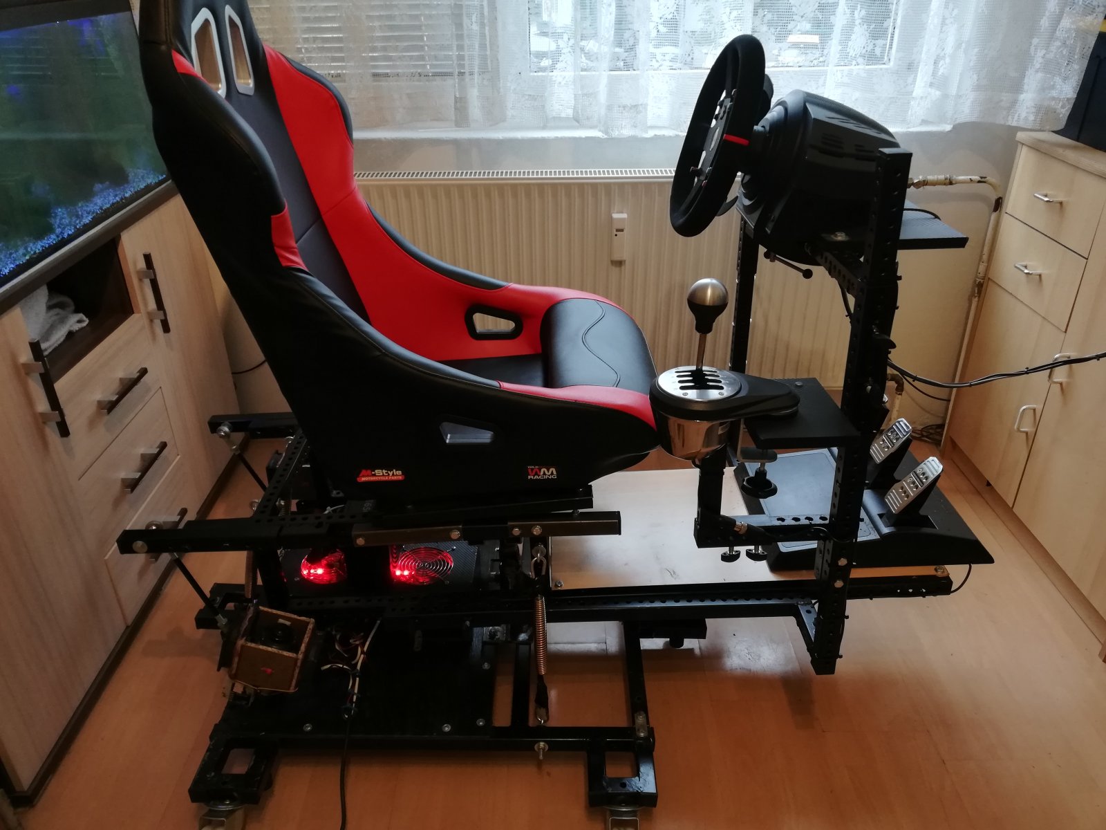

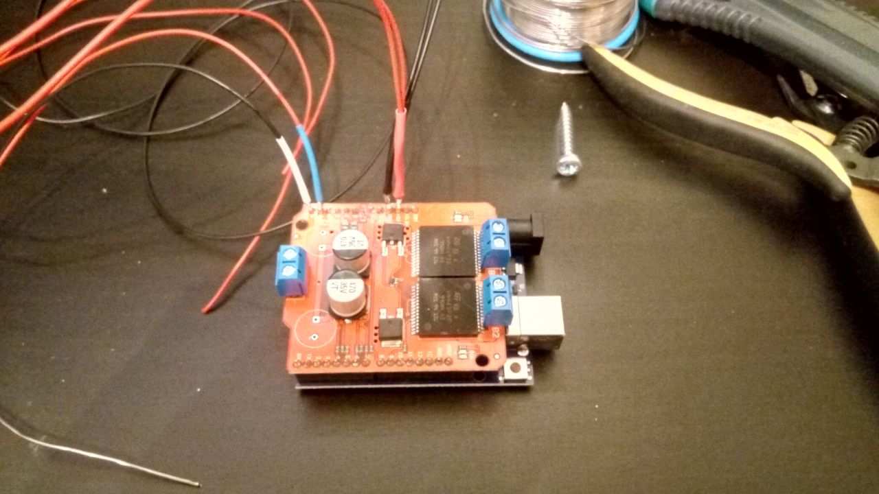

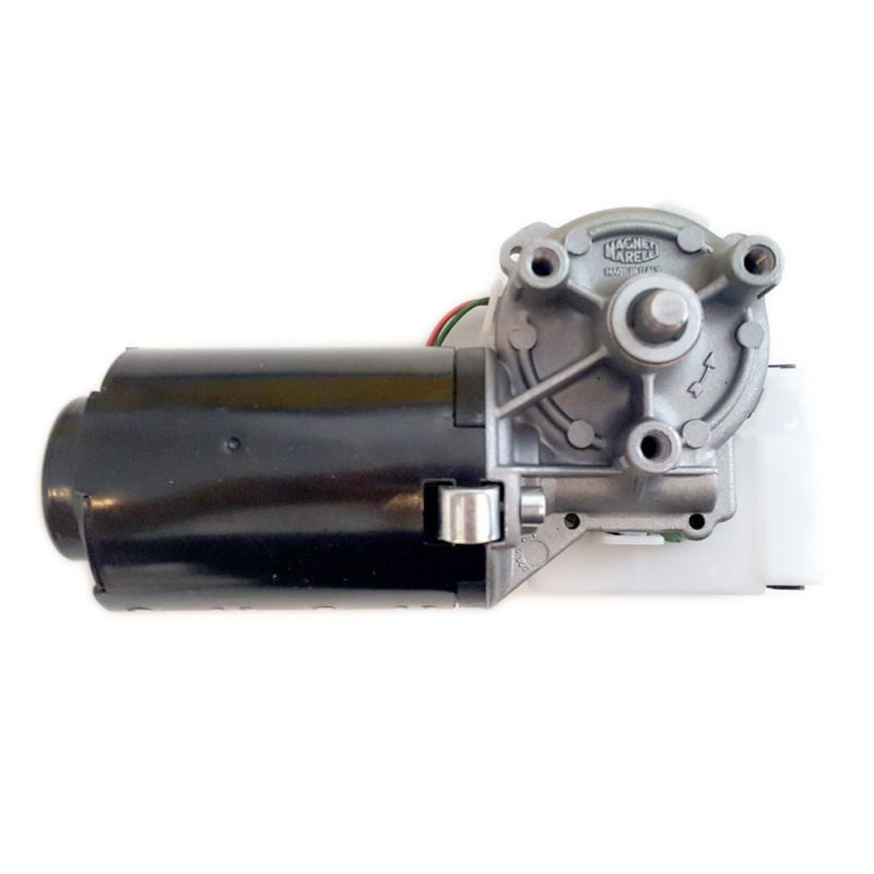

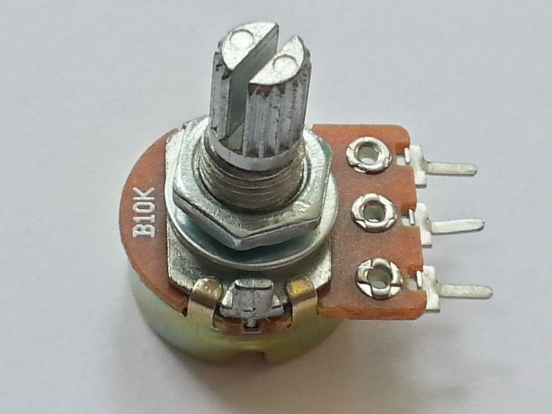

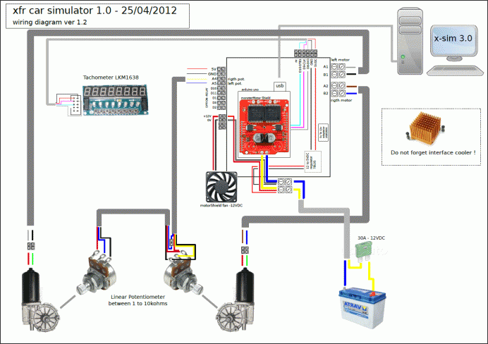

    Hello everyone,
    After lots reading and watching everithing about simulator i start the project 2dof arduino+moto monster shield.
    All parts for project:
    i start with electronical conennction with this wiring

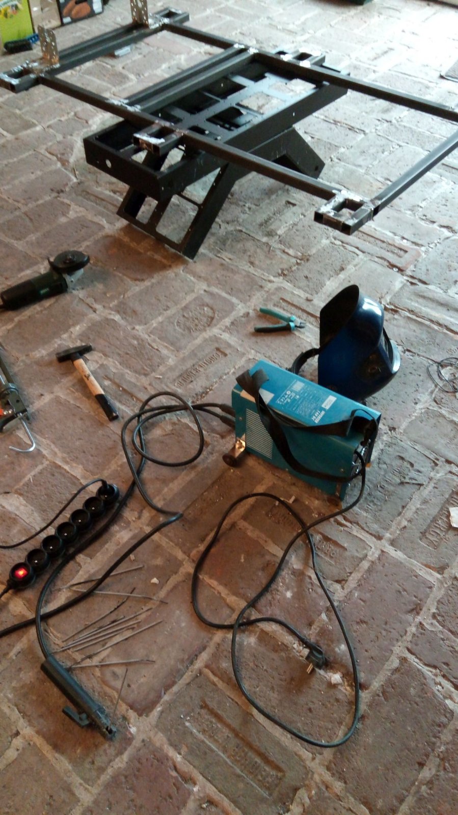

    test was good soo made box for everything :)
    electronic is ready soo build seat :)

    I have problem with motors now i dont knows what could by wrong i change lots of potenciometers and read forum and nobody have this problem maybe somebody can help or any idea?

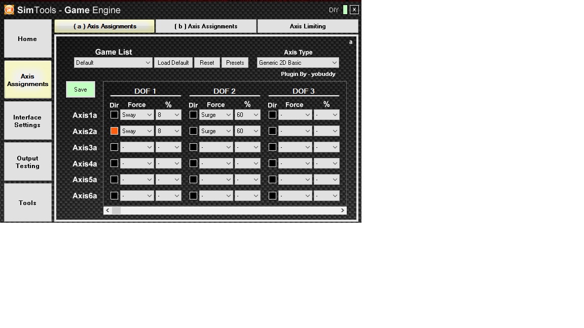

    Can you please provide a better explanation of what we are looking at in the video and post pictures of all of you settings.
    Is the motor not responding only when under load, as you posted an early testing video with them responding to a game?

    the motor doing this all the time if i driving straight ahead left side and right side its like on the video for arduino i use code from RacingMat https://www.xsimulator.net/community/threads/2dof-arduino-simulator-with-rear-wipers.4897/

    But the motors responded correctly in bench testing when they were not under load, is that correct?
    And can you please post pictures of all of your settings.

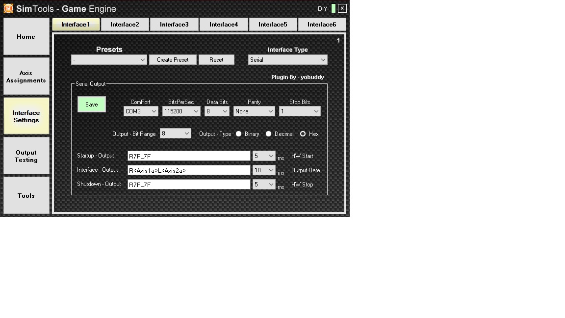

  8. sudca
    sudca New Member
    Sep 25, 2017
    18
    Slovakia
    36Coins
    yes everything works good only this is problem engine doit this a make picture now and put here and thank you for answer :)
  9. sudca
    sudca New Member
    Sep 25, 2017
    18
    Slovakia
    36Coins
    here is picture but engine doit this without simtools too if i just connect and seat on the sim that engine doit this maybe i am to heavy for that :) :)

    i trying doit without balance but is nothing change maybe i have somewhere mistake ....

    and power supply should by strong enough 12v 50A

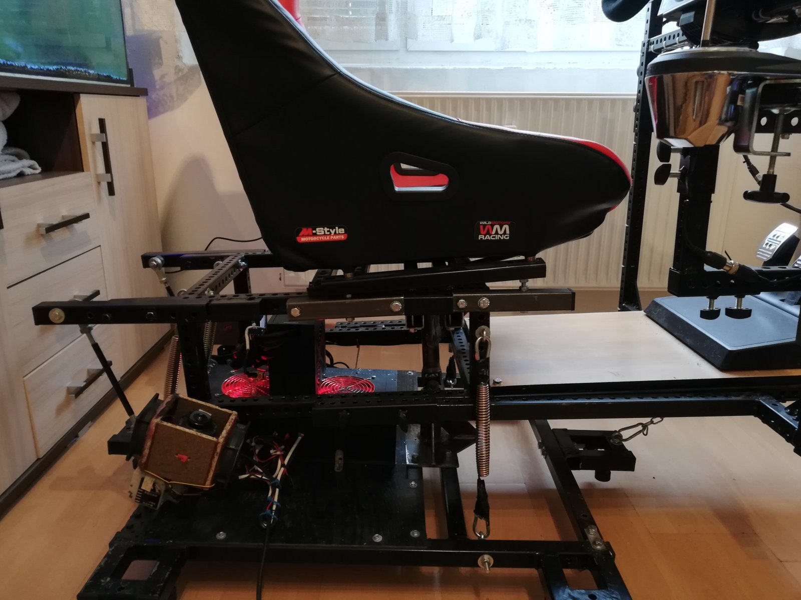

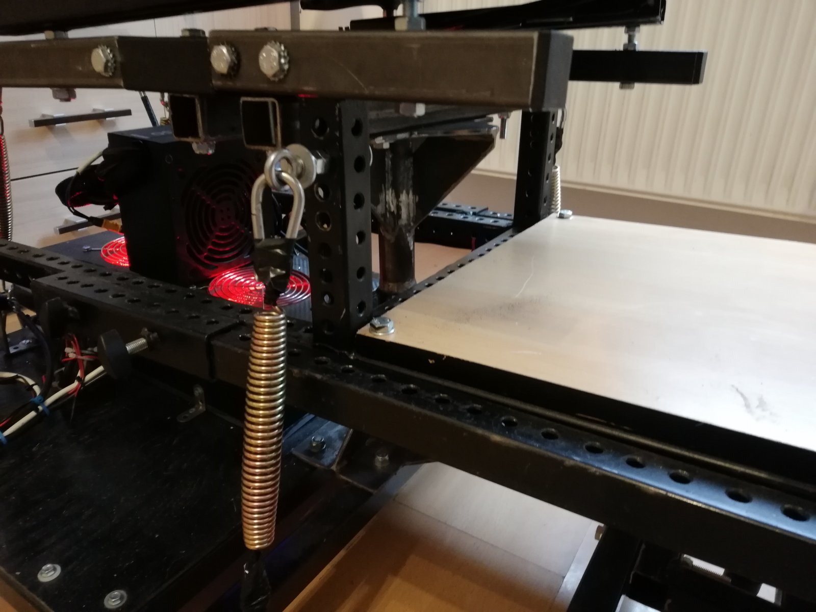

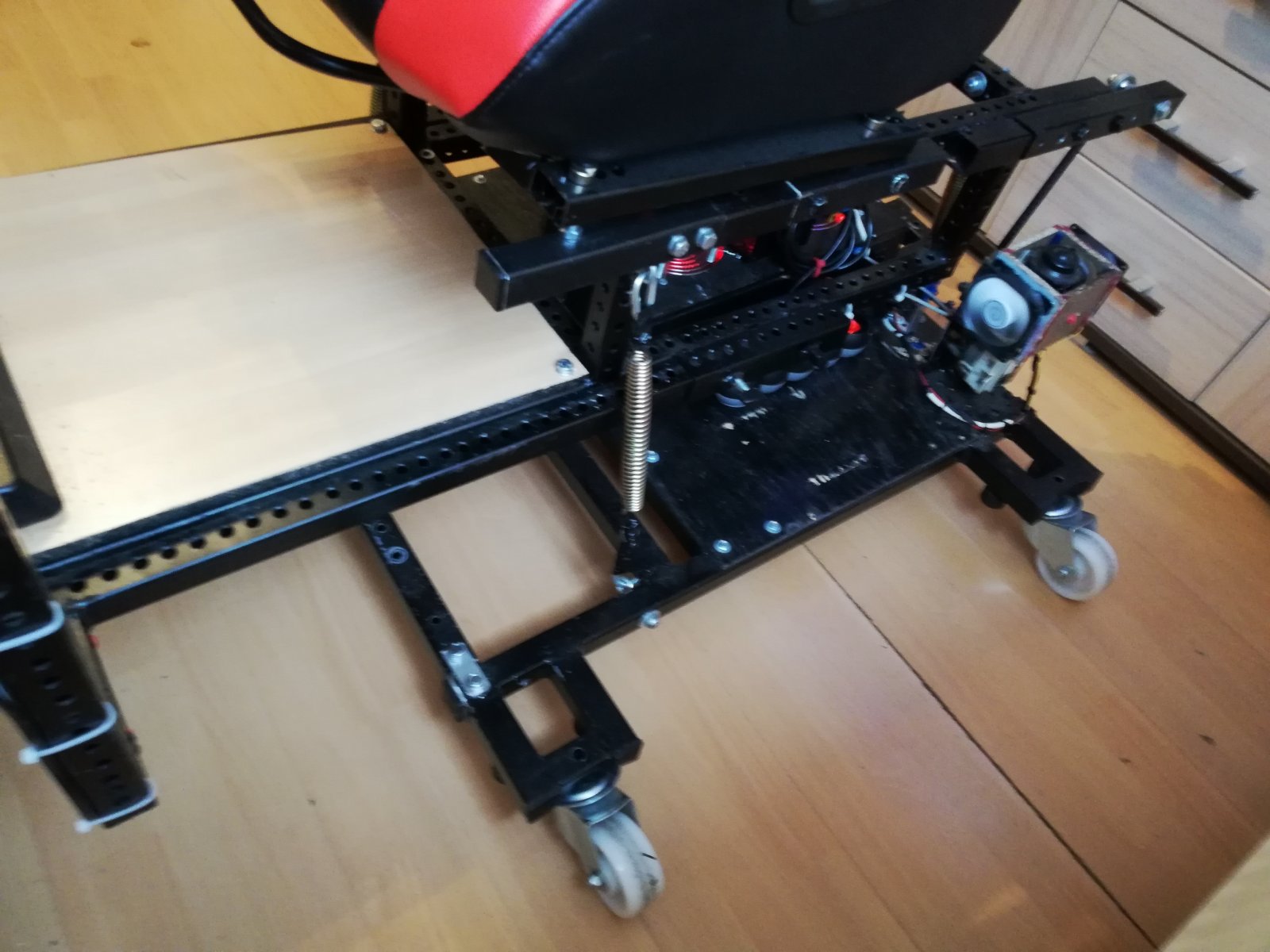

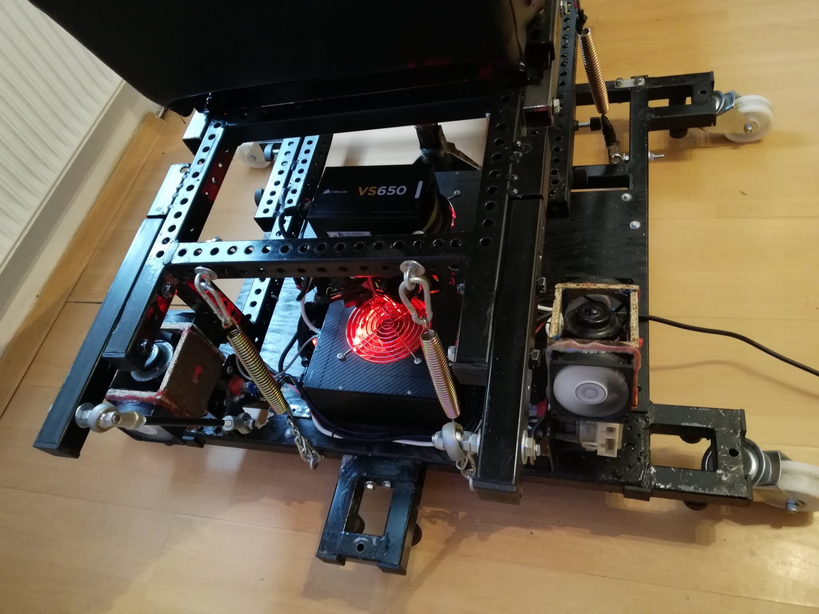

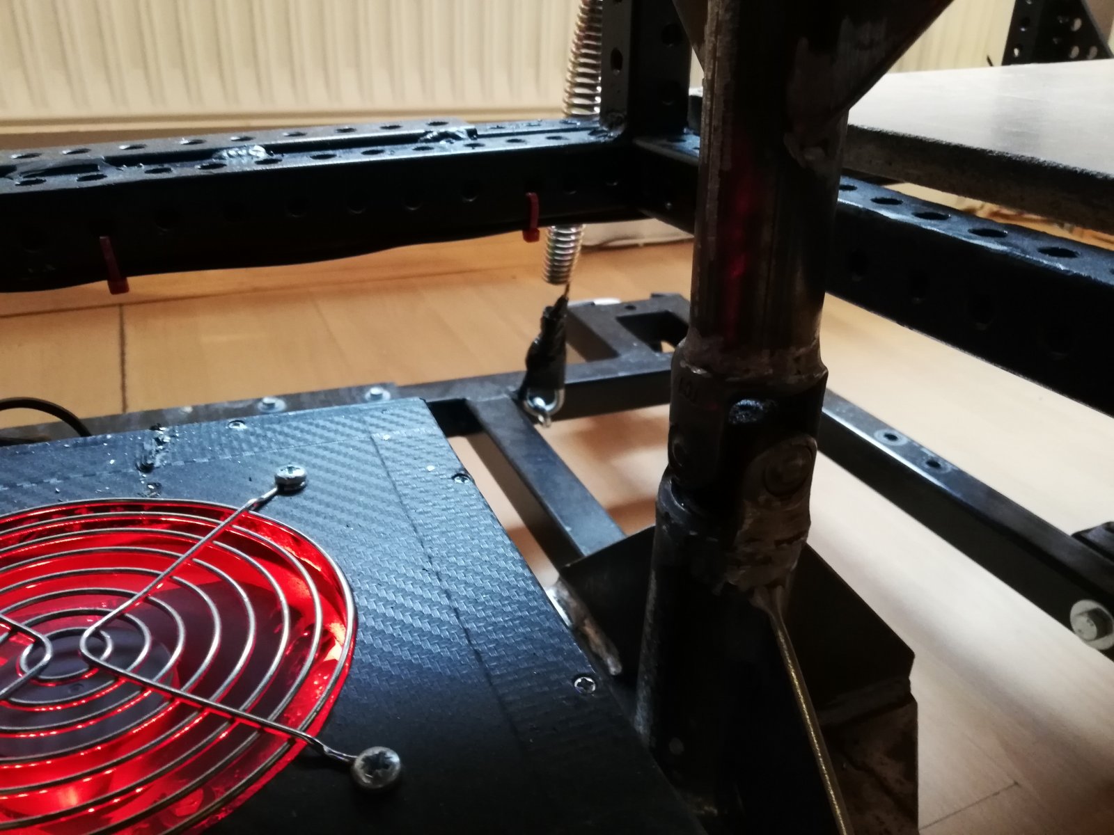

    Thank you for answer, balance is ok if is nobody on the sim if i seat down on the sim moving litle by left,right,forward,backward and motor doit sound like on the video if i disconnect levers everhing is ok only problem is if i seat down, motor dont holding balance and dont holding position in the middle
  16. sudca
    sudca New Member
    Sep 25, 2017
    18
    Slovakia
    36Coins
    And i put springs there and is better but if i seat down motor dont keep the balance like on the video IMG_20180718_183327.jpg IMG_20180718_183334.jpg IMG_20180718_183348.jpg IMG_20180718_183354.jpg IMG_20180718_183401.jpg IMG_20180718_183418.jpg
