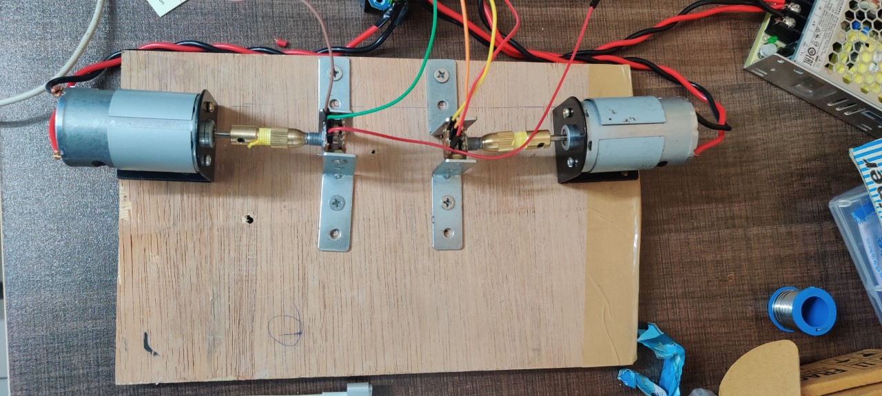

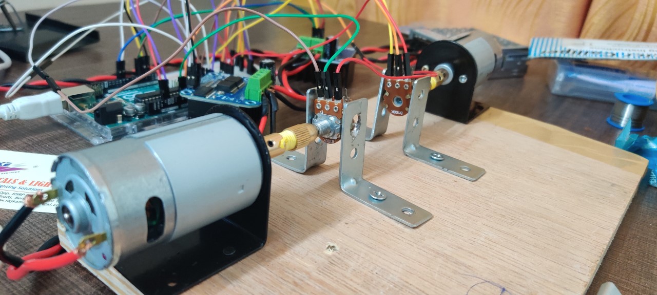

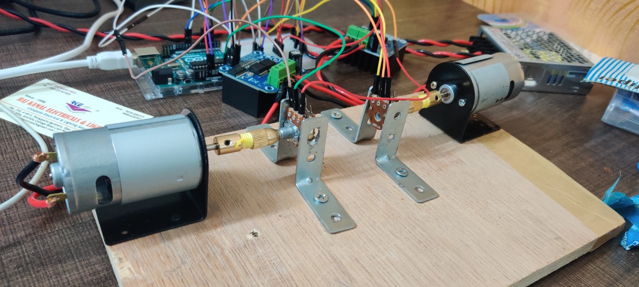

    Hello All,
    I am building a 2DOF simulator for PS4 using SMC3. Electrical connection is done but the motors are not moving. Please help. I am sharing the pictures.

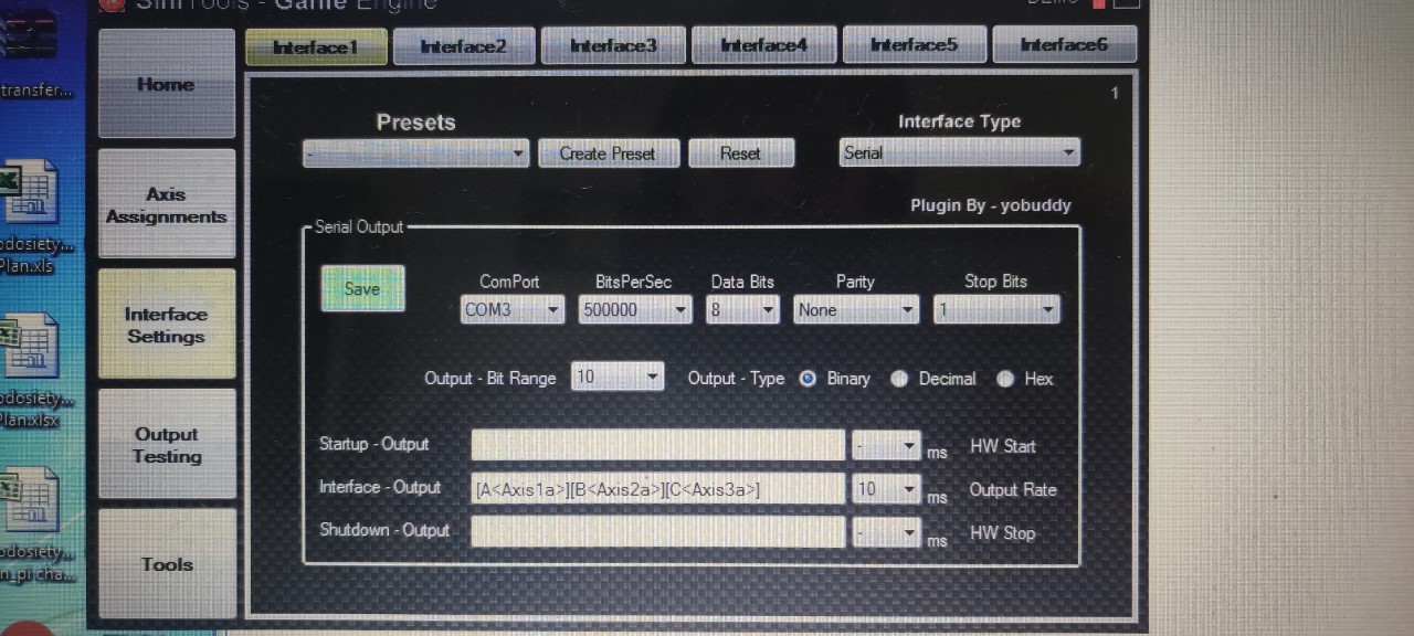

    I am presuming you are using Output Testing, if so is a Default Axis Assignment configured?

    Thanks for the Reply, Yes I just testing the Output as of now. Once I will succeed with this I will move to next step testing it on my PS4, Later will move for mechanical design. Where I have to configure the "Default axis assignment"? Is it on the interface window?

    It is configured in Axis Assignments.
    Grab a copy of the SimTools manual and keep it handy for reference: https://www.xsimulator.net/community/faq/rtfm-start-with-the-official-simtools-documentation.117/

    Thanks, I checked the setting and the Motors are running now. Output testing is fine but motors not working during the game play. What might be the possible reason ? I tried limiting the axis but still not working. Please suggest.

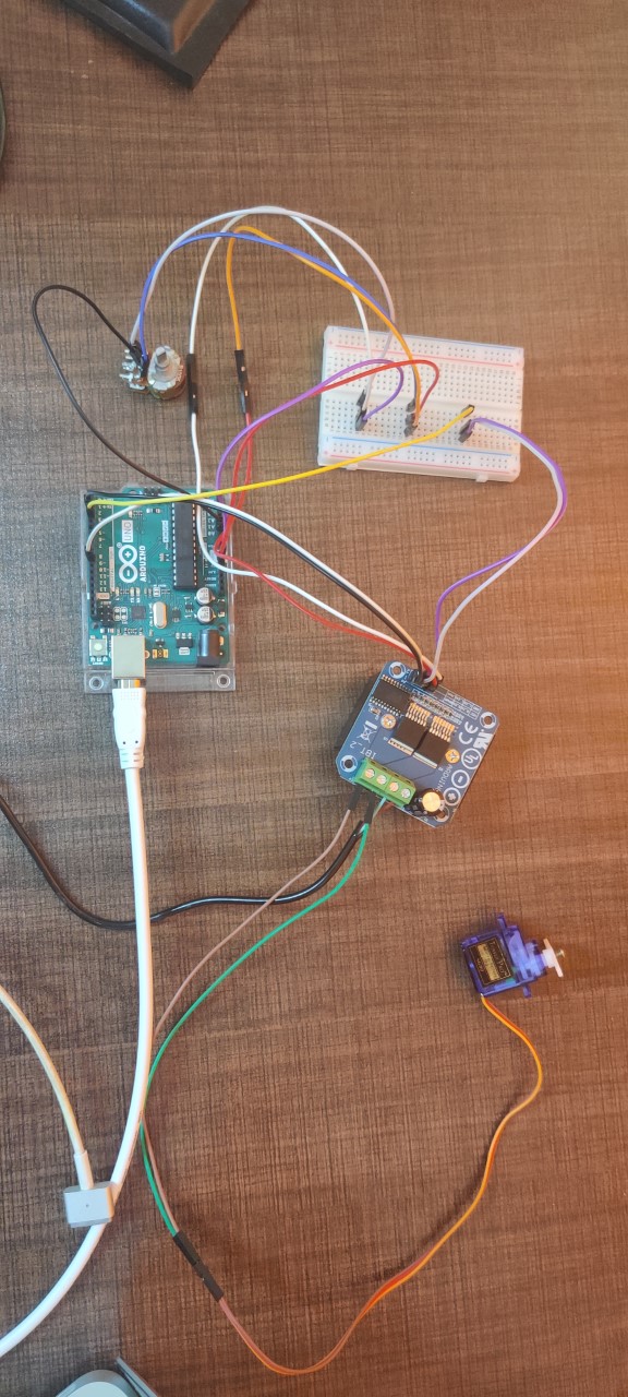

    Can you please share the wiring diagram for the POT connection to the motors? What changes are required in the Arduino code?

    If Output Testing works OK then you have to patch the game for motion and refine a motion profile.

    Hello, I have connected the POT of 100K to the shaft of the motor and slowly increasing the PWMax value, All of a sudden the POT go out of limit and the motion stops. Also on the lower value the Motor trying to turn but unable to turn. Please let me know what I am doing wrong. I have used 100K POT instead of 10K is this why its not working? Just for your information I am using 12V Motor for my prototype.

    Hello All, Need your help for my project. I have placed the correct 10K POT but when I start the SMC utility it overruns and stops. Manually I adjust the POT to bring it to center but which turn ON the motor but suddenly it moves and goes out of limits. I am stuck with this, don't know how to proceed further.

    You likely need to post pictures of your current settings and a video of what is happening.

    Please check the videos for Settings and Motor movement,
    Settings -
    Motor Movement -
    Please suggest what I am doing wrong, I have following issues,
    1. Motor stops as the POT goes out of limit.
    2. Motor spins in only one direction
    Although I have tried all the various settings, The Motor doesn't spin in both direction as I have seen in various videos. :(
