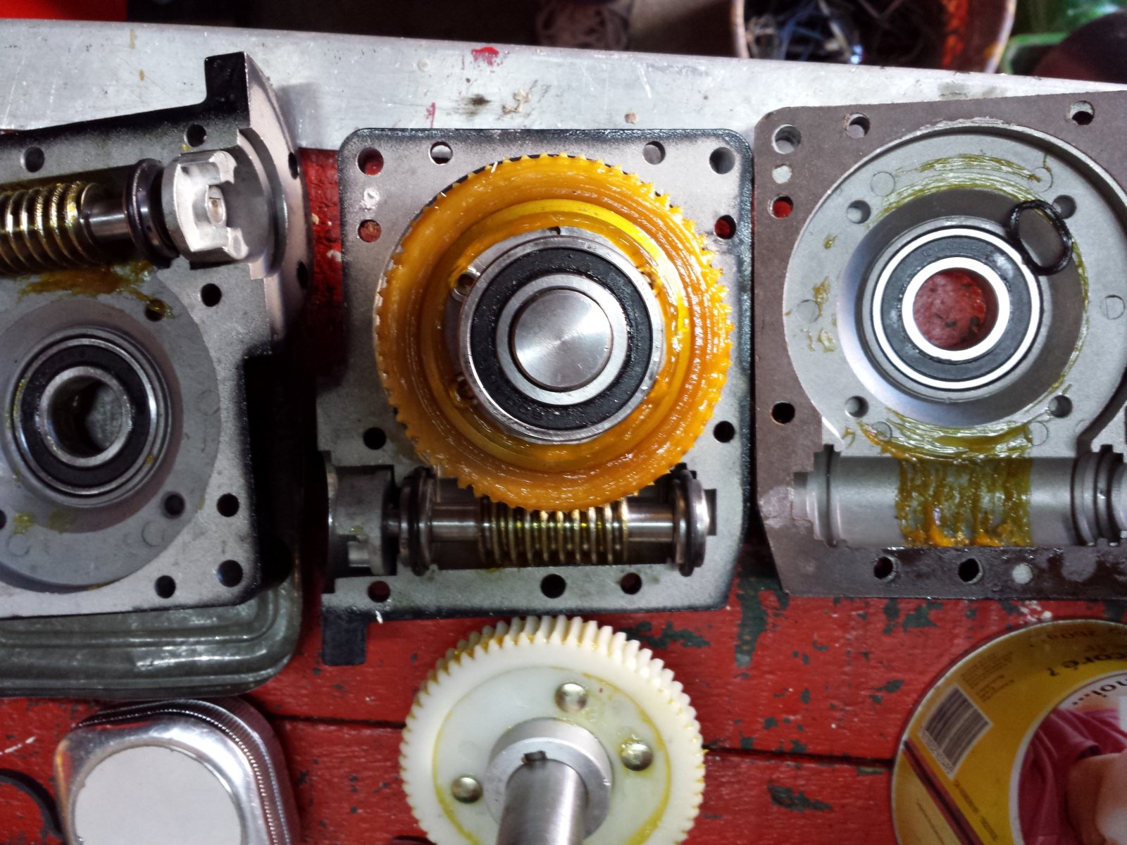

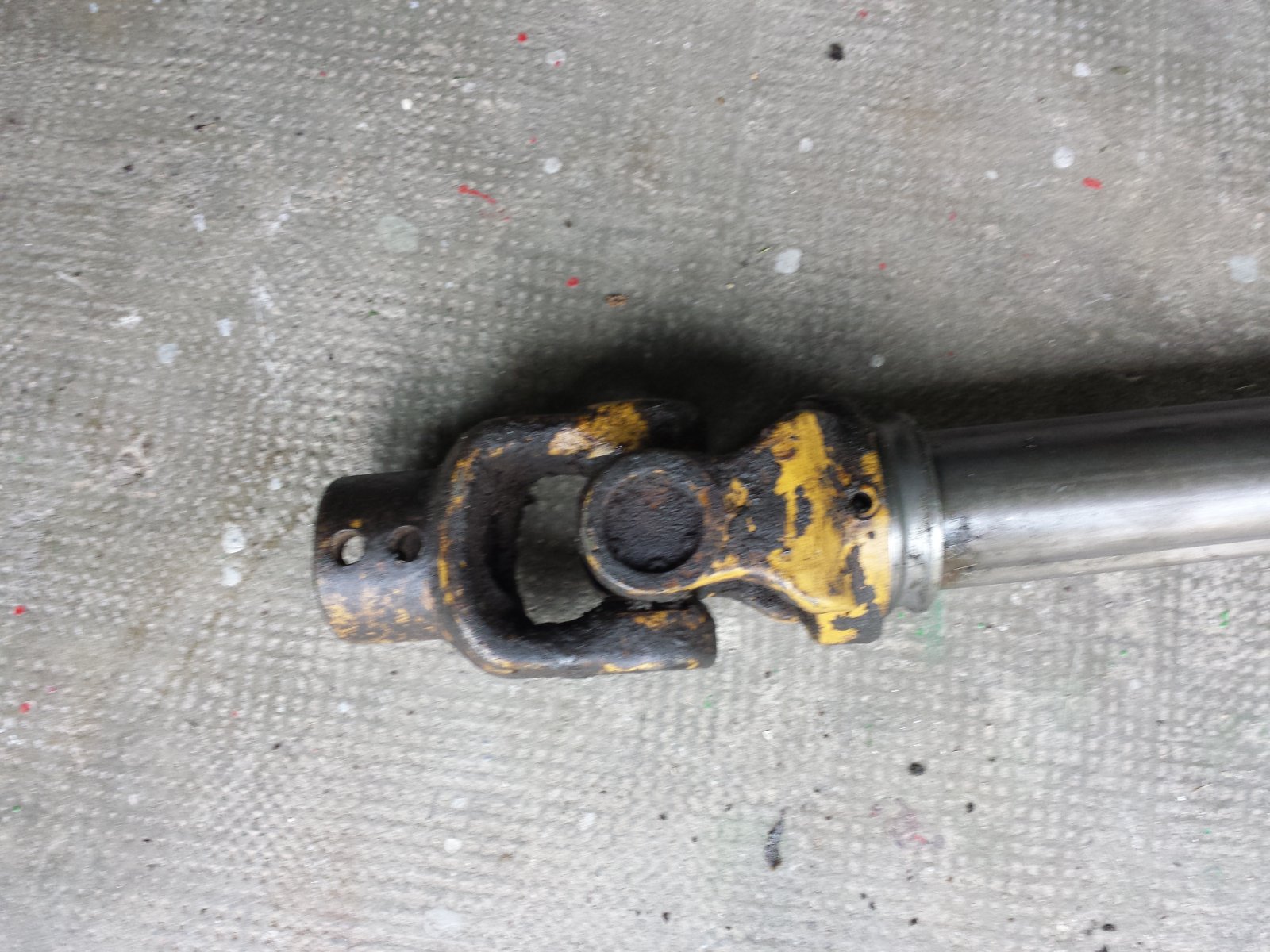

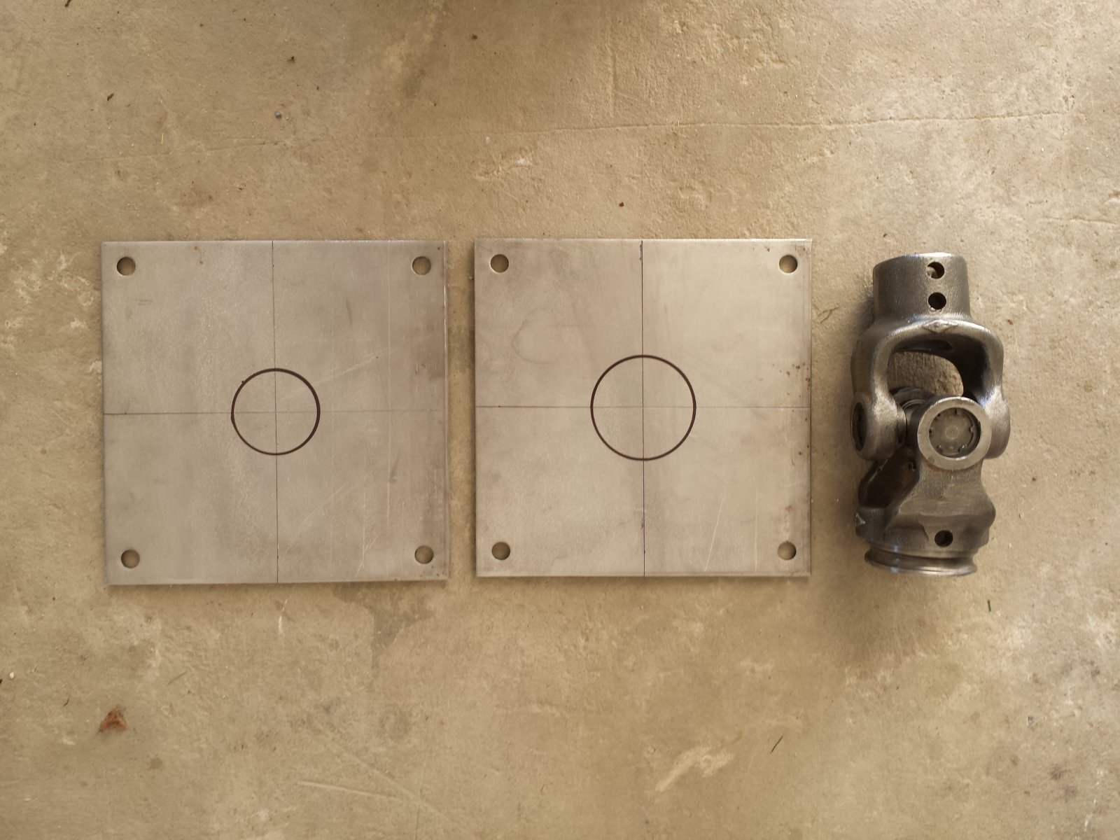

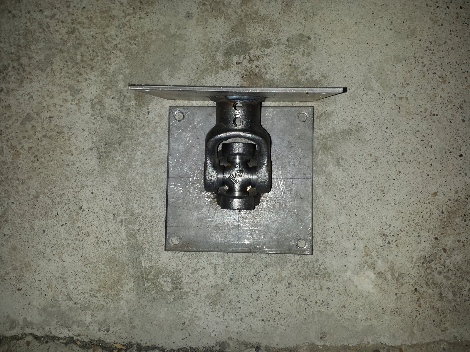

    Hello everybody, I'll make a 2DOF for my seat.
    Hardware:
    12V DC Geared Motor, Motor with 60:1 ratio Gearbox (Right Hand) and (Left Hand)
    http://www.ebay.fr/itm/111415229286?ssPageName=STRK:MEWNX:IT&_trksid=p3984.m1497.l2649
    2x Power supply 12V 50A 600W
    http://www.ebay.fr/itm/351108980724...eName=STRK:MEWNX:IT&_trksid=p3984.m1497.l2649
    2x Pololu JRK 12v12
    2x Potentiometer 10k PPC27

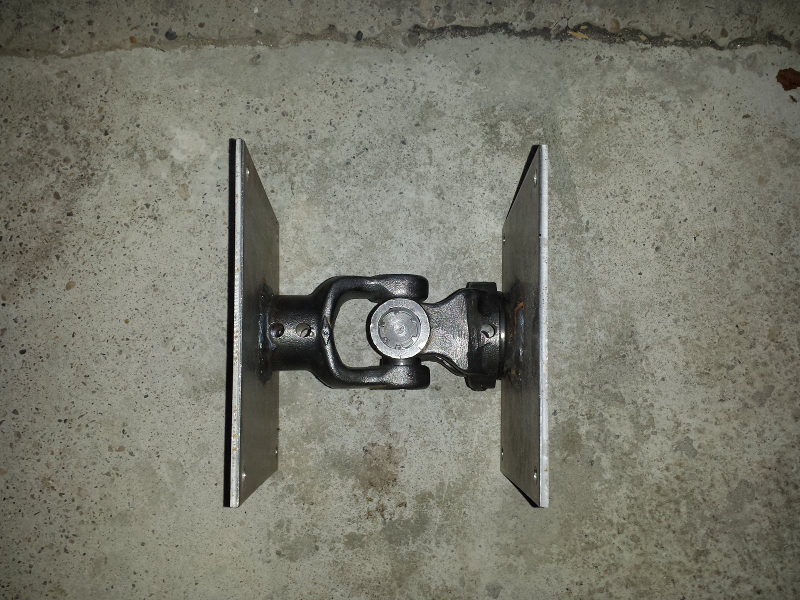

    Agricultural cardan
    Sizes of the plates 20x20

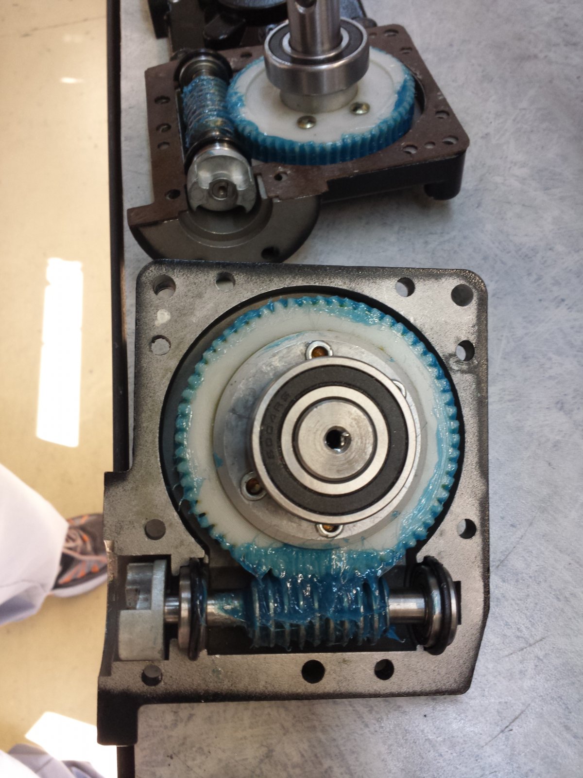

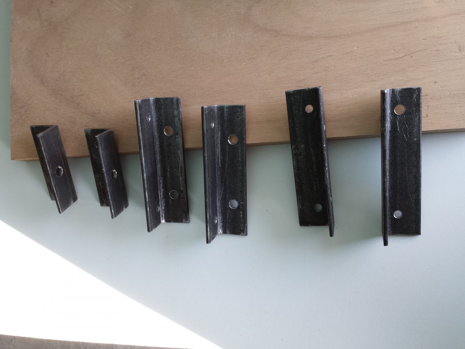

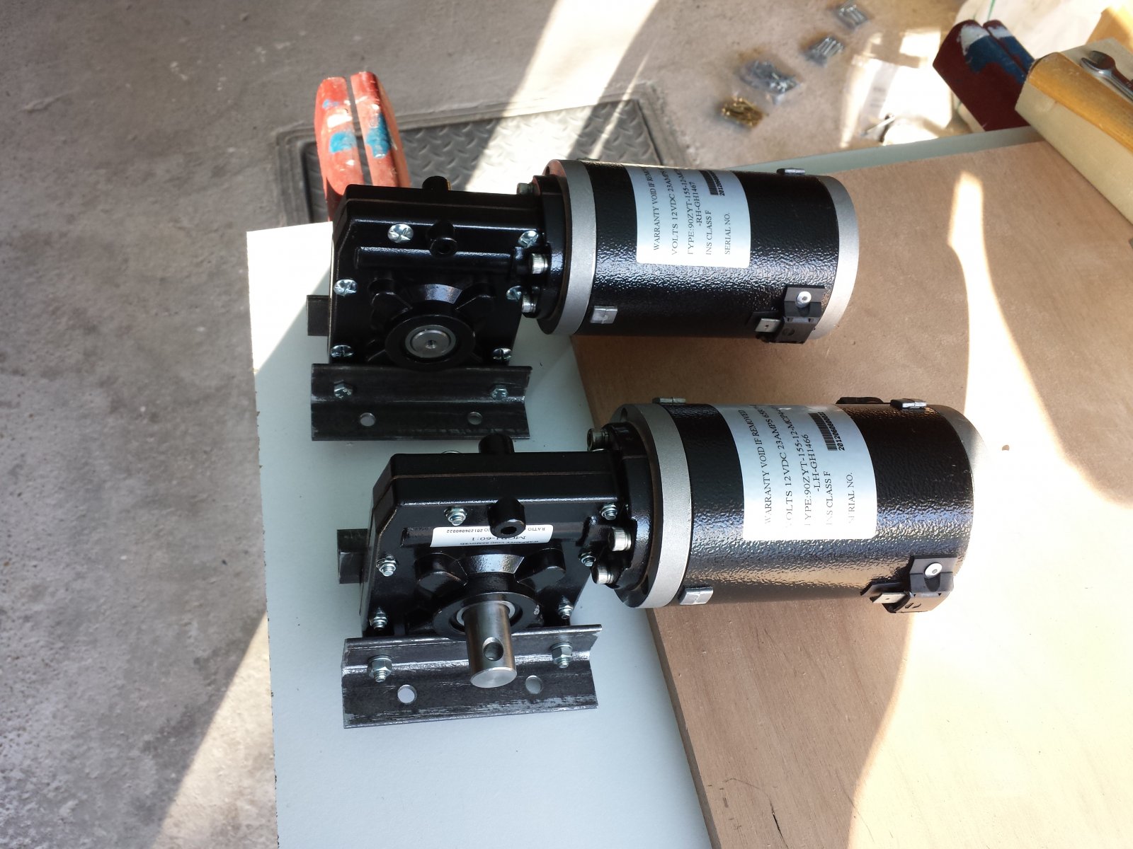

    Dismantling of gearbox before drilling
    Cutting and drilling of motor mounts
    The mechanical and almost finished, tomorrow I will make pictures of all and I'll start the electronic part.

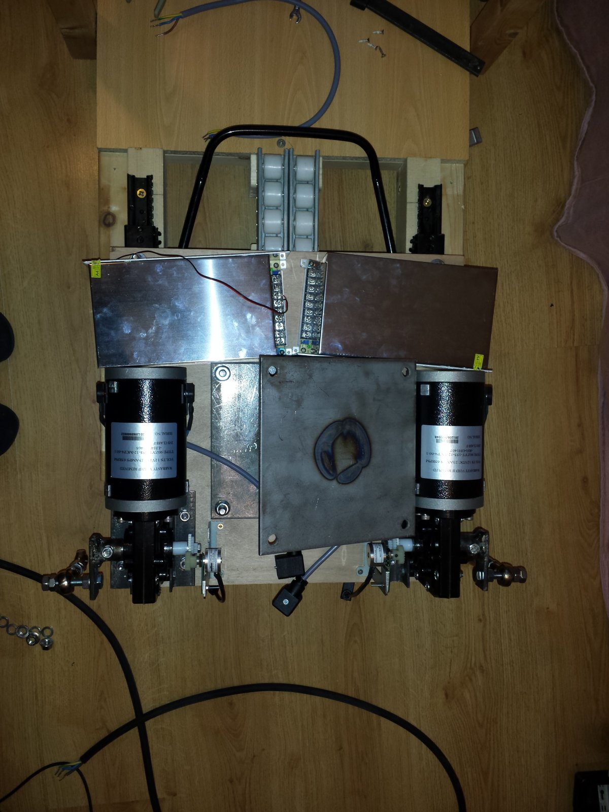

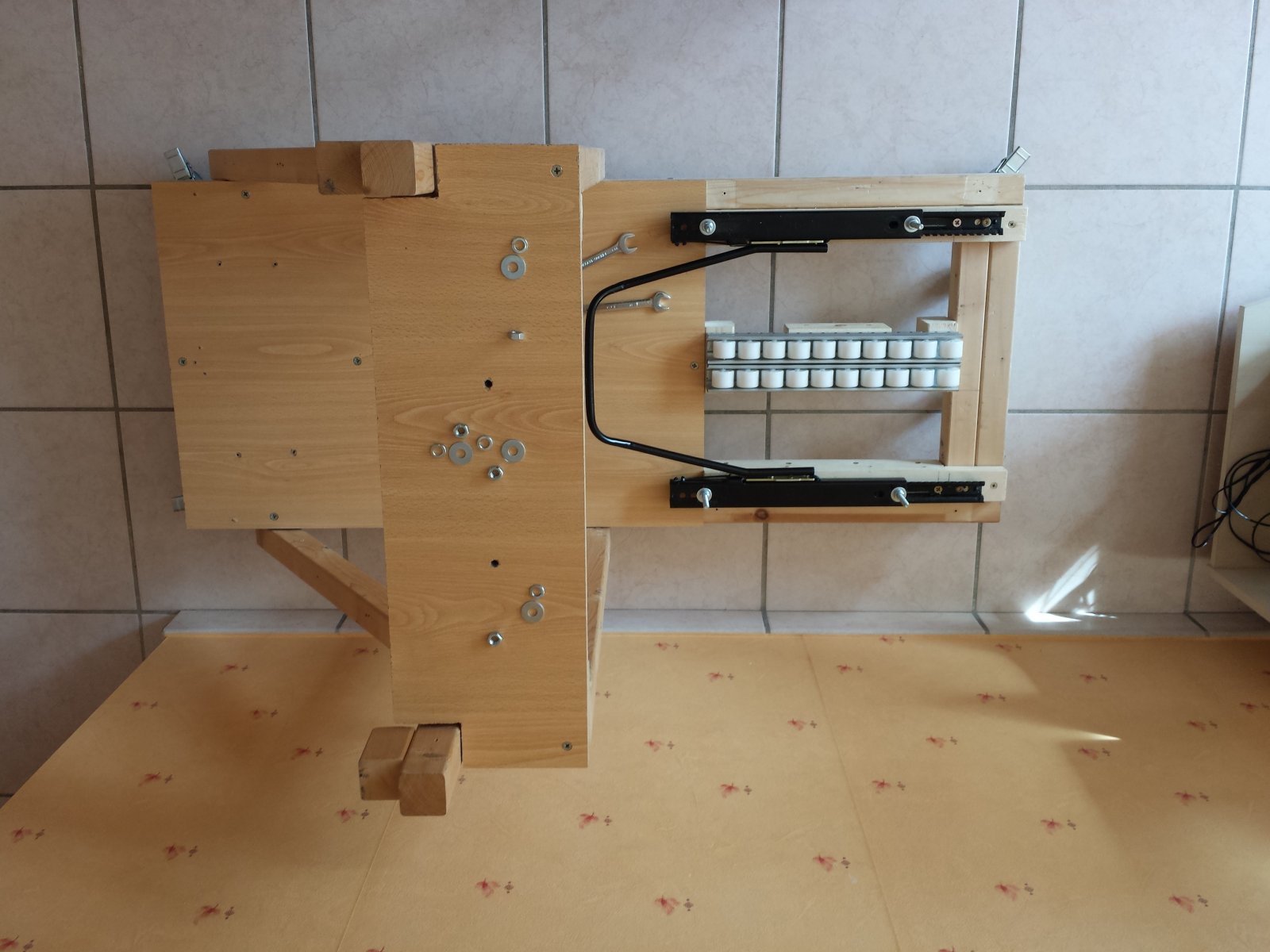

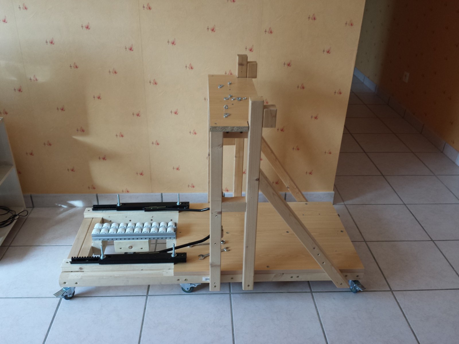

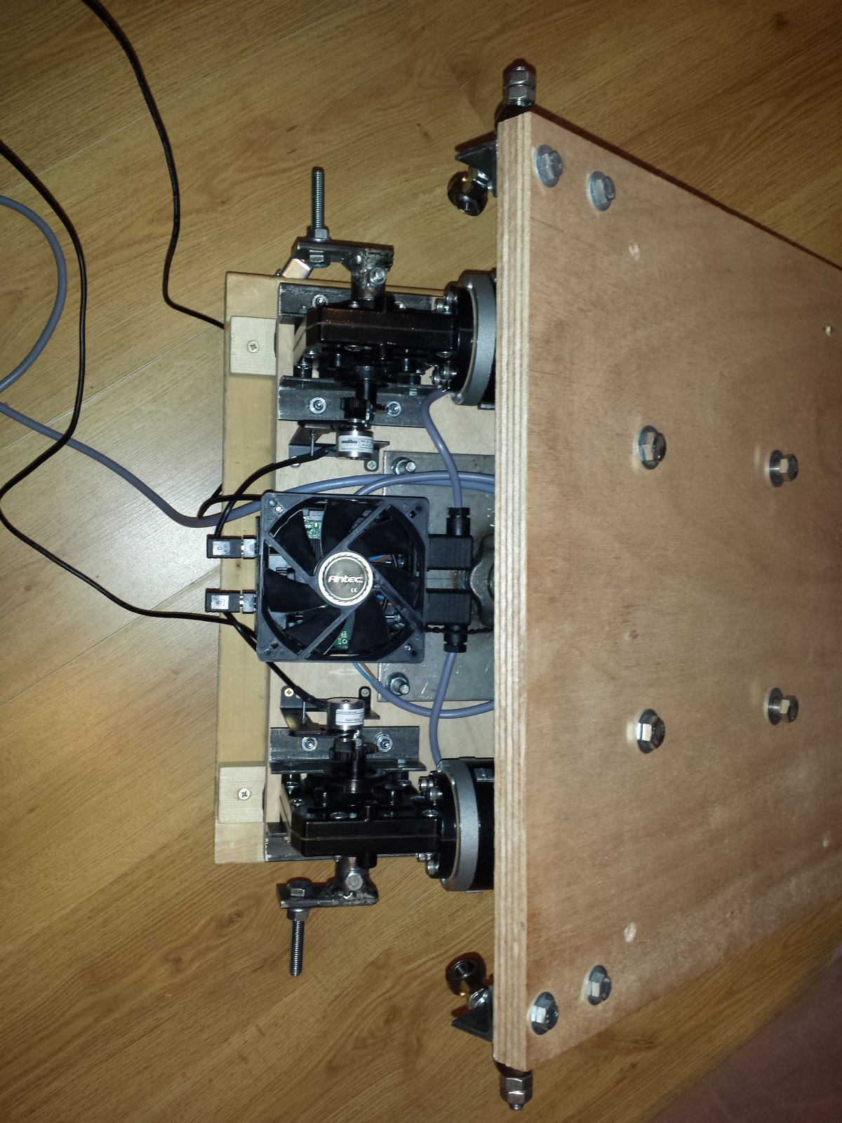

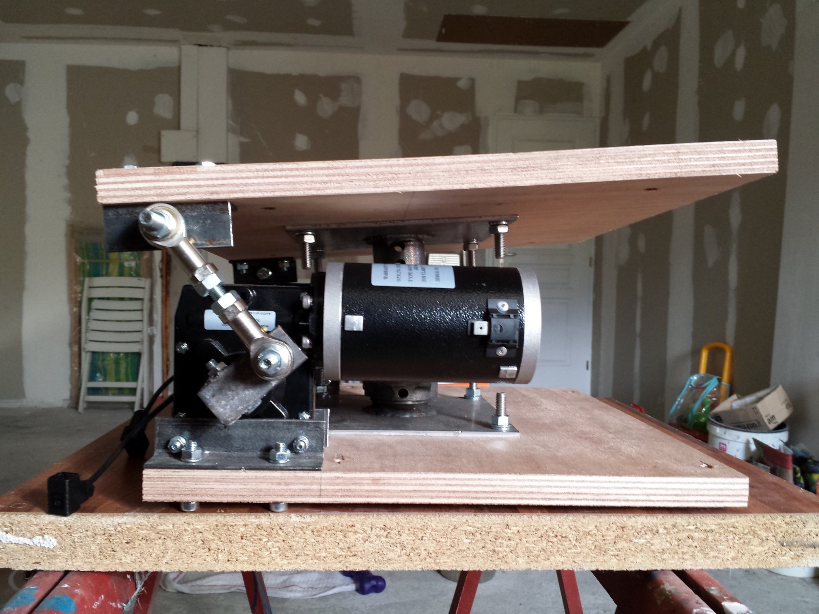

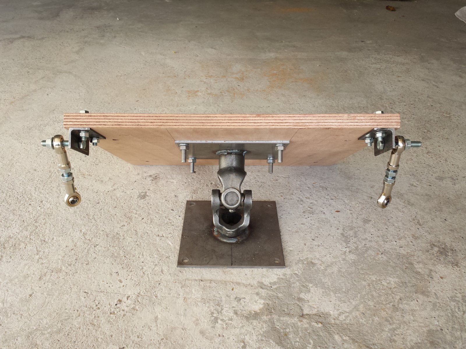

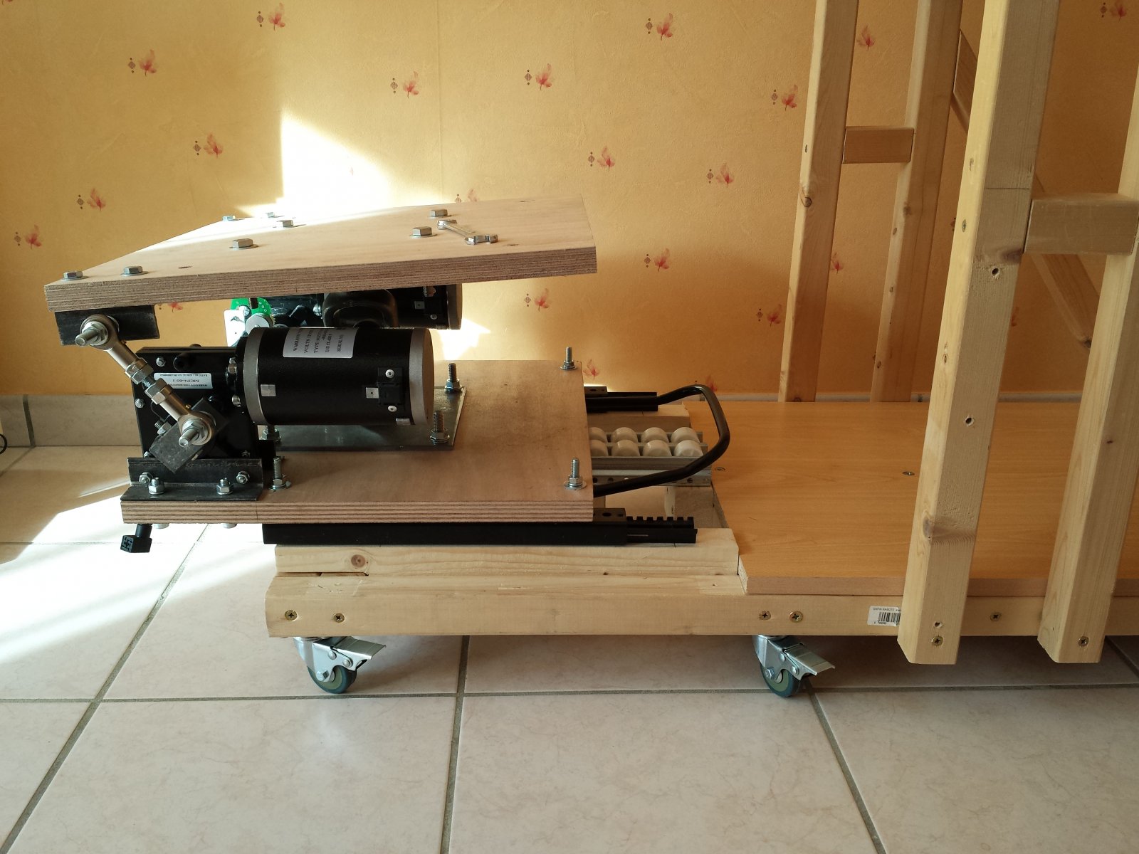

    @noorbeast I made a wooden cockpit when I bought my wheel (Porsche 911 GT3 RS V2 Wheel EU). After finding my seat equilibrium point, I wanted to keep the possibility of setting with the seat rail.
    IMG_20141107_094234.jpg IMG_20141107_094312.jpg I finished the mechanical part
    Now the electronics with JRK :sos
  5. bsft
    Good idea, I recall @Rastus did the same thing and at his young age of 86, its easier for him to get in and out of his seat mover sim
    With JRKS, no problem, just holler if you need help setting up.
    EDIT, oh and turn the motor levers the other way
    21,511
    150,686Coins
    +11,018 / 55 / -2
    Very compact design @Trafalgar, the seat rails are a great idea and looks really sturdy. At this rate you will have it moving in no time.

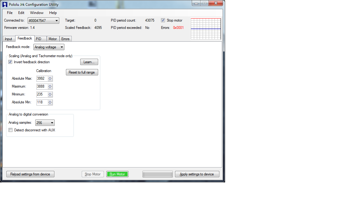

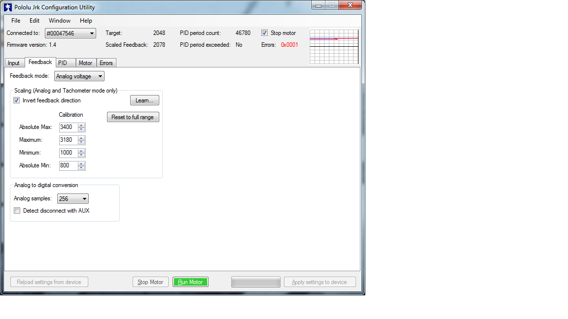

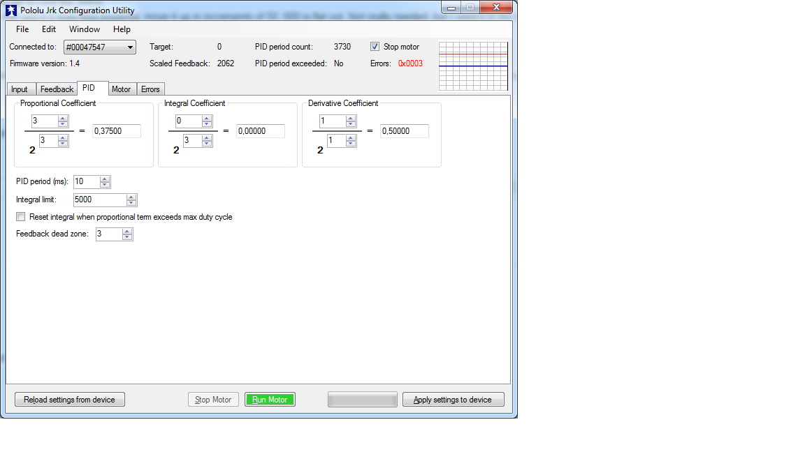

    I wanted to keep the same dimensions for my cockpit, that's why it is very compact. Maybe a little too much, I have yet to find a location for my two power supply :eek:. I did the manual calibration potentiometers with my two card JRK. The control with the target set is very sensitive, if exceeded, motors oscillate.
    For learning, should we adjust the range of the potentiometer 180 ° or 90° ?
    For PID, what are the standard values ?
    @bsft I have a motor in one direction and the other reversed, if I do not keep this configuration, the motors oscillate loudly.
    I'll take pictures soon, but I still did not find how to attach the cards pololu :mad:
  8. bsft
    heres a video that might help. All I did was just set the feedback]
    I dont adjust anything
    If motors occilate, it sounds like PID.
    Set D and I to 0. work with P, move P up in increments of 0.1 and test each time in the slider input tab till it oscillates. Once it hits that , halve that value. Then work with D, again working up in increments of 0.1 and test again in slider in input tab till it moves nice and solid.
    Leave I at zero
    Can you please send me screen shots of you PID settings so I can see them.
    With one motor leaning the other way, the whole frame is going to be lopsided. Yo may just need to invert motor direction and or feedback direction in utility settings.

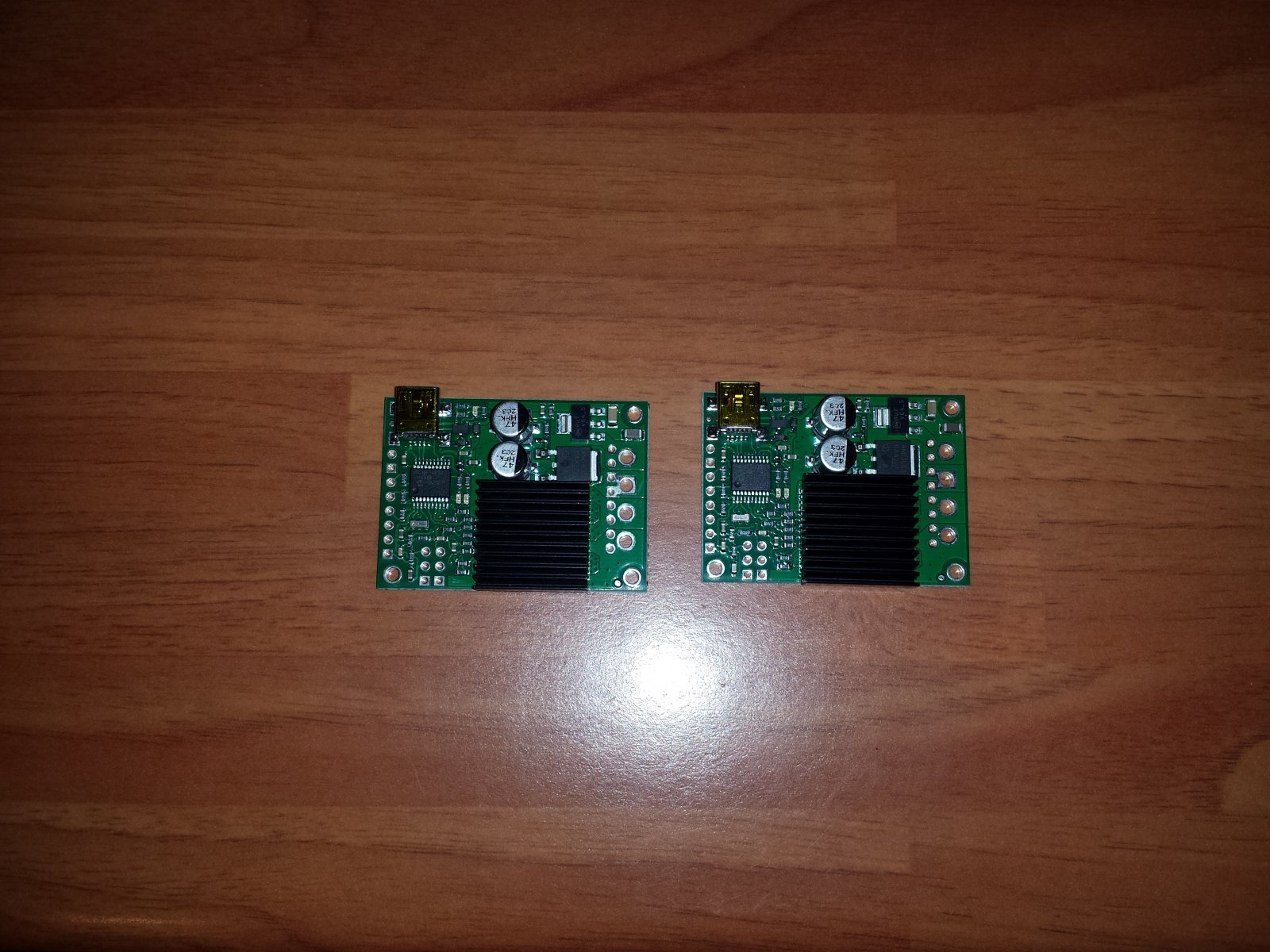

    Hi, I'm back :)

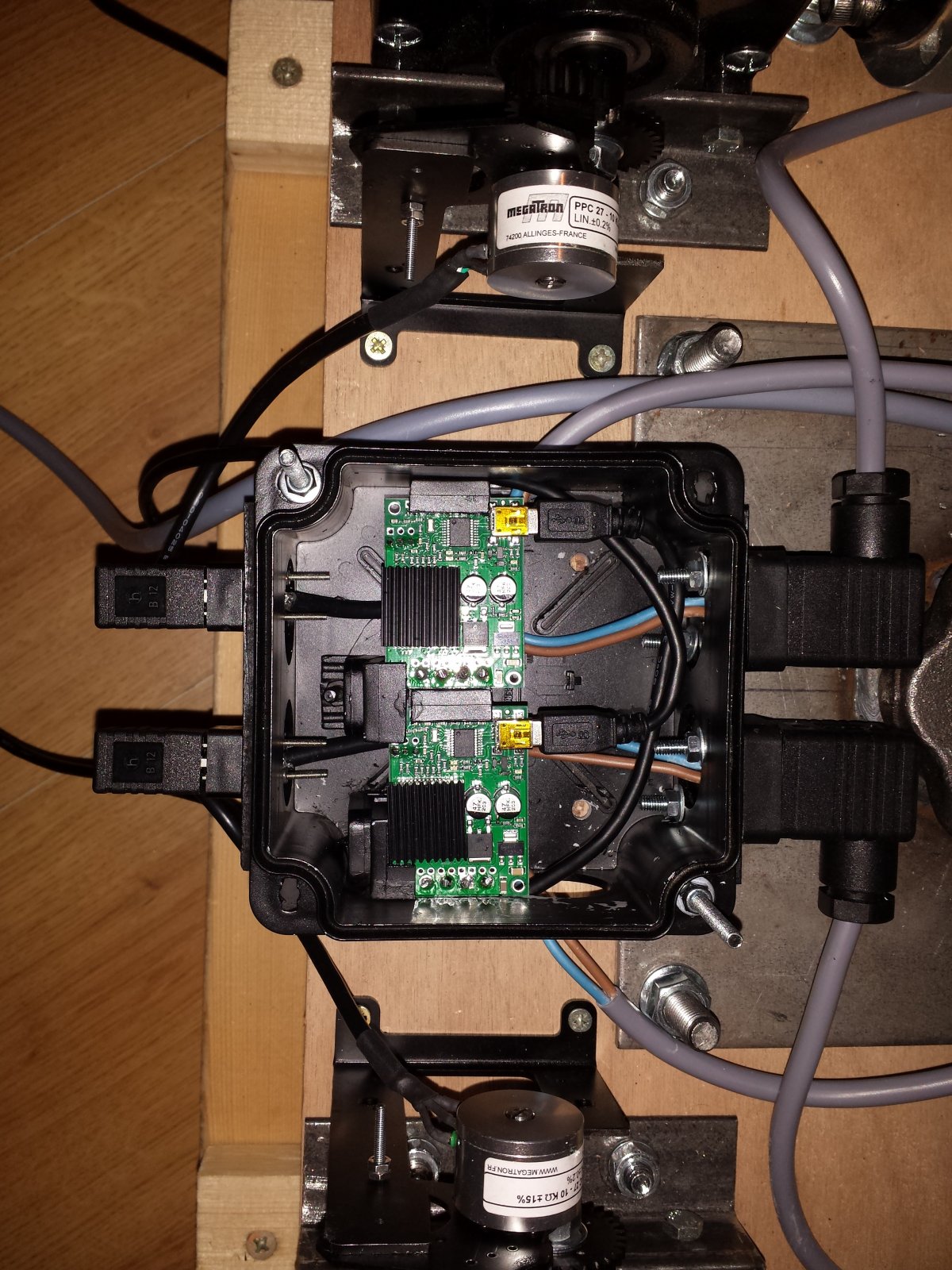

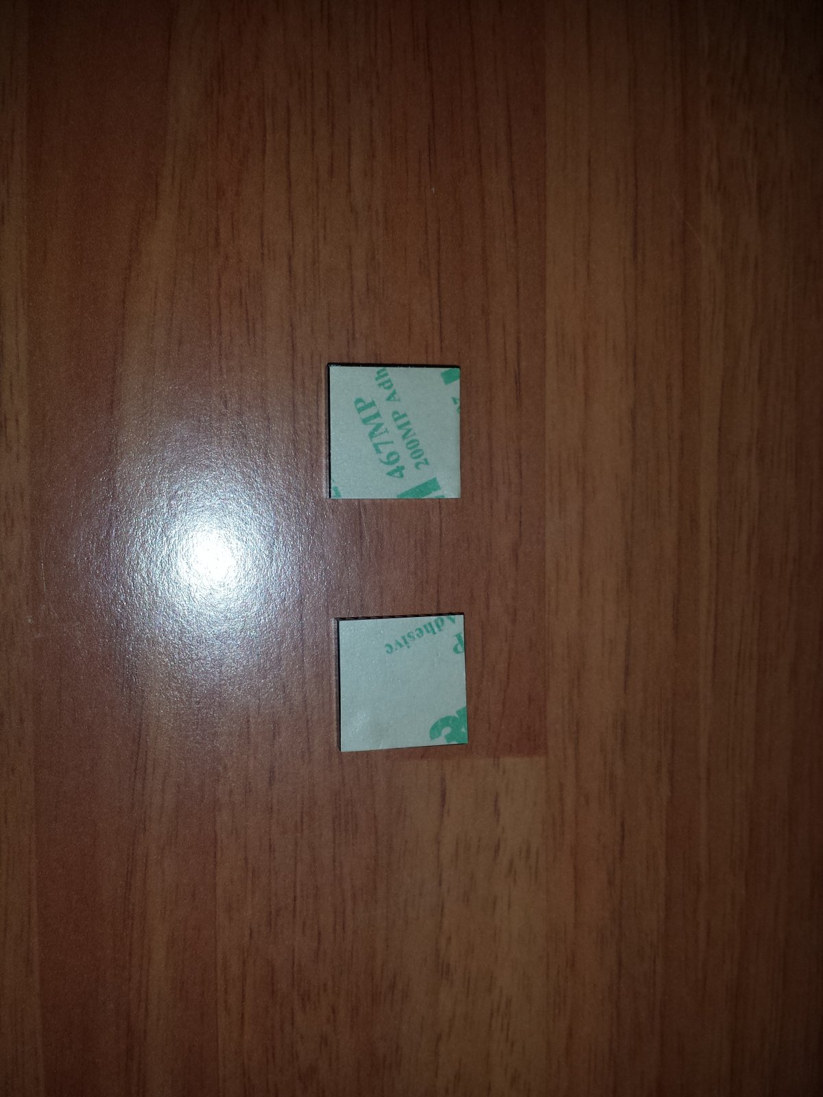

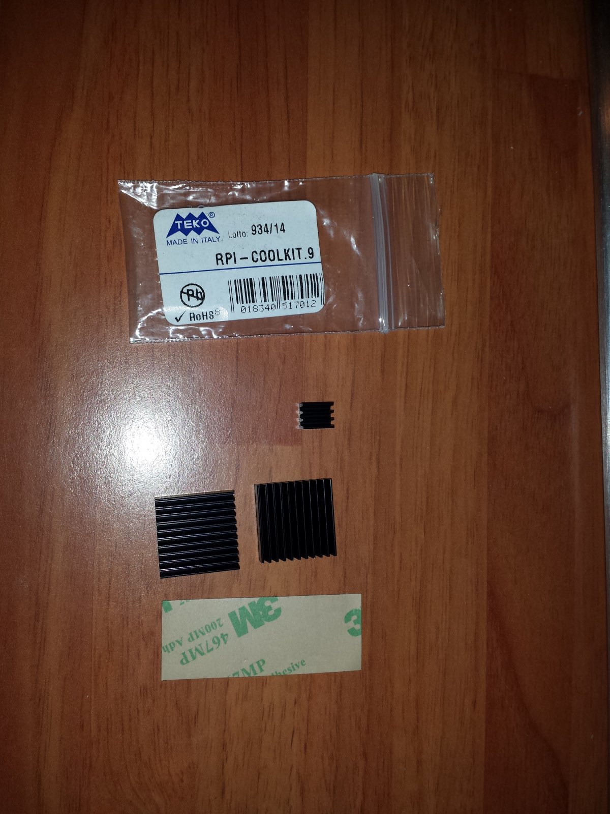

    I stuck heatsinks (heatsink for Raspberry Pi) on the big chips.
    I found a location to secure the two power supplies.
    I tinkered a electrical junction box to put my two JRKS

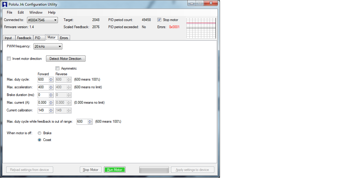

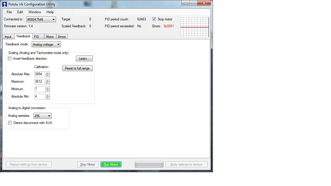

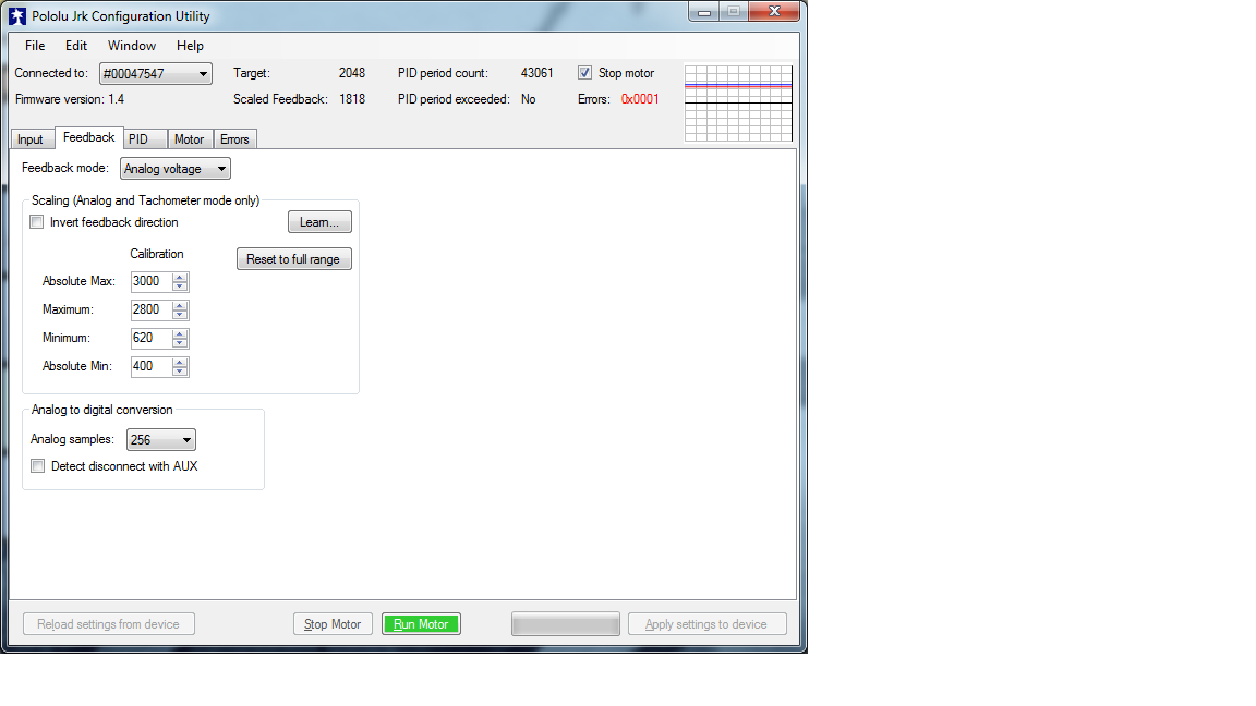

    I began the paramètrage of cards JRKS, here are the screens of values Max/Min of my two engines.
    For PID settings & motor, I used the values on the topic Erwan960, I will refine them again later.
    With these values, I have done my first test on LFS :cheers
    The seat moves :thumbs, I have to finish fixing the steering wheel and pedals on my cockpit.
    I have not yet understood how to get the plugin for Assetto Corsa and DIRT2, he'll have to look at it quickly.

    I almost finished my 2DOF, but I'm not very satisfied. In terms of movement, surge & sway ok, it seems to be synchronized with the games.There are however things to that hinder me. I tried the following games, Assetto Corsa, Game Stock Car 2013, DiRT 2 & 3, RaceRoom Racing Experience.
    1_When the acceleration is finished, for exmple from 0 to 100 mph, to 100mph the seat should not return to its original position 0?
    It no longer of pushed, the speed is constant.
    2_On a game like Dirt2, the road is rutted, often my engines vibrates at certain extreme positions. This game is the most problematic, because the road is not linear. I am often in excess of instruction on all my games.
    3_But in general, I do not feel the mouvenents heave, pitch, roll and yaw. Is this normal?
    here is my screens of my configuration, if anyone can tell me where I'm wrong.I'll change the way of doing my turn potentiometers, for setting taken directly, perhaps change the potentiometers. For my potentiometers, I use sprocket a 32 tooth and a 20 tooth.
    Use you smoothing, washout, deadzone option in Game engine ?
